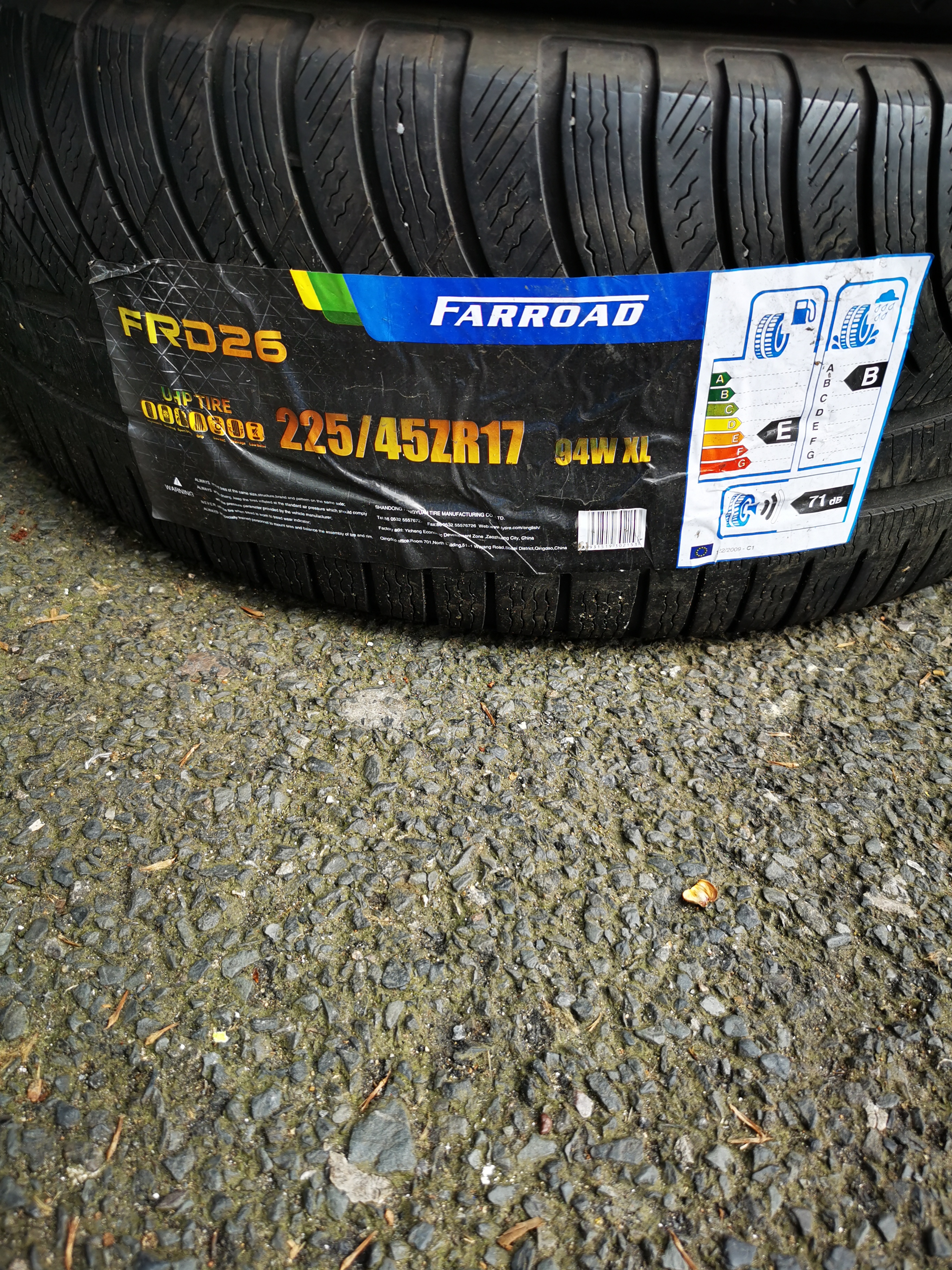

Similarly old tyres will have lower rotational grip than new tyres. New tyres will give more resistance but also depending on what tyres you fitted will depend on how much extra. Usually A rated tyres will give better economy and G rated tyres the worst. What tyres did you fit and what tyres came off?
I have checked the tyres. They are called Farroad (225x45 R17). Wouldn't be able to find the ratting of these tyres.
Just to let you know the consumption 289miles in 39liters. Previously I would get 330miles with this anount of petrol.
289 miles on 39 litres is ~33.7 mpg
330 miles on 39 litres is ~38.5 mpg
To put that into context, the worse/best from a single tank in my vRS is 33.0 vs 41.95 mpg so its certainly within single tank variance. Might be worth measuring a few more tanks to confirm the fuel usage :)

Is that the tyre or have you chucked the sticker on something else?  If you image search the FRD26 it doesnt look like that.
I think @langers2k has nailed it.  Different tyre + new tyre + tank variation = your higher fuel usage.
  • Confused 1
Thats the original tyre in front of the tyre shop in the corner of my house which i fitted in my car. As I was walking by, it cought my eyes and thought to share with you guys as somebody else was asking about the sticker. Its pretty bad, consumption grade is "E".
