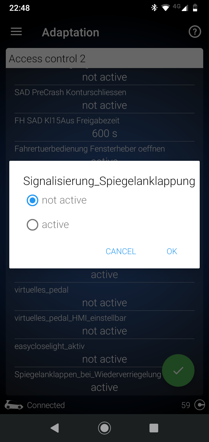

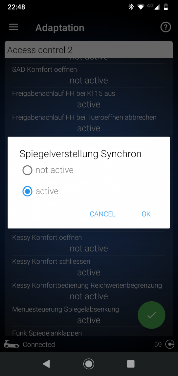

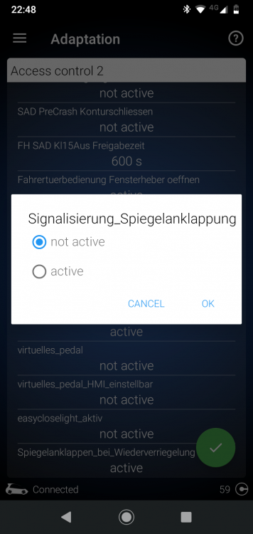

 I changed  2 adaptions in access control 2 to not active and it worked on my pre FL 2017 Vrs. See if that works for you.Screenshot_20200707-224832.thumb.png.ebddafff279e66a0da8a88240bad2761.pngScreenshot_20200707-224818.thumb.png.981624e3c6adaccdc5395100fa3c4221.png
So it looks like you just have to change spiegelverstellung Synchron: to not active I reckon.
