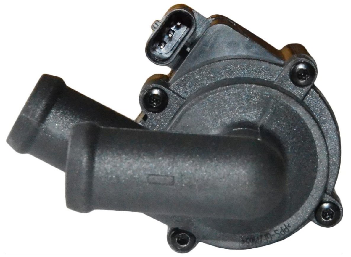

The noise sounds like a tyre inflator pump, but it's clearly not that. The fuel system pump(s) shouldn't carry on after switch off.  The radiator fans make more of a roaring noise, and if you open the bonnet you can see and feel them going. But there is an auxiliary electrically operated water pump which carrys on circulating coolant after switch off, to avoid heat soak.  I suggest you try and locate it and see if the noise is coming from there (it shouldn't be anywhere near that loud by the way).  Sometimes a length of plastic or rubber hose is useful as a stethoscope, put one end to your ear and "explore" with the other end.

The main water pump is mechanically driven by the timing belt and is the one that's often replaced at the same time as the belt. It only runs when the engine is running.
The auxiliary water pump is electrically driven, so that if the engine is quite hot the coolant can still be circulated for a while after the engine has stopped.  I suspect that it can also be switched on automatically to boost circulation if the coolant is especially hot and the engine is running but not very fast, e.g. idling in traffic.
IF it is the auxiliary water pump making the noise, it suggests that something has failed and is causing internal rubbing, or some foreign object in the coolant has come to rest inside it.
