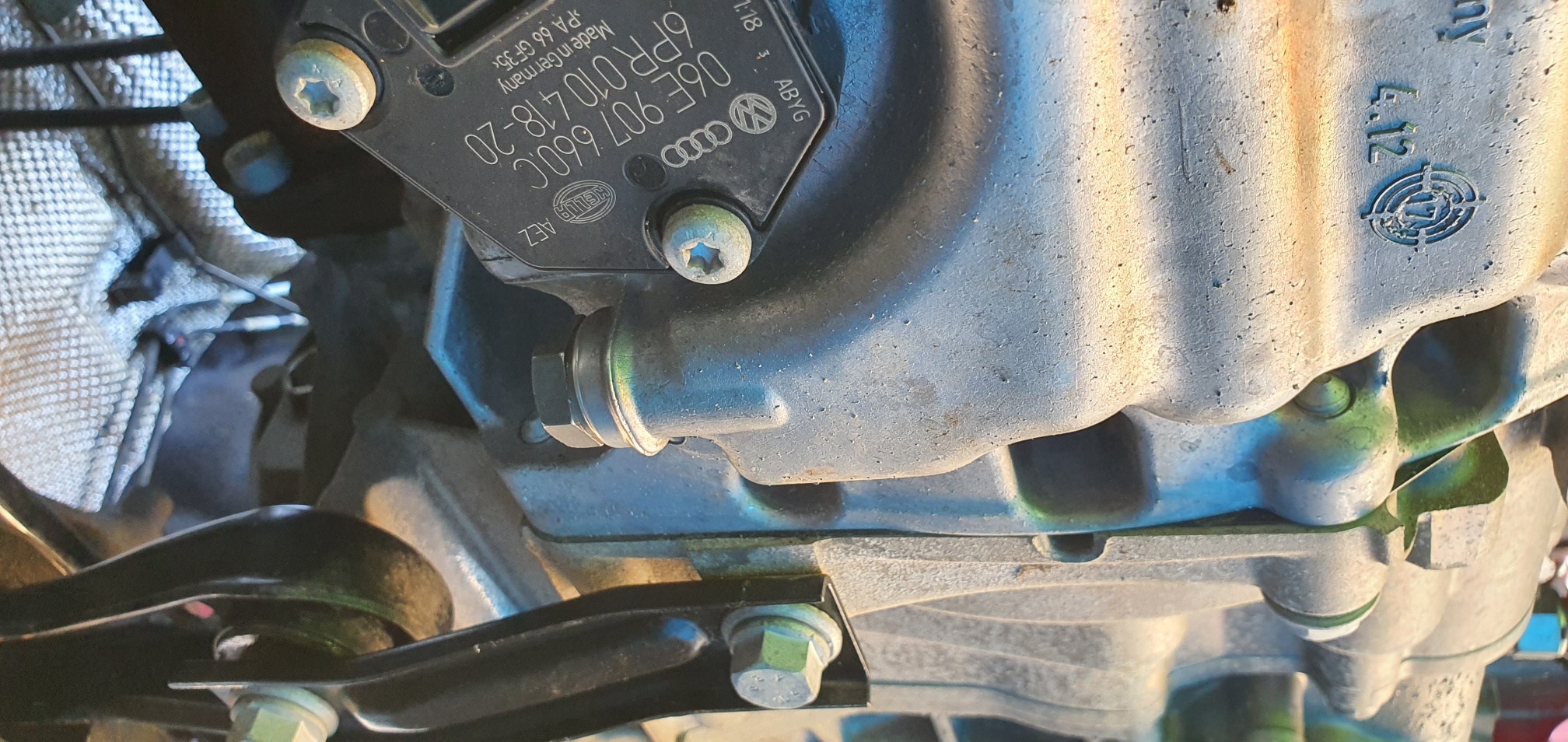

5) You now need your oil catch can and the 19mm spanner.  Undo the sump plug shown above.  Watch out - oil will get on gloves  - it comes out with force.

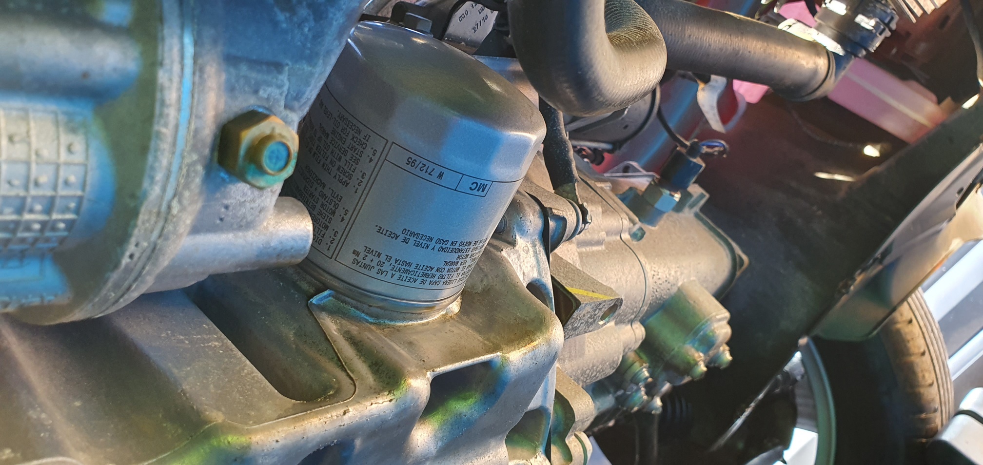

6) You now need to take off the oil filter - you will need your oil filter removal tool.  Space is slightly tight, but suggesting getting purchase on the end of the filter.
7) Oil will come out from the filter, so be careful.  Have some rags available to mop up any small spillages.
8) Put in new sump plug and washer.  I've tried to find the correct torque settings - google suggests 30nm of pressure (which is quite a lot).  Practice shows that you will get up to about 25nm and that is tight.
9) Put on the new oil filter - remember to put oil on the seal around the face of the filter.  google suggests 20nm, in practice, this needs to be done up hand-tight (as tight as your hand can manage).

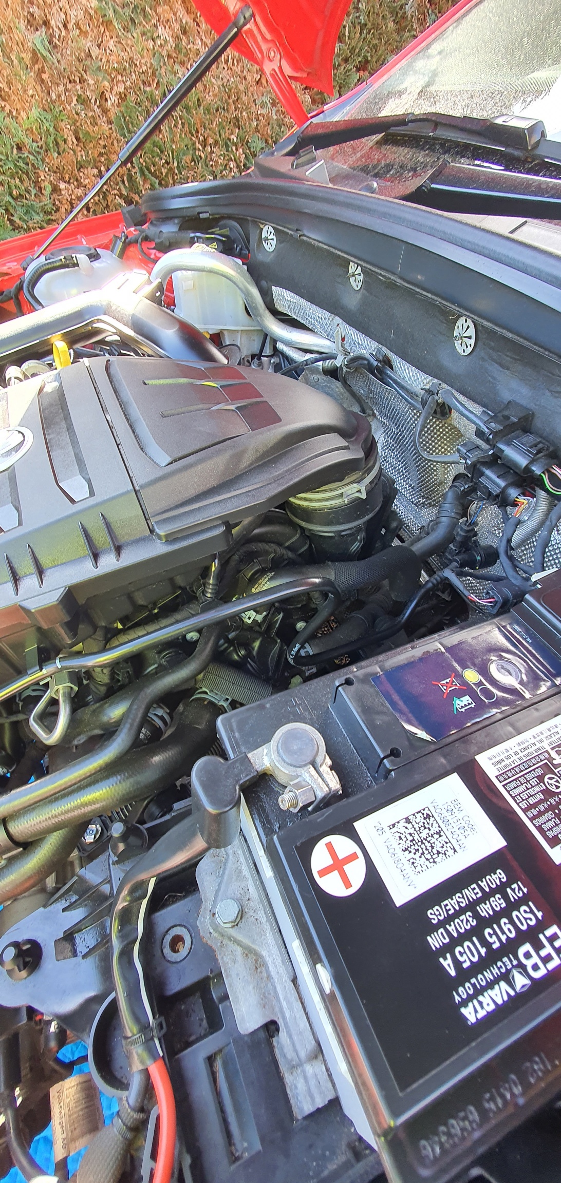

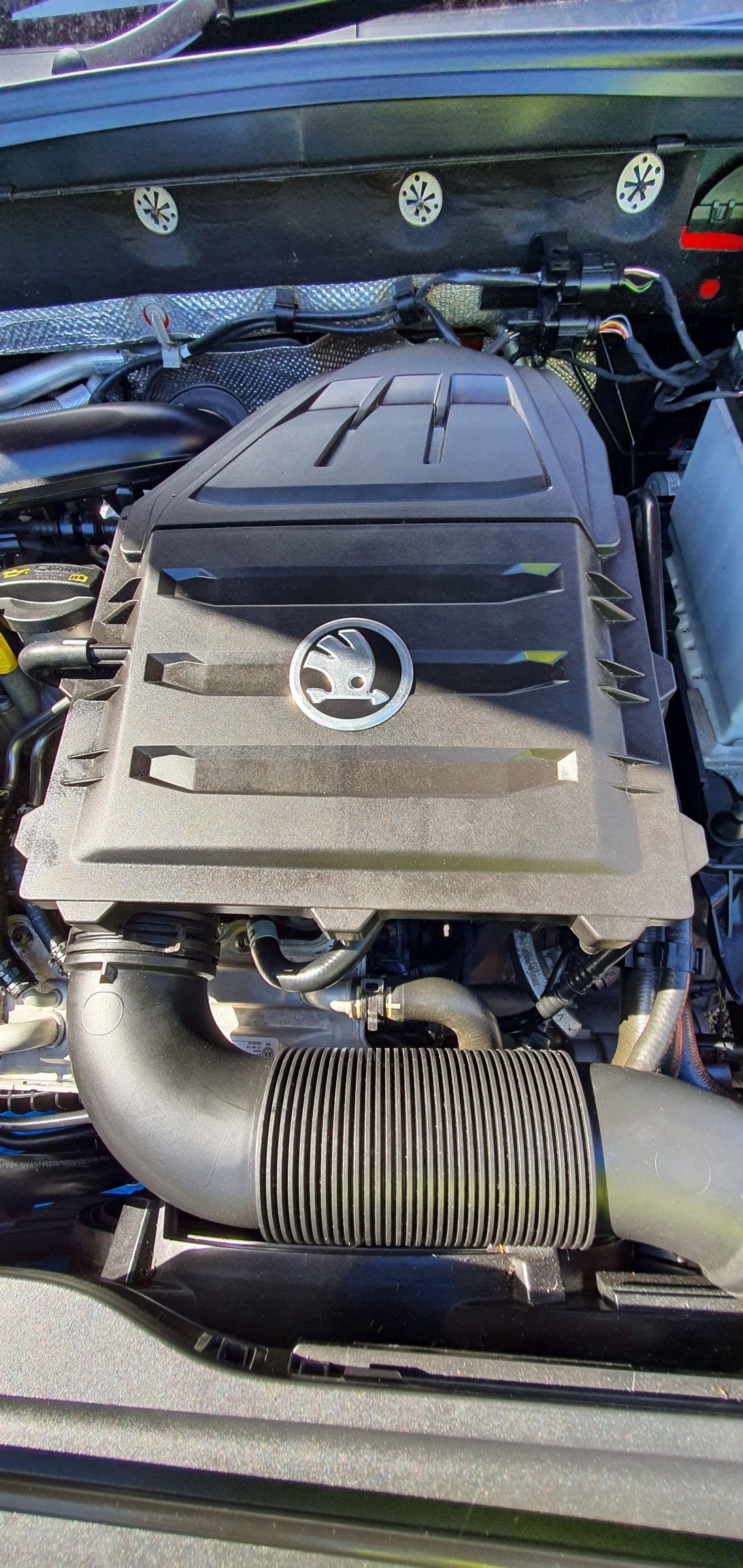

15) Air Filter - the air filter box cannot be accessed whilst on the engine.  It needs to come off.
16) There is a T35 at the front middle of the airbox.  Remove this.
17) You need to remove the air hose surclip at the back of the filter.
18) The air filter pops off (like pulling off the plastic cover from a TDI Engine).  You can now access all of the T35's around the filter - and replace the filter.  Please note the correct way around for inserting.  Don't forget the T35 in the middle of the filter housing.
19) Put filter back onto hoses and top of engine rubber mount.  Its fiddly - and its important that the clip makes a good seal (see photo above), otherwise you will have an uncontrolled air leak.
