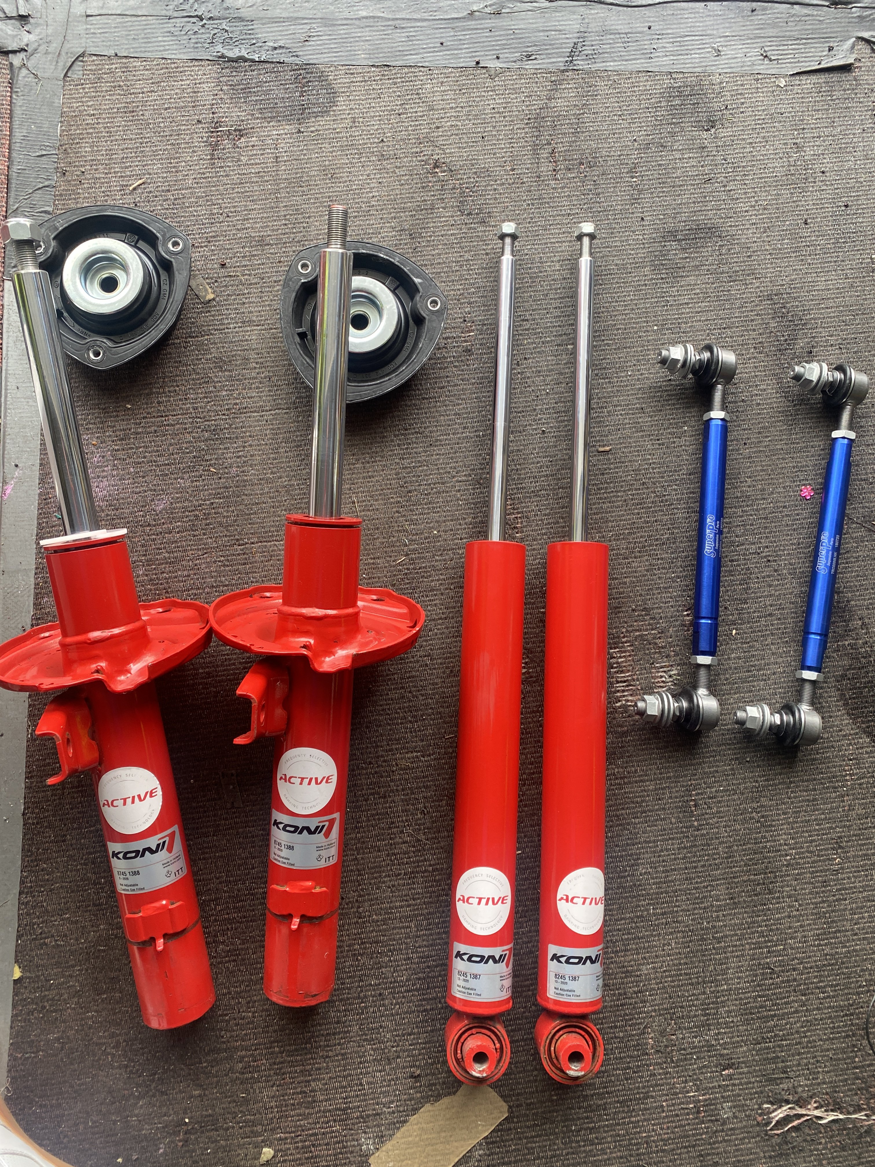

Koni special actives mate. Just fitted a set that I brought form a member on here and it’s absolutely lush

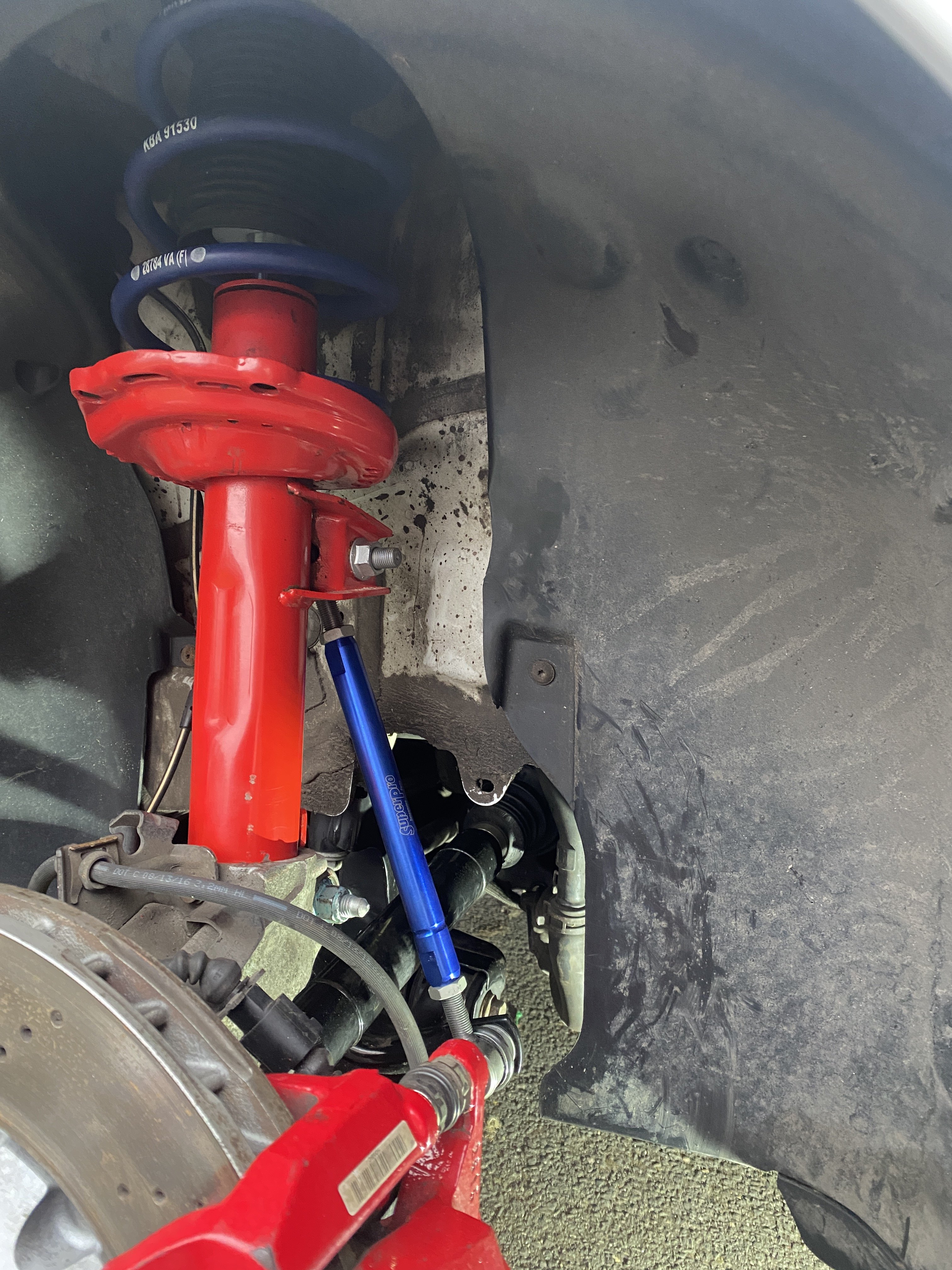

How were they to fit? What's the benefit of those tie rods?
19 hours ago, Esseesse200 said:
Mate de activos especiales Koni. Acabo de instalar un conjunto que traje de un miembro aquí y es absolutamente exuberante.
I have spoken with a Koni dealer in Spain and he tells me that he does not recommend me to put lowering springs, I have told him that I want to put them with Eibach Pro kit or OEM Sportline springs, and he has not answered me ...
After lowering original rods are bit long so preloads they arb.. these are adjustable length so can shorten them to take preload off arb. Also ball ends are heavy duty metal not plastic so much stronger and last longer. Plus they look sexy haha
never had a problem running lowered springs on them in the past and Fiat/abarth run konis fsd’s (special actives) on their punto and 500’s with eibach lowered springs as standard on their essesee kits

On 20/05/2021 at 14:28, Esseesse200 said:
Just fitted the koni fsd (special active) and wow what a difference.. no wallowing round corners no bouncing after bumps and no crashing though potholes and minor bumps.. really sure footed now..
I am also lowered on H&R with 12mm spacers. It’s properly spot on and very highly recommended mid for the price

Car was beautiful after fitting and handled lovely.. car sold now tho however I did remove  konis and they are going on the new one.. 272 sportline this weekend
can you tell me what age of cars you had before (and now) and apart from the shockers did you need anything else when you had them fitted (outside of springs and tie rods as they won’t be necessary for me)
I mean changing of bump stops or shocker top mounts??
can’t remember if I’ve asked this of you but where did you get them from, and fitted by? And approx cost?

I tow a caravan, and these  shockers (with sportline springs) are a godsend for towing. Do it 👍
I’m very tempted, only just got car, so between swapping towbar over and the eye watering road tax am a bit brassic.
But I am aiming for them, any recommendations for a source and who fitted them for you - anywhere near Manchester?

i had mine sourced and fitted by clp automotive in sheffield, but im quite sure awesomegti in Irlam could sort you out.
Fitted them back on to the new one today. Old one was 66 plate diesel 4x4 and the new one is a 68 plate 272 so front springs were different but all in all so much better.. bump stops swap straight over. Kind of. Because off the bigger diameter damper rob tube you have to drill out the centres of the bump stops slightly. Front and back. Everything else just swaps straight over. I did replace top mounts because you might as well. Can use slightly shorter drop links if lowering but not essential
