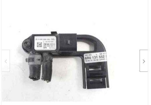

I was given the wrong sensor by the scrapyard I went to, apparently the sensor has a right angle bend so my mechanic says. So I've been on ebay this one is for a CAYA engine code. Mine is CAYC. Anyone know if it will fit please? Many thanks.
 He may be referring to one like that pictured in the below add - listed for an Audi A1. The letter on the end of that one is E but you should be aware that there may be an updated version with a different letter on the end for your car. Unfortunately 7zap is not helpfull in this instance as the engine codes cannot be cross referanced. It may only be a mount at 90 degrees as the connector appears to be in the same location.
059906051c sensor audi a1 1.6 tdi (105 cv) 0 6r0131552e 950555 | eBay
 Just looked deeper and the number on the unit with inlet pipes on if for the pressure switch itself of standard design so it appears that the 90 degree part is  just a bracket - with the attachment of the switch via the screw on the LH end. This would suggest that you need to identify the number on the one fitted to your car, check for revisions/official updates with later suffix letters and buy based on that.
 Once again Winos understanding of wiring may allow an understanding of how the switch works, my theory being that applying pressure on the pre-pdf side would either change resistance across contacts or be a make/break signal.
Edited by KeithCheetham
Wino input may assist
The sensor is like a pair of MAP sensors in a single package, they measure the pressure in the same way and the ECU uses those measurements in an algorithm to determine whether to regen or not.
Rather like a MAP sensor the DPF sensor is incredibly robust and rarely goes wrong, however it is possible that the convoluted pipework can get blocked giving rise to errors, simply use a blowgun to ensure the pipes are clear.
