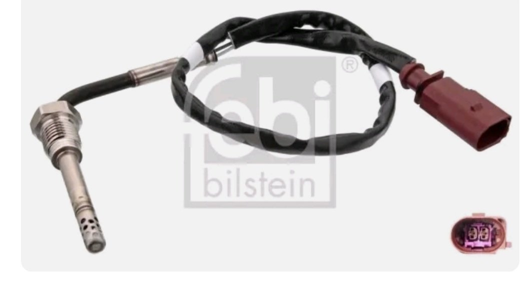

With regards to the original sensor problem, I had an autoelectrician look at it and bring up the codes on his computer. Apparently it's the number 3 sensor DPF temperature sensor that is very similar to the sensor no4 that I have replaced in error. Its before the DPF. I can't find it on ebay and the parts place I have asked I'm apprehensive about as its £80.
If anyone knows what it llooks like that would be great,  he said u need it on the ramp it's a two pronged sensor. I'm wondering if it's the one already posted on this thread? Any help or advice is really appreciated. Thanks

Is this for the DPF temperature sensor? Thanks
I've had a look on eBay, this is a brown end one fitting the description the autoelectrician gave me.
It looks like that yes. And if you look back at some of my posts from our discussion earlier in the thread, you will find a reasonable description of where it is and how to get to it.
It's just a thermocouple in a fancy housing, they're all the same really just with a different plug on the end depending on application.

Hi,
as previously stated this is the part you need, and sorted me out with the sensor 3 issue. the sensor routes to the brown plug which is near the DPF sensor (black plug), disregard that sensor.
https://www.ebay.co.uk/itm/Skoda-Fabia-2-II-5J-Bj-10-1-6TDi-Exhaust-Gas-Temperature-Sensor-03L906088-BK-/165012194277?mkcid=16&mkevt=1&_trksid=p2349624.m46890.l49286&mkrid=710-127635-2958-0
