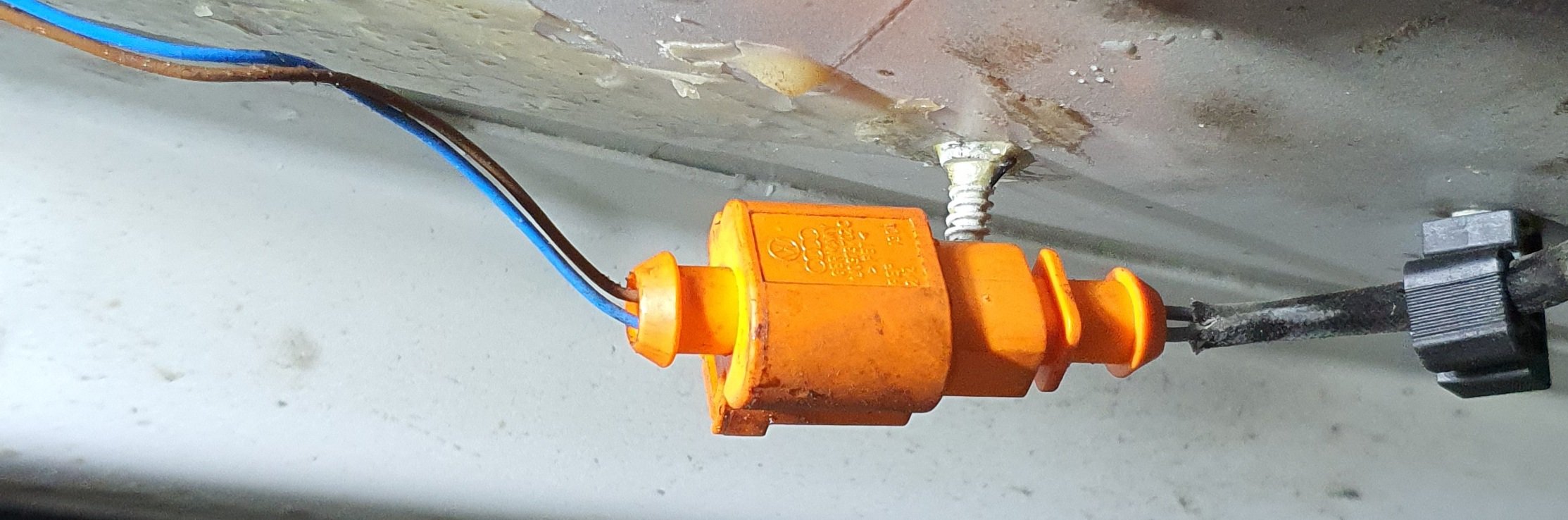

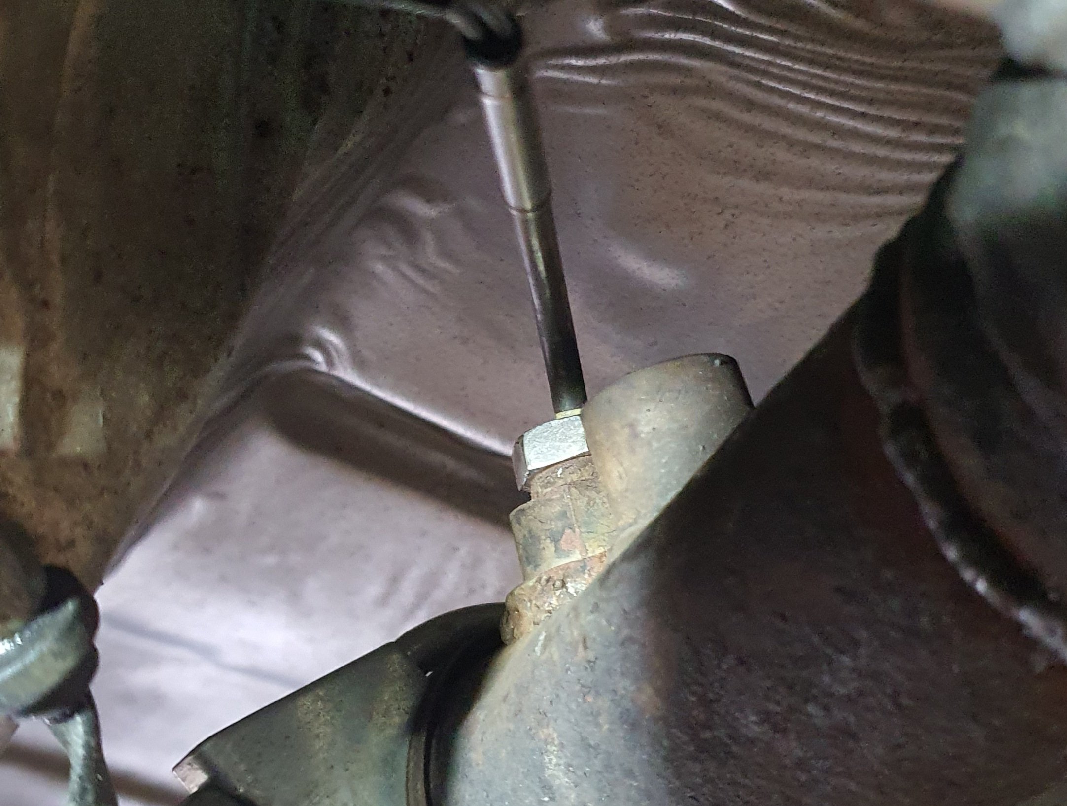

You will need to get underneath, unplug the brown one, find where it’s going to and hey presto, remove the sensor.
As the sensor is broken anyway i would recommend clipping the wire with pliers and getting a 17mm open end ratchet spanner, there is a little bit of sleeve before the sensor, clip the wire right before that unless you have something that can clip through steel/aluminium whatever it is
you will know what i mean when you’re underneath and why i clipped the wiring

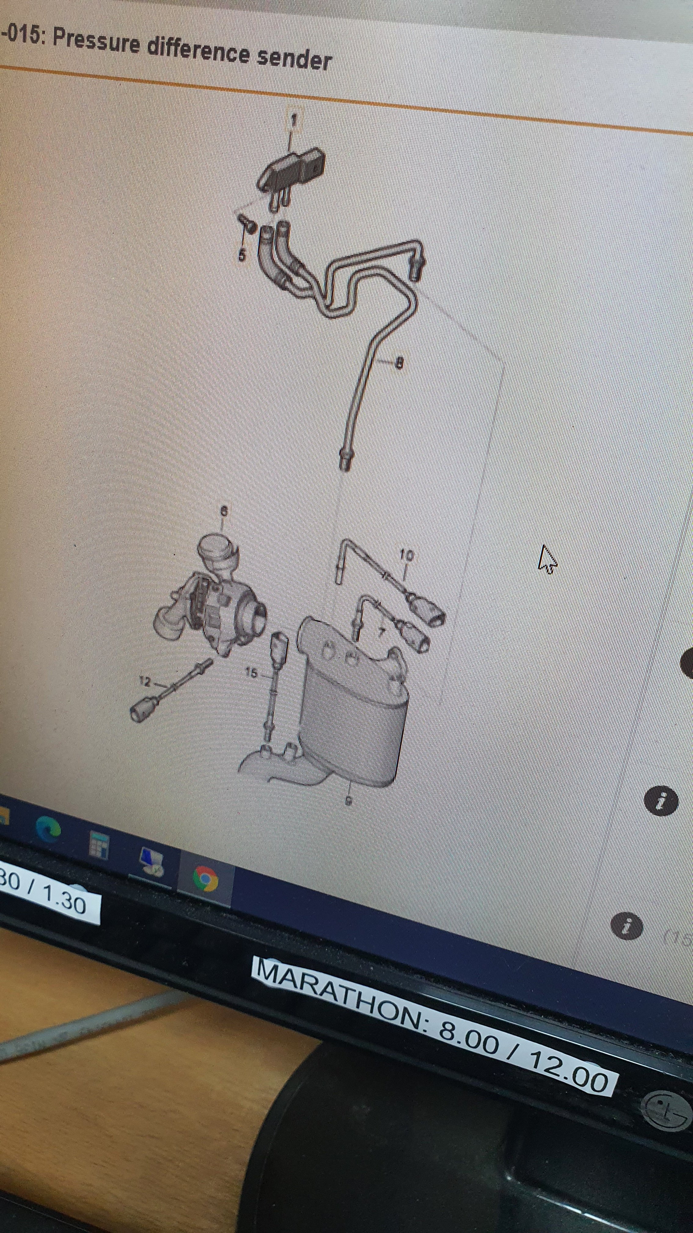

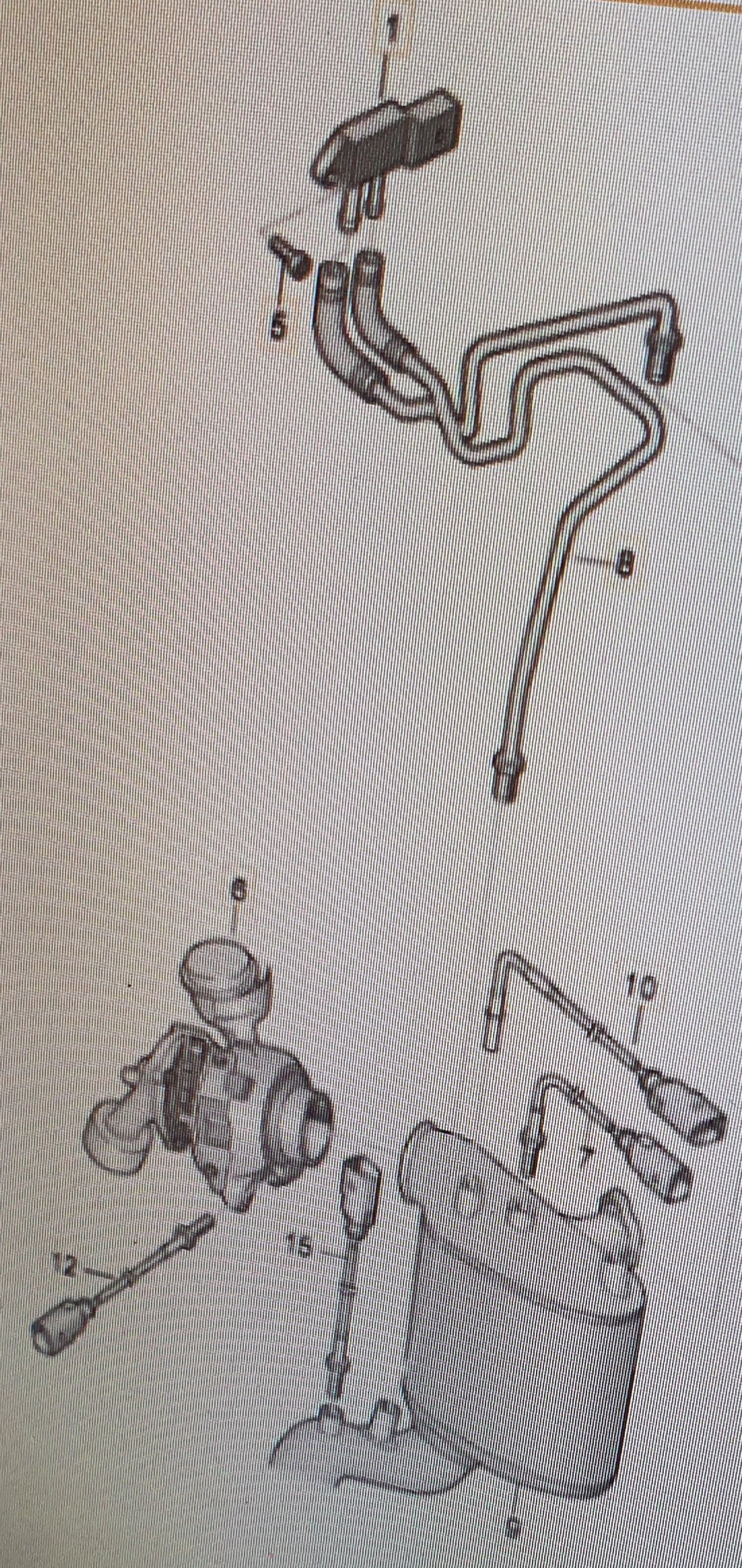

Sonics number 10 on this diagram? Thanks
Hi. I've replaced the brown sensor which is not accessible easily.
I am still getting a yellow light on the dashboard. I attach pictures.
Where does the black plug sensor go? Do i need to replace the orange sensor? There are two slots.
My mechanic has said the diagram showing the DPF doesn't correlate with my engine?
Any help or suggestions are much appreciated.
