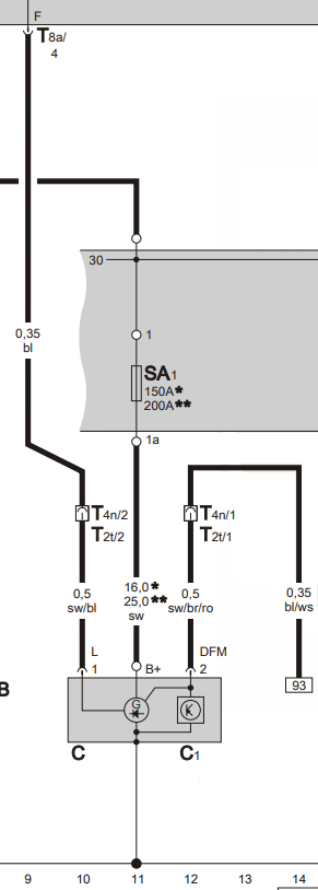

I havent cheked that because i dont know how but , my engine code is this BLS , i dont have the number but i can check and let u know.
  • Sponsor
BLS is enough. I will research the wiring info soon.
  • Sponsor
It looks like you have a black/blue wire coming from pin 1 (L) at the alternator, becoming blue at either a 2-pin or 4-pin connector pair (with/without A/C fitted) and finishing at pin 4 of a black 8-way connector of the onboard power supply control unit in cabin.
Then there's a black/brown/red tri-colour cable from pin 2 (DFM) of alternator connector, becoming blue/white at the 2 or 4 pin connector and going to pin 64 of the 94-way engine ECU connector (on a different page, box 93 tells you where to go).
