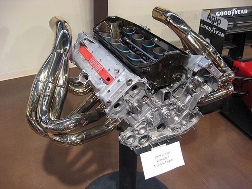

Take a look at this F1 V10 no cat no nothing just properly tuned exhaust runners.
