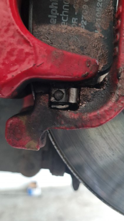

I own a 2013 vrs octavia..... last week replaced original rear trw/vag pads and discs with new delphi discs and pads.  I also have the same annoying clicking, so my supplier sent a replacement set of delphi pads, didn't even bother fitting as the measure the same, so ordered some Brembo guess what they are the same. There is a lot of space between the lugs. The pads float up and down causing them to click mainly when you reverse, stop, drive forward it stop. If driving forward all the time they don't click. The moral of the story is I think it needs dealer pads, or TRW which are factory fit........I would never use eichers or any other cheap pads like brakefit. I always trade my reputation on using quality parts, ferodo, apex, delphi, trw, brembo etc. Or dealer bits. I am awaiting my supplier getting me some TRW pads. Makes it worse its my car.
Simon, from Appley Bridge Diagnostics Ltd
Simon, thanks for taking the time to reply, and after all of this I think you're right, dealer or TRW pads would have probably resolved the issue. I was surprised the brembos had the same problem, but after a few thousand miles it's eased a little, probably due to a bit of brake dust build up.
What you've shown in the picture is exactly the problem I was having with mine.
Hopefully this thread helps others if they have the same issue with poor fitting pads.
Thanks again!

So the saga continues....TPS just delivered some rear pads and guess what they are exactly the same as both the delphi and brembo ones.....stamped TRW VAG....I give up what if this was a customers car....what a headache. As a mechanical engineer pads should not have this amount of movement in them....
The photo shows that you are using the wrong pads. The rear brake pads on the Octavia MK3 VRS don't look like that.
Here's some photos of what they do look like.
