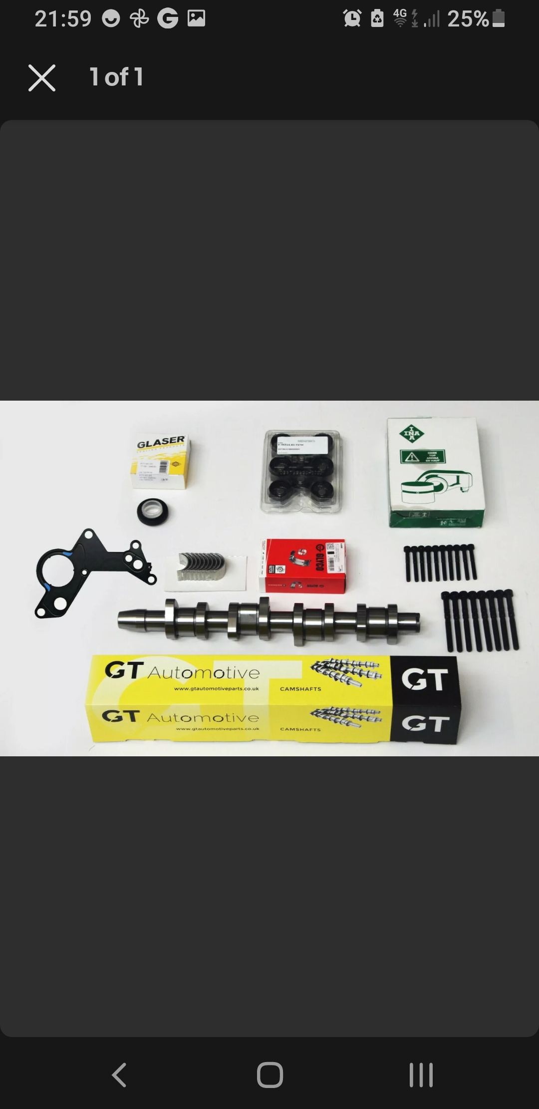

Camshaft removal
Full details how to change a mark 1 fabia vrs camshaft
Please help lol

The video wino provided will show you what needs to be done, its a good video, it shows what he calls the 'advance method' which means you don't have to take the tandem pump off.
You of course need to re-time the engine so you will need the locking pins etc to do it properly, also a puller to get the cam sprocket off.
Check the rocker shaft to make sure the oil gallery plugs are still in place, if they are missing you lose oil pressure to the top of the engine which cause wear on the camshaft/followers.
If you feel confident give it a go, I would plan on 6-8 hours to get it done if you have never replaced one before.

I understand and I'm sorry you're having a tough time, I wasn't trying to be rough but replacing the cam is a big job and you'll need some special tools to lock it all up.
You also need to worry about why the cam needs replacing, it's usually down to the wrong oil used in an oil change, first thing you need to do is see how much metal glitter there is in the sump, if a lot comes out with the oil then you might be better off just swapping out the whole engine.
