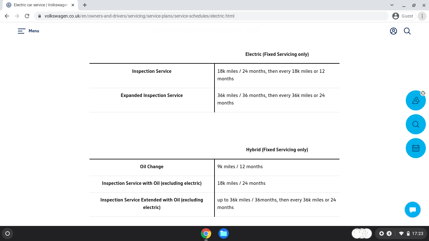

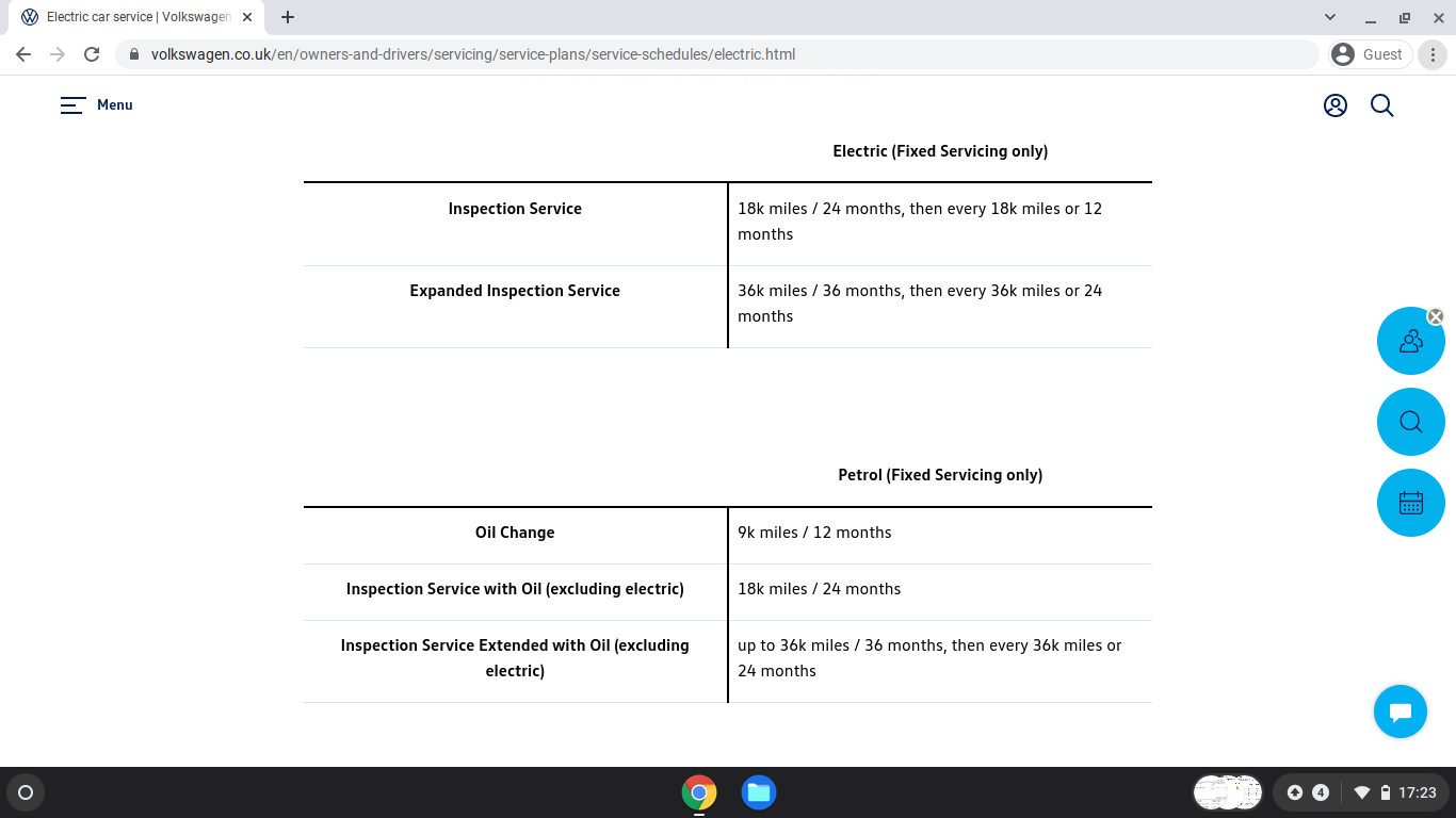

This is from VW UK Servicing site.
BEV Servicing regime.

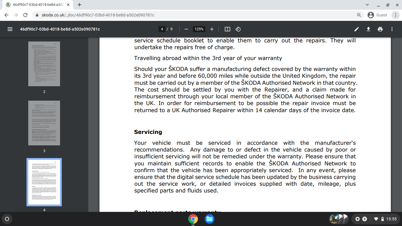

Does the Warranty read the same as for other Skoda Models?
SKODA_Warranty_Terms_November_2021.pdf

Vw quote first service for their EVs due at 24 months or 20,000 miles then every year or 20,000 miles. Lots of cable checks apparently and they will check the charge on your battery and top it up if necessary.

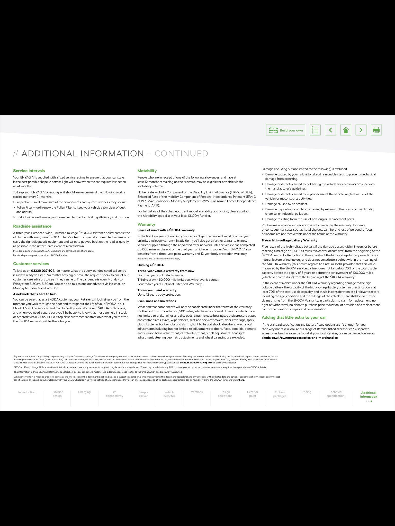

The Enyaq brochure states service required every 2 years, with no mileage quoted.
My interpretation of the brochure is that every 2 years they will inspect it, change the brake fluid and the pollen filter.
