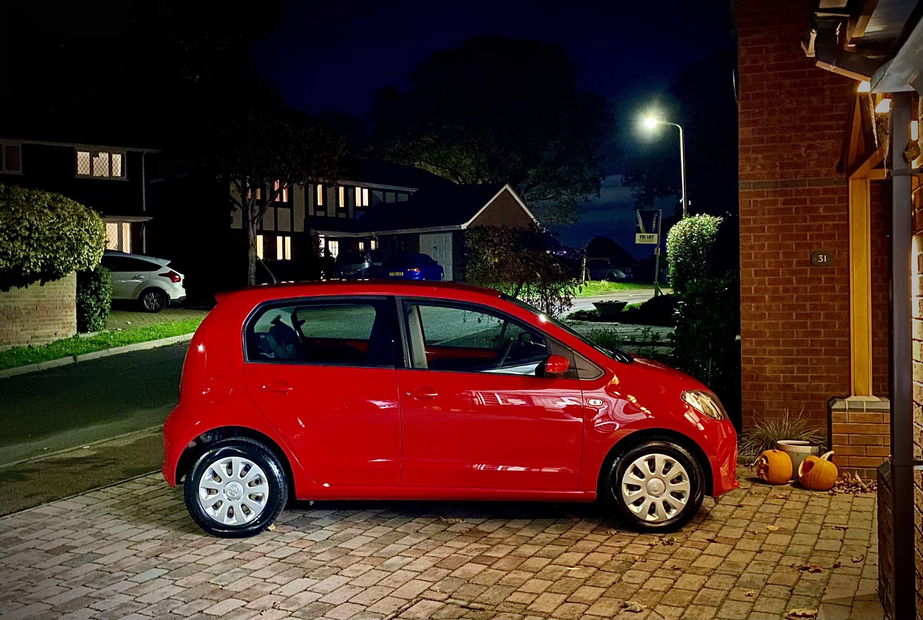

Anyway................had the CrossClimate+ tyres fitted today, all good so far, they seem to install more confidence than the cheapo tyres that were on it before.   Suspect once they are scrubbed in they will be way better in cold / wet / damp / wintry conditions.
