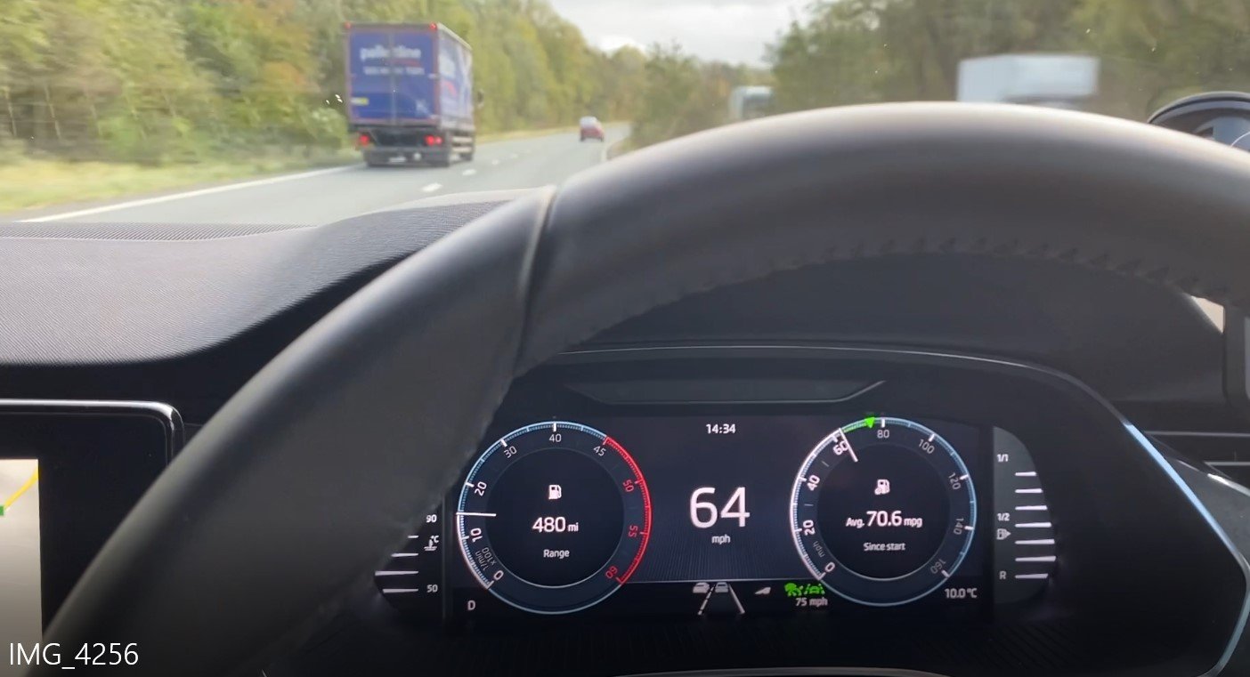

Hi, just seeing if anyone else has suffered this with their ACC, when ACC on and on dual carriageway or motorway. My car brakes when it detects a car on the inside lane to me. This is really annoying and dangerous because it does it quite aggressively if it picks the car or lorry up late. The car knows it’s not in my lane as the ACC shows it on the left lane next to me but immediately uses that car (highlights it white and the car in my lane it was tracking goes grey). If I touch the throttle, it immediately drops that car and tracks the car in my lane and accelerates again. I have to do this quite a lot so the ACC is virtually useless as my car is a danger to anyone following especially if the road ahead is clear and my car slams the brakes on (I got flashed twice on the M3 today) they think I am brake testing them!
I have the car booked in next week but not happy with this. I cant find any way to change the side of driving the car thinks (i.e. left hand or Right hand) I have an SE L without Matrix headlights so no settings there…..
Any ideas would be helpful as Skoda were confused and seemed to know nothing about this. I have had exactly the same ACC in my last Golf R and it worked perfectly so I know how it should work!!
