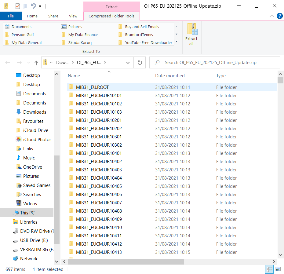

  • Hi Chris , I copied everything that was there after I unzipped it, using "7 Zip", just checked and yes "Package.SList" is there..   I went from 19.11 to 21.7 on mapping
  • Thanks for the tip on Edge. Google Chrome just does nothing at all and does not even report the file as unsafe. I will download and try the suggestions offered here. Thanks for the detail! B

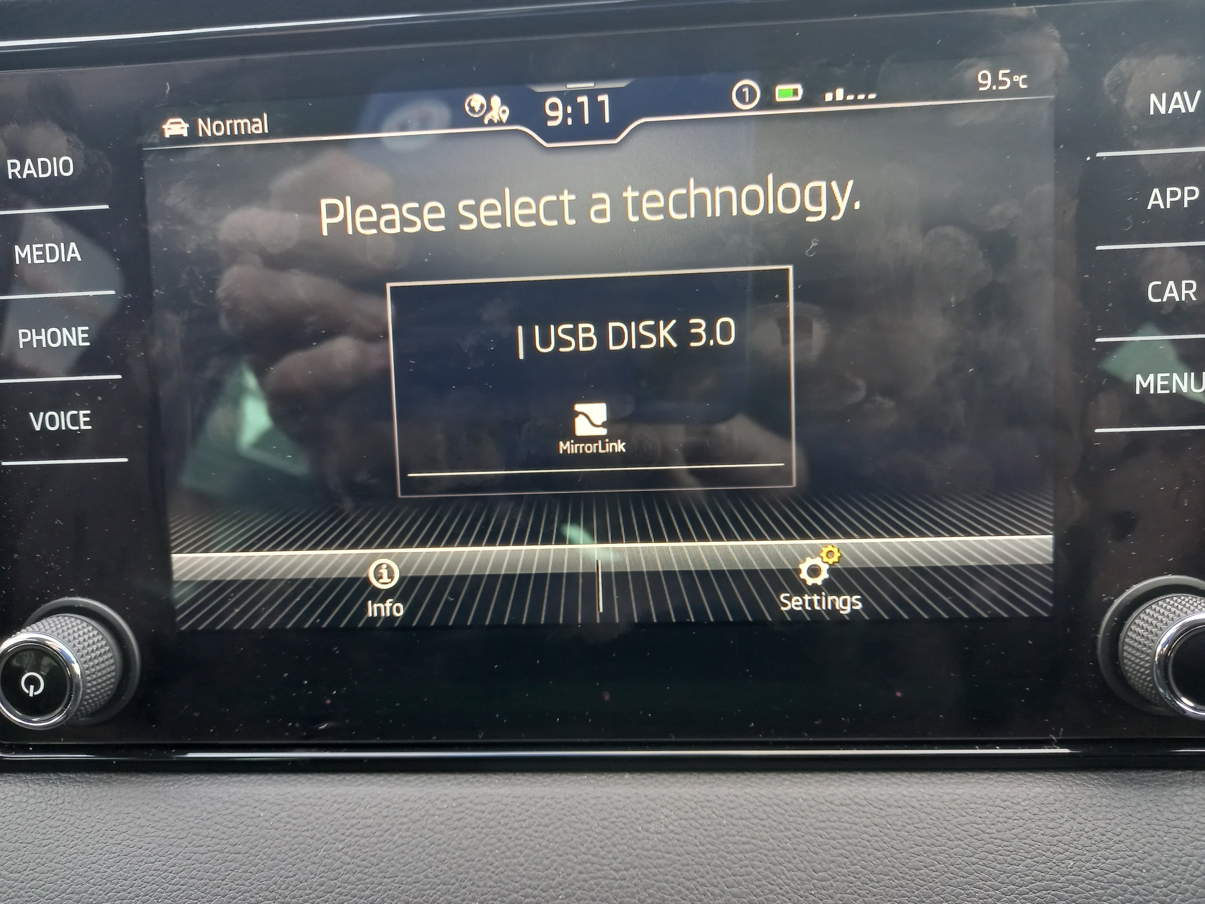

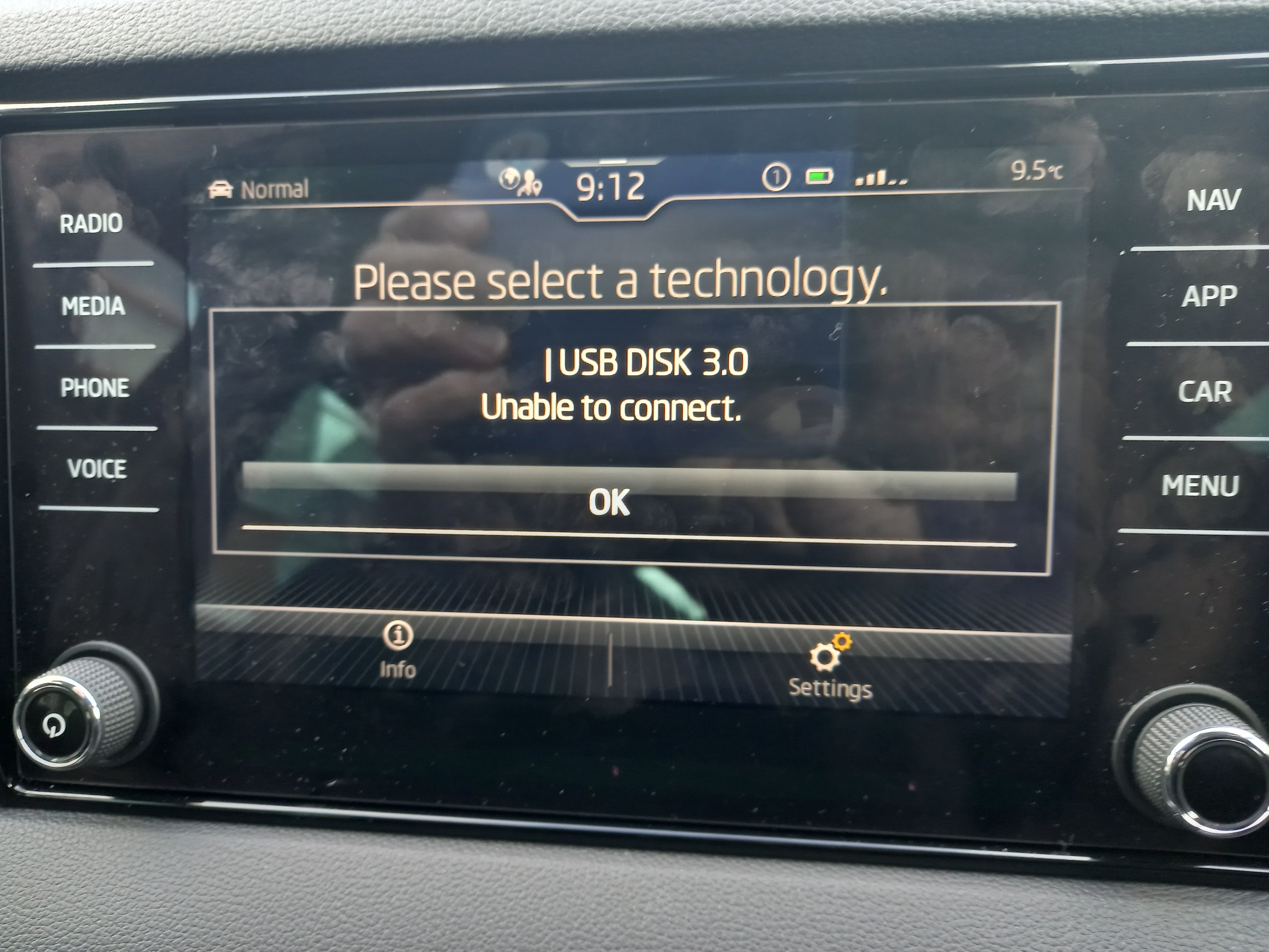

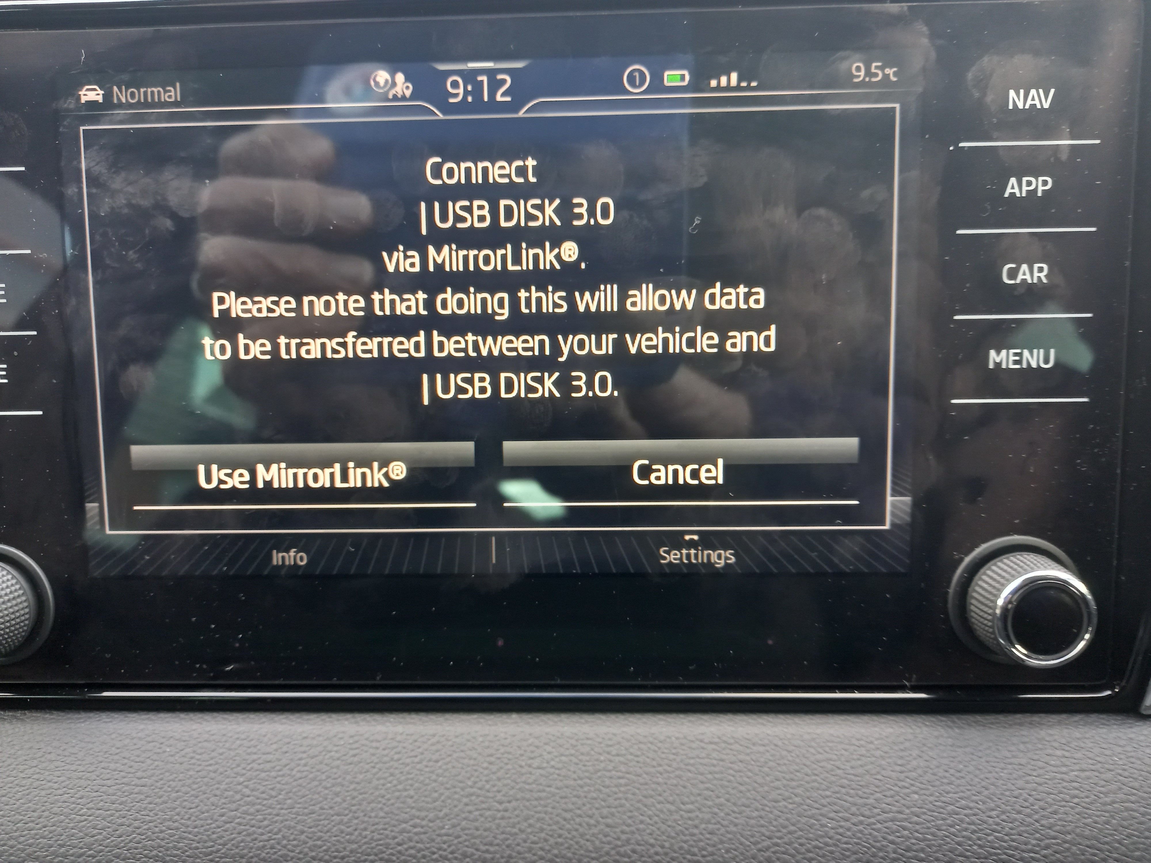

I have been updating the navigation maps using the download file on the portal.
My USB-C stick has been plugged in for several weeks and so far the maps have been updated from 19.11 to 21.7, which has been the case for more than a week.
It is stuck on 21.7.
The car was serviced a few days ago and the software was updated to 0276 and it had an infotainment update too.
I don't know when the map update stuck on 21.7, but I can see that the memory stick is not being connected to - see images.
I have rebooted the infotainment, reformatted disk and reloaded files.

Re the map update - yes, copy/paste the files to your USB stick, put it in your vehicle, leave it there and activate Navigation when driving (even if you don't need it for route guidance).
The update files you have will take you to 21.7 - as they did for me (see previous posts).
