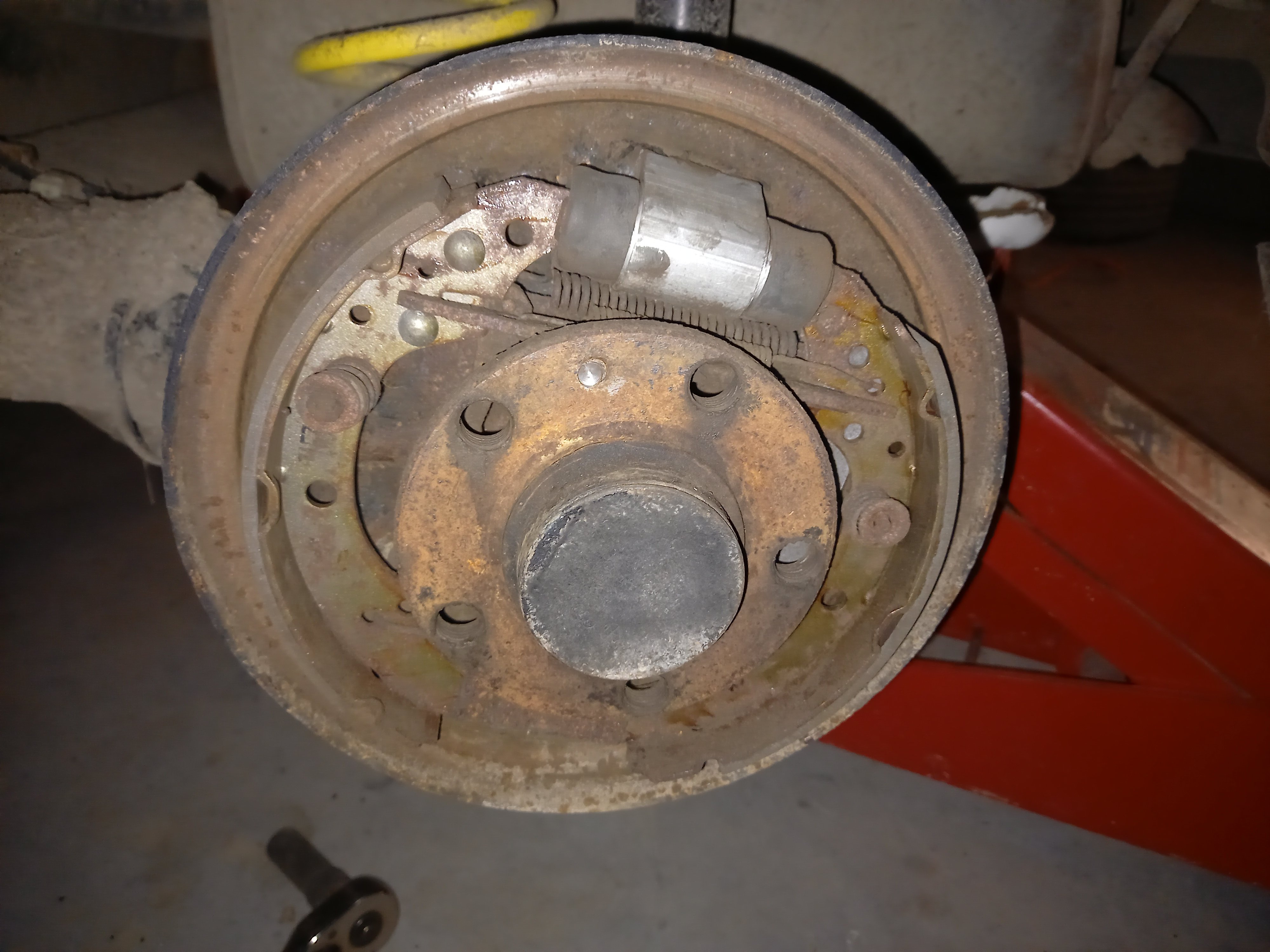

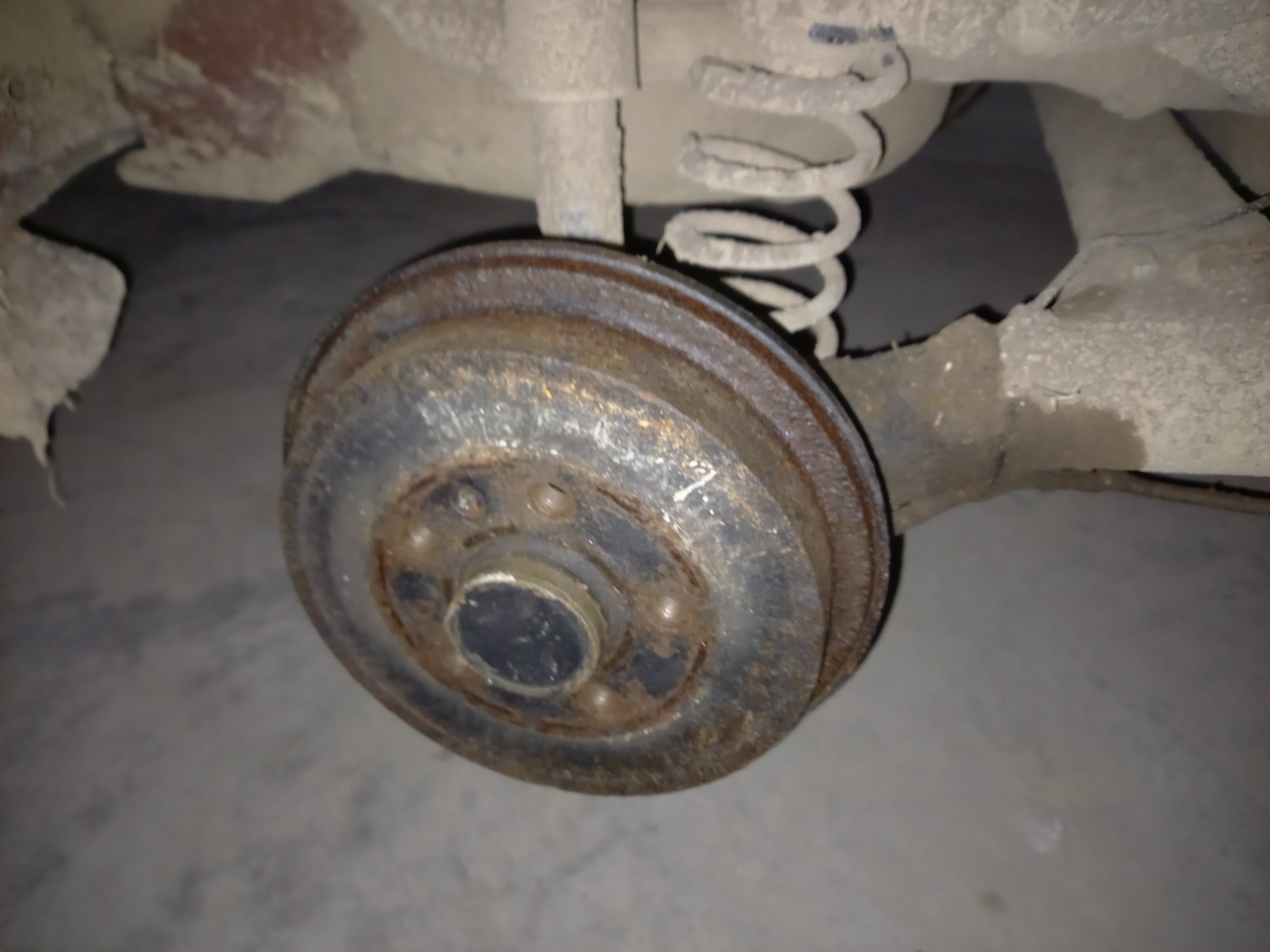

Found some pics of the rear drums on my phone. Hard to see but the screw is pretty chewed.20210315_201758.thumb.jpg.9574475a5323036bce07c153e7006ede.jpg
Just drill the screw head, then knock the drum off.
You're making it much harder than it really is.
The drill might take a few goes until it wears down the torx "teeth" to make a nice round hole. Should get easier after that.

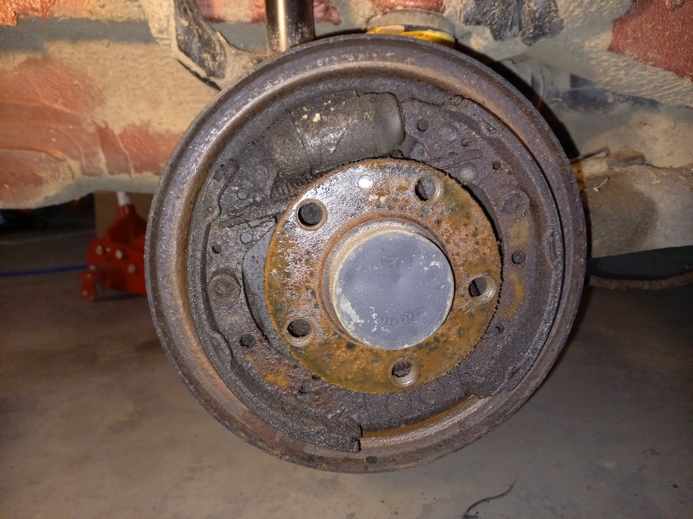

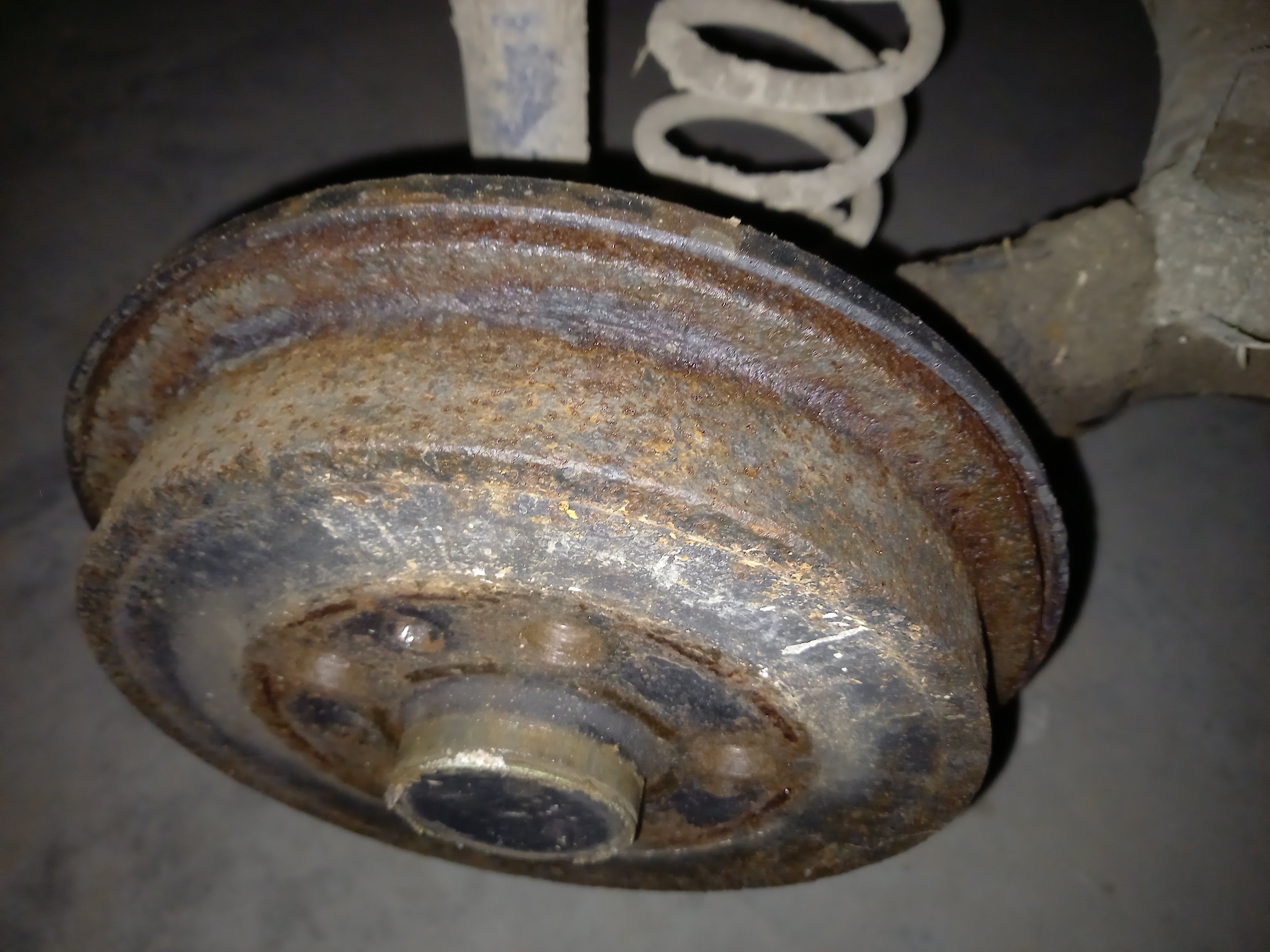

Other side isnt wanting to come off, it feels like the brakes are contacting the drum even though the handbrakes slacked off, it'll come loose sooner or later.

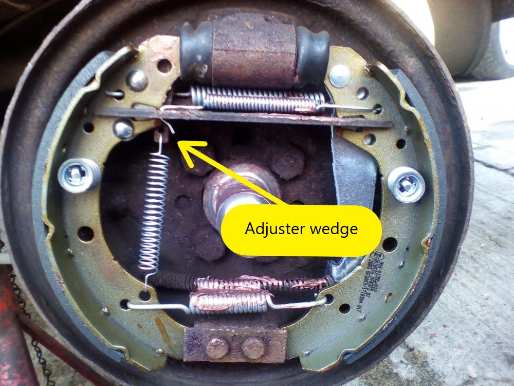

Do those drums have the adjuster wedge or have they got the more usual winder rods?
Either way, you'll be able to stick a flat screwdriver in through the wheel bolt holes and pop the wedge out or wind off the shoes. If it's a winder adjuster, it will be quite fiddly but if you have someone or something push the brake pedal, it will make it a little easier.
 These have the wedges for the adjusters. Is there any freedom of rotation before you try to pull the drum off, if there is it may just be a build up of rust or increase of the bore due to wear which, due to the shoes being narrower than the drum, leaves a lip at the edge. What may be happening is that the handbrake actuating arm can rust on its pivot which is part of the brake shoe. This component can be partially seen in the above photo between the shoe retaining spring at 9 o'clock and the hub. While you may release the handbrake this component never really releases the drum which you will identify by the drum being tight to rotate. Hammering the drum at 12, 3, 6 and 9 o'clock and on the face may assist otherwise it may just be a case of levering the drum off.
 The fact that the shoe in the photo is nearly worn out at the 10 o'clock position suggests while the rest and the other shoe are good, either seized piston at the 1 o'clock position or seized brake actuator arm,

Additional data
They use a wedge.

Got the other side off in the end, just a bit more fiddly.
Cleaned both sides up but looks like these shoes are contaminated with brake fluid so I'll need to get different shoes atleast.
^ That wheel cylinder is leaking and needs replacing.
