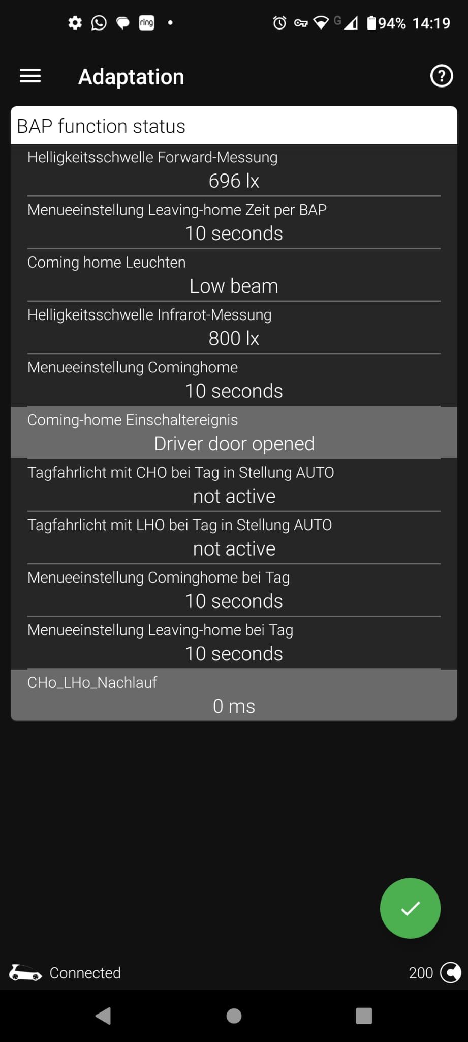

Was du eigentlich meinst, ist, dass diese Optionen nach deiner eigenen Überprüfung in dem von dir angegebenen Abschnitt einfach nicht vorhanden sind. Sei ehrlich, Alter. Wir alle machen Fehler, nicht wahr?
Weißt du was? Ich beweise es dir, Bruder:

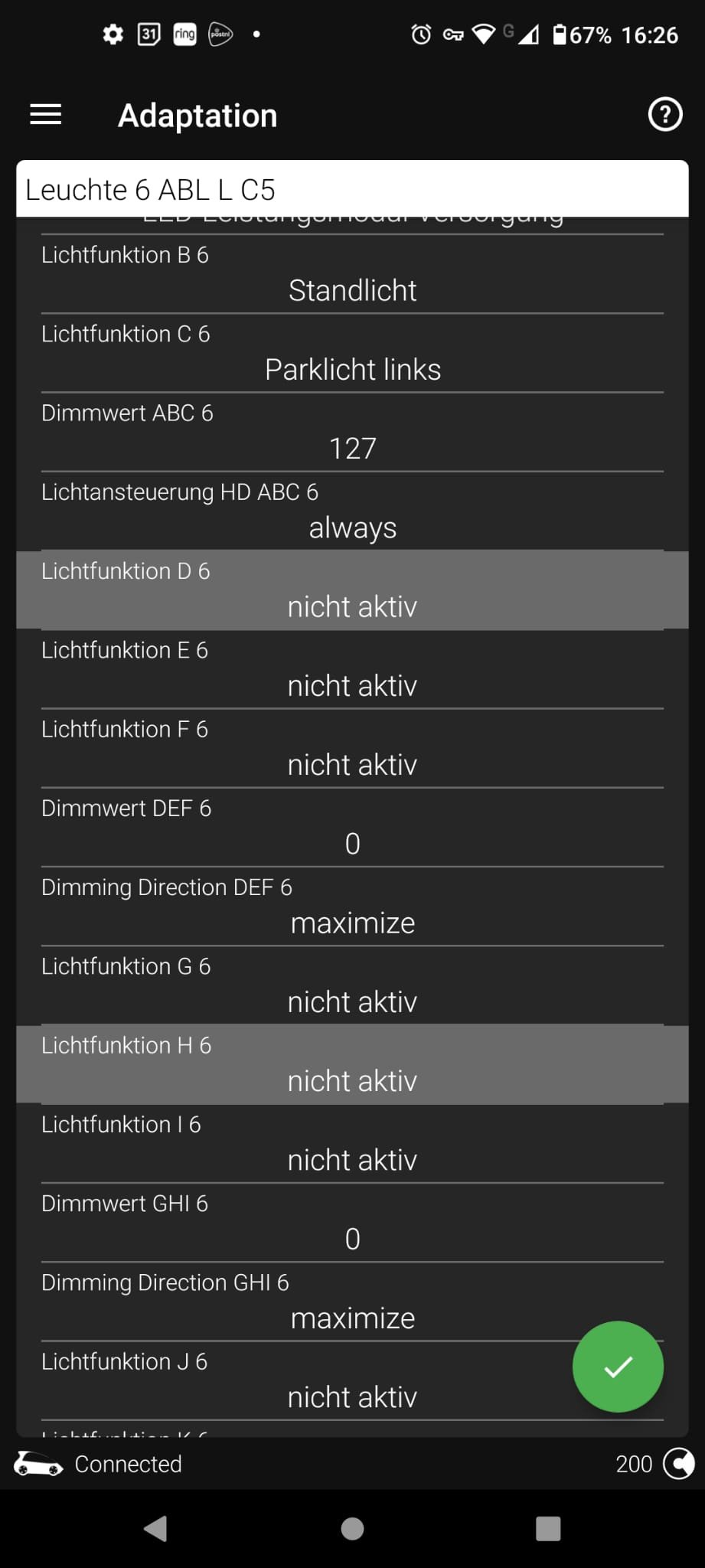

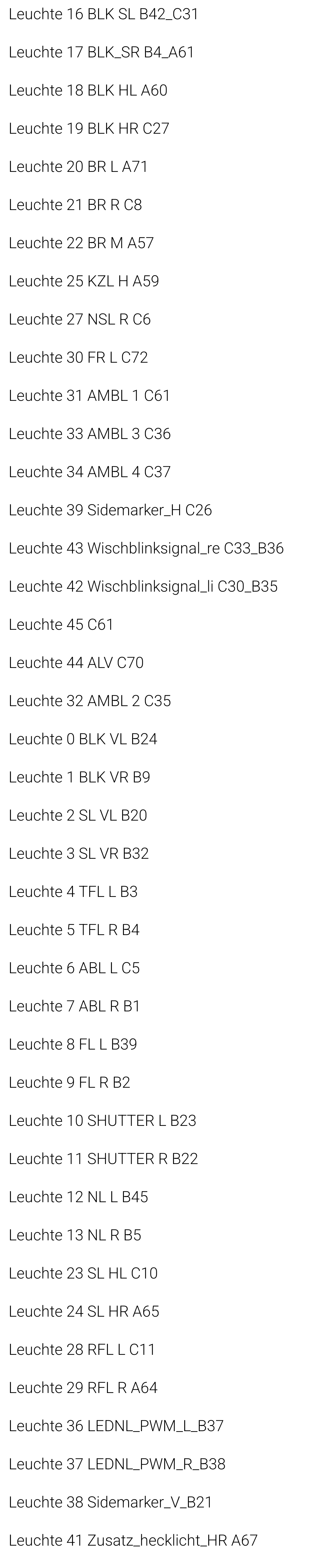

Of course it is obviously clear for you which of these are the two to make changes, to me (and for sure for many others as well) it is not so clear... Depicted options are in German language with unclear abbreviations...

If I interpret the document correctly, these two lamps are under discussion for the 'coming / leaving home' scenario:
Question remains: How to link these lights to the 'coming home' feature? I mean, supposedly (I did not try) I can switch them OFF, but this should only be activated to OFF in the case for the 'coming / leaving home' scenario? Can you please explain or at least provide a hint where exactly to set this to 'inactive' only for the 'coming / leaving home' feature?
Is Lichtfunktion B6 or C6 the one to change or? (since the rest are factory set to 'inactive')
Chanel 5&6 is it not the only one, or are only the lights going on at the front for you?
I would like only to have the front Fog Lights and rear lights to be enabled for Coming / Leaving Home functionality. Unfortunately, both the front headlights / beams are activated as well.
This is what I would like to have:
