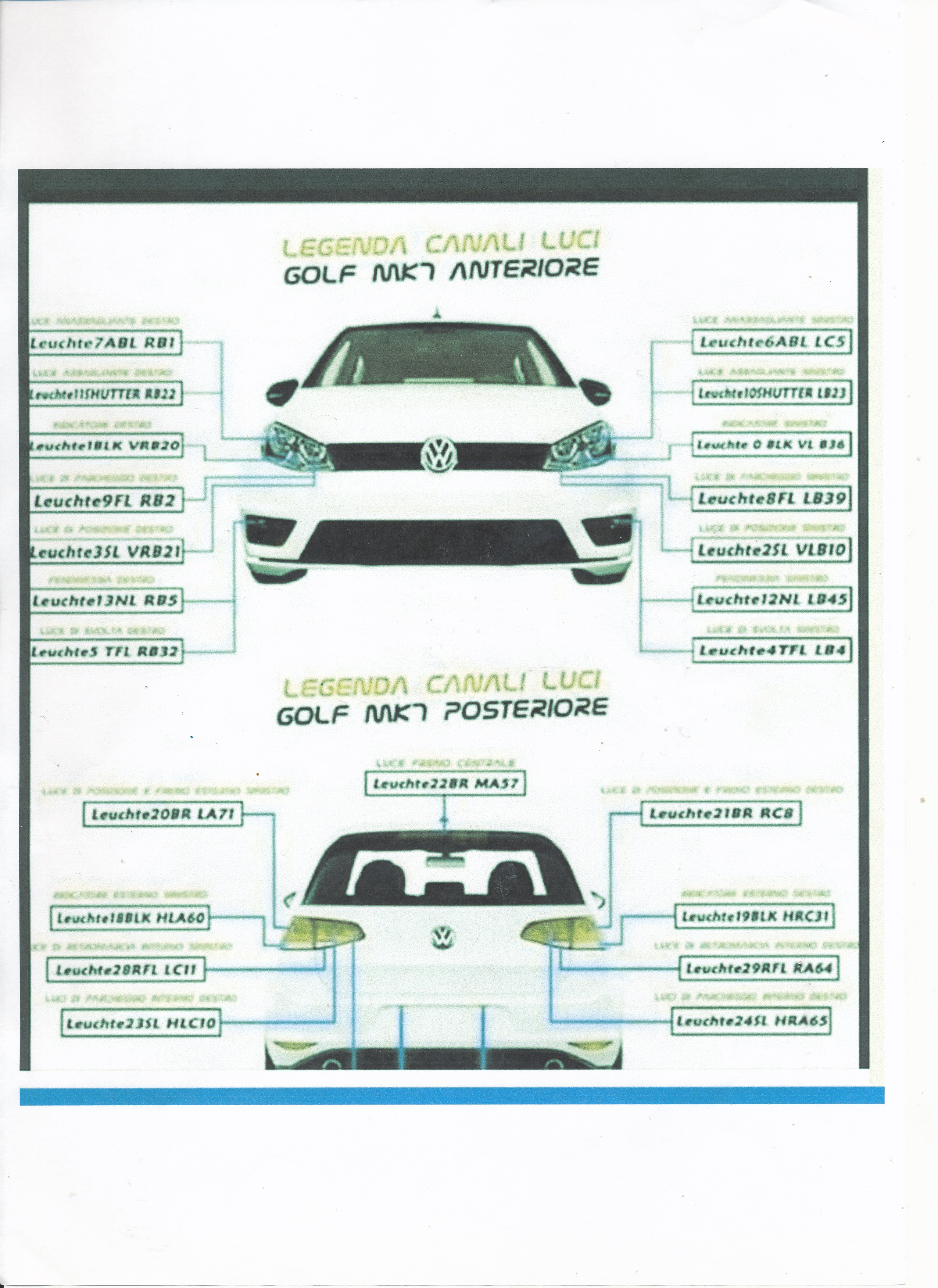

Dont know if this will help but it might as has all the different lights named The same names should apply to the same type on other models Not a very good scan Im sorry but cant find where I got iPet scan.jpgt from to redo it
Thanks for this overview, very handy!
