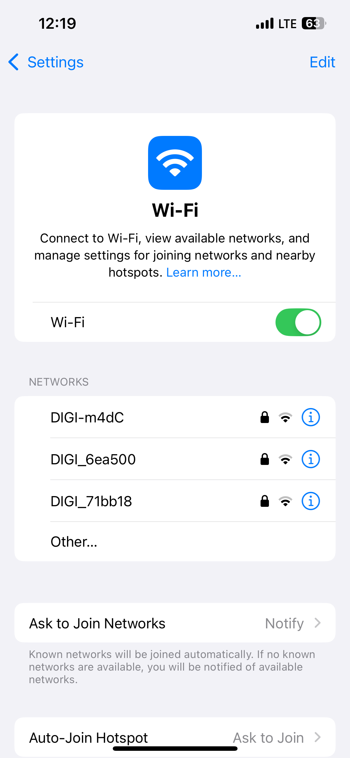

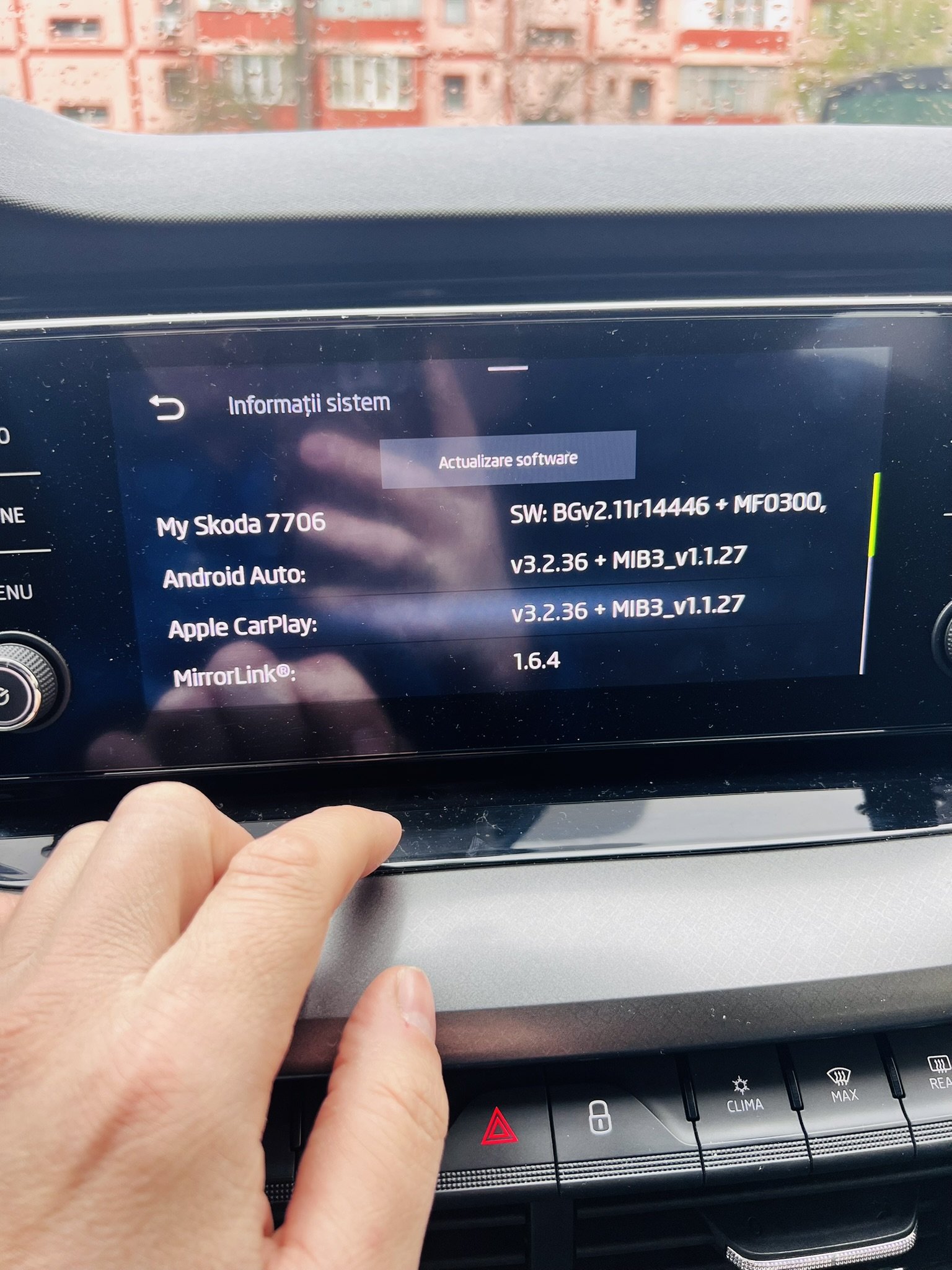

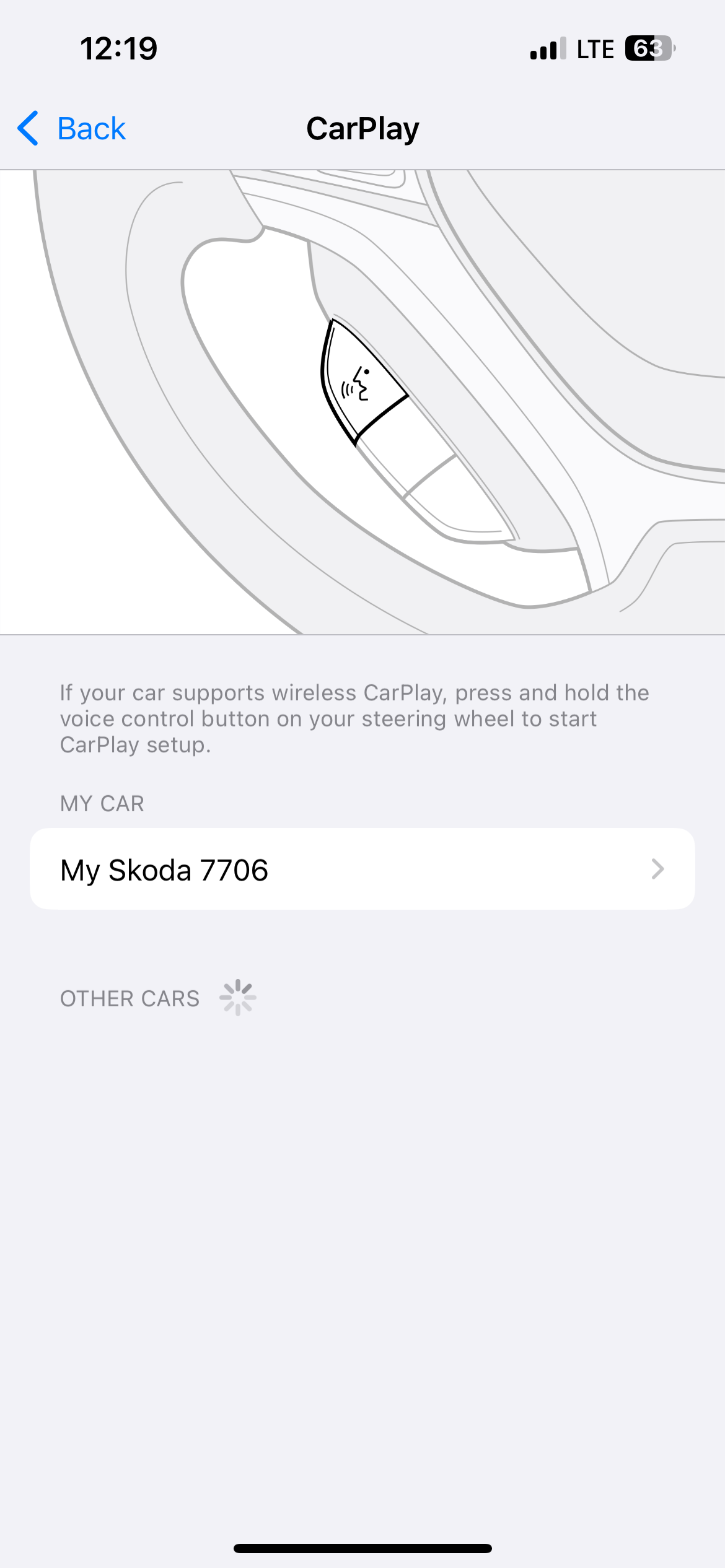

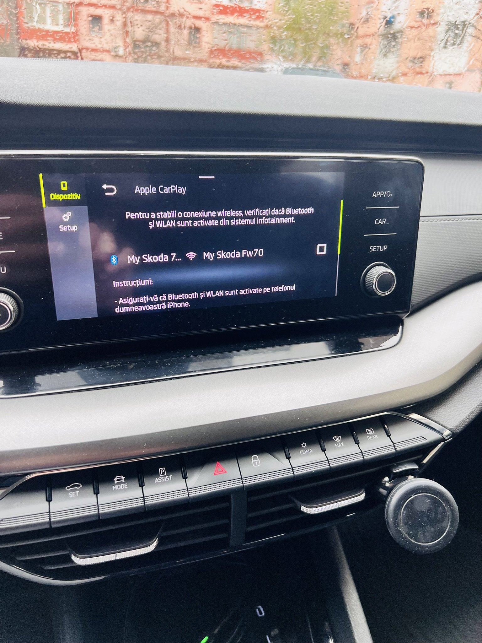

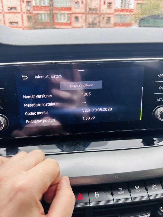

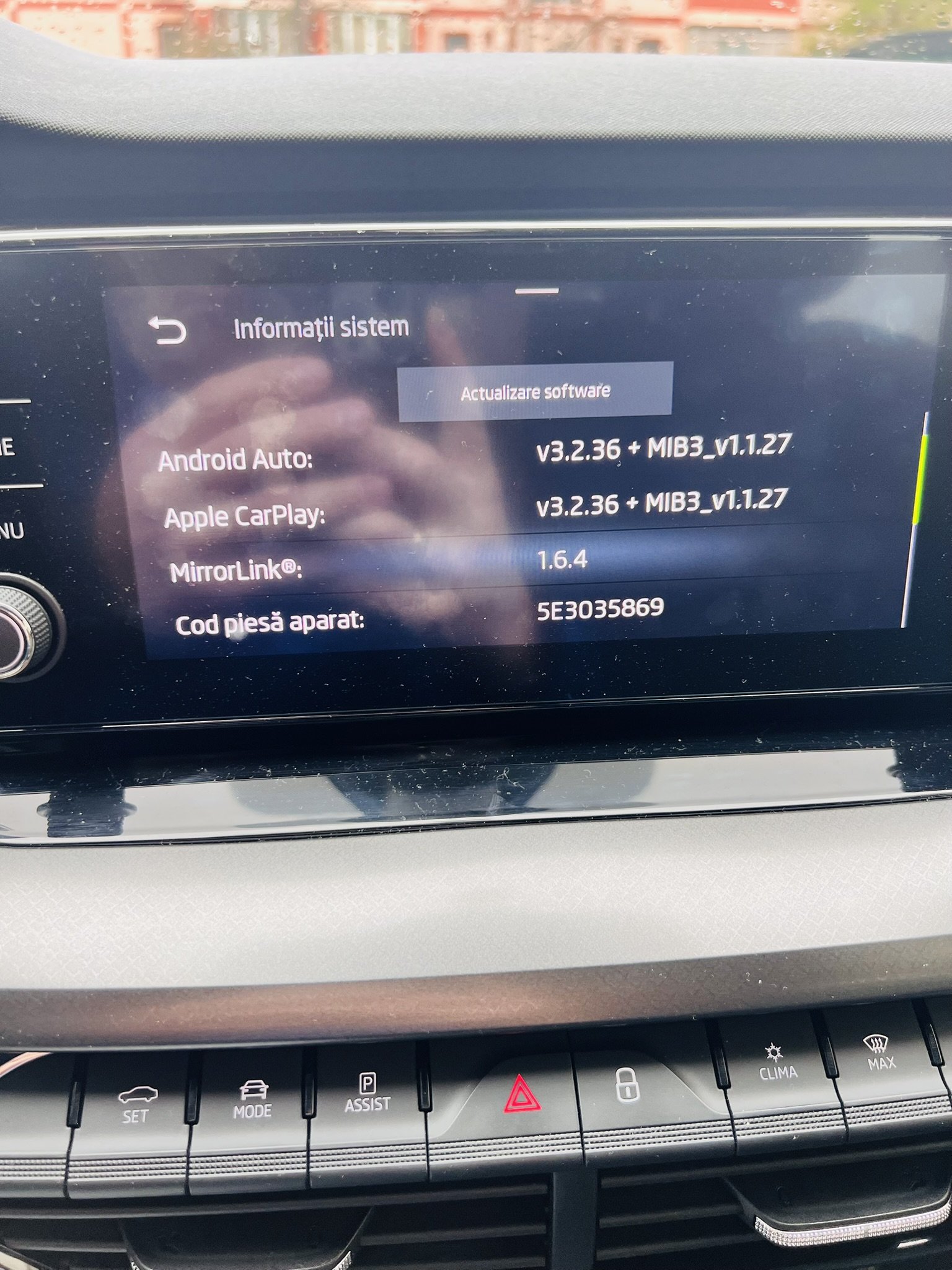

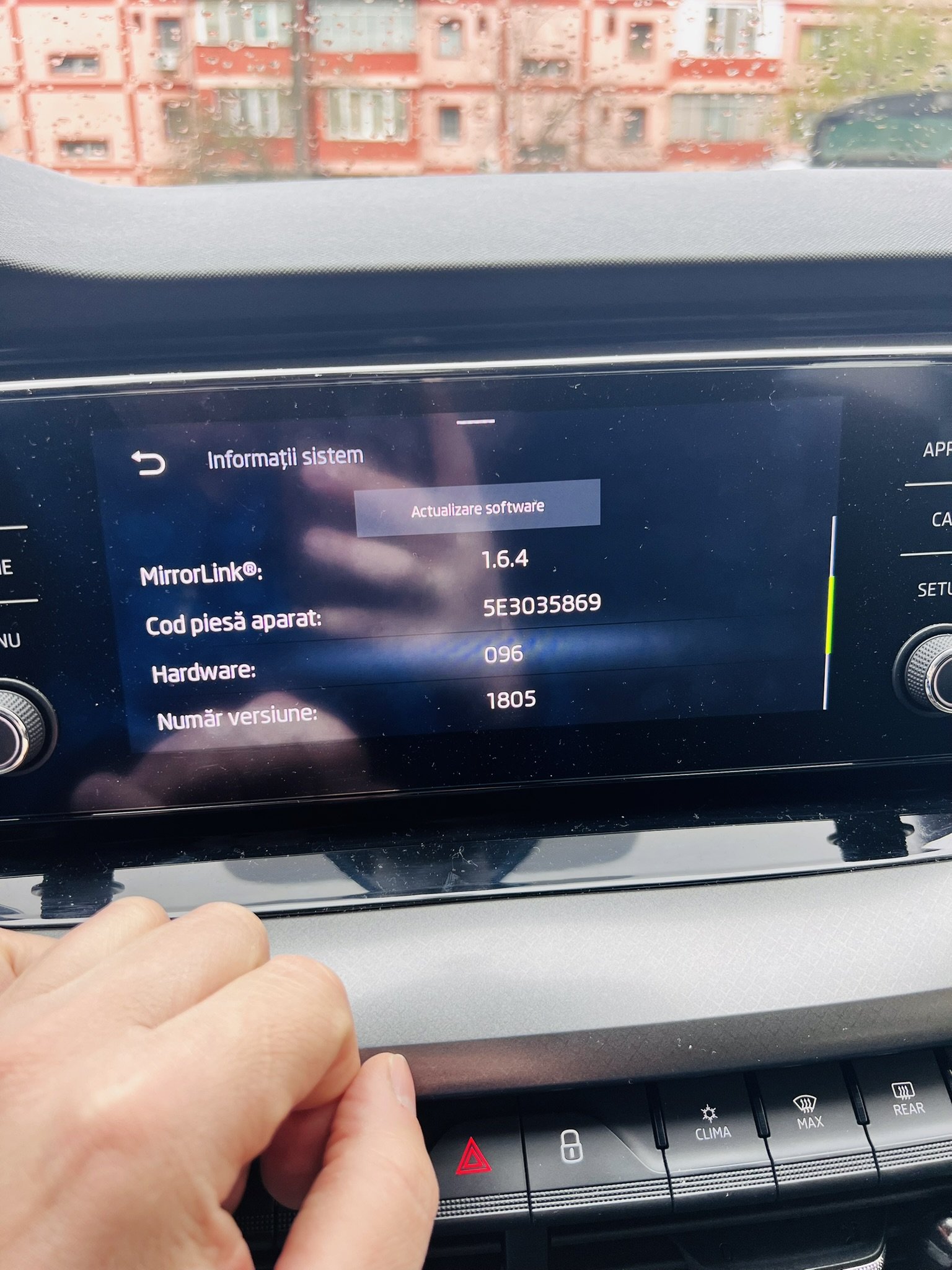

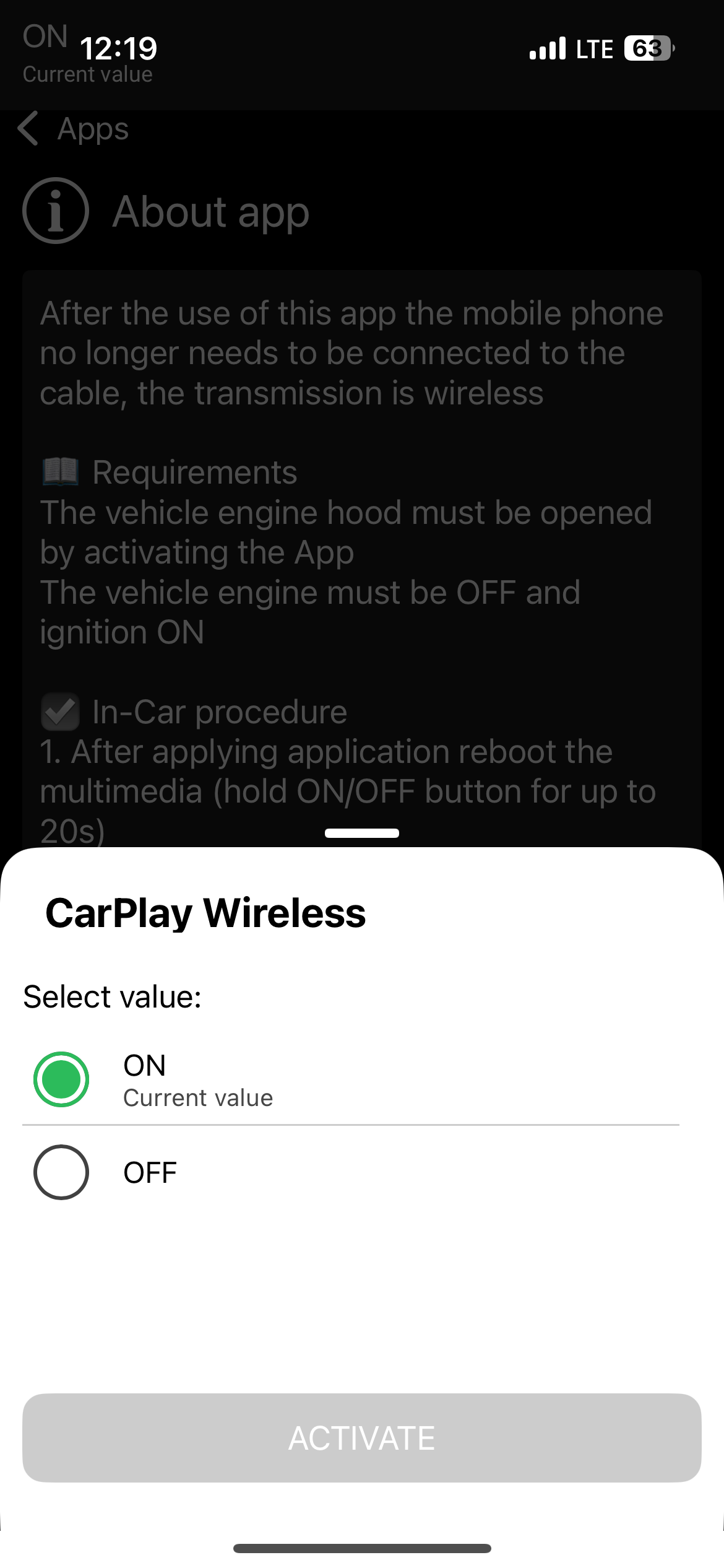

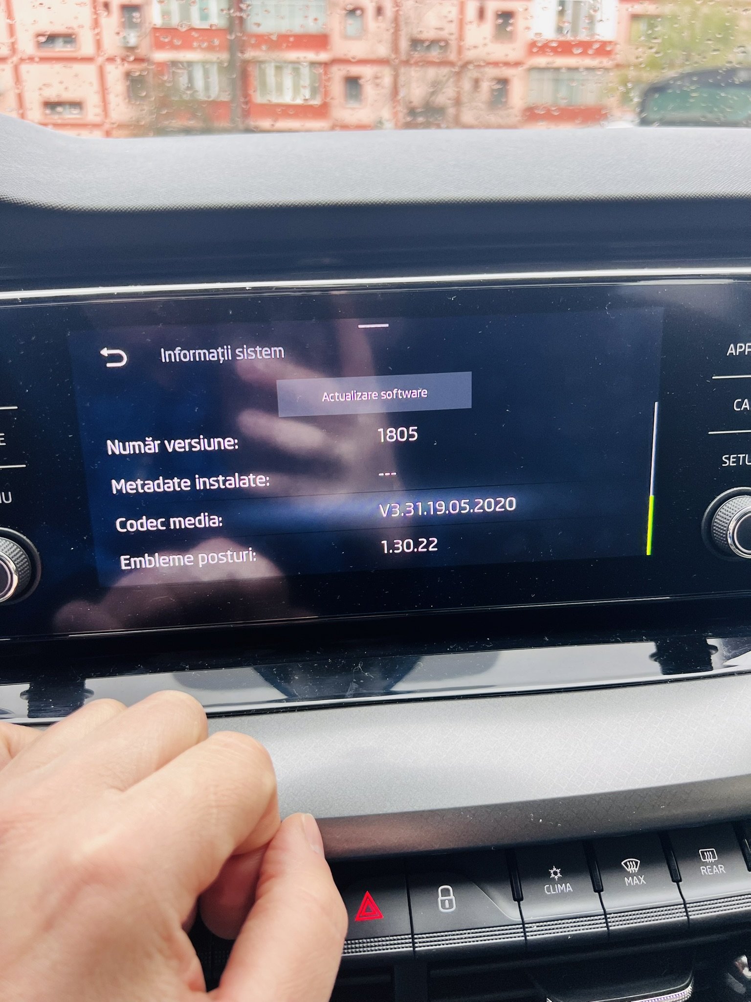

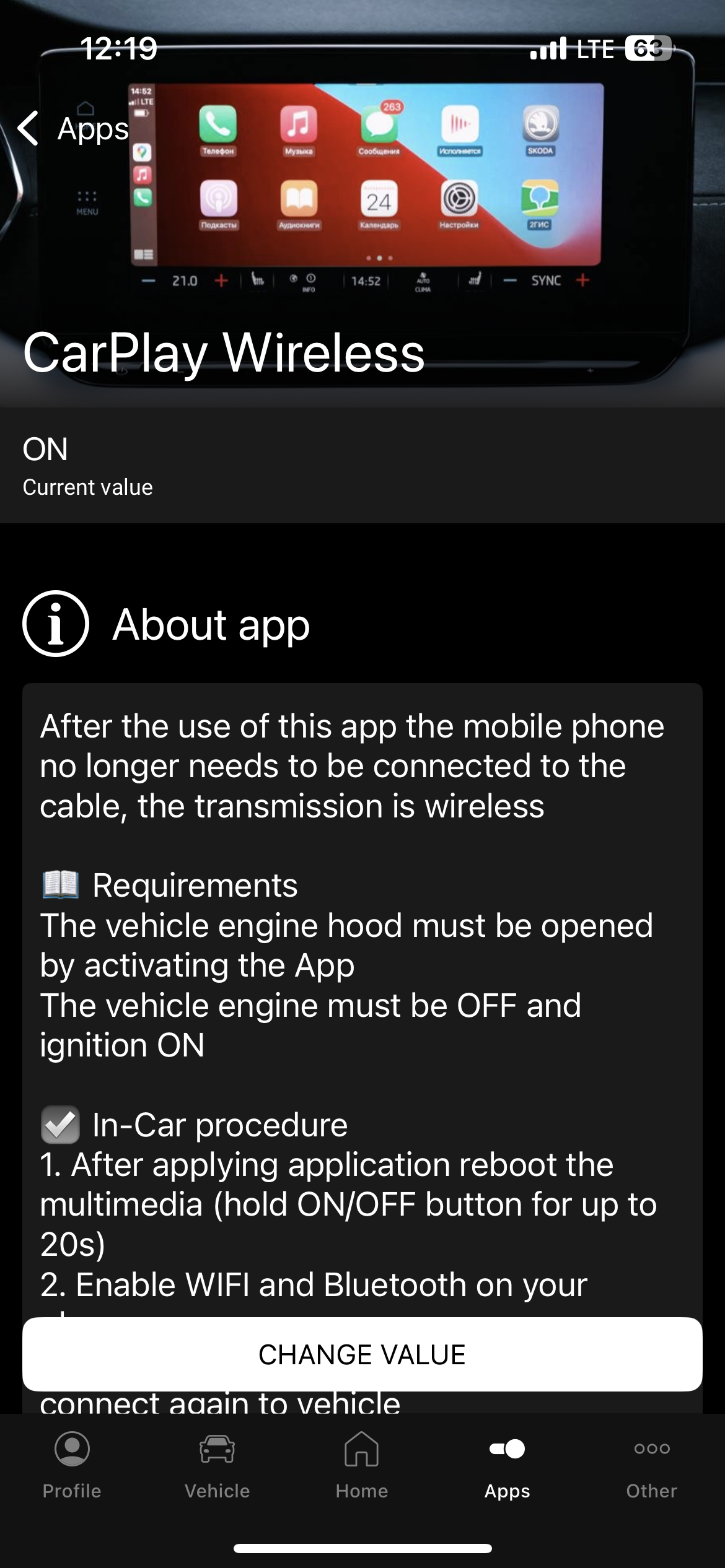

Hello,
Just received OBDeleven ultimate pack and tried to activate a few things on my Skoda O4 2020, unfortunately without result:
  1. CarPlay activation without cable is not working; it is working with cable but via WIFI, not... I have activated thru OBD, can you please give me some support?
  2. Cornering I have turned on but when I try to see if is working, without moving the car, nothing happens. :-( I have also activated fog with high beams. Does this impact somehow cornerring?
    I have attached few pictures.
    IMG_6375.JPEGIMG_6376.JPEGIMG_6377.JPEGIMG_6378.JPEGIMG_6380.PNGIMG_6381.PNGIMG_6382.JPEGIMG_6383.PNGIMG_6384.PNG

this is for Carplay or cornering?

Do you have a Swing radio?
1 hour ago, manuelin said:
it works for you?
Does not work, I have Swing radio as you can see in the pictures.
I saw in your pictures the part number, and I was looking your swing radio have BT and WIFI, so is 100% compatible... in my case, my swing radio just have BT.
Actually, you show a picture (last radio menu) with wifi connection to CarPlay, so I guess is working
unfortunately, it is not working; when try to connect, the phone does not see the wifi of the unit and when try to activate the wifi on it ... the tick box does not work :-(

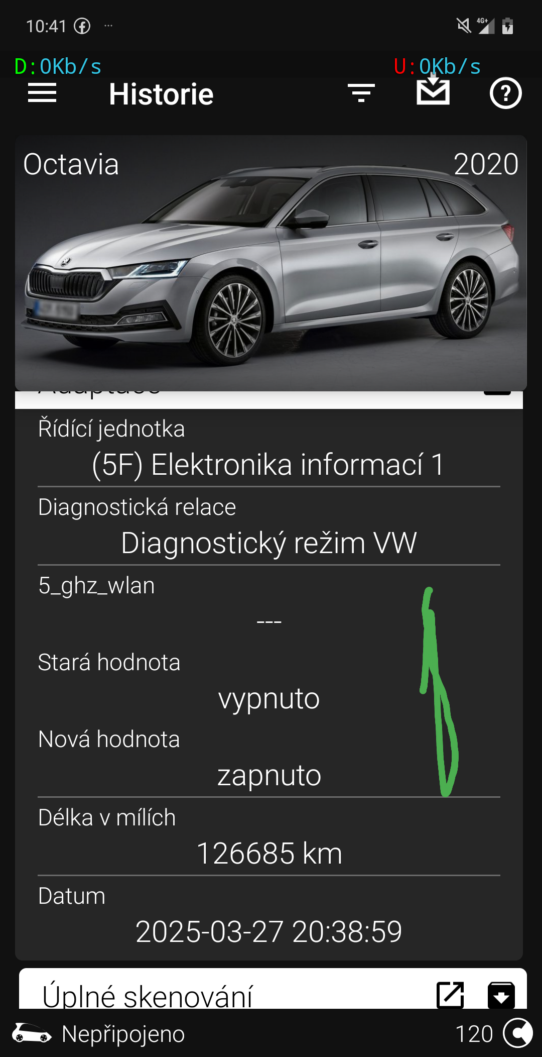

This option helped to activate wifi for android car wirelessly
