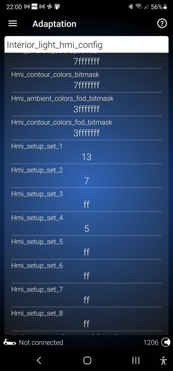

activate additional ambient light colours
open the bonnet
09 central electrics - adaptations - interior light  hmi config
first and second value should be 7fffffff coding and ignition of, ignition on turn multimedia on , find ambient lights and shoul be activated additional 20 colours
this worked for me btw,

This doesn't work for the Octavia, probably because the golf only had four dive modes, while the octy had five. I can change the values in the interior lights general settings, but it just does random things. None of the mapping_fpa_profilexx settings seem to relate to the drive modes.
