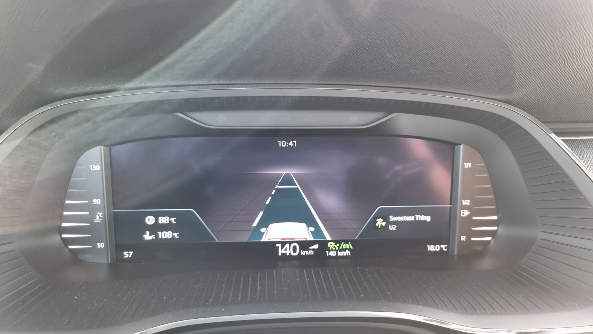

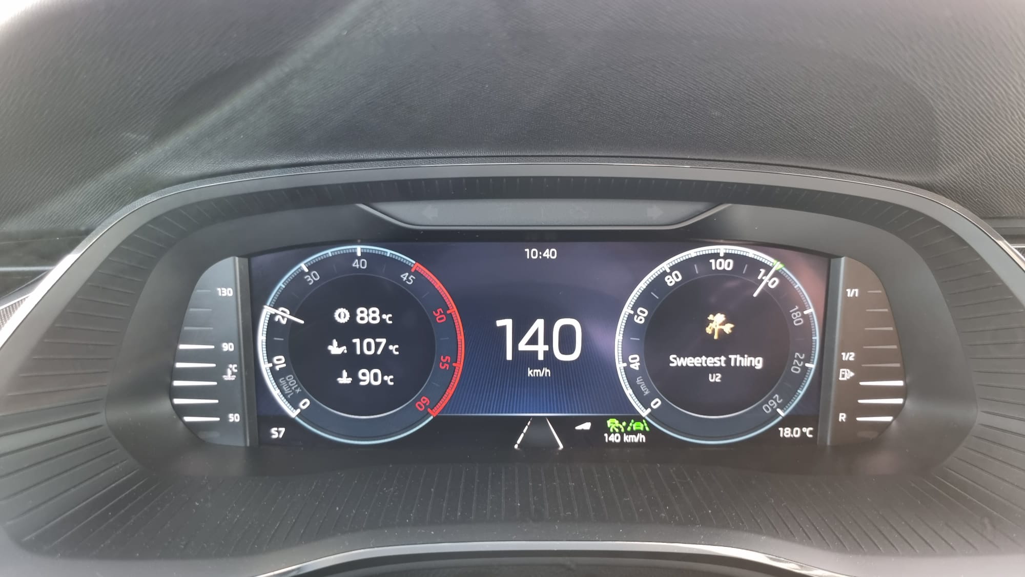

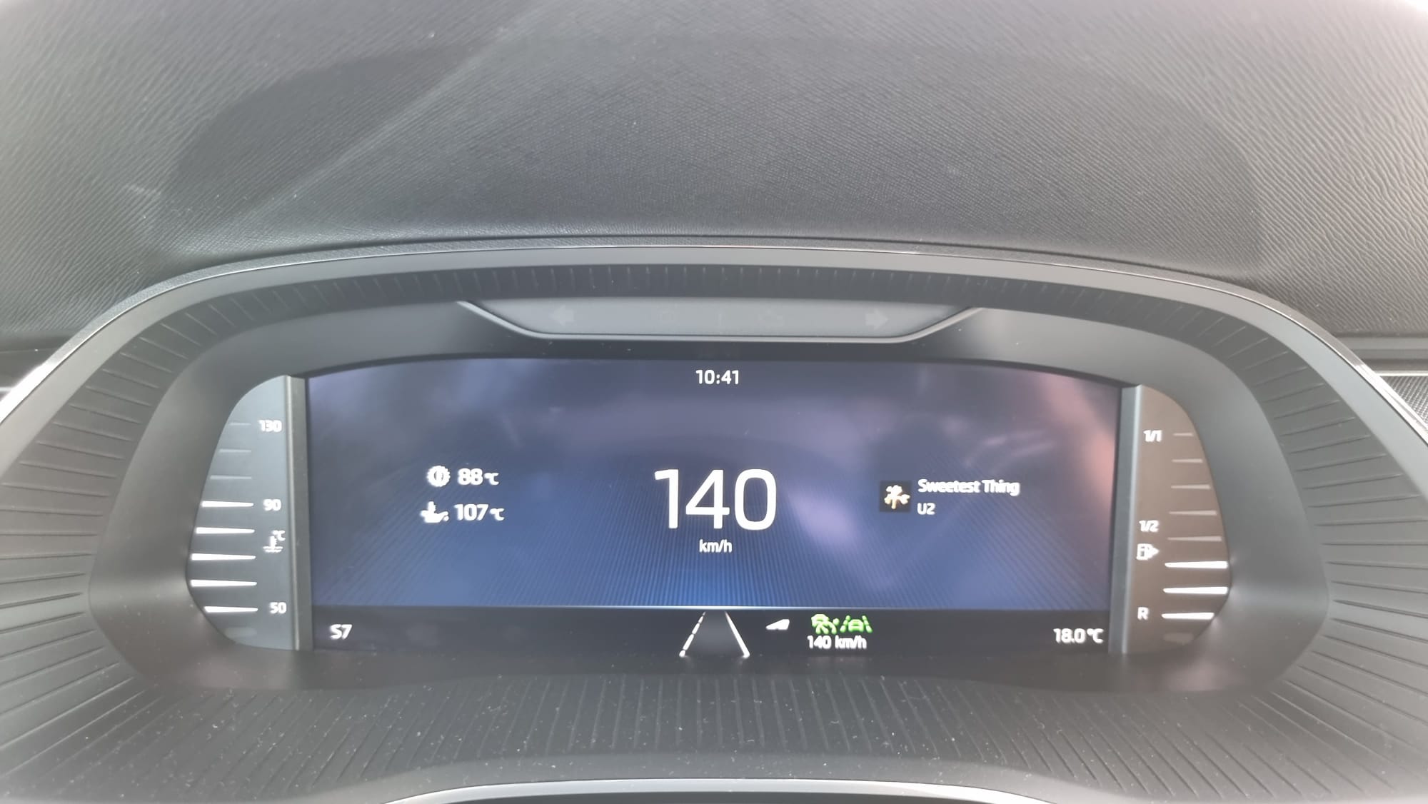

On 27/03/2023 at 00:53, SkOmk4 said:
Indeed, I had a longer drive over the weekend and had the chance to monitor the temps - they all start shoving numbers at 50 deg Celsius (coolant, engine and DSG oil), nothing below this value.
Correction to one of my previous posts: the set of three temperatures (coolant, oil, oil) only shows all three on the "classic" dashboard theme. All the other layouts only show two values.

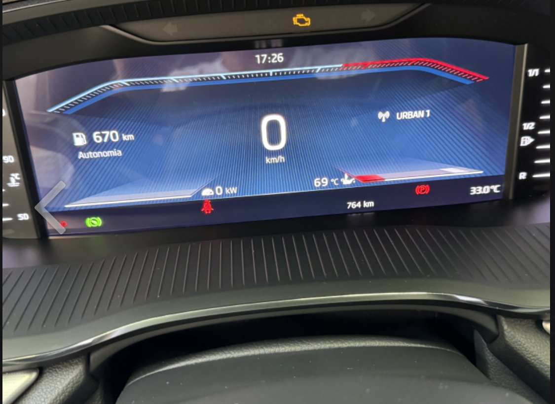

hello, can you help me? I put the VRS image (coding cluster) but doesn't appear the numbers... please, help me

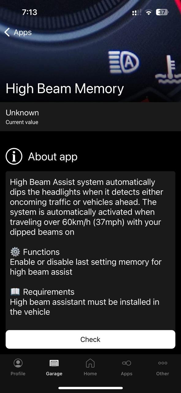

Could you please share the long coding for high beam memory? I did the adaptions and also the payed app in OBDeleven but it still don’t work. Didn’t buy the feature as SWaP, had it factory-installed.
Also, if anyone have the coding for audible singal when locking the car, it would be much appreciated 🙏
This is what I’m looking for as I don’t have alarm in my Octavia IV 2021.
Pls see the screenshot of the long coding I did for high beam memory below

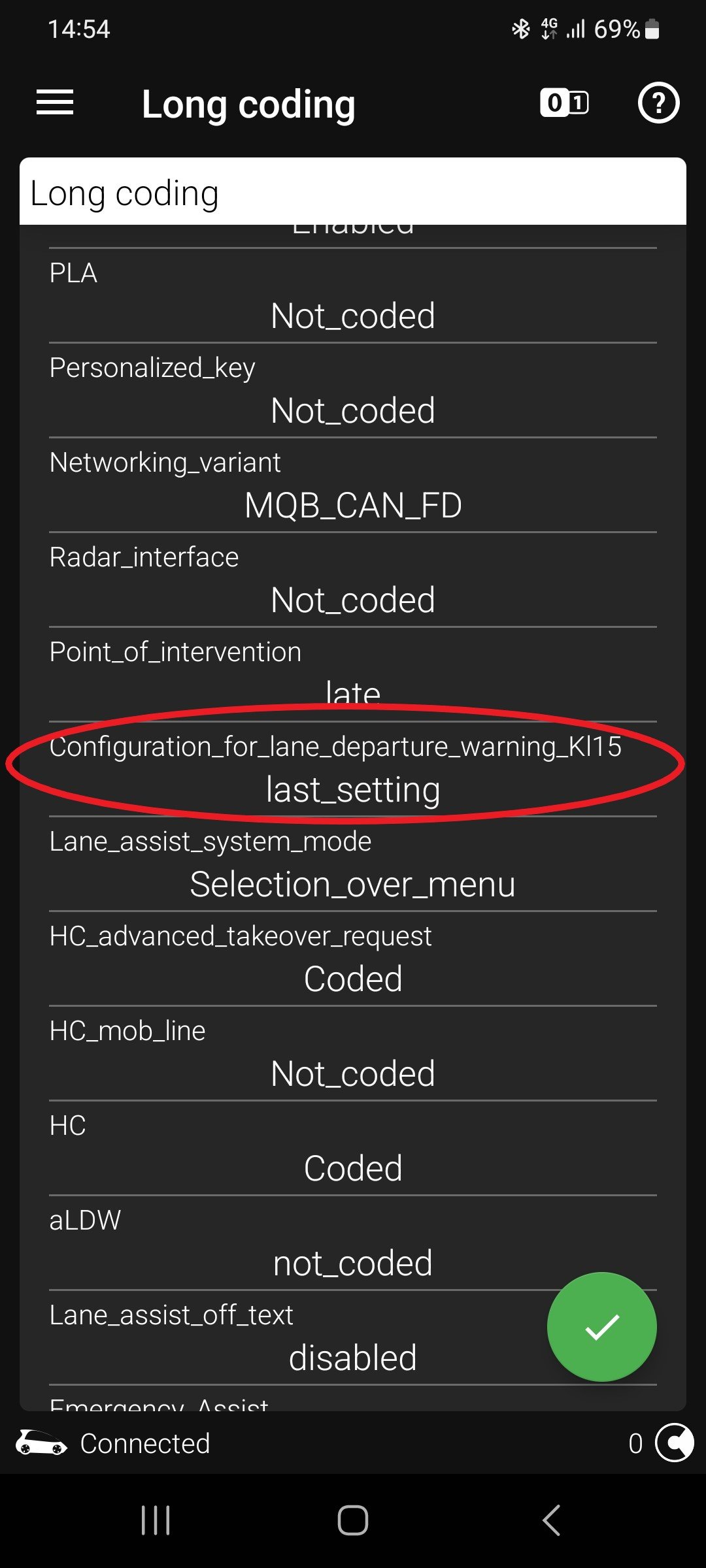

Do you have an OBD11 device ? How do you intend to do the coding ?
  • Lane Keep - remember last setting:
Driver assistance (module A5) > long coding > Configuration for lane departure warning KI15 > change to "last setting"
LaneDepartureWarningoffstep1.thumb.jpg.52738ae66a8fbf6ee9bb4d243399fc15.jpgLane Departure Warning off  step2.jpg
I do not know for the others you asked.
