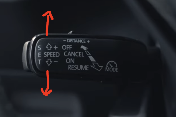

20 minutes ago, SkodaOctaviaIV said:
Dear forum users,
To lower the ADD (flipper-handle up/down) 10KM steps back to 5 or 1KM, who can share the coding for this change, please? (Skoda Octavia IV 2020)
I think I misunderstood it at the beginning. You can set the speed in 10km/h or 1km/h on the ACC lever.
No problem. But how exactly? How can I change the speed from 10KM to 5 or 1KM? Please your instructions?
How to change these ACC up/down steps from 10KM to 5KM by coding? Anyone please?
5 hours ago, SkodaOctaviaIV said:
Wie kann man diese ACC-Auf-/Ab-Schritte per Codierung von 10 km auf 5 km ändern? Kann das jemand?
Now i unterstand...
This is normaly an Audi Feature, but try this:
Unit 13
Coding
Operation_moden
From Mode 1 Change To 2
The Change is 10km/h step To 1km/h

Well on all my VAG cars you pull it up and down for 10k and towards you for 1k increments or away to lower it by 1 k

Thanks for your instructions, much appreciated.
However, I would like to have 5KM steps instead of 1KM, is this code-able?
Surely it must be, as the cars in the UK have the "5" as standard value available?
That might very well be the case, but I would like to use a 5KM/h setting instead of 10KM/h...
IT Dont Work with EU Firmware and HW
