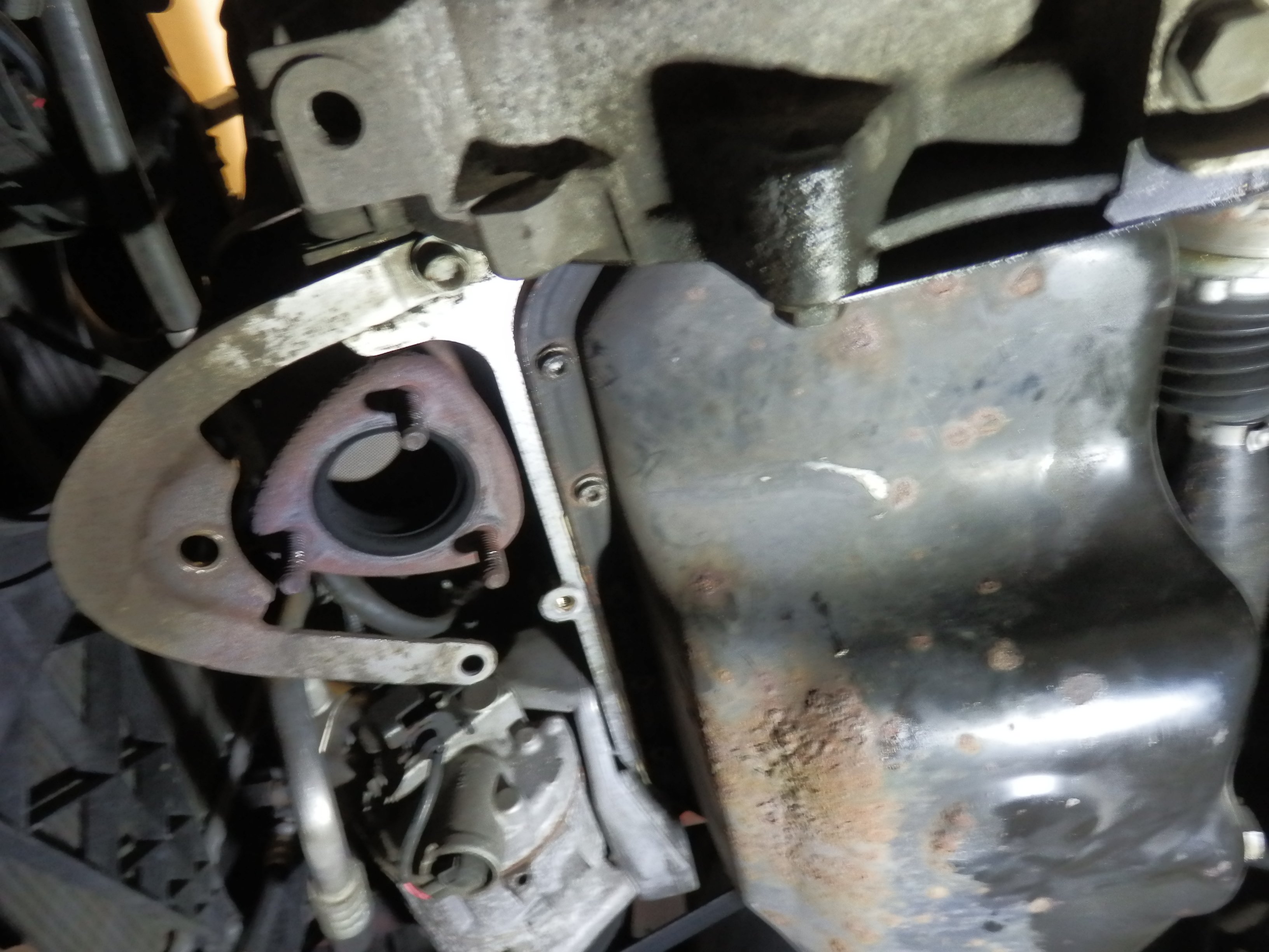

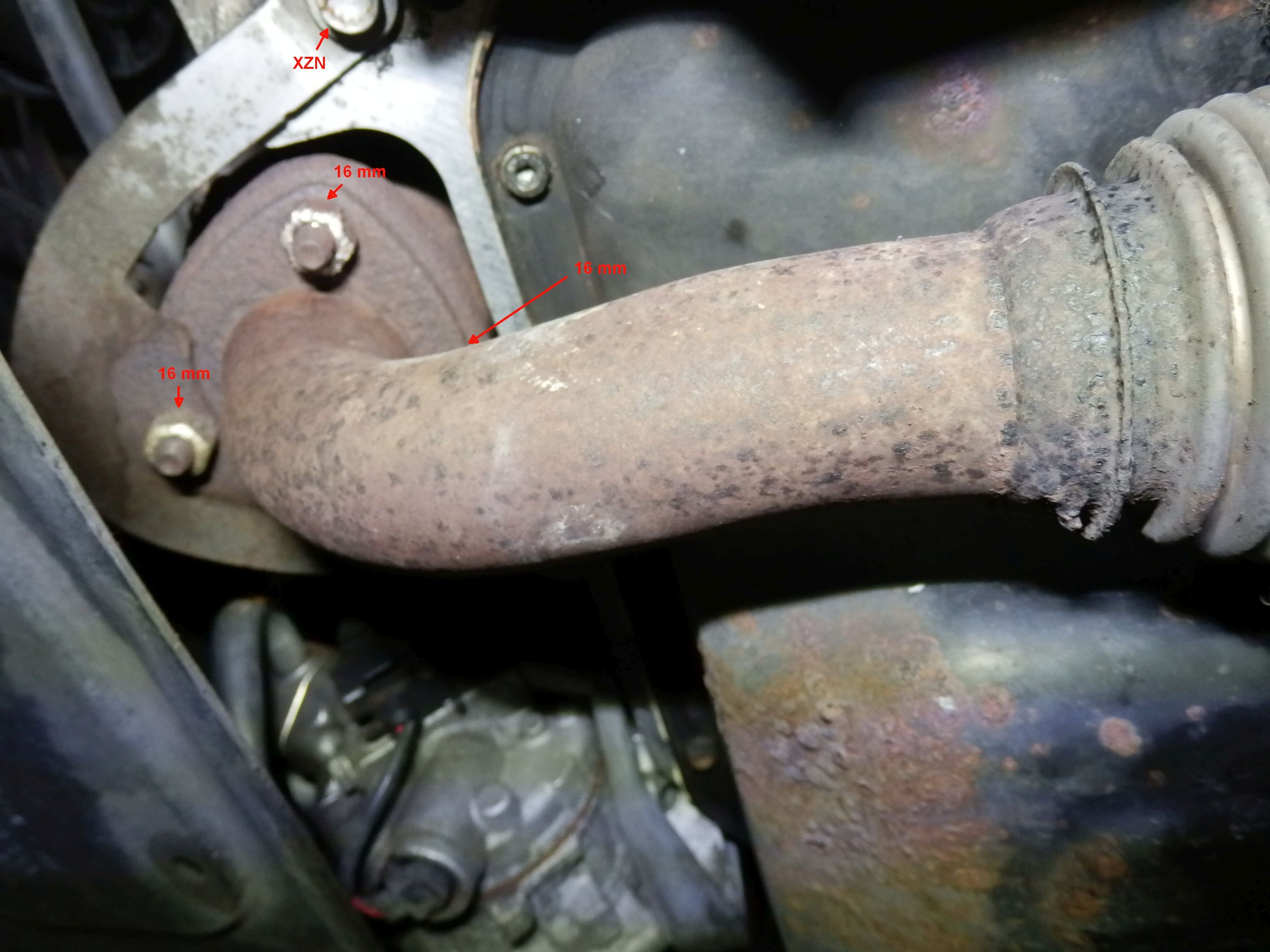

I started by marking the cuts on the exhaust pipe and undid the front end to the manifold. There are 3 x 16mm bolts to take off which can be a little stuck, and a XZN bolt.

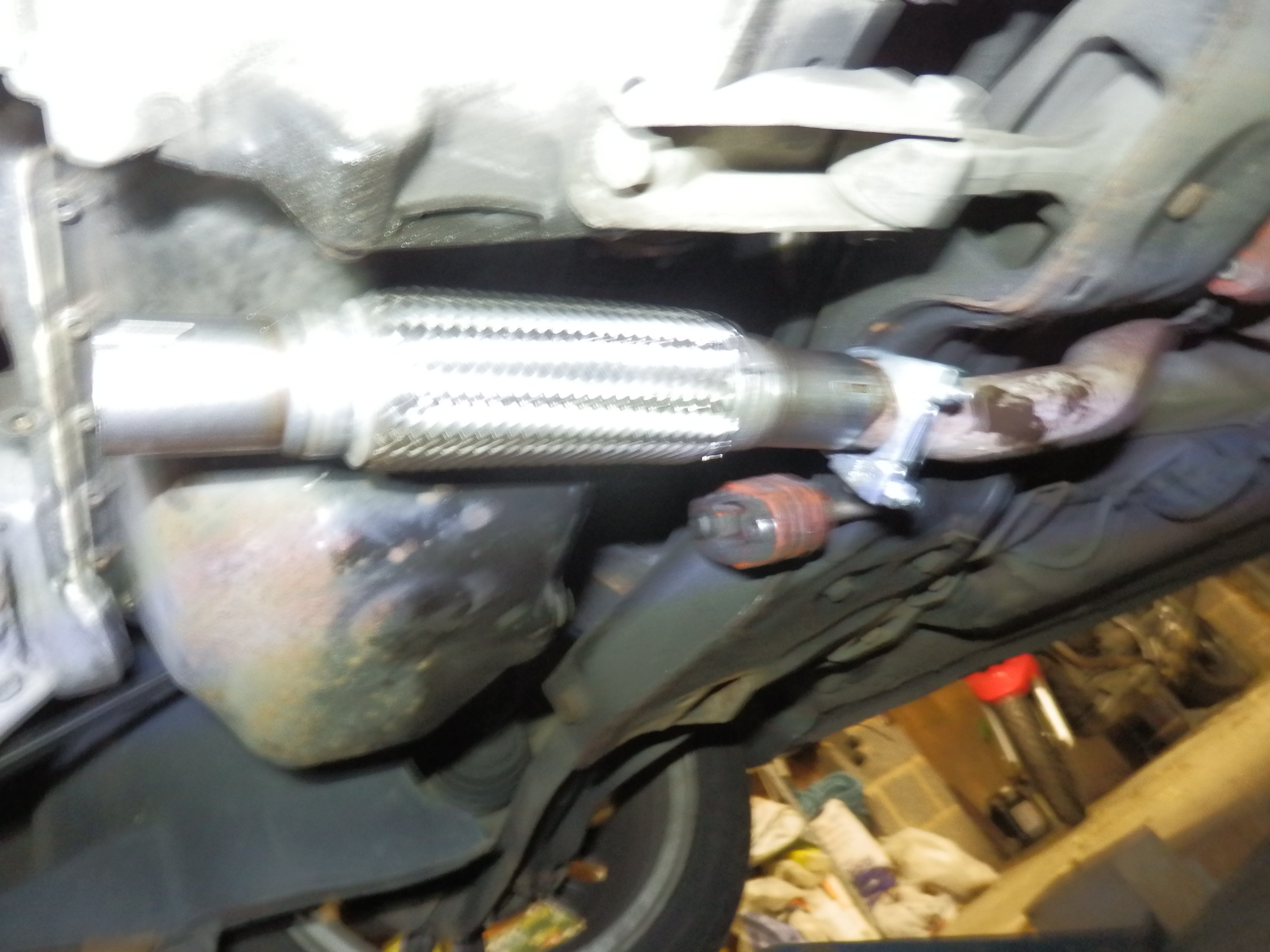

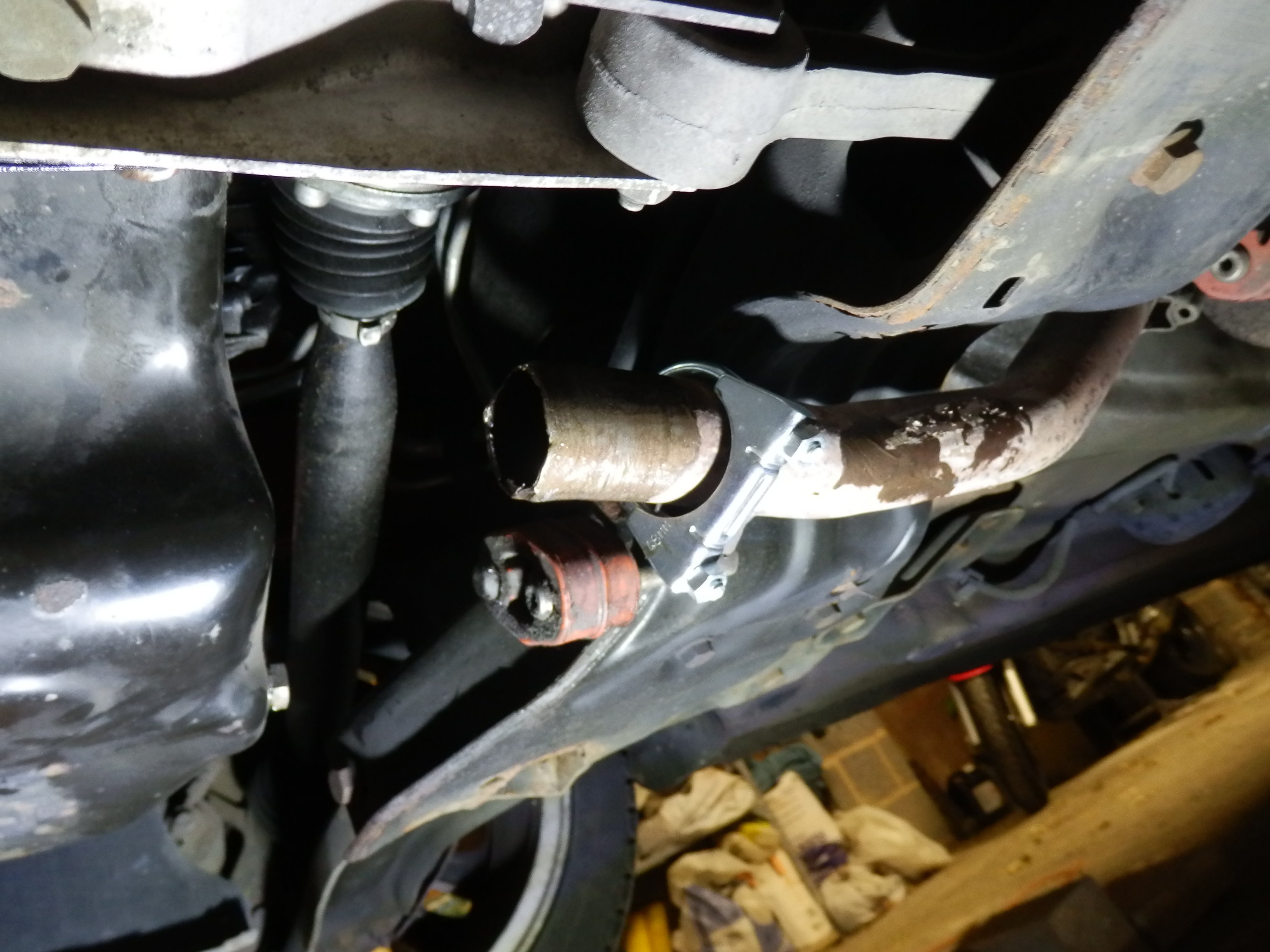

I left the back section in place and cut with a small angle grinder that part straight and did the front end on a bench.

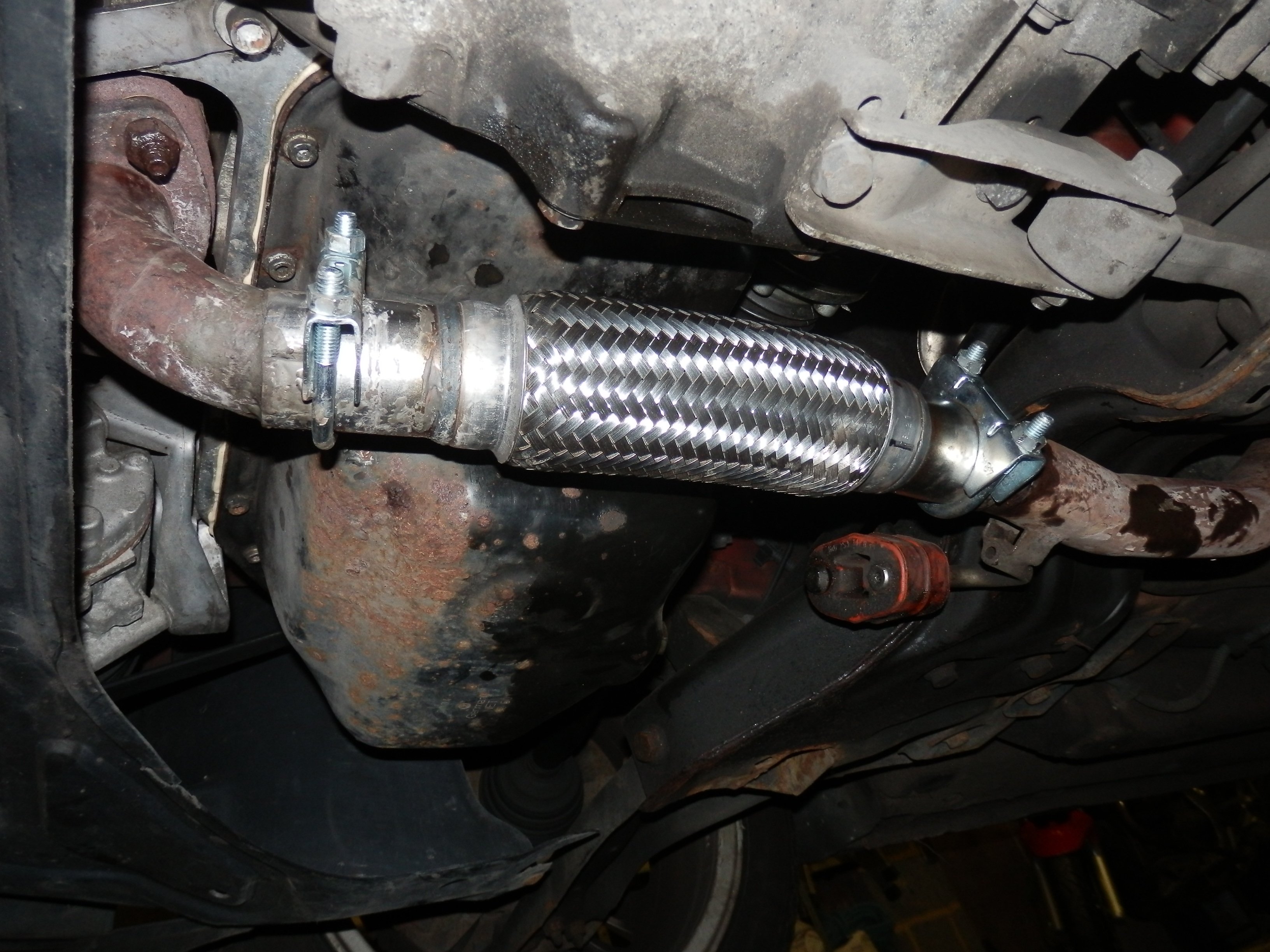

The replacement fits over the old exhaust. The OD is 45.2mm and it was a good and tight fit with the new part. There is about 5 cm overlap on the old exhaust.
I tried to clamp it first without the exhaust putty but still had a small leak so had to fit it with exhaust putty and the leak was gone.

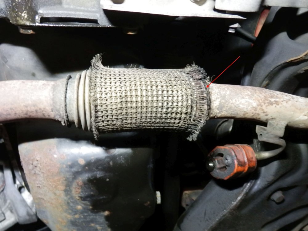

Little update, decided to spray a little water on my flex joint and take a look.. does appear to be blowing a bit to the rear (aren’t we all). Got some video and pics for your enjoyment 😆
Measured up for appropriate Mikalor clamps too. Time to get busy.
