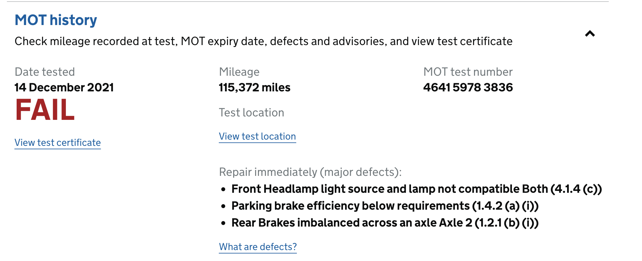

can you please educate me on what does the last two points mean?
Headlamp - yes I know, bye bye HIDs
Parking break efficiency - my handbreak works fine and i don't notice anything different. I don't have to lift it that much when parked.
Drum breaks - neither of them are sticking. What sort of test do they do? They have been replaced 50k miles ago.
Which exact parts were replaced?
50k miles in how many years?
This is indicative of a rear wheel cylinder leak which has contaminated the shoes on one side as well as reducing braking pressure.
Replace it and the shoes and it should pass once you've swapped out the headlights.

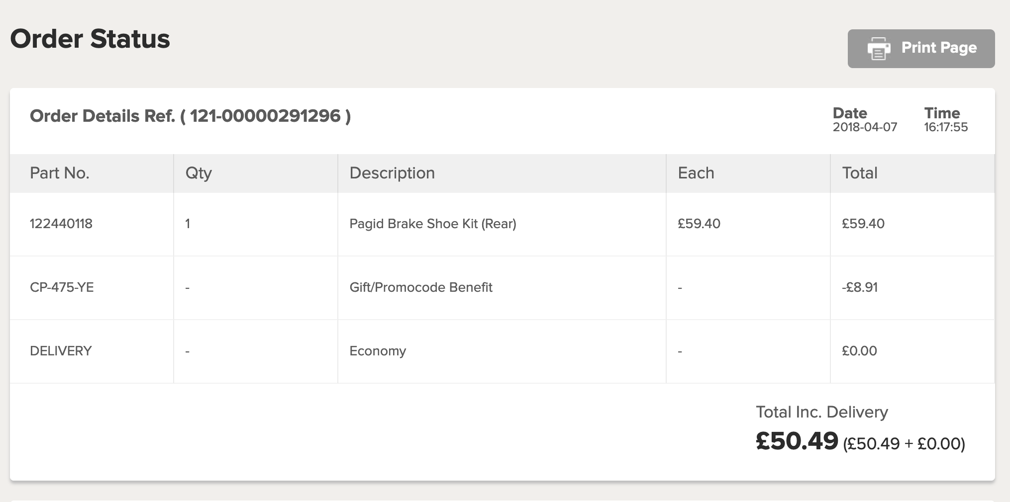

Found the order. I bought everything in one go. Shoes, hydraulic pistons etc. 2018
That brake shoe kit does not contain wheel cylinders.
I have replaced those too 100%. Everything was out becasue I had to do a brake bleeding kit

That kit did contain the wheel cylinders: Pagid Brake Shoe Kit | Euro Car Parts
3.5 years is possibly enough time for something to seize up inside.
Take the cover off that allows you to see the equaliser bar behind the handbrake lever, and see if it skews sideways when the handbrake is applied. That usually suggest a seized pivot inside one drum.

I was just about to edit my post as I missed the bit about the brakes being imbalanced, that won't be brake dust, but 3.5 years is a long time to not look inside the drums.

I think @Bertie90 you can test the handbrake function yourself fairly easily. Apply handbrake to normal position, chock front wheels and put in gear; Jack up both sides of the rear until the rear wheels are off the ground, then see if you can turn either wheel by hand.
If that shows one side not getting braked as much as the other and the equaliser bar is also pulling to one side it would be fair to think that there is a real problem.
A stretched cable on one side could also cause these type of symptoms, I guess.
