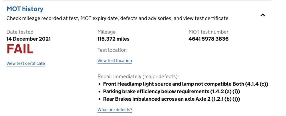

MOT Fail
Our very local MoT, or one tester I saw at least, has all the lights on including fogs and hazards whilst checking the underside with the car in the air, when I asked him not to do it on my neighbour's car which was next in line the tester said it was Ok because he left the engine running!
By coincidence another neighbour had a fail the year before from this place on front sidelight bulb, Covid, you had to leave the car with them, we had checked all the lights the day before.  Obviously you can't say a bulb couldn't blow in the meantime and the spare bulbs my neighbour kept at home instead of with the car.  They also found a lot of advisory work.
This year the same neighbour took the car back there for a service and get the advisory work done and MoT, less surprisingly it passes this time but they tell her there's something wrong with the gearbox that neds sorting, I'm not sure if they wanted that work or not, but there was nothing wrong with the gearbox luckily another neighbour has a good scan tool and car repair experience.

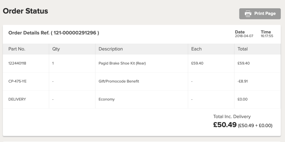

  • That kit did contain the wheel cylinders: Pagid Brake Shoe Kit | Euro Car Parts 3.5 years is possibly enough time for something to seize up inside.   Take the cover off that allows you
  • Quote.. "The thing is, this garage failed my Roomster for both rear coils snapped/fractured and a ball joint with a damaged sleave. None of that stuff was true. They asked £700 to fix it but I decline
  • I'd be tempted to swap out the headlights to the correct bulbs and have a look at the rear brakes/handbrake and if you find nothing amis then take it to the local council MOT centre for a second opini
