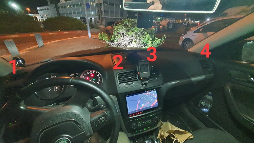

hello friends,
cold day arrived and my air vent give me diffrent temperture,
air vent 1 give me the tempeture I desire, but 2, 3, 4 vents are more colder when 4 is the coldest and 3 less and 2 is more also less colder.
I tried any kind of ac settings, and did AC+face calibration - didnt work.
any ideas what can I do?

I dont use it, I turn it on without any separed zones, just regular climate control with or without AC. I noticed this beacuse in cold weather the climate control didnt warm the car well as it used to be

No it did not reach the desire temperature.
In cold weather after the engine is hot, still cant warm beacuse of different temperatures air vents.
I own the car for 10 years, I am sure there is some problem, sould you advise to clean some part of the ac?

Do you regularly adjust temperature and/or direction (include setting the Demist mode here) to exercise the control flaps? If not, then I prescribe 10 minutes of flapperobics before doing anything else.
Could be  a thermocouple in the control system not working   ---   I had a similar sounding problem with my first Yeti,  said piece replaced and no further  problems.
Good luck!!
Sounds probable if it has Climatronic.
I have the much simpler manual heater and AC in this vehicle after Climatronic in the previous ones, the only drawback is having to juggle the heat control on a cold start cold day, it needs max until engine up to temp and then progressively turning down, Climatronic takes care of that well, the rest for me now is just unnecessary complication.
The two centre vents will be at the same temperature as they share the same duct, flap and thermocouple, the thermocouples in the outer ones can become detached, they are situated right near the outlet. I would check thermocouple 1.

There’s a process to reset/calibrate the vent flaps.
https://youtu.be/6xnnS4cANSk
His car has climate control and he said he has done calibration.
I've got a similar problem. I've tried the re-set procedure which sort of works temporarily but is not the answer.
I can hear the flaps moving when reverse selected, and it groans and wheezes to move about. No clicking of skipping gears, just seems to be clogged up.
