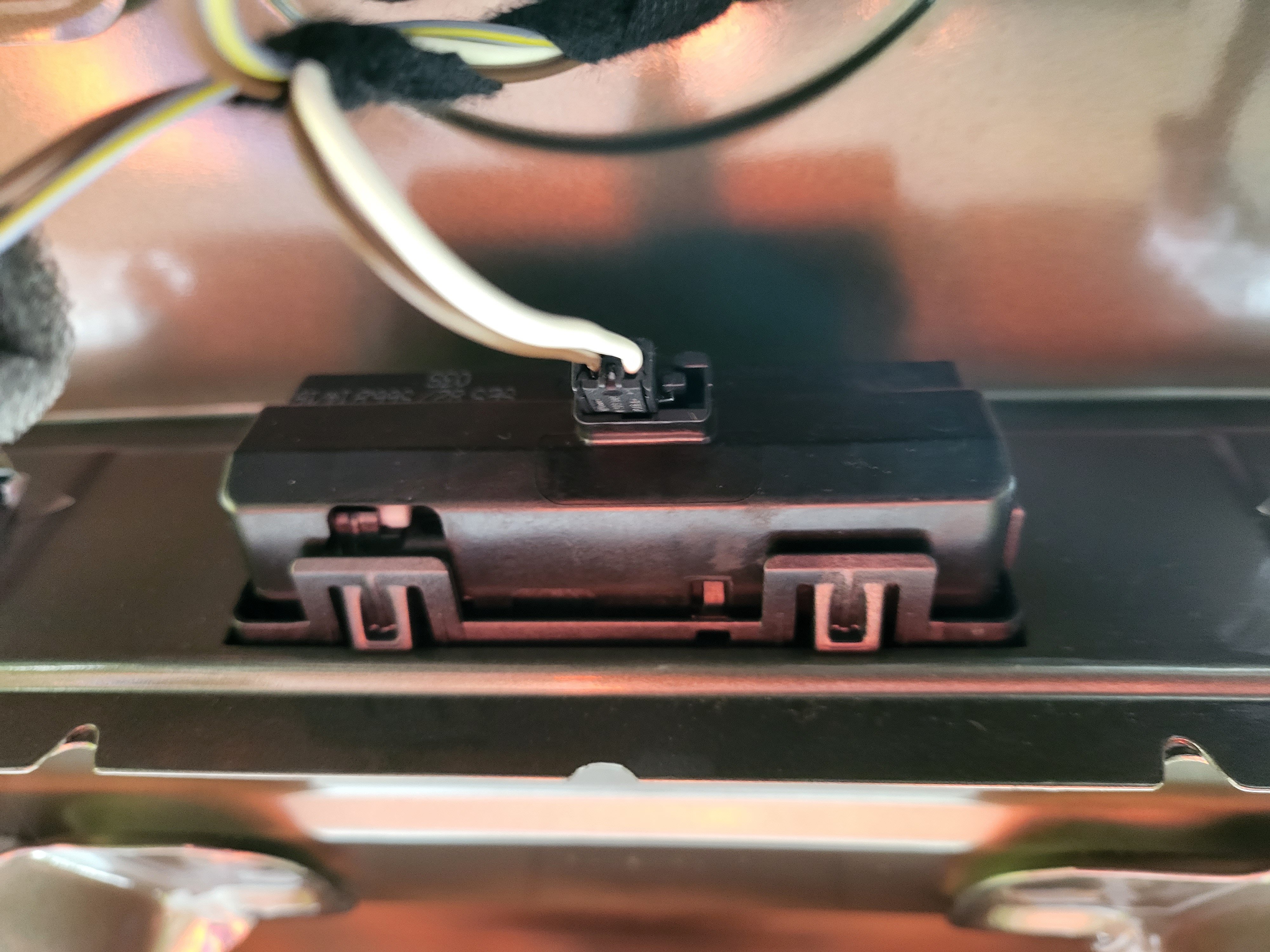

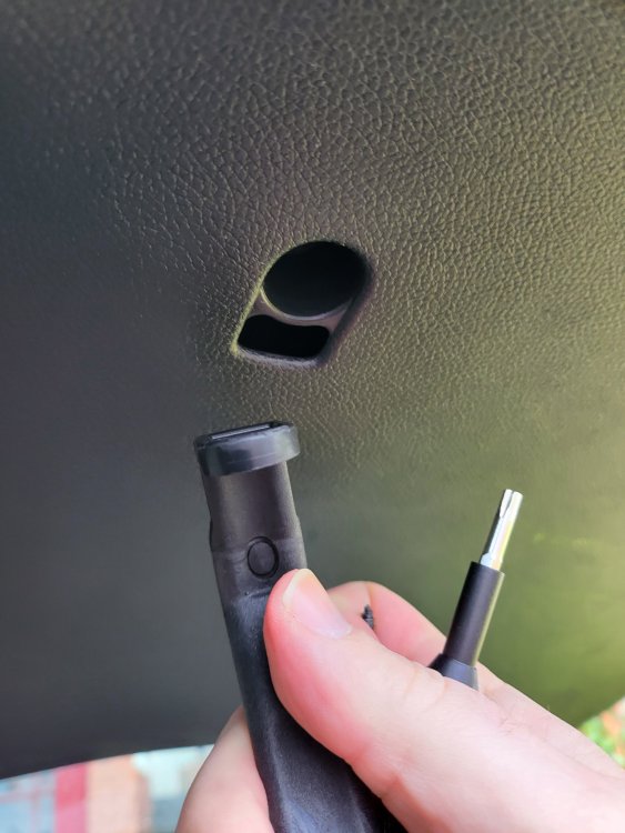

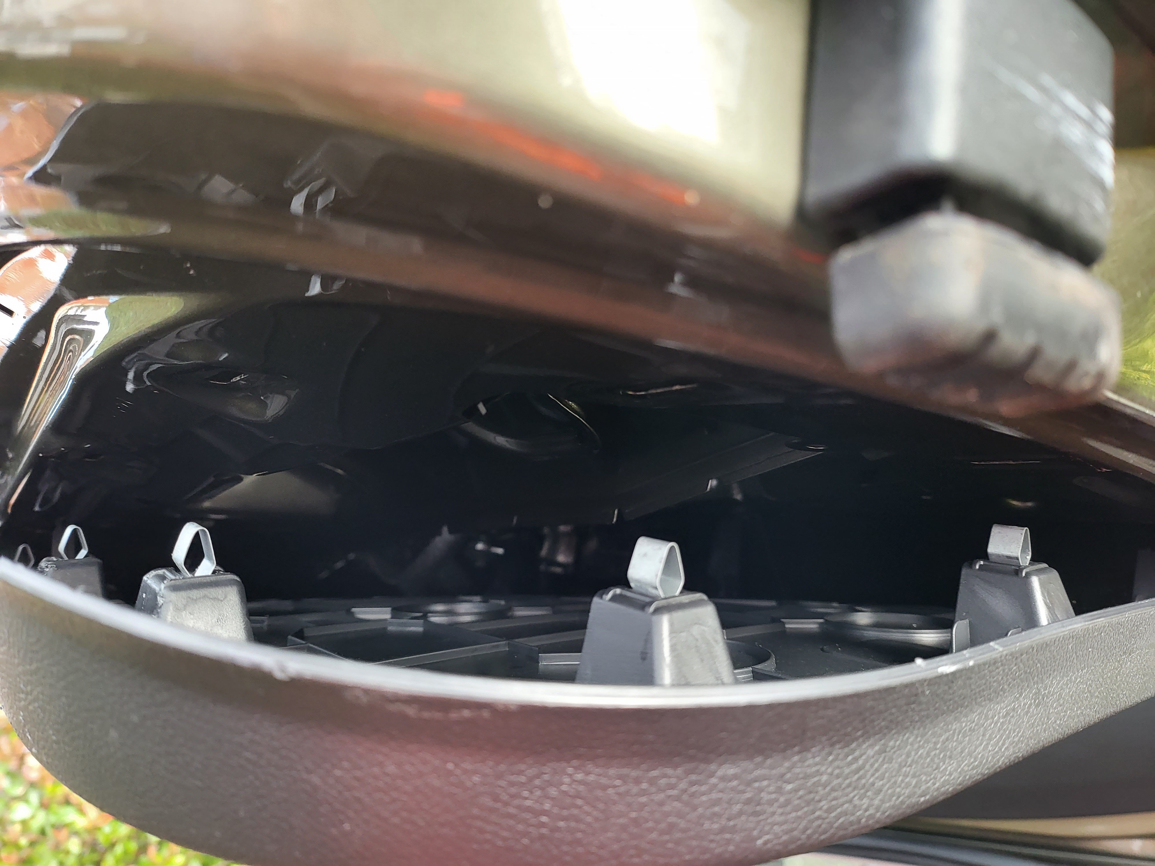

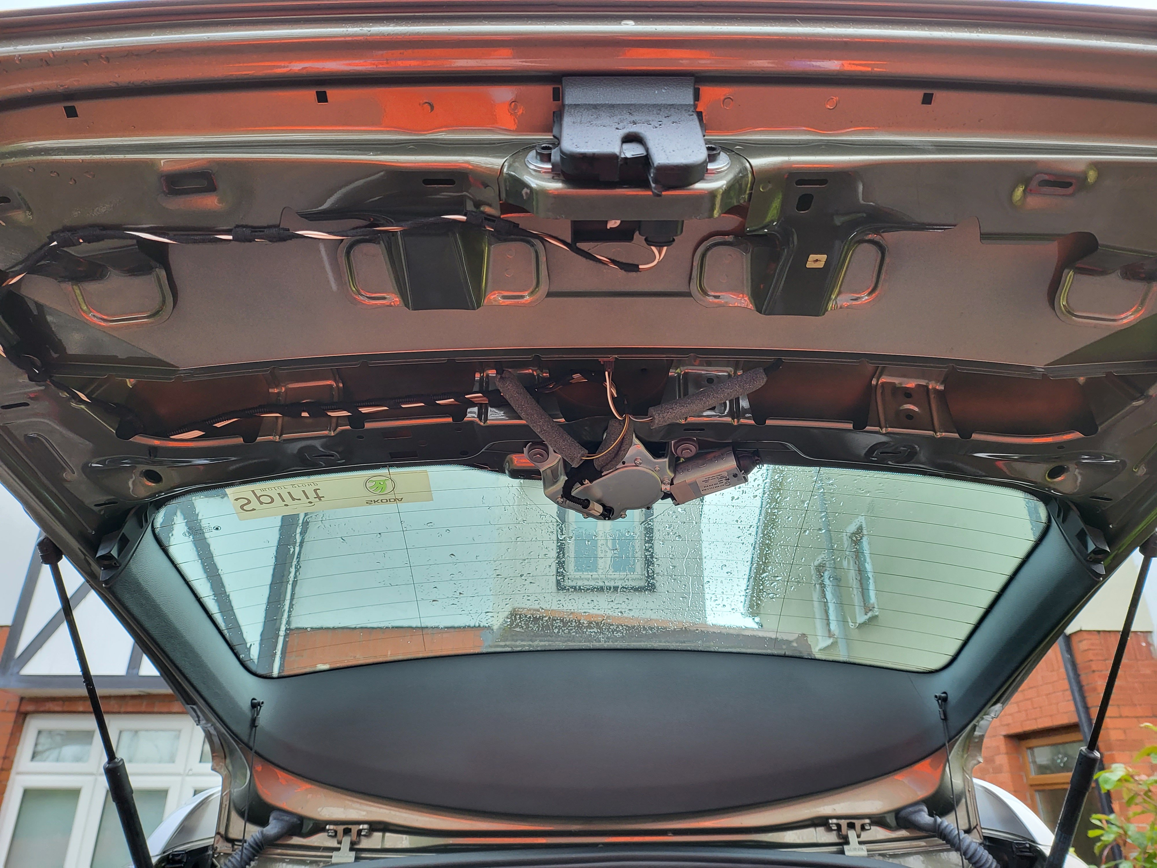

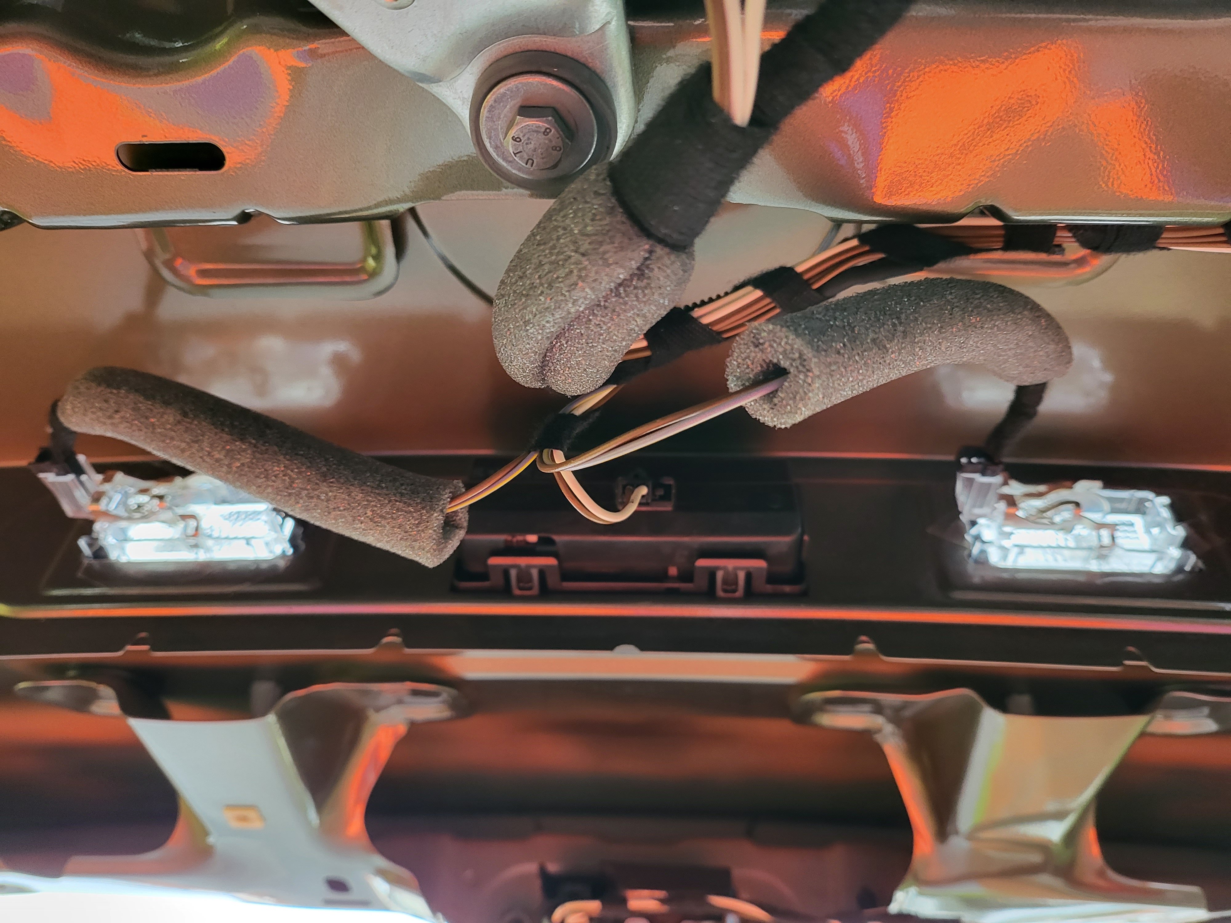

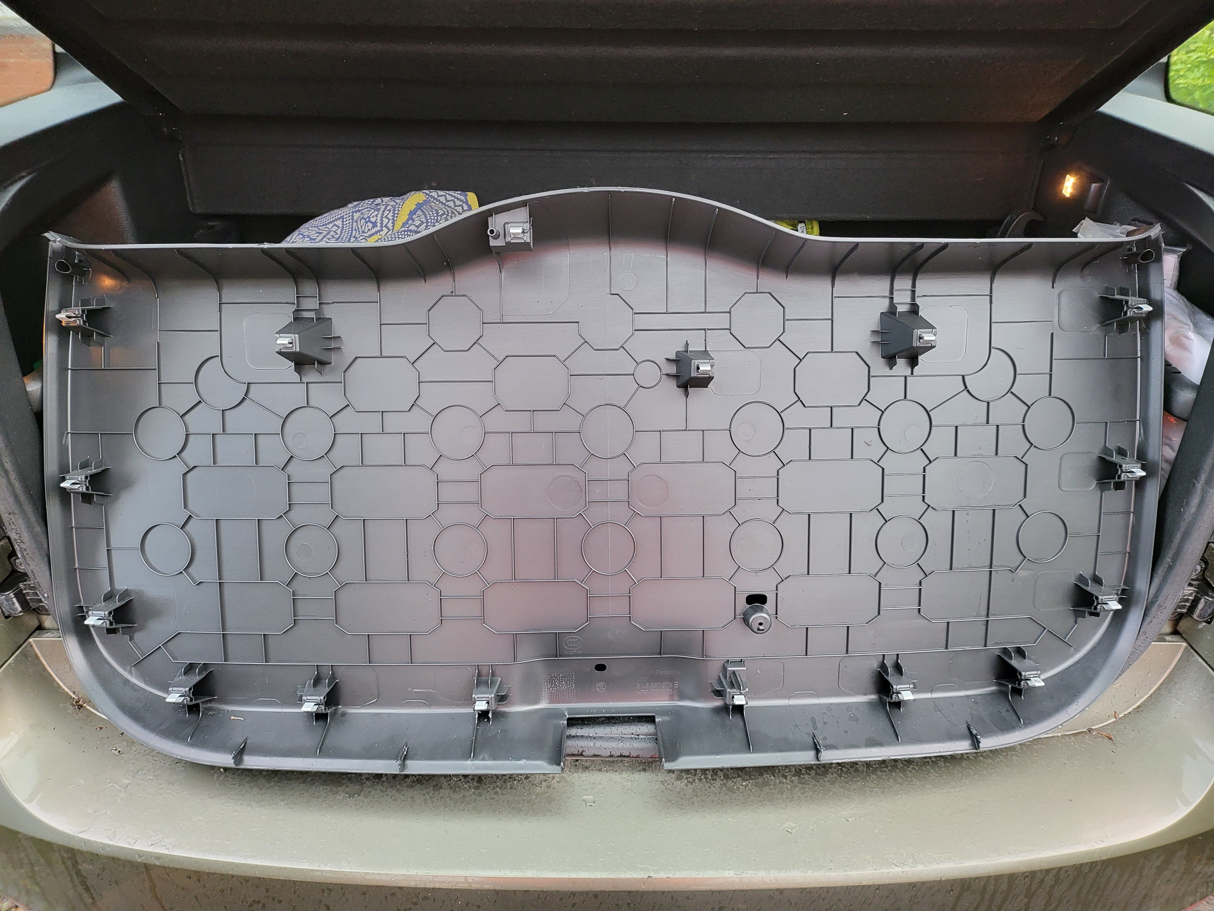

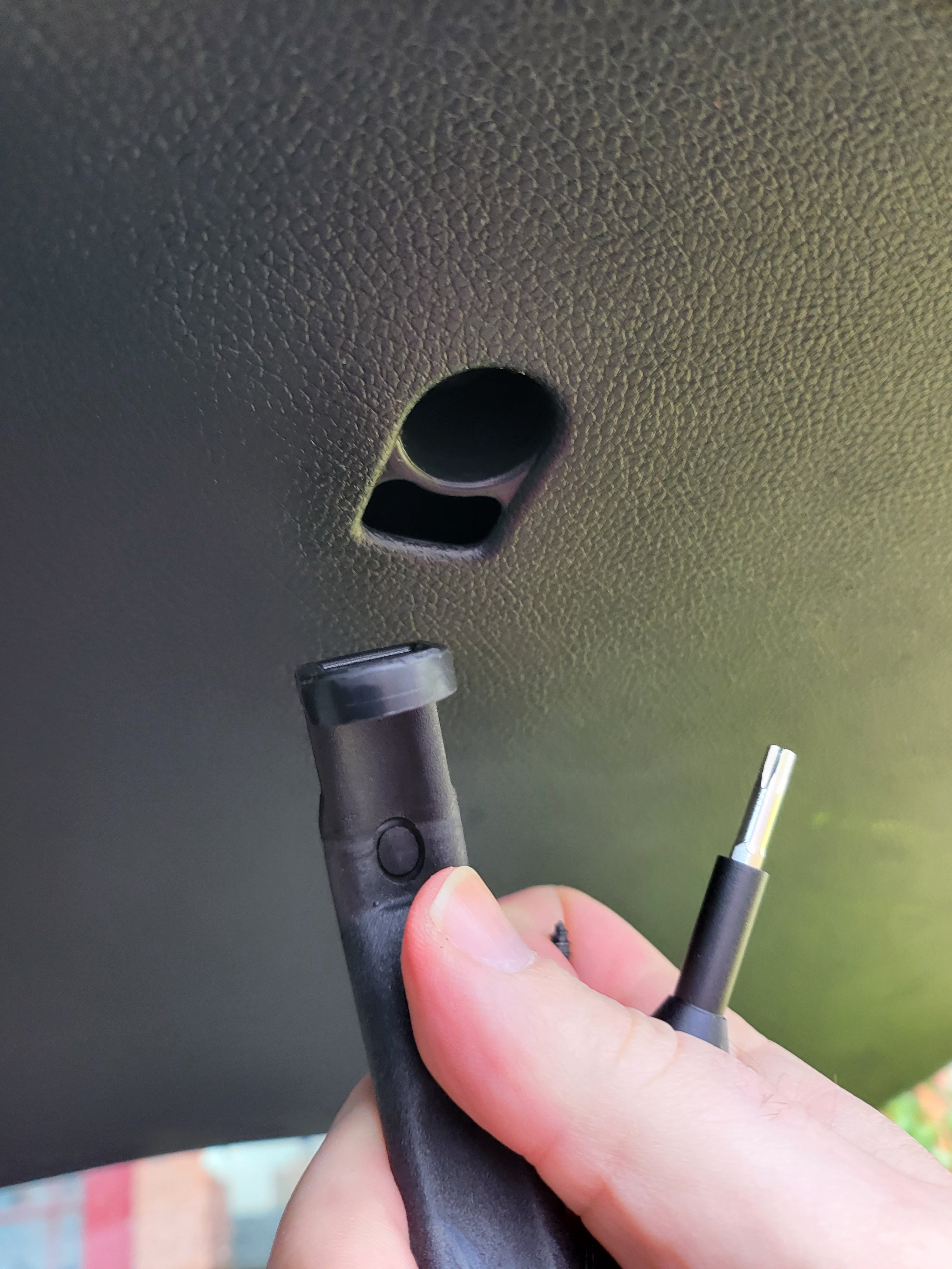

Had a "rummage around" the Skoda Yeti boot panel to check which connector is used for my boot opener, as I've decided to purchase a new reversing camera that replaces the boot opener. I don't want to drill holes in my Yeti. It's the LS8012 connector for my face-lift Yeti. I think the pre-facelift Yeti has the other connector.
A right pain in the backside to remove. Unscrewed the rubber boot strap and pulled it out. To remove the boot panel, the clips attached to the body requires getting a long strong plastic "spatula-like" implement or two and with fingers forcibly pull it off as the clips are on tight. I've left the panel off until I get my new reversing camera as I don't fancy removing it again. I began at the bottom, closest to the boot lock, as I had the best access and not like some where the panel meets the window.
I'm buying this on Amazon UK (I have vouchers to use), Dynavsal 1280 x 780p night vision camera together with this in case I need it: 12 Volt Rectifier.
At the moment I think I'll pull the reversing camera cable through the bottom of the car, as opposed to via the roof. Mind you, I might change my mind as I'm doing it... 🙂

Finally managed to find an ingress point, two rubber grommets just below the bottom boot trim. No need to remove the trim or the screws at the bottom of the bumper, just pull the grommet in to the car, cut and feed the wire through then replace the grommet from inside. I pushed it all the way back out then used wire nosed pliers to pull the lip of it in to the interior. I ran the cable to the front the lazy way under the trim on the floor of the passenger side and through the dash to the back of the head unit. It works fine with my AVIN app but when I put it in reverse, still no picture. Still waiting for a response from Xtron support on that one.
The end of the line. All in and working correctly, engages with reverse, looks great. The missing link was another part of the head unit loom still being in my drawer rather than attached to the unit. On that loom? A video input labelled Reverse Cam In...

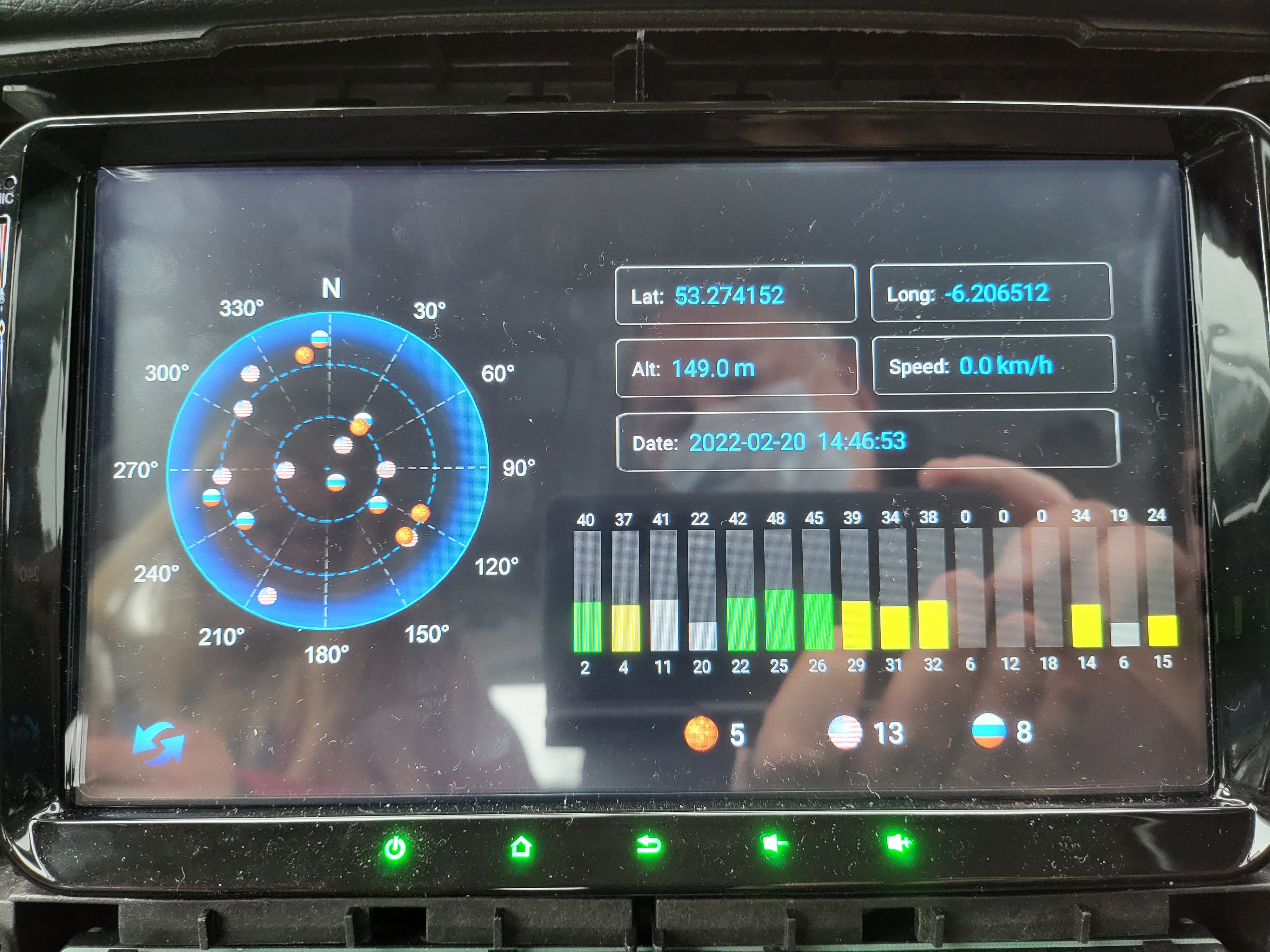

Hiya!
Android Auto via USB works extremely well on the Xtrons IQ90MTVL. It's responsive, beautiful big screen (9"), and just works well via the ZLink application. Occasionally, wireless Android Auto works too, though not frequently enough for me to trust it.
The built-in navigation is dependent on having good connectivity and a SIM installed. Good connectivity is available either by using the pre-existing GPS contact connected to one of the new USB connectors (I now know this works) or using the GPS puck that comes with the unit, however, this requires a decent placement of the puck on the dashboard (attached photo of GPS satellites).
If you're only installing the Xtrons IQ90MTVL without accessories such as the DVR camera, the reverse-parking camera, or the tyre pressure monitor, or the OBDII device then I think installing it is easy enough (if I managed to do it, then so can anyone else 🙂 ).
