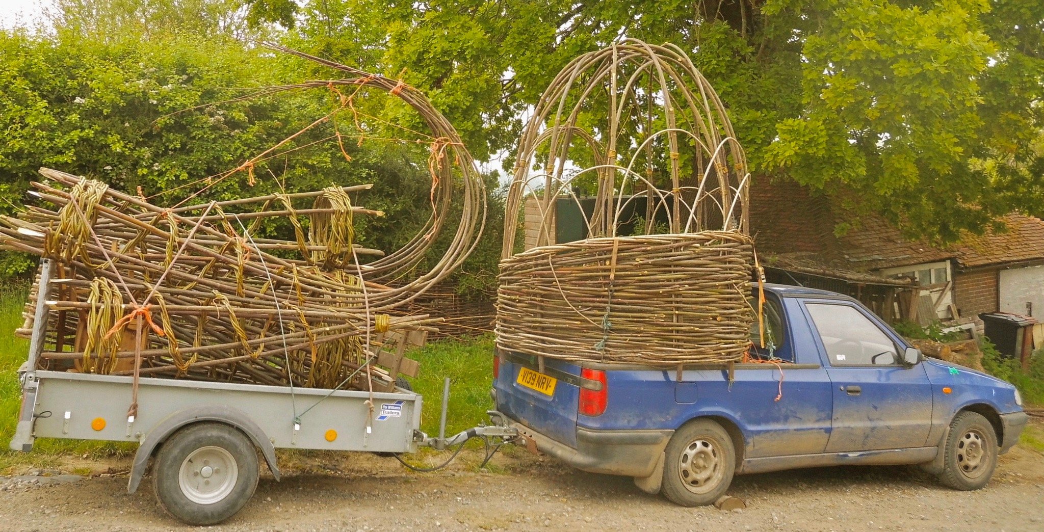

Half the world seem to want me to scrap the little felicia. Hmm. Too useful. I can go where the Works HiLux fears to tread and carry 20ft chestnut stick bundles out of the woods.
