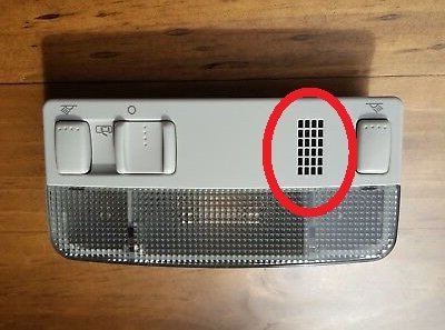

this is what you need to buy, and yes it plugs into the quad lock connector, be careful with buying Non VAG parts, the green adapter can be to big for the quad lock.

And yes it goes behind the grille in the courtesey light and clips into place ( Piccys below). It's pretty straight forward, runs from the radio behind the top glove box, then up the L/H A pillar and across to the light.

Then you only need to remove the courtesey lamp assy (remove plastic lens), undo 2 screws, let the light dangle,

Then it's a case of feeding from the radio, then along behind topo glove box, up the A pillar (secure to exisiting wiring with cable ties or tape) and across above roof trim.
To get the wiring from the top of the A pillar to the courtesey light hole, using a "fishing" rod like a coat hanger or stiff piece of wire or similar pushed back from the courtesey light hole, tape your mic / wiring to it and use that to pull the wiring through.
To work "well", the microphone is best placed at this height, it is very straight forward and works very well.
