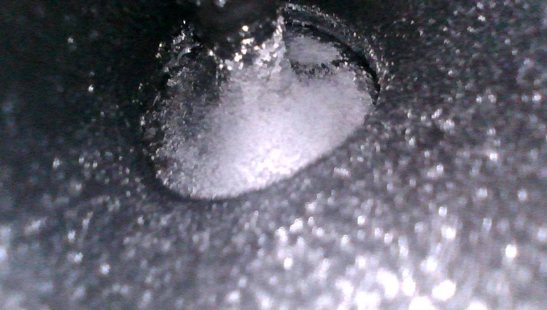

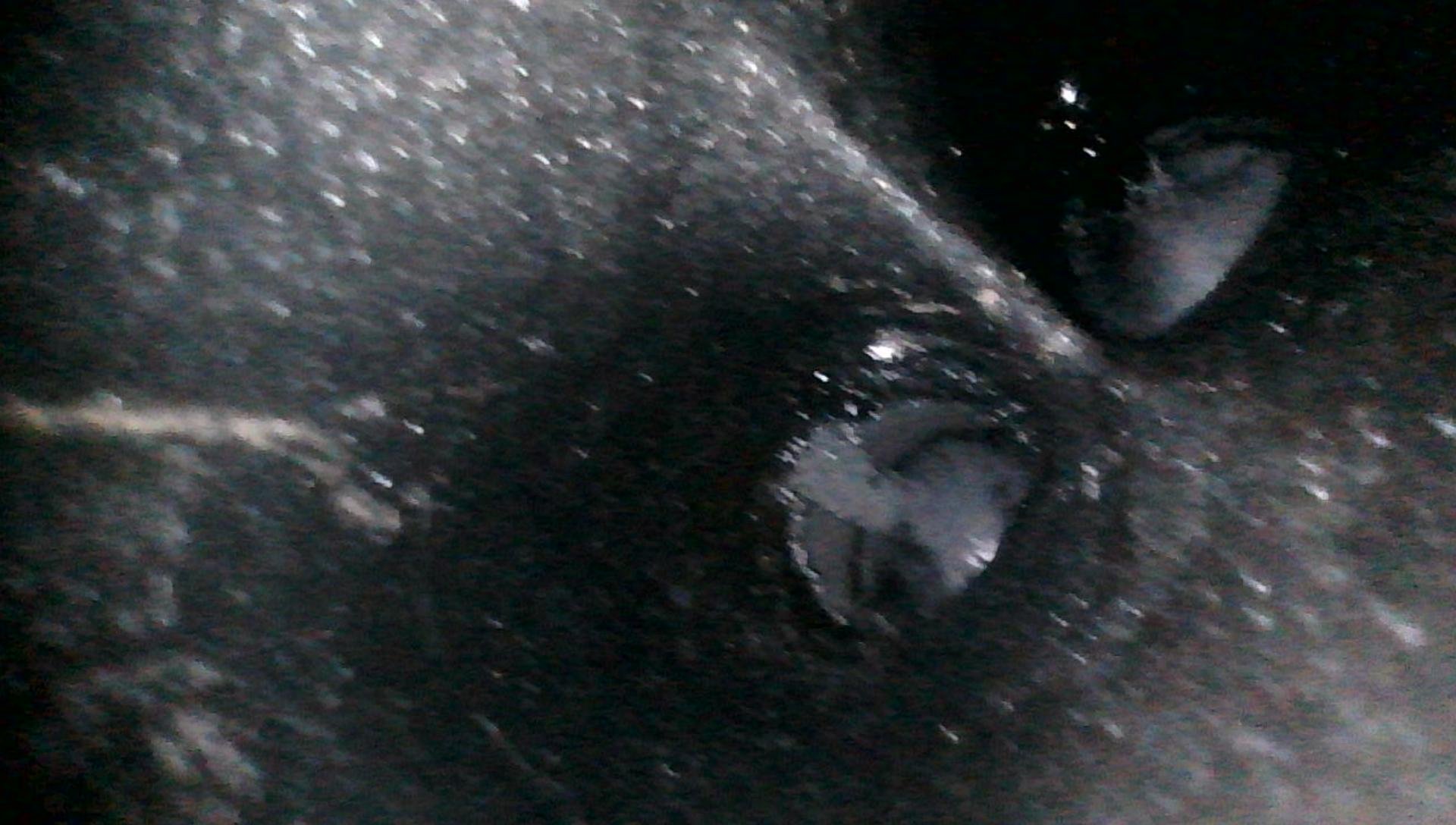

What worries me slightly about this whole thread so far (Pages 1-4) - seems to be the lack of either a compression or relative compression test having being done on any of these engines.  As the 1.4 is a direct injection, the valves do seem to get covered up in crud more often.
So - thinking about this logically; I think first of all; the ECM is slightly crying wolf re: misfires.  A lot of the misfires and misfire counters were reading single digit misfire counters.  That's probably an overly sensitive piece of software at play here.
Second; if you start getting errors on multiple cylinders from nowhere, that means you've got a problem with either fuel/fuel pressure.  The likelihood of multiple coil packs failing all at once is vanishingly small.
Third; some of those pictures of the valves look horrible.  Assume those are exhaust valve pics as opposed to intake.  I also saw a picture of one of the the injectors.  Anyhow, one of the posters said that his mechanic said take the car on a high-speed brisk run; problem went away for a week or two, then came back.
Its an issue; people want to save fuel and running costs think that by running engines kindly, it will save their fuel costs/costs of running the car etc.  This does not apply in VAG world.  Every single VAG engine I've ever seen/owned as always benefited from being driven hard.  Its the German way....
I would run several tanks of Super Unleaded through these cars engines as a first port of call to try clean up the EGR/valves and add some weights to your right feet.  That means hard acceleration and progressive braking at least once a week.  If your car is only used for short/in-town journeys, take it on some fast roads and keep it going for at least 100miles.  Do this at least once a month.
