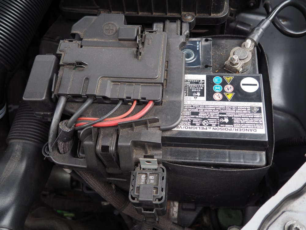

After 8 years my battery has lost the will to start my engine. I have a 1.2 tsi 85bhp and there is nothing in the handbook mentioning battery specification. I have looked at the local motor factors and there are choices of battery. I don't have stop start to a standard battery is listed. The specification fogs me. One battery is 60Ah with hold-down Type B13 Post positions 0; Terminal Type 1. The other battery is 45Ah while another is 63Ah. The fuses are mounted on the positive terminal. Also what is the purpose of that felt wrap around the factor-fitted battery and does it need to be replaced around the new battery?

Looking at another local Motor Factors I have found a DriveTech 45Ah battery at 60% discount for £60. Measuring the in-situ factory-fitted battery it measures 207mm long and that correlates with 45Ah batteries. Yes, Fred I looked at that website and found it rather confusing with pictures of where the positive and negative terminal are positioned. My positive terminal is on the left but is it a case of just turning the battery round?  I phoned up my local Skoda dealer and was quoted £137 for battery and £69 for fitting!! An interesting weekend lies ahead.

Is there a part number on the top of the original? One that matches one on this page (view on computer, not phone to be sure of seeing all info):
fuse socket - Roomster(RO) [EUROPA 2014 year] (7zap.com)
It is difficult to see any info as it has a tightly fitted felt belt around it I need to dig deeper
  • Sponsor
Part number usually on top face, or does felt cover that too?
If I get another battery will that fuse pack fit correctly over battery top.? Looking at the cut out in the plastics to miss the 'viewing eye' looks as thought battery is tailor-made
  • Sponsor
Ah, I see. You'd have to unclip and lift the fuse section away a bit to see.
  • Sponsor
Not sure the viewing eyes are worth much to be honest.
I'd expect the fuse tray to be quite easy to lift off enough with the two or three clips unlatched?

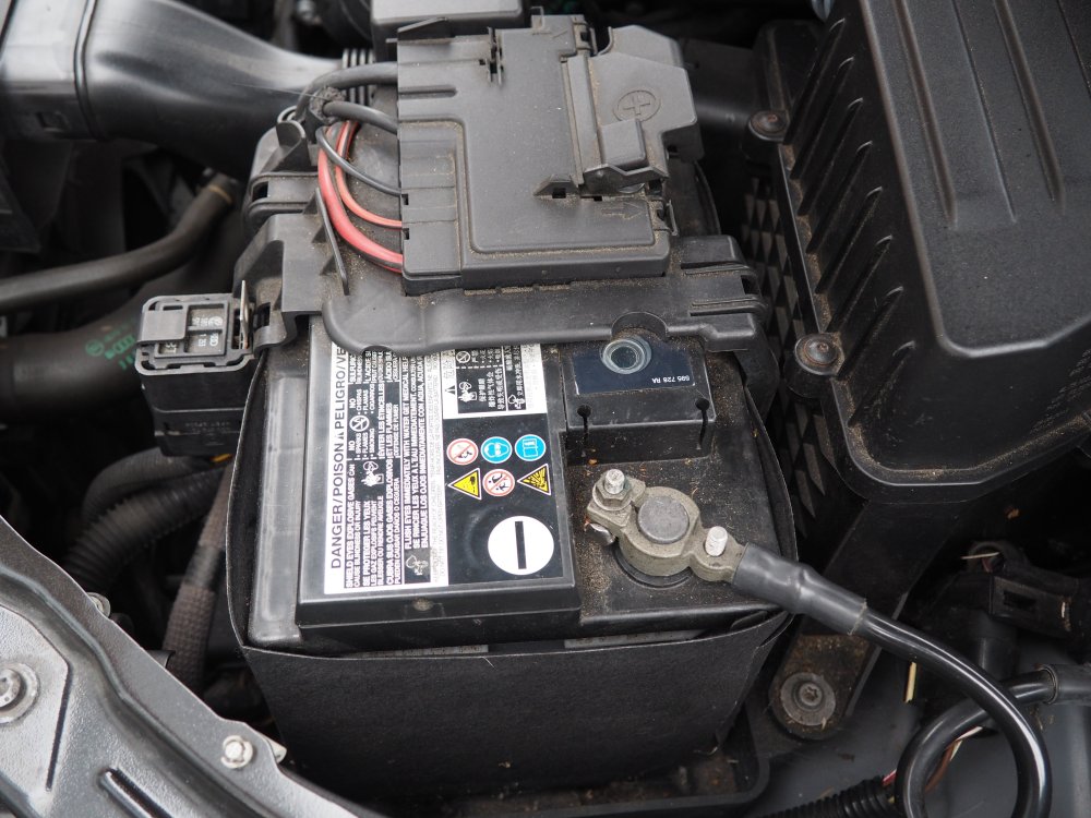

Just noticed that the new battery does not have the metal studs the negative fits over. Is just the clamp enough to keep the terminal tight?

Is that actually a stud off the battery or the post clamp, I thought it was just a fixing point for more earth wire connections - but I'm often wrong about things.

Part of the negative clamp, not battery, relax.
The felt stuff is just thermal insulation - in case you are wondering how to remove that plastic "lump", I seem to remember that it gets clamped down over the top of the battery, so to remove it, after removing the earth terminal and slackening off the +VE post clamp, feed a largish screwdriver down through the hole in each of these clamps, maybe 3 in total, press down at that point to relieve the tension on the clamp and pull the screwdriver handle towards the centre of the battery - doing that should force that clamp out and so free, repeat for the other 1 or 2.
Edit:- the top section with the wires hinges back first it also has a small clip(s).
Edited by rum4mo
My daughter's partner changed it 15 mins max. Yes so easy the myriad of connections on the positive terminal unclips and lifts off in one piece. Original battery was a Varta, 50Ah 480 'whats its for cold start ouput'. Thanks for everyone's advice.
