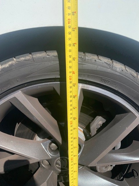

These were my measurements, measuring from the centre of the wheel arch to the floor:-
Before lowering:-
- 690mm (front & rear)
After lowering:-
- 670mm (front & rear)

I measured my Sportsline with DCC front wheel arch at 690mm
Edited by Legion
But then I couldn't compare to RS's measurements.
It would appear that the 162 with DCC is the same height as the 206 with DCC at 690mm.
