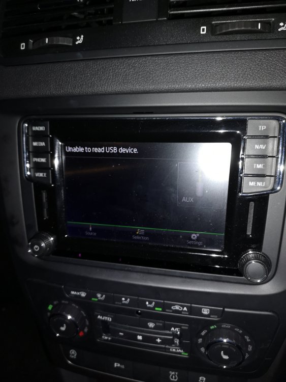

How do you get Android Auto connected to an Amundsen system? Tried connecting my Huawei phone via a USB cable, but all I get is an "Unable to read USB device" message. Newbie at this.  Am I not doing something obvious?
Not sure what that is but its not an Amundsen system on a Kamiq.  If you have a Fabia, depending on how old it is, it might not even have AA.  Usually you can either connect it wirelessly, you need to go into Android Auto settings on your phone and tock the wirelessbox (providing your phone supportts it).  Alternatively the USB-C socket should let you plug your phone into it and just load it up automatically as AA is built into Android.
Check your phone is compatible on skoda website

Cheers. It's not on the list.  What a pain.
Thanks. My phone is apparently not compatible. What a nuisance.
Do you mean the list for AA Wireless or just for AA?  If its not on the wireless list, and the car has it included in the system, then you should be able to get it via USB cable.
Thanks.  This is the site I went to: https://compatibilitylist.skoda-auto.com/#:~:text=You can check the compatibility,skoda-auto.com%2F.&text=the mobile phones were tested,at the time of testing.
I have a 2017 Yeti with an Amundsen system. The phone is a Huawei P20 Pro. It has AA on the phone but when I try to connect via USB it comes up with the "Unable to read USB device" message. Not v techie and don't know if it's a phone issue or something to do with the car? Any thoughts?
Thanks
Thanks
Check on the Skoda website for compatability
I know someone with a Yeti and AA is not built in (mat be able to be activated by a dealer).  Are you sure that AA is part of the spec for your car?
Thanks. I'm not sure, and not sure how to check. Perhaps it hasn't. Just assumed that as I have the app that I could connect via a USB cable.  Not sure I want to give a dealer any more money so will either stick to it on my phone in a holder, or use the built-in satnav.
