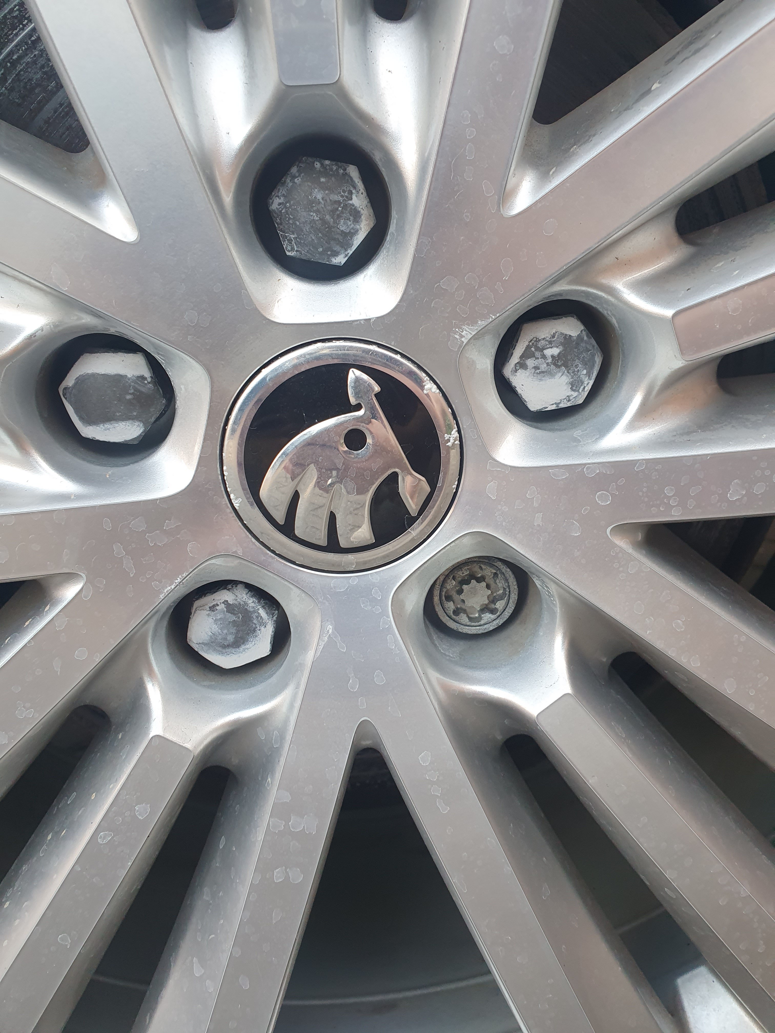

Other more minor issues include scratches on the skoda sign in the middle of the wheels, missing wheel nut covers and some weird white coating on the existing wheel nut caps, some weird white spray on the silver window frame drivers side.
Nut covers were notorious for coming loose on earlier cars. The white 'milky' coating is actually a form of corrosion - it's been a common problem on ALL VAG models for at least the past 40 years!  These are typically replaced under manufacturer warranty but if you're driving a 2018 car bought outside the Skoda dealership then don't expect Skoda to come to the rescue. If it's just the centre caps then you're only talking a few pounds to replace them. Same with nut covers.

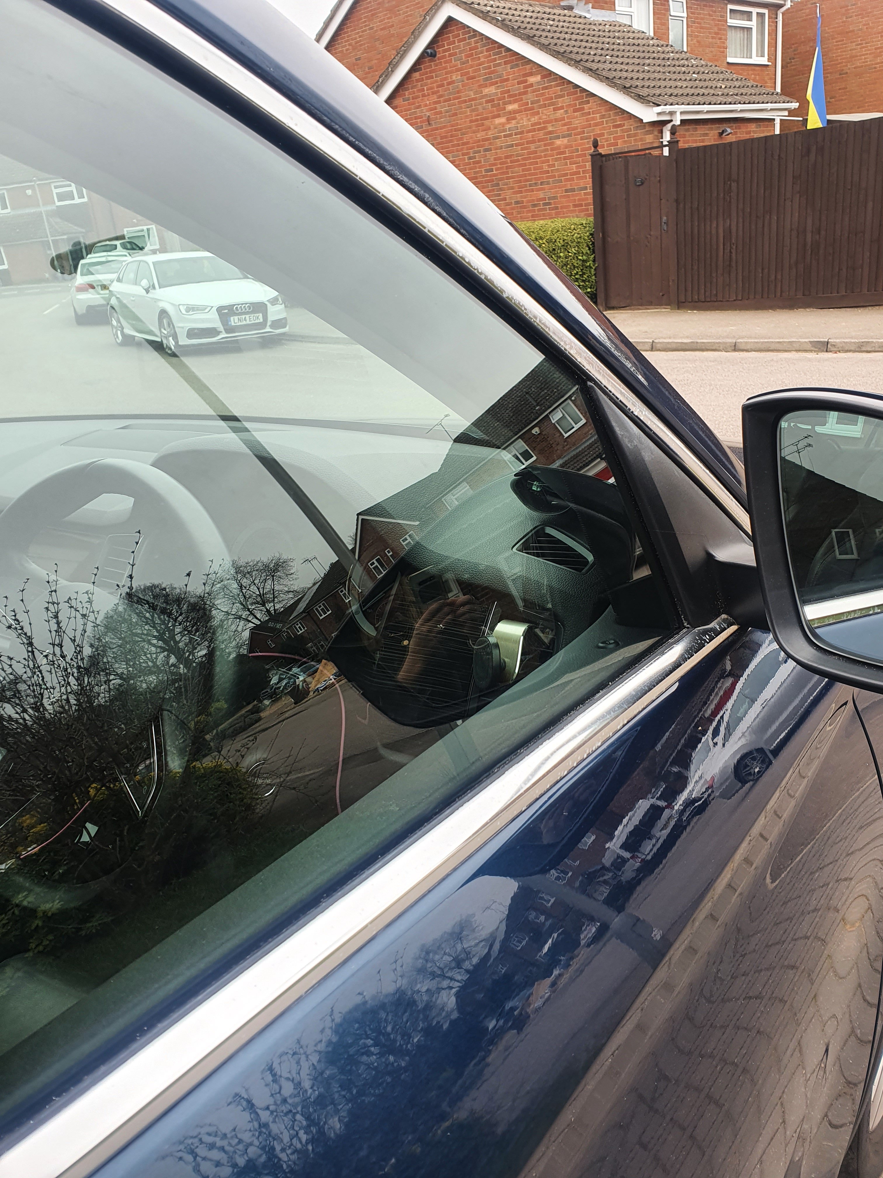

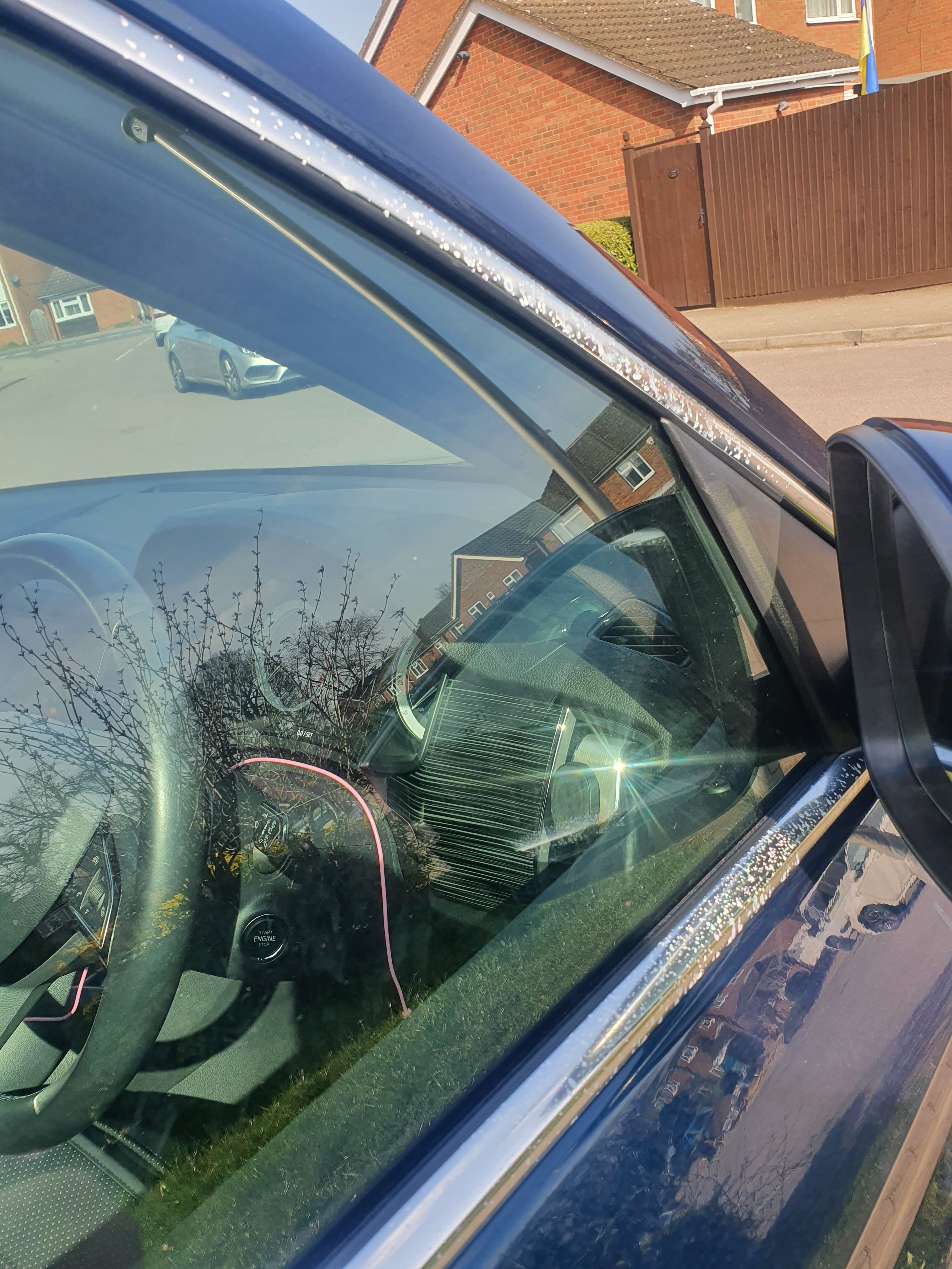

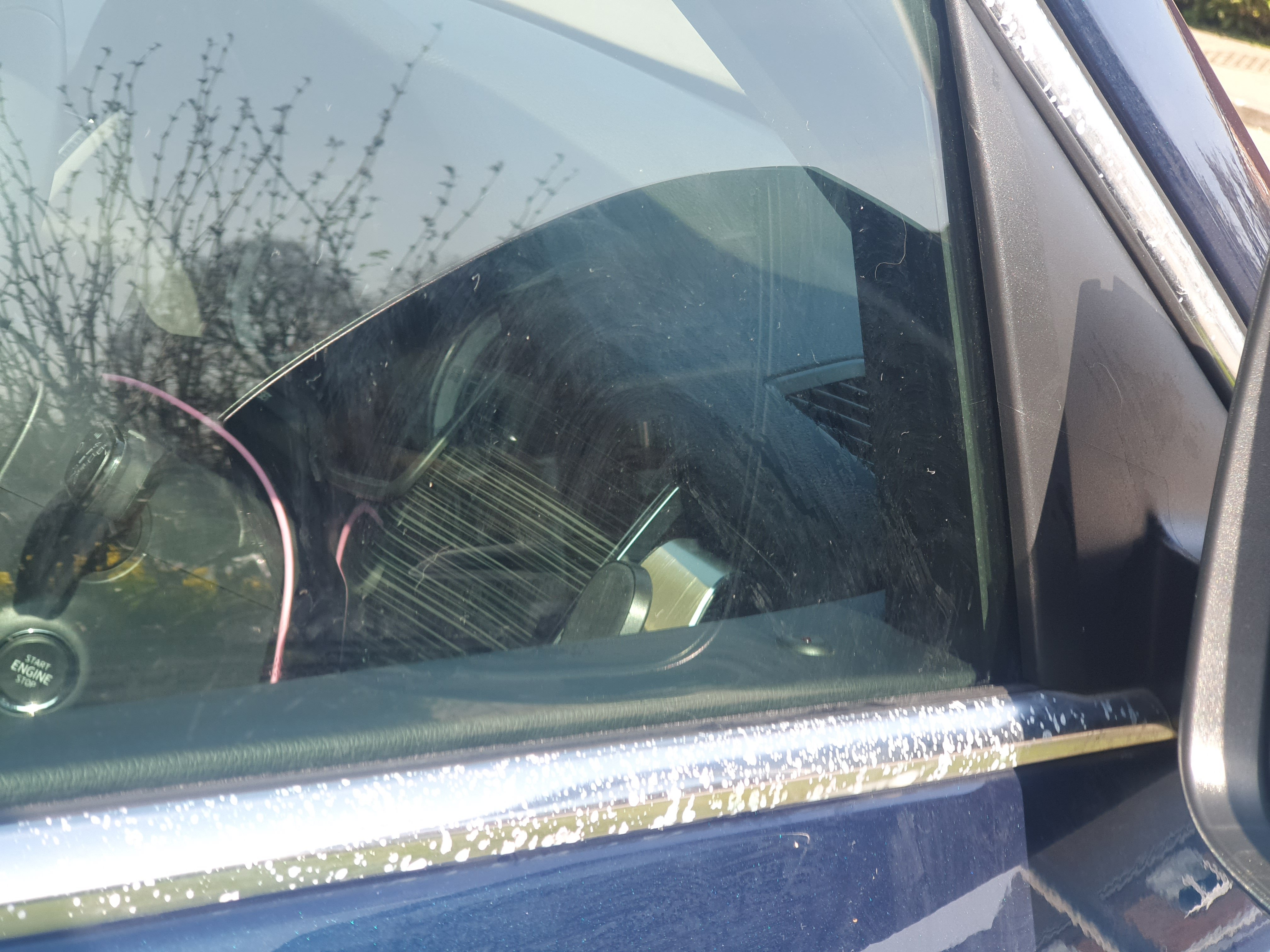

20220325_132437.thumb.jpg.d56fccf1d1f92b92c5eb6e769c04af11.jpgA couple of pics
Looks like aggressive cleaning agents have been used, probably by a local roadside hand wash  gritty sponge crew.

Also - the white marks on the driver's door silver trim; that's damage from traffic film removers when cleaning the car in hot weather. It's very common on VAG cars. It happened to my Kodiaq twice; once caused whilst at the dealer's for a service when the cleaned it and once when I took it to a hand car wash, both in Summer, bright sunshine and over 30c. You'll need to get the trim changed if you want to see an improvement.
The damage to the nut covers will have been caused by the same.

The chrome window surrounds are best tackled with a specialist metal cleaner (available in big supermarkets, where tap and stainless steel cleaning trigger bottles are).  Should get it lot better, but if they have used something heavily corrosive in past then might never be perfect unless replaced.
