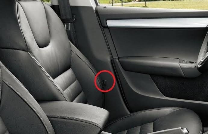

There’s a button on the b pillar?
Not on all models, on some the interior monitoring is disabled through the radio
Yup.

Found it today, never noticed it before :o

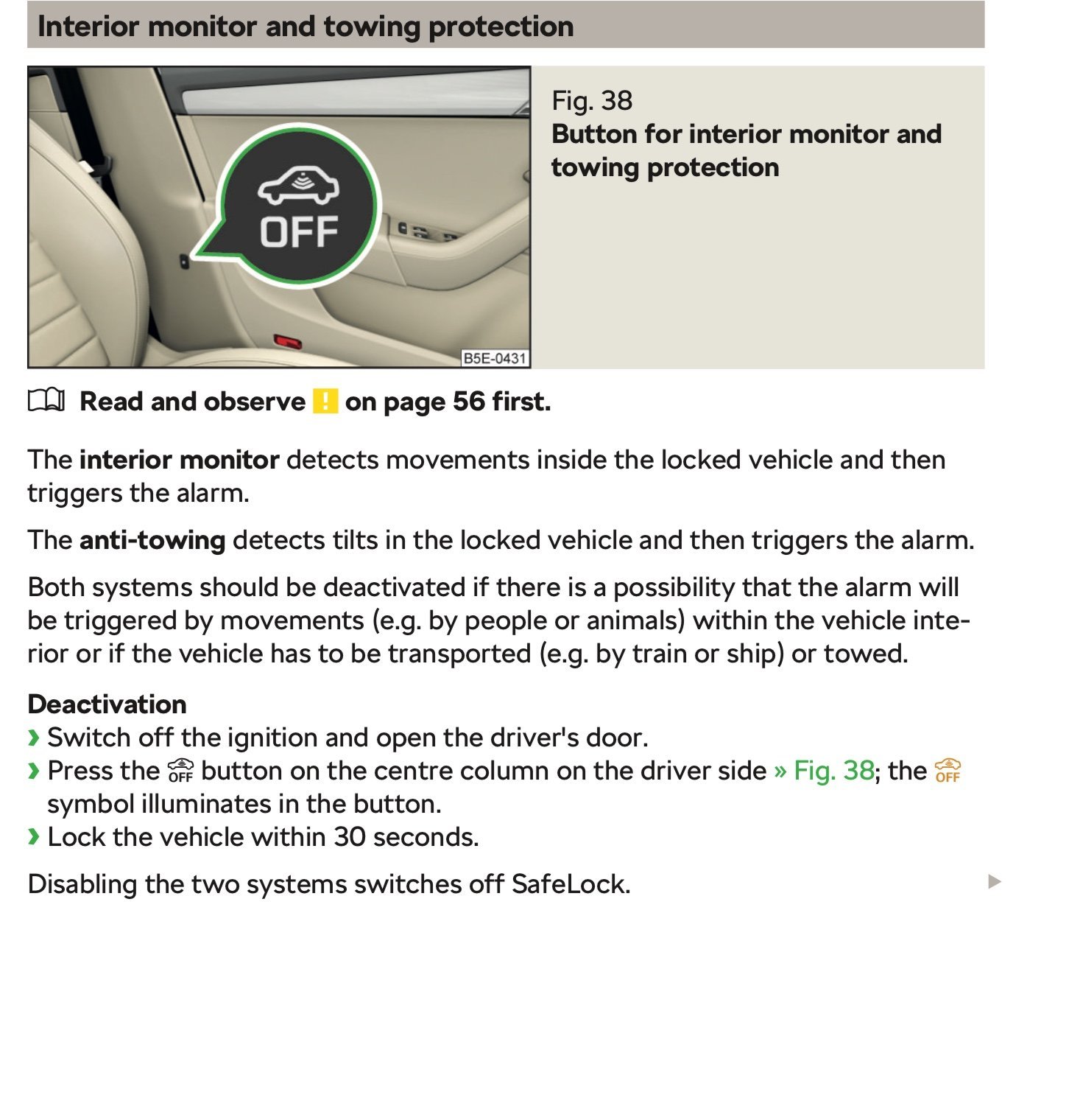

Sorry, late to the party on this, but we will be taking the car on a ferry.  How do you disable the ‘anti-towing’ alarm? There is no button on the B pillar, so I realise it’s through the infotainment….interior monitor tick or untick, OK, but it looks like there is anti-towing as a separate item on page 59 of the manual and I can’t see how to disable this?
Thanks in advance.
Try pressing the lock button on the remote twice (straight after each other). It works on our 2020 model and on my old 2014 Leon (gone but not forgotten) but my 2017 golf has the pushbutton on the pillar - strange
Edited by geordiebloke
Spelling
I have just re-read the manual and noticed that it says these, (not this0, functions can be deactivated simultaneously in the infotainment menu, so I guess that means if i deactivated the interior monitor that will also deactivate the anti-towing alarm.
So, if you see me pushing a car off the ferry in Santander with a flat battery, I have misunderstood the wording !!
Deactivating by unticking the box in the infotainment will work fine for the ferry but beware it resets when you unlock...   So don't lock then unlock then lock again.   Just unstick, turn off the engine then get out close all doors and lock.
