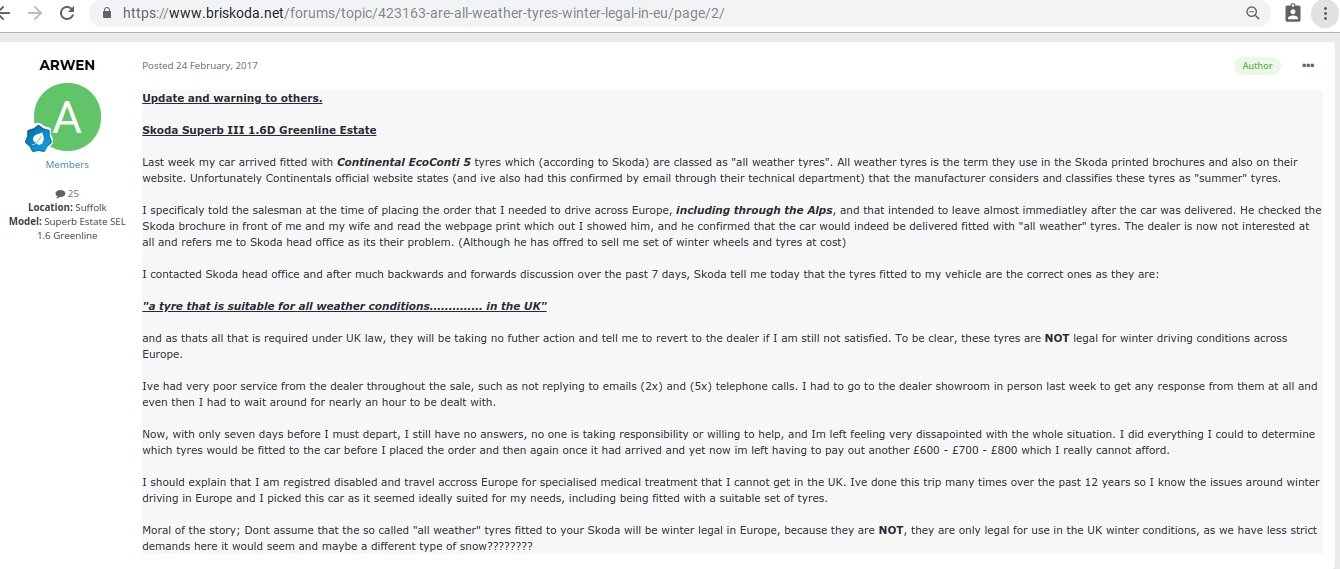

Skoda did show as a choice & OEM fitment  at one point All Season tyres on Octavias & Superbs in the UK according to the configurator / brochure.
 The posts on here were about getting 'All Weather tyres',  with a Superb Mk3  SEL Greenline estate' as a member thought the car would arrive with.
'All-weather tyres 205/50 R17 89H (NAR) 17" Drakon alloy wheels.'
They turned out not to be All Weather Tyres and were not '3 peak' / 3pMSF so they would not have been legal if you had been going to any region of Europe that required 'Winter tyres'.

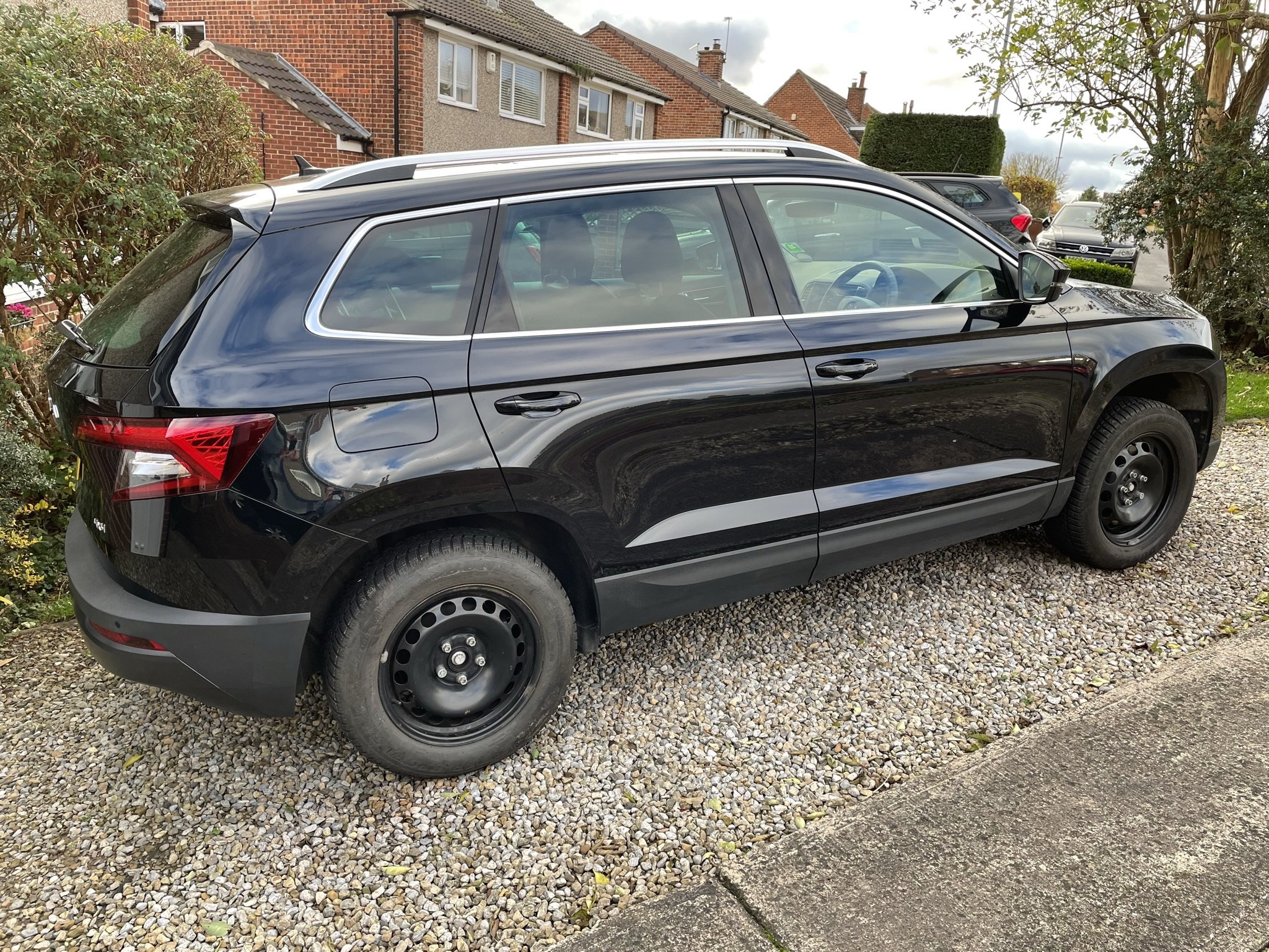

This is my car on its 16” winter tyres . Please note that you can only officially use 16” with winter tyres fitted.

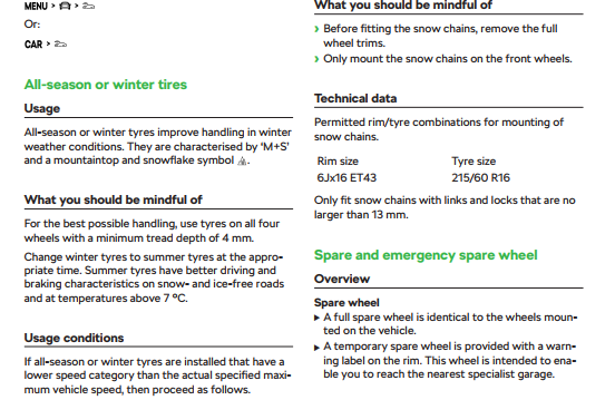

Hi
I think you may have misread the manual which states that the permitted Rim size for the fitment of snow chains is 16"
There is no mention of a size restriction in relation to the use of 16" rims generally, nor that winter tyres need to be fitted on 16" rims.
When swapping my OEM 18"'s for 16's I checked with Skoda UK and my dealer that 16" rims were allowed for normal / all season road tyres, both said yes no problem.
I called my insurance company (LV) to inform them of the change and they just made an update to my declaration regarding the vehicle for no additional charge (either administrative or on the premium)

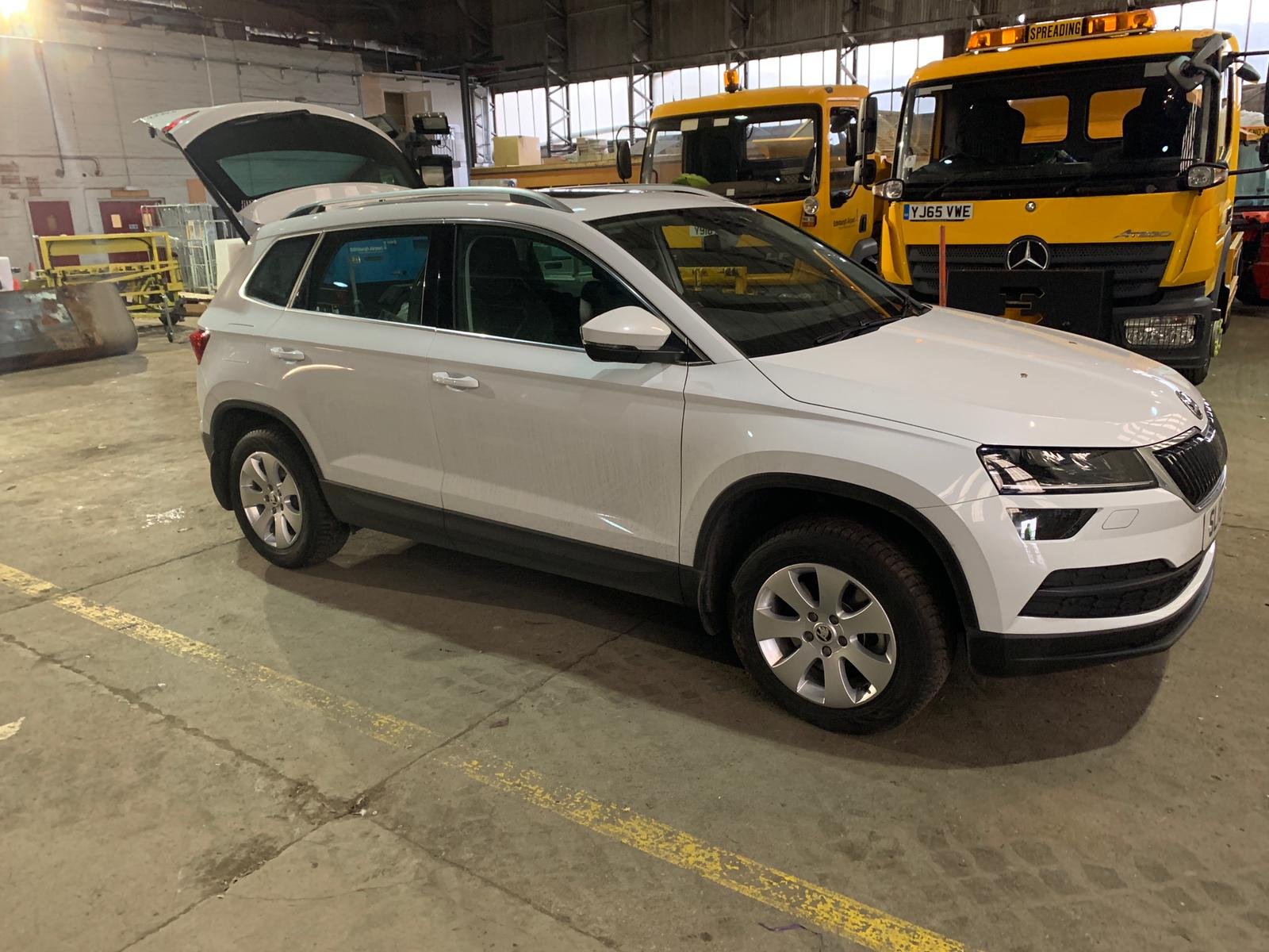

Here is a pic of our Karoq on its 16's.
Some might say it looks odd, but the diameter of the wheel / tyre combination is exactly (it has to be) the same as other rim sizes.
Neither of us require the F1 type handling that low profile tyres afford, we prefer a softer more relaxed approach.

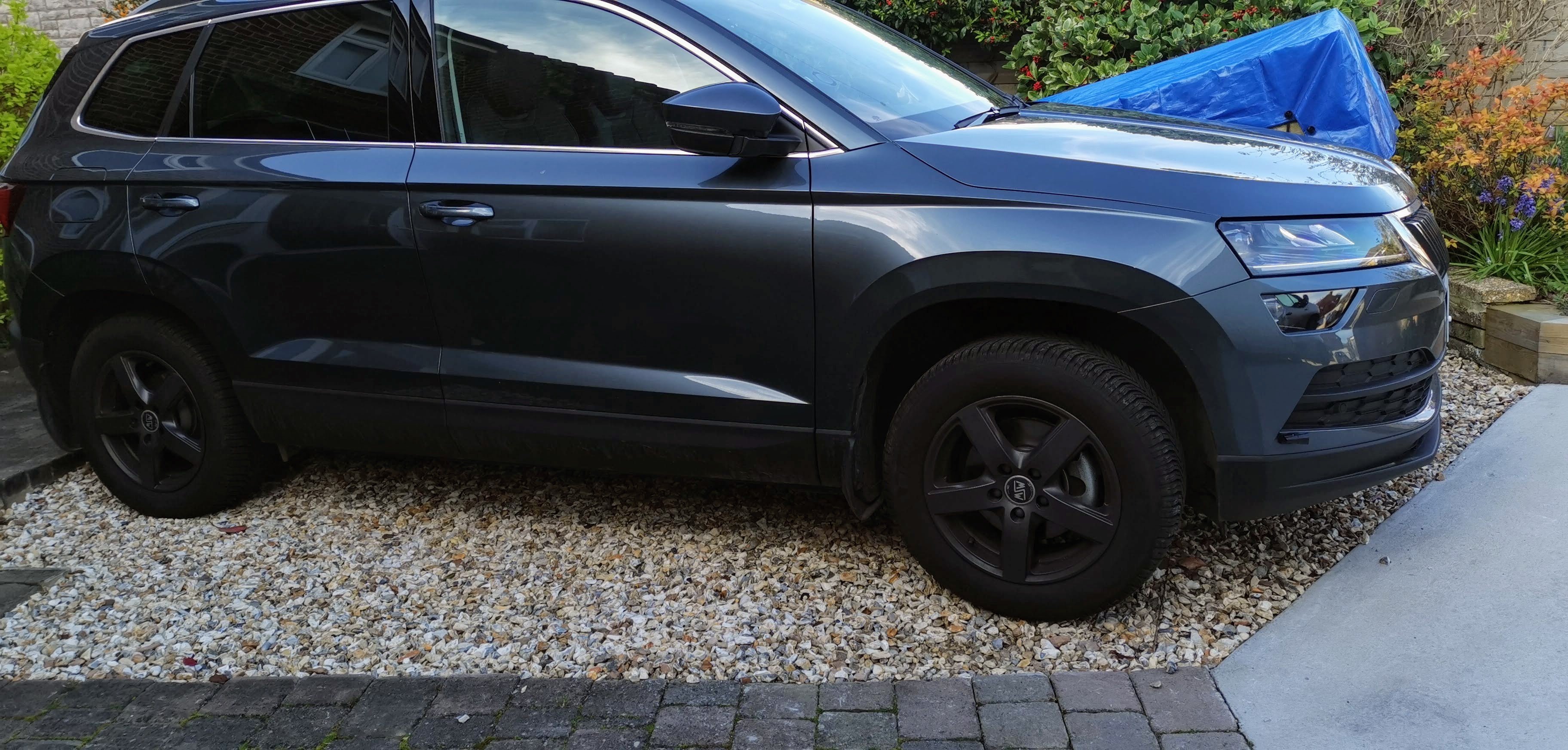

When my son had his Karoq, he used my old Yeti 16” winter wheels instead of his standard 19” wheels  during the winter months.
