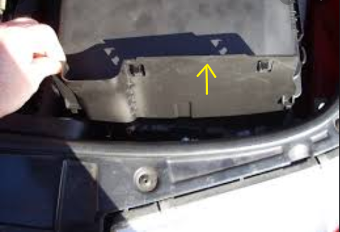

The light on the battery side of the car can be tight to access but on some models there is a cover on the battery box that you can slide upwards and remove to gain more room.

Drivers side is really easy, passenger side needs you to manipulate the cover a bit to get it out of the engine bay due to the battery box being a bit close. Unclip the cover and move it towards the radiator. Turn it so it stands on end, and it comes out fairly easily.

As TMB says, passenger side dip /main beam poses little problems. But depending on model, you may have to take the battery out and remove the battery sleeve to get access to the main beam one.
