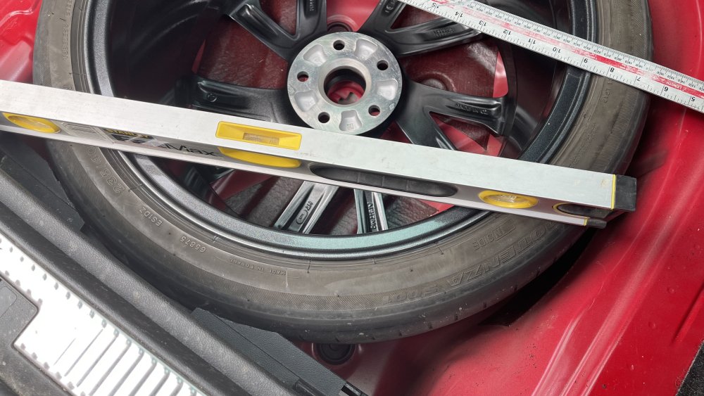

My 2020 Superb Sportline Estate is the first car I've owned without a full size spare. Instead it came with a foam spray can thingy. Time to put that right...
Vega 19" wheel purchased and 235x40 tyre fitted...
Only it doesn't fit in the spare tyre recess under the boot!
Out comes the angle grinder to cut the plastic on the inside of the boot lid and in it pops.
Only the recess isn't deep enough and the wheel sticks out around 25mm.
Next job is to put a double layer of 12mm ply with some damping under the boot liner. No probs to do that.
Can anyone please advise the correct spare wheel holder screw and where to get it. Also looking for recommendations for a suitable jack and wrench. Cheers

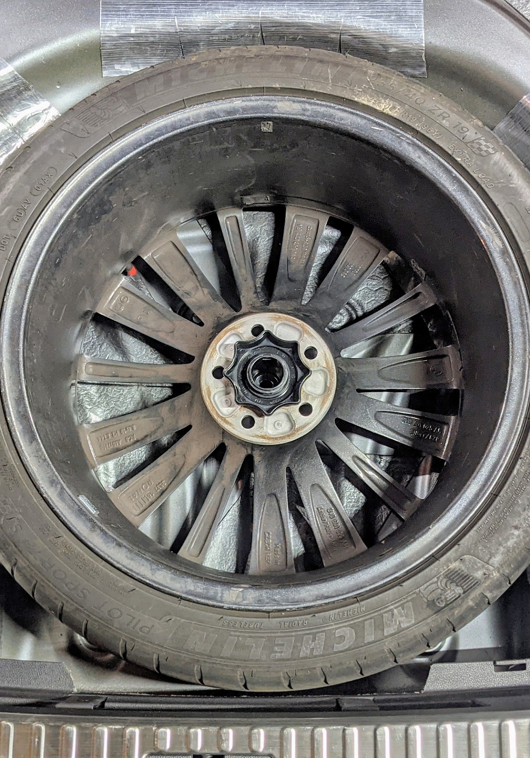

But to answer your question, the parts are as follows
3v0012115e - foam insert for a 18 inch spare, no 19 inch spare available
6q0867749 - strap for foam insert
4d0012219a - wheel wrench
3q0011031a - jack
5q0011221 - jack arm
3g0803899e - big screw and nut for securing the wheel

Did you need to raise the boot liner around 25mm to get level with the tyre (235x40)? If so what did you use?
I used some plywood cut out the the boot liner template and some packing at the seat end, it is a handy storage space, hidden from sight.
I simply put a layer of Car Builder's Stage 2 Acoustic layer on the boot floor - added about 12 mm thickness, and added bonus of noise dampening.
I hardly notice that slight bend in the boot liner.

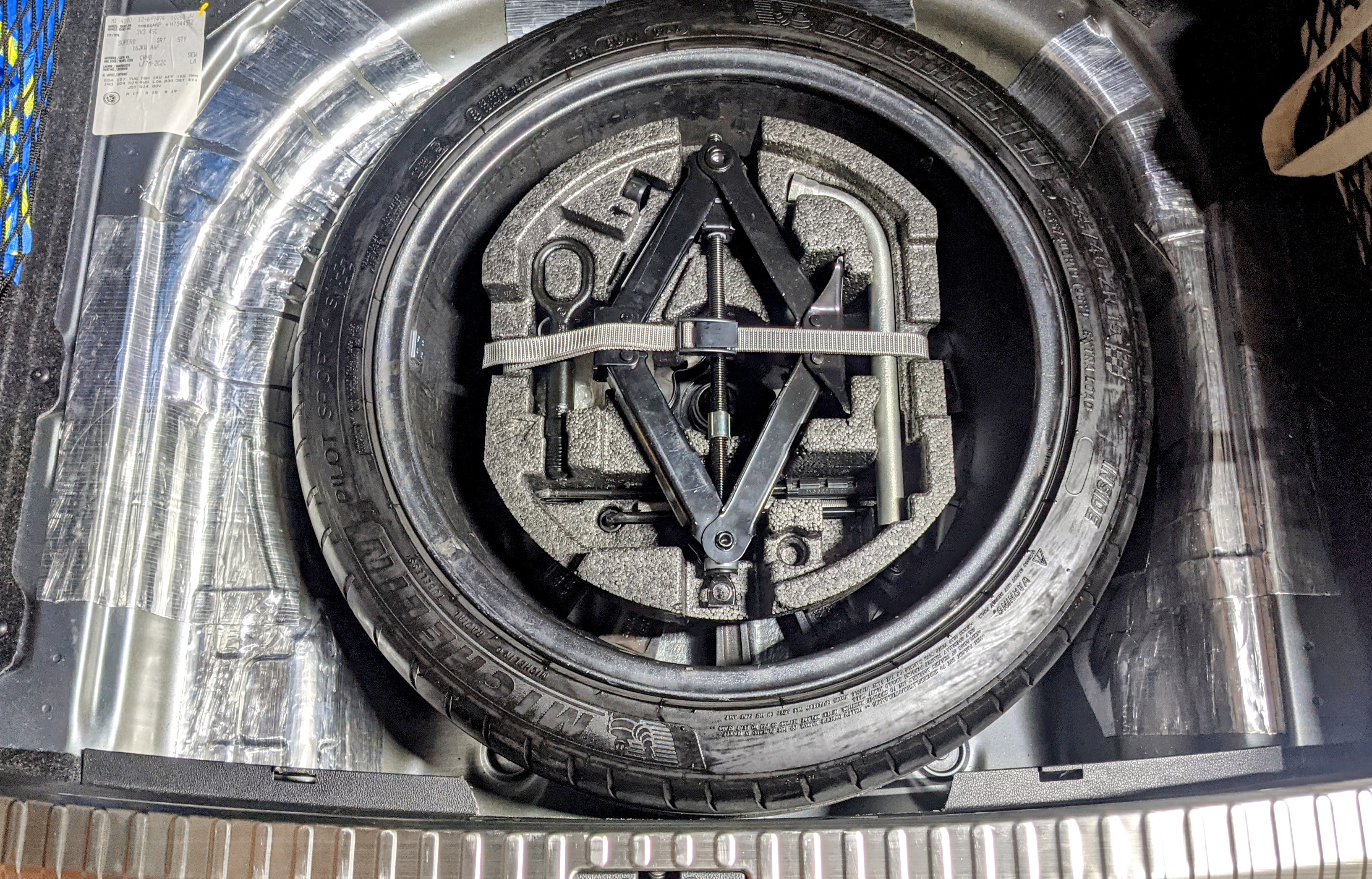

You should be able to order the below spare wheel kit which includes the foam, jack, and tools from a local Skoda dealer using OEM part number 3V0093860B. Only the spare wheel is then needed. 215/60R16 fitted to a 6J rim such as 6Jx16 ET40 (from a Superb MK1) or 6Jx16 ET43 (from a Karoq) should fit flush. 215/60R16 fitted to the standard 6.5J rim apparently sits a few millimetre too high. It sounds like Skoda made the wheel well to fit something like a 205/55R16 fitted to a 6.5Jx16 ET46 rim from an Octavia MK3 (which they sometimes sell as a spare wheel for the Superb MK3), although the outside diameter of a 205/55R16 tyre is about 5% smaller than Superb MK3 tyre sizes.
You can check with the Skoda dealer using your car's VIN that this will fit your car.
1,359.00CZK is about £46.16.
Spare wheel kit for Superb MK3
Spare wheel replacement kit
https://eshop.skoda-auto.cz/cs_CZ/sada-pro-vymenu-rezervniho-kola/p/3V0093860B

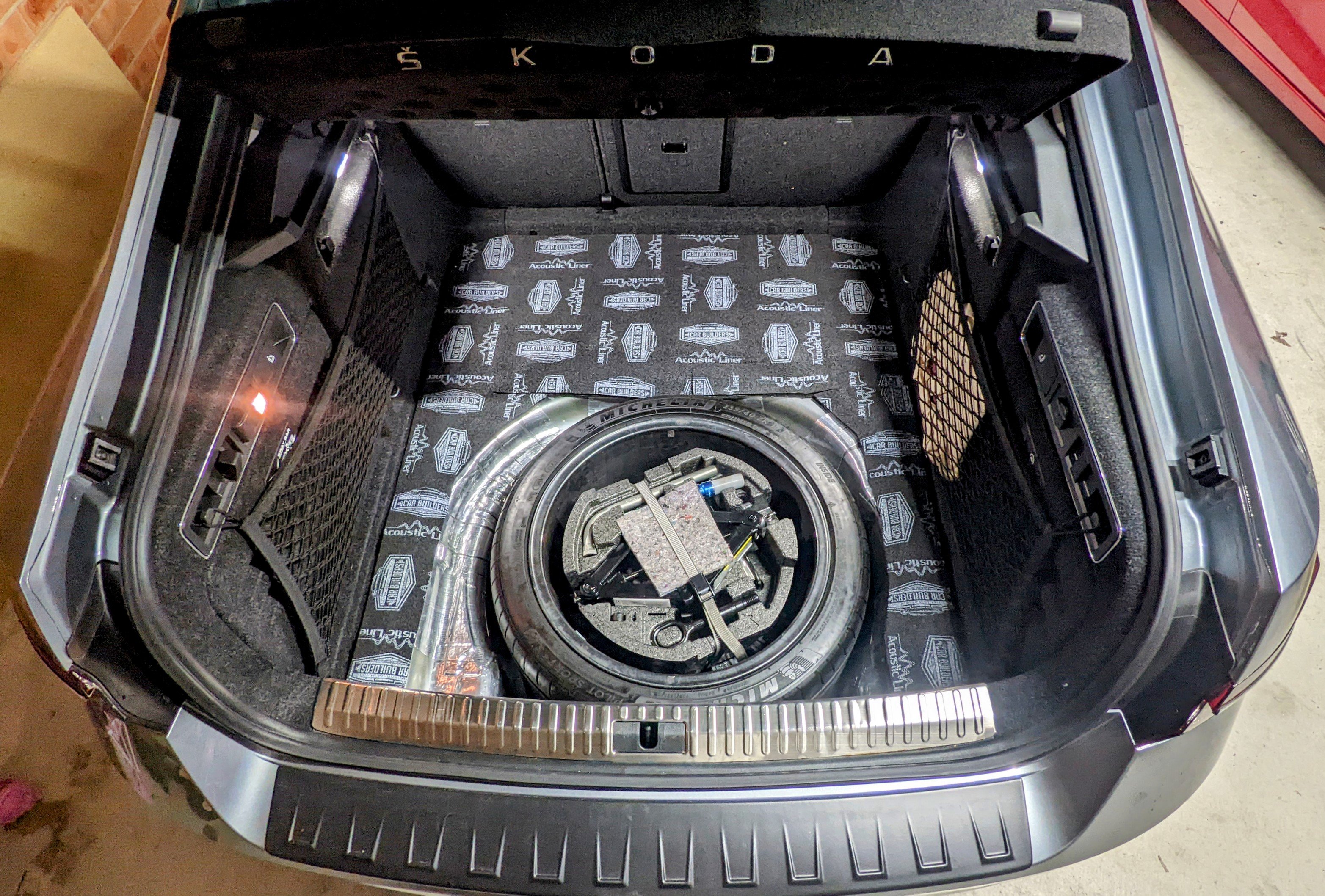

Spare wheel now fitted and screwed down
19" Vega wheel c/w 235x40 tyre
Plastic inside boot lip trimmed with angle grinder to get wheel in
A scrap bit of ply placed over the wheel hollow to support the boot liner. Hole cut out of ply to keep things flat where liner hook is. 12mm ply used with edge reduced to 7mm to sit flush in wheel.
25mm polystyrene on boot floor to level with tyre height. Intention was to use doubled up 12mm birch ply (lighter than normal ply) but the war in Ukraine has stopped supply from Russia. May do this later?
Boot liner replaced flat and supported with boot floor now raised 25mm
