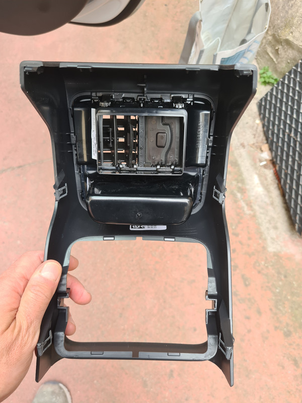

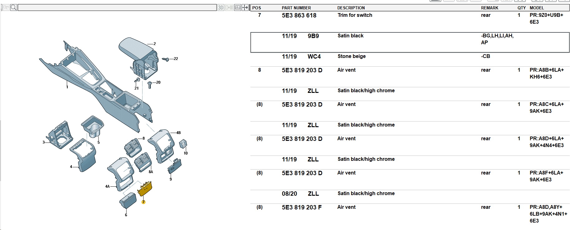

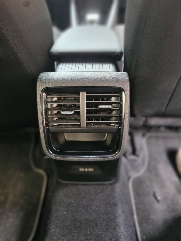

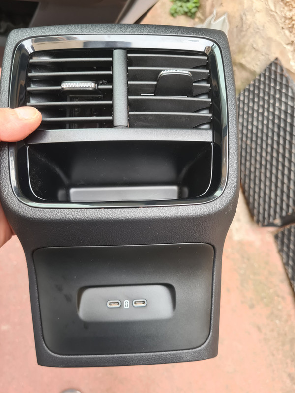

I am willing doing this retrofit.
I currently have the plastic trim with the 2 holes for the USB ports to fit through. The code is 5E3863618 (9B9)
The hard part is the wiring. There is no wiring in the car so if someone wants to add these ports they have to build it themselves.

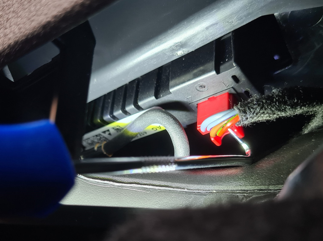

I'm thinking of getting power from the wiring of the front USB ports.

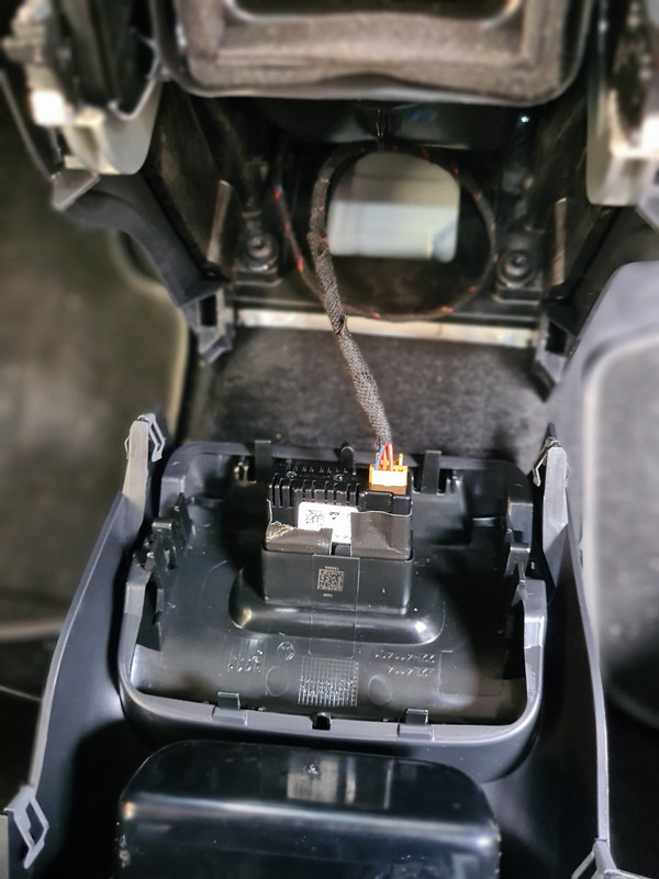

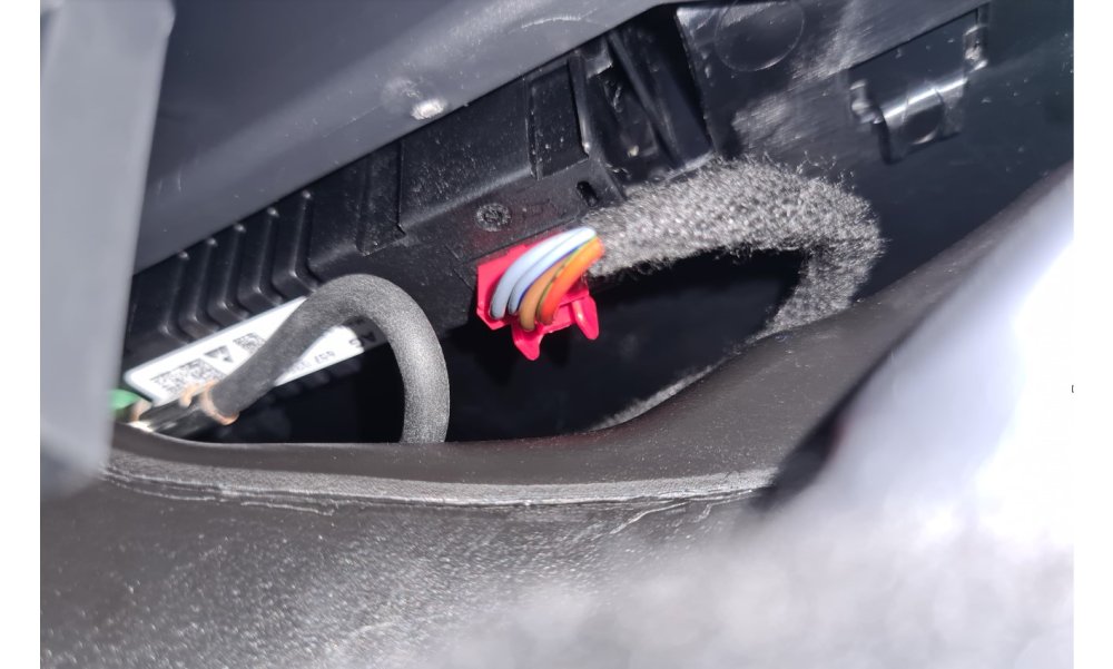

This is the existing connector for the front USB Ports
Only take the power leads from the front to the back, not the data leads - you can't have additional media sources for the infotainment system.
Yes only the power connector.

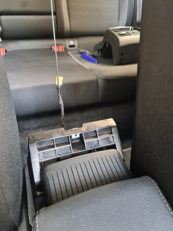

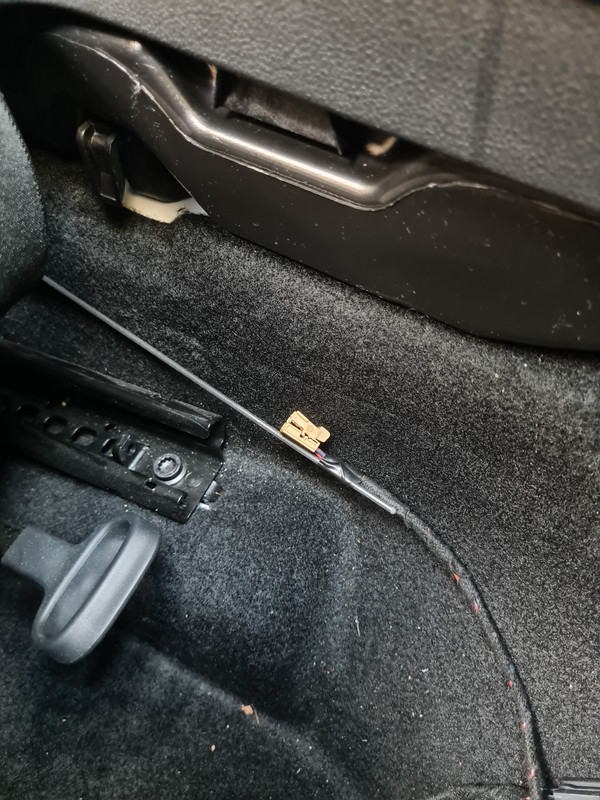

I made a wiring myself buying some connectors. I have come this far
Really interested on how it will turn out as I am also really looking forward into adding the rear usb to my car. Hope you will get the topic updated so we all can benefit :)

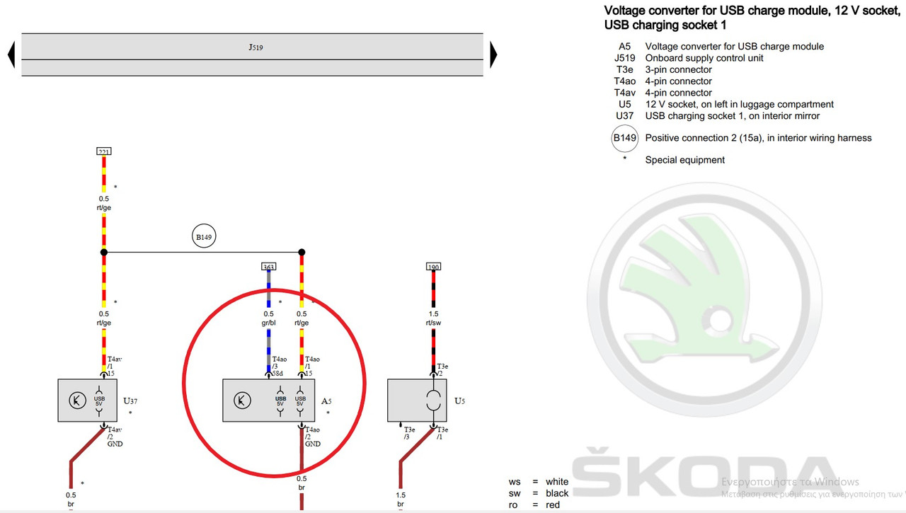

@s3bek for the wiring, if I am not mistaken, you have the wiring section on the wiring diagram, for connector A5 0.5 mm2 wire section.

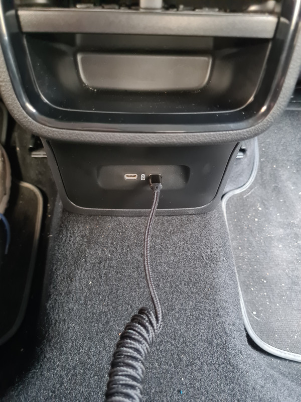

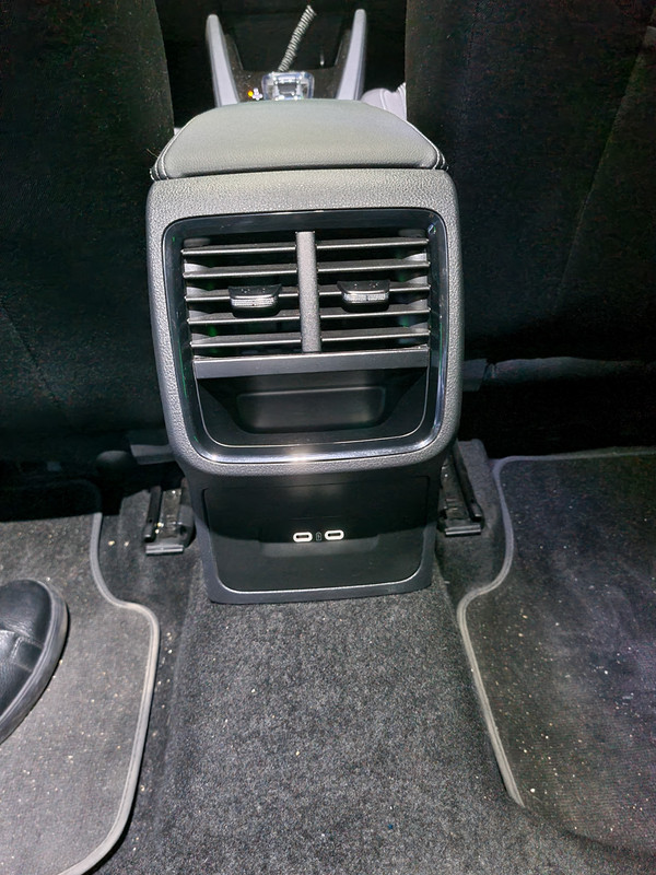

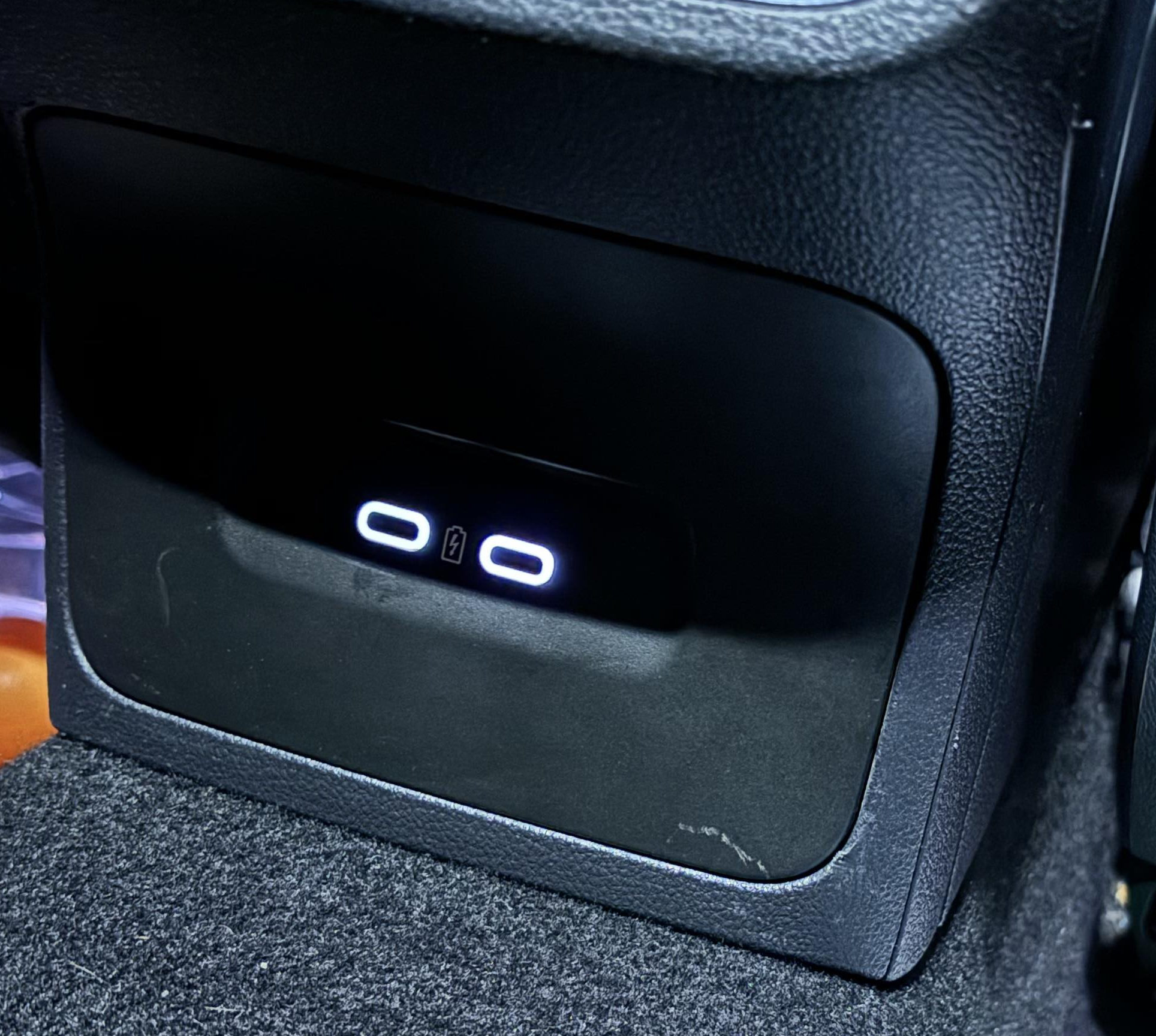

And some photos at night.

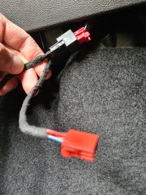

no, there is no chance of that happening.

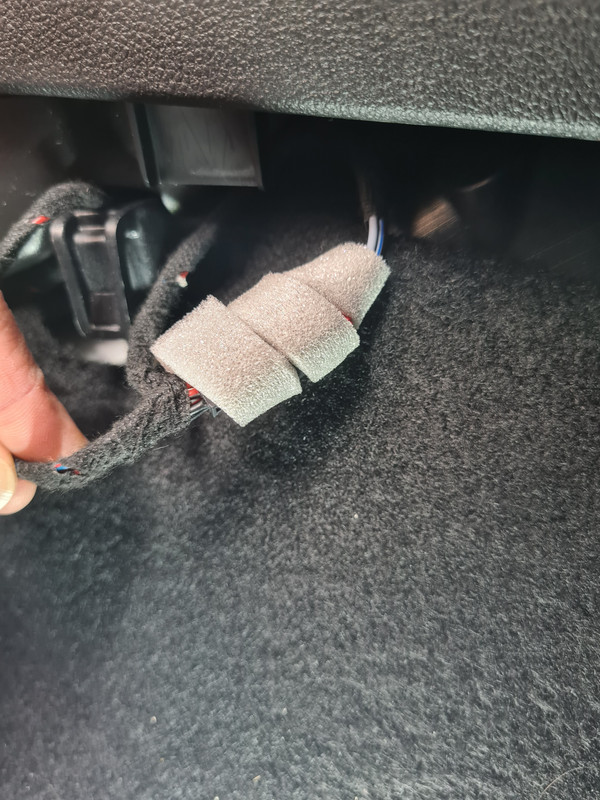

The plug I use to connect it is for power only, not data. Please see the following picture.
Thanks for clarification, now it's clear.
I didn't know, that they have separated power and data to separate plugs, as it's rather uncommon. Good to know.

Plastic (decorative face) is not suitable for our cars. You must buy the correct one, I gave the part number a few posts ago, this is: (5E3863618 (9B9))

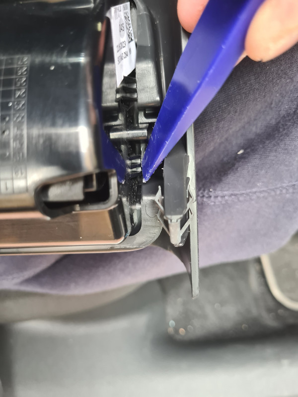

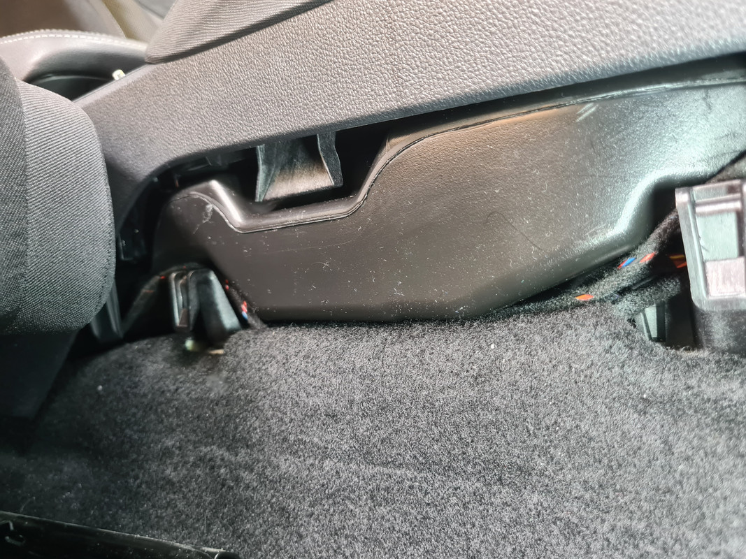

I just wanted to drop my thanks to Giannis20 for this guide, it helped me install it on my '21 Octavia. I didn't use the black connector, I just got the USB module, the trim and the cable from a write-off vehicle and just connected the pins 1-3 with WAGO connectors, I assume it was easier with the black connector extender, but I didn't have it handy.   And as you said, Giannis20, the space under the front module is quite narrow and there is not much cable to use.
