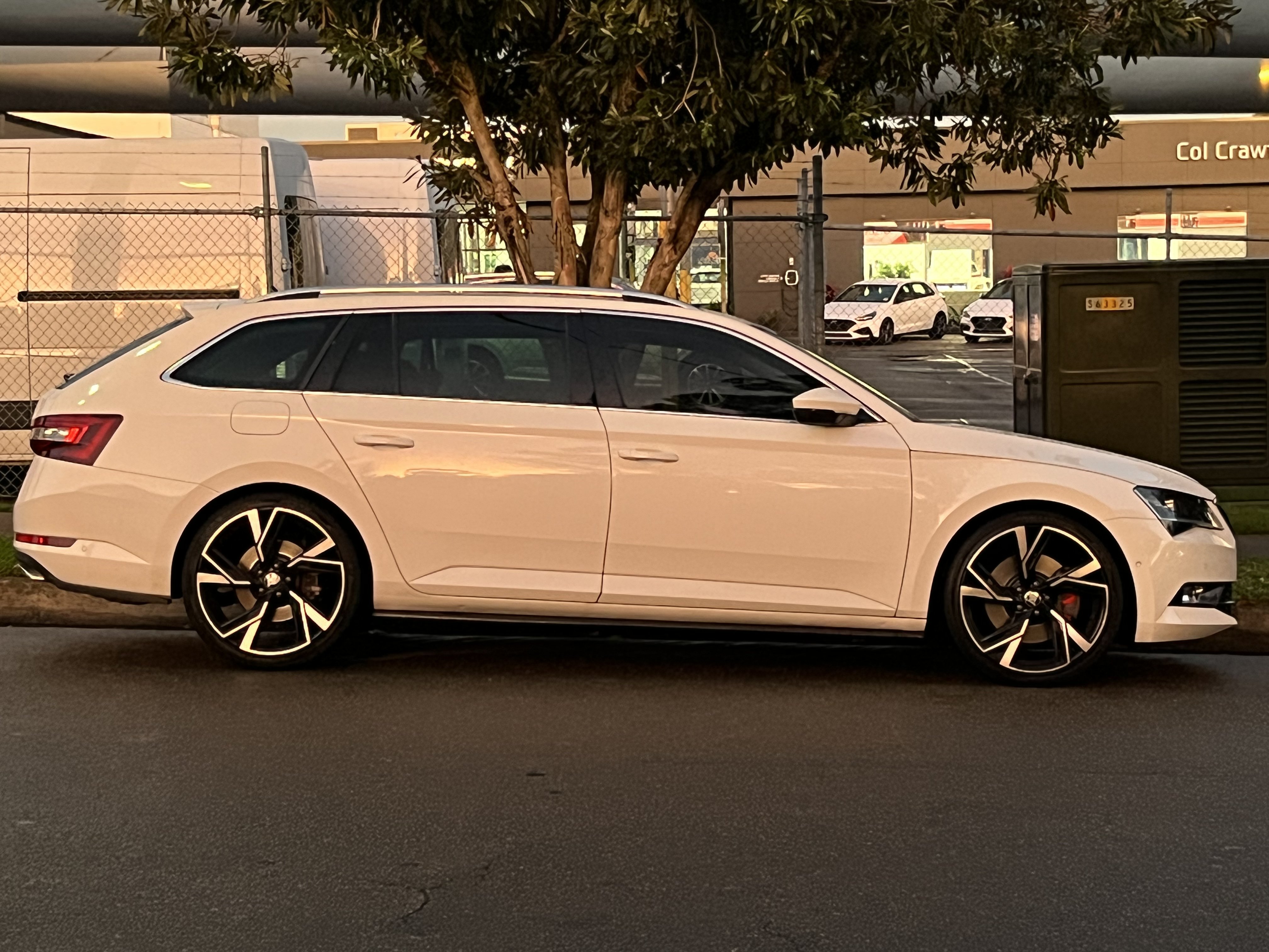

I got a 2019 Superb 2.0TDI FWD 150hp.
I recently bought 19" rims but since the car was imported with increased ride height, it looks ridiculous lol.
What I would like to do is install the standard coils under it instead of the increased ride height ones. Does anybody know the genuine numbers for that one, both front and back. Partslink have about 26 genuine number but impossible to find the correct one.

Thank you. I’m also not interested in dropping the car too low. I actually recently changed the wheel and tyre combination to 245/35R20 tyre with 20x8,5" ET35 as I was gifted the rims used from a friend. Originally wanted to stick with 19s but am quite happy with the comfort and the roads near me are quite good. The rims fill the arches out nicely although the combo does lift the car almost 9mm through increased tyre diameter which has inadvertently helped avoid scraping in our steep driveway. Speedometer error has been accounted for and was about 1%.
Really just trying to keep the current aesthetic in terms of ride height. This is the car unloaded.
those Goodyear tyre’s look really good. I’ll be looking at those for our Tiguan. I’m currently running Khumo PA51 AS on the Skoda which are helpful getting around at the snow and are a nice soft compound.
If your rear springs are currently 3Q0511115AL, then maybe try the next stiffness up in the hierarchy, ie. 3Q0511115M, as this is a relatively cheap and easy upgrade to try.
