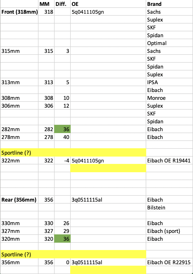

Seems like @Carlston got the insites 🙂
I have a 2019 Superb Combi/Estate 2.0 TDI (FWD 150hp) DSG, but without DCC.
I am out replace the standart (very soft) springs with the springs found on the "Sportline" edition (that is around 15mm lower).
My current spring OE numbers are:
Front: 5q0411105gn
Rear: 3q0511115al
Do anyone know the OE numbers for the "Sportline" replacement springs and what are your recommendations?
(I am not looking for Eibach pro-kit, H&R etc. with +30mm lowering of the car, that is way to much for me).
PS. I have searched all over - attached is what I got so far 🙂
@MartiniB Okay I see your point, but in my case wishing for a 15-20mm lowering of the car incl. getting rid of the "boat soft feel" what specific front and rear spring should I ordre from lets say Eibach? I can not figure it out 😅

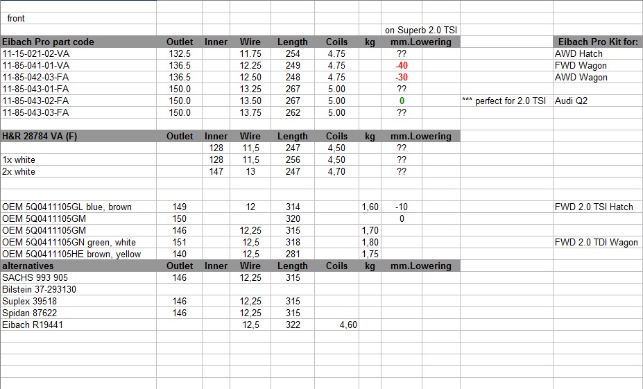

@Kasper_DK
browse link i posted above
@MartiniB I have checked your link and maybe I am a bit “slow” but it seems like you are listing DCC springs?
I have also checked you excel line up - but I can see the “matching” front spring for:
3Q0511115AB (+20% stiffness)
https://www.autodoc.co.uk/eibach/18112504
NB it should match both "1JC+0YD" and lowering height so that the loweribg height is the same front and rear.
thanks again for you inputs 🙂
NB it should match both "1JC+0YD" and lowering height so that the lowering height is the same front and rear.

Standard ride height weight range 5 rear spring 3Q0511115M
Eibach R21093 (Length 361mm, Number of coils 8.3, Wire diameter 13.0mm)
https://www.autodoc.co.uk/eibach/18112500
Standard ride height weight range 6 rear spring 3Q0511115N
Eibach R21706 (Length 357mm, Number of coils 8.3, Wire diameter 13.5mm)
https://www.autodoc.co.uk/eibach/18112503
Increased ride height weight range 6 rear spring 3Q0511115AS
Eibach R22930 (Length 367mm, Number of coils 8.3, Wire diameter 13.5mm)
https://www.autodoc.co.uk/eibach/18259221
Edited by Carlston
Thanks Carlson, your thoughts are much appreciated! 👍 Think I'll go with the standard height, weight range 5 then (3Q0511115M)
Hello group!! :) I wanted to restore the standard suspension height in my Superb 3 Estate 2.0 tsi 4x4 272 whit towbar
with the off-road package
Orginnal setup
Front spring  is 5Q0411105HS PR-L31
Rear spring is 3Q0511115AS PR-UC7+0YF
So, following the topic, I chose spring
Front 5Q0411105GN PR-L08
Rear 3Q0511115N  PR-1JA+0YF             Is this a good choice?
