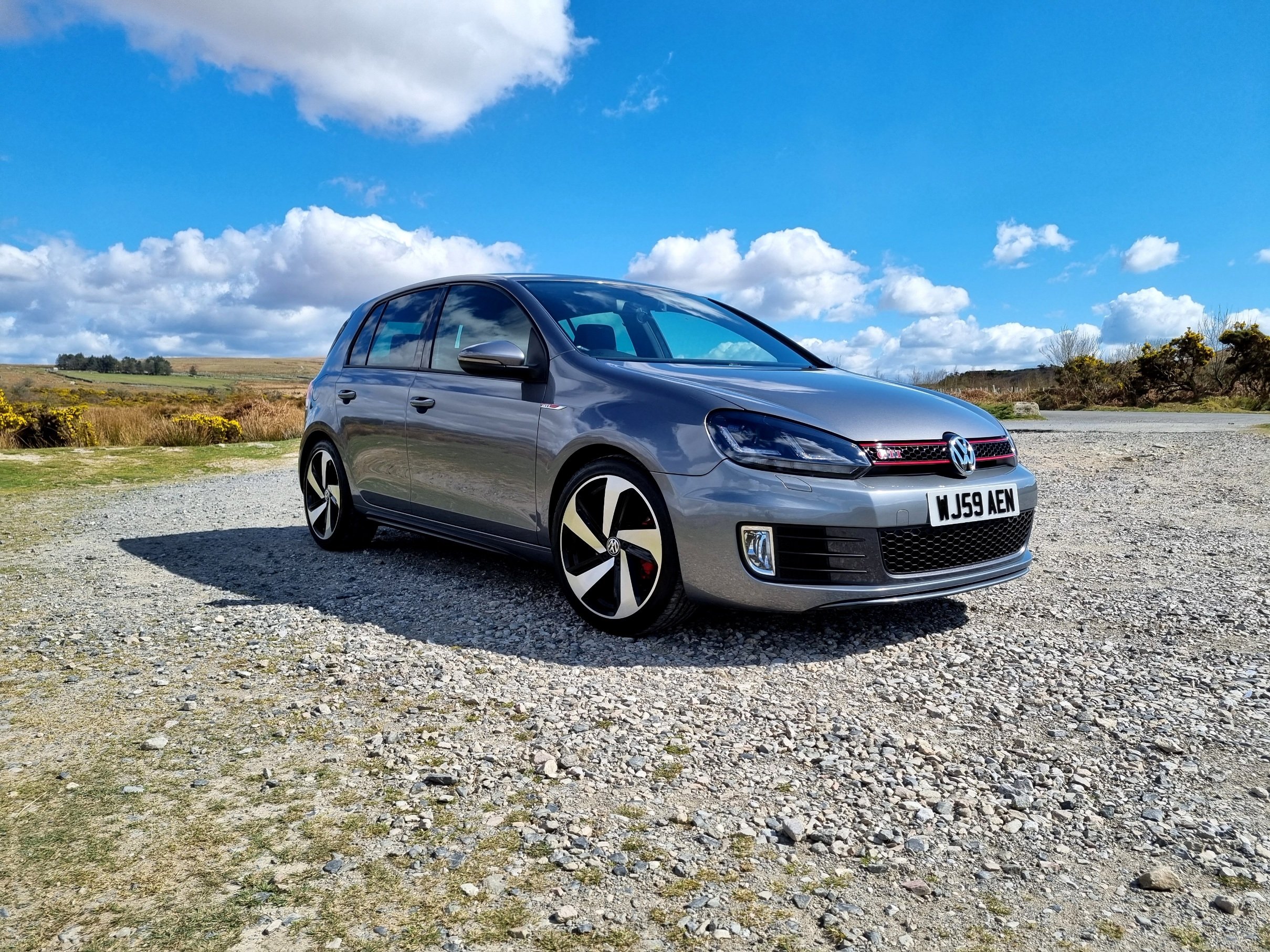

-VW Golf MK6 GTi, MK7 alloys, Stage 1 map. Cost lots as changed clutch and cam chain.

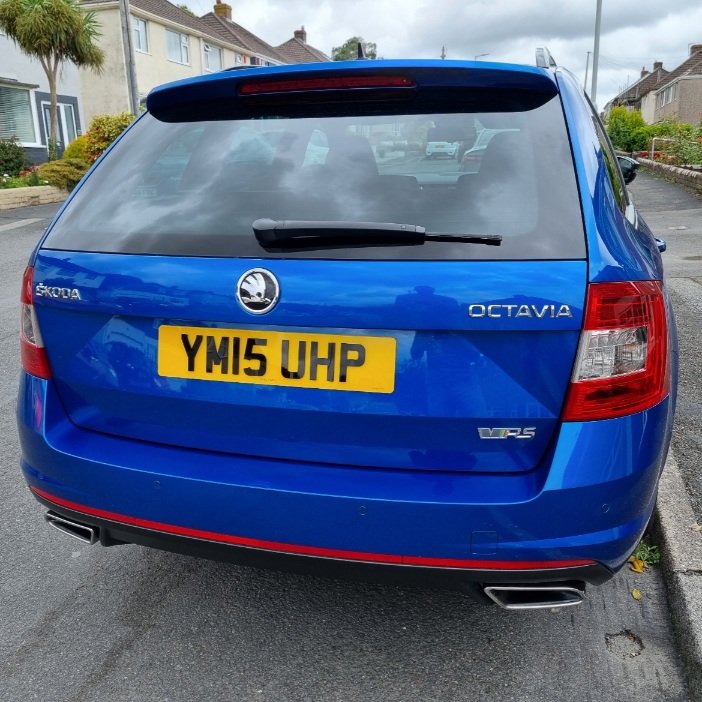

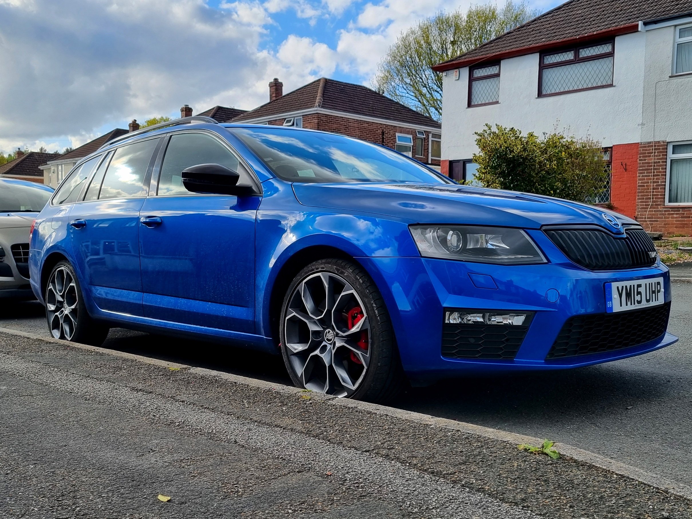

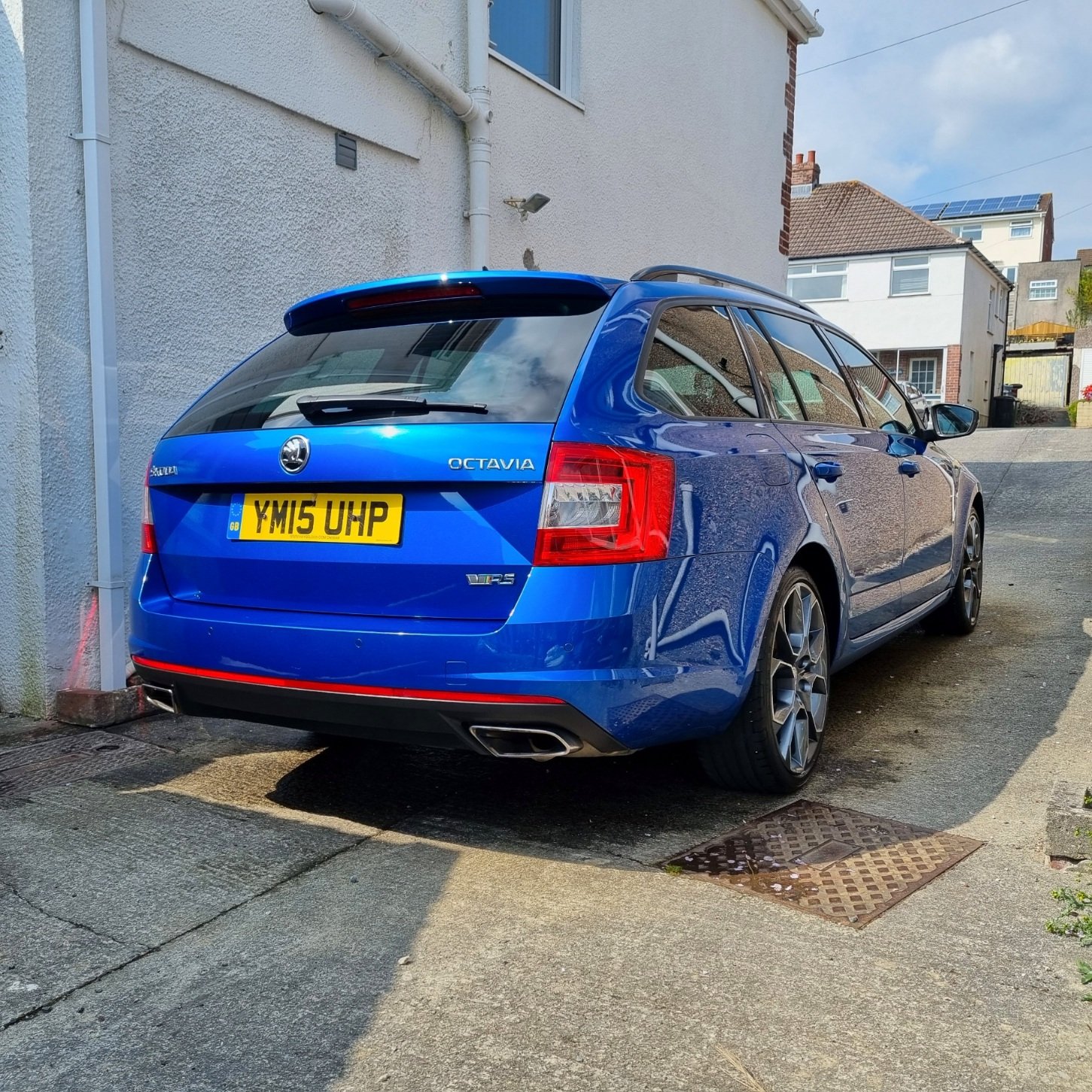

Once I found out that my wife are expecting in October the hunt for a bigger car came! Always like VRS's and fancied a DSG.
After a little while I upped my budget from 10k to 12k to 14k. Found this 15 plate in Norwich. After an epic journey to get it (my flight was cancelled and so jumped in a black cab from Exeter to King's Lynn) I picked it up!

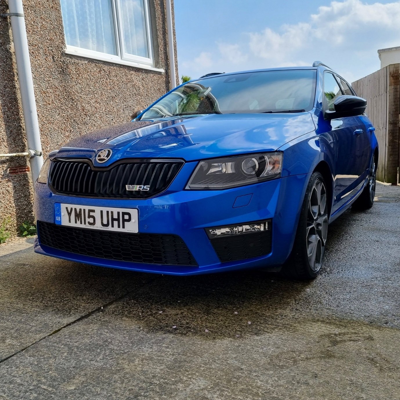

2015 VRS wagon in Race Blue, full Skoda dealer service history, winter pack, black pack, leather, bigger infotainment screen, DAB, Apple carplay/Android Auto activated, cruise control and 19" Xtreme alloys.
Drove home and was smitten. Not as powerful as the Golf but more civilised and comfortable. DSG is awesome too!
First things first, good clean inside and out. Came up well but still needs a good clay bar and polish.

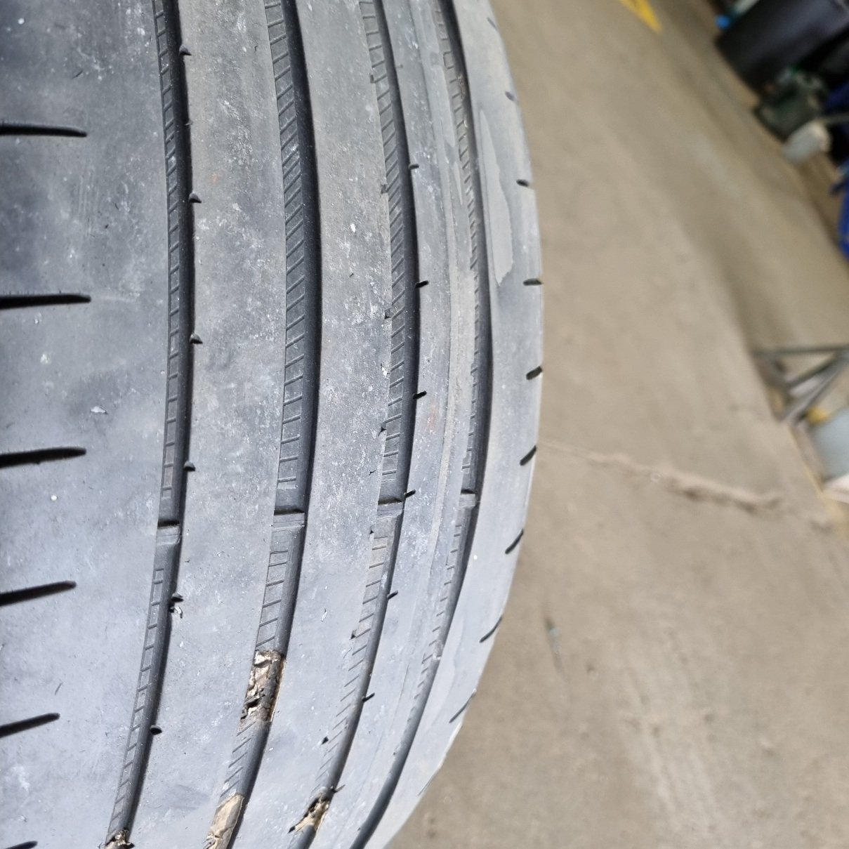

Then took the car in for wheel balancing as had a droning from the rear which I thought was either balancing or wheel bearing. Turned out it was neither!
Nearside rear was badly worn, never seen anything like it but apparently on MQB platformed cars?
After checking the dates on the tyres, the fronts were 2019 and the rears were 2017! Decided to buy 4 new Goodyears and up the profile to 235 rather than the 225. Fills out the arches nicer and provides slightly more comfort.

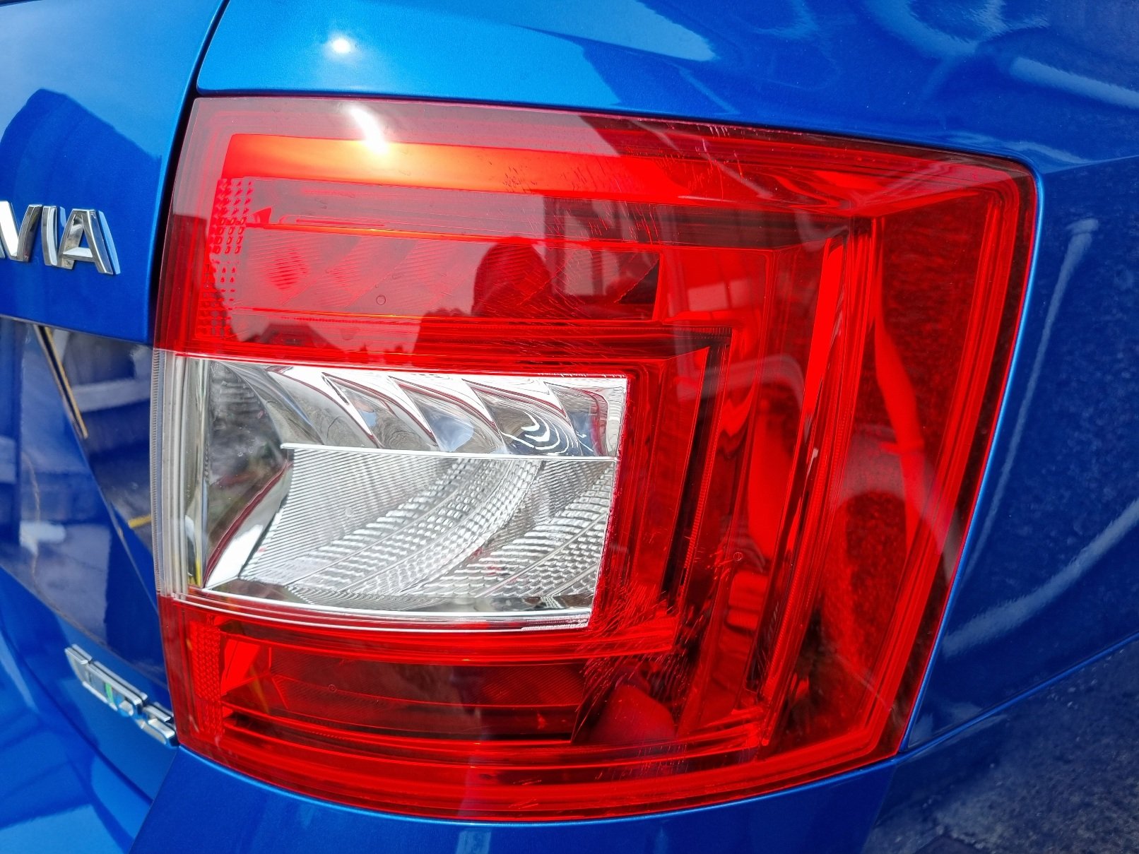

- Replace both rear lights, they are both weirdly crazed. Never seen it and doesn't appear to be a common thing?

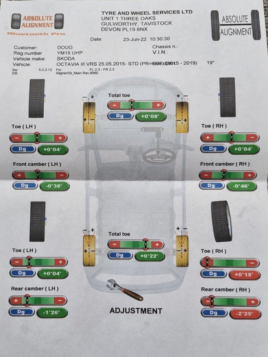

Took the VRS for a proper alignment at a trusted tyre shop, they sorted the front but couldn't do anything about the rear due to being seized. Apparently a common problem, probably going to sort it with some polybushes from Problem Solving Bushes.

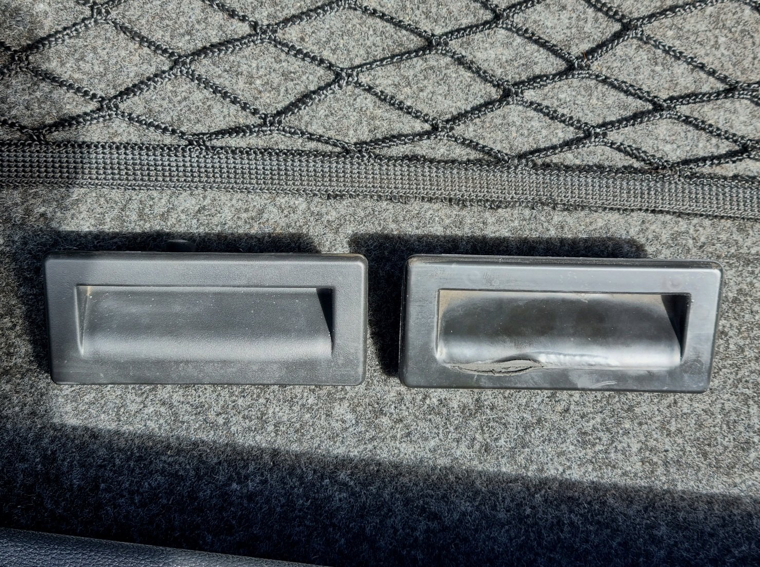

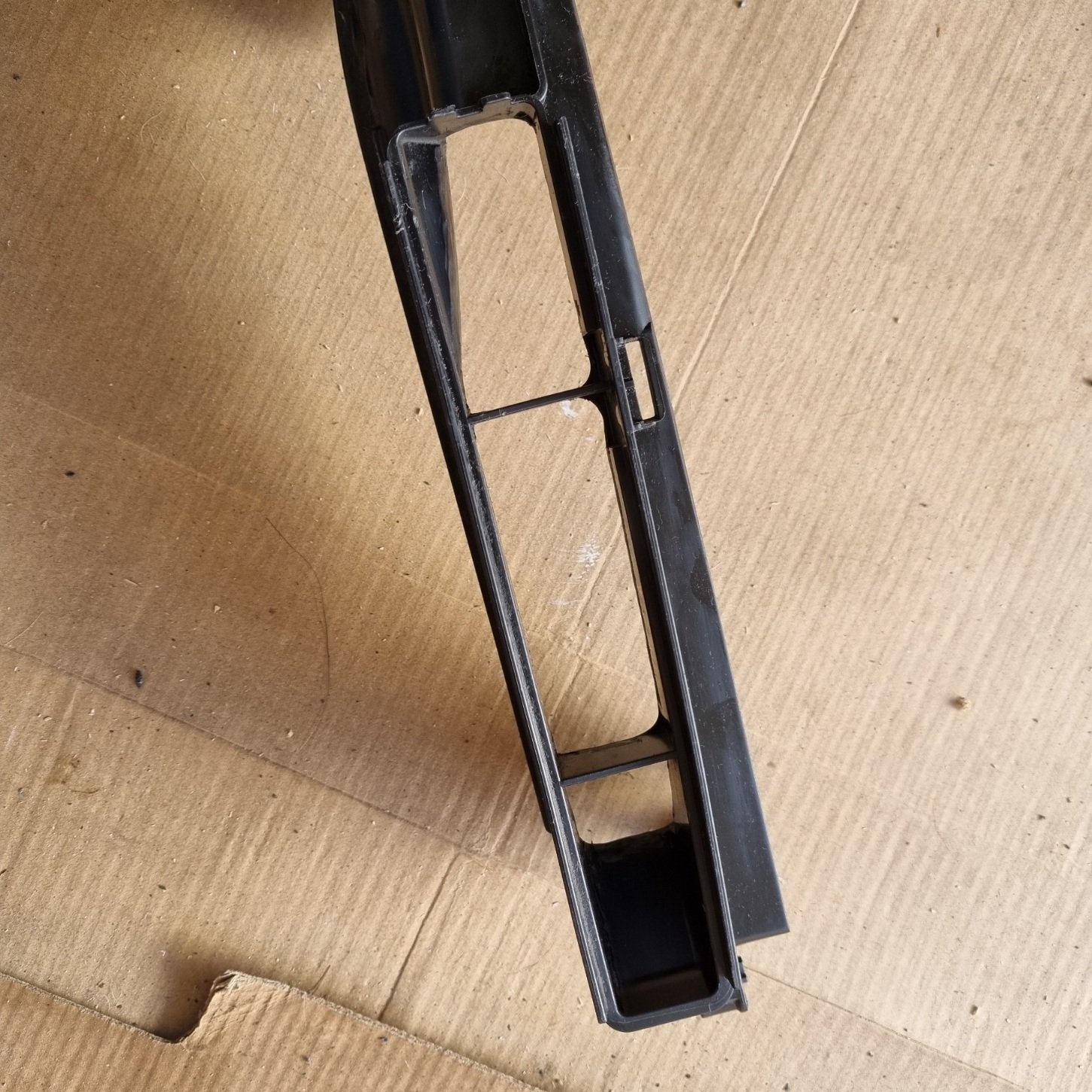

Ever since I bought the car a small thing that annoyed me was the rubber on the boot release had torn from use. I looked up how to change it and did some Googling, finding it on a Skoda supplier's website for an eye watering £131.54!! Needless to say I wasn't going to pay that, eBay to the rescue. £20 later and I had another boot release handle. 10 minutes of faff (getting the large black plastic panel back on was 8 minutes of the faff) and it worked perfectly 🤟

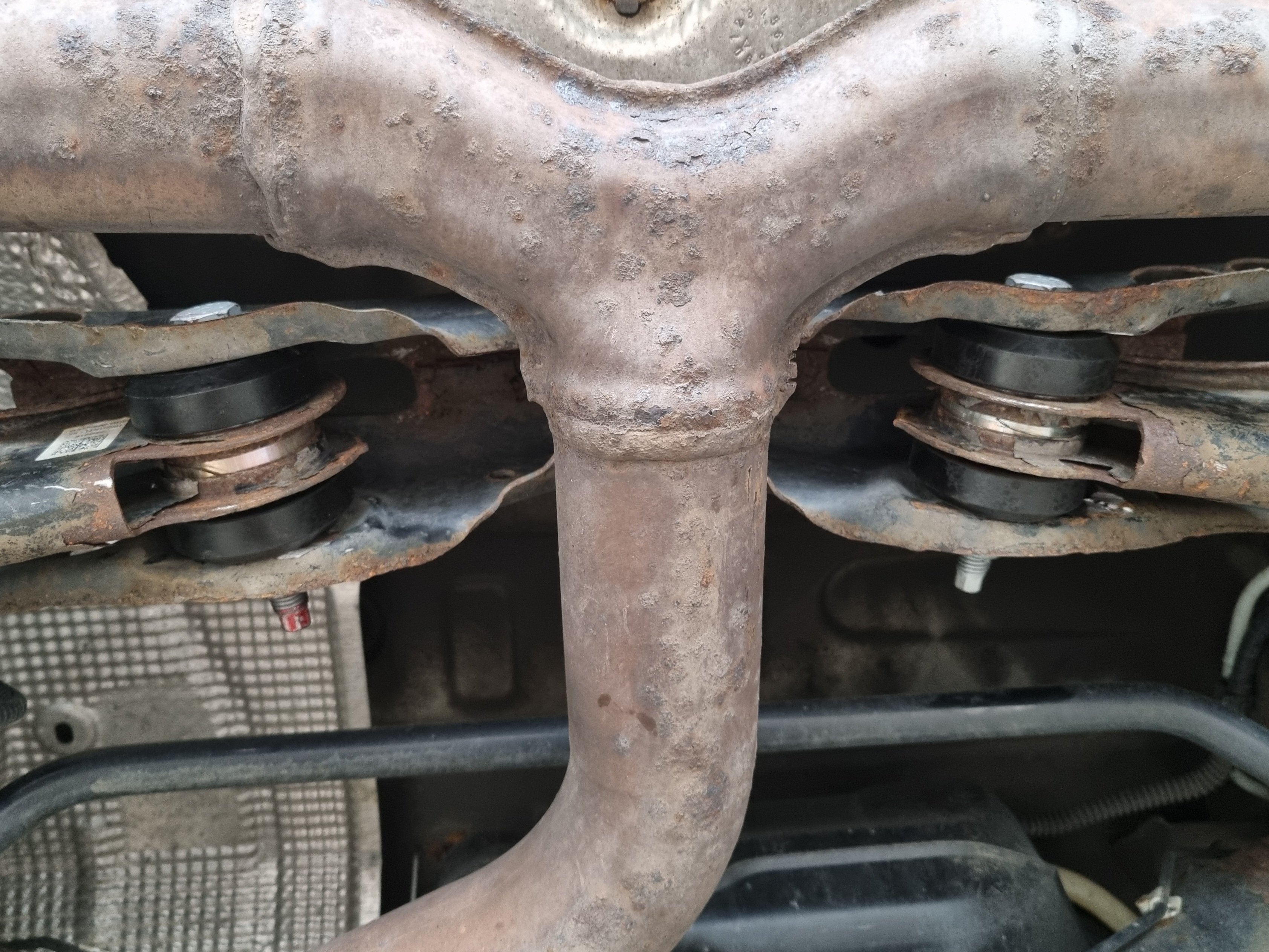

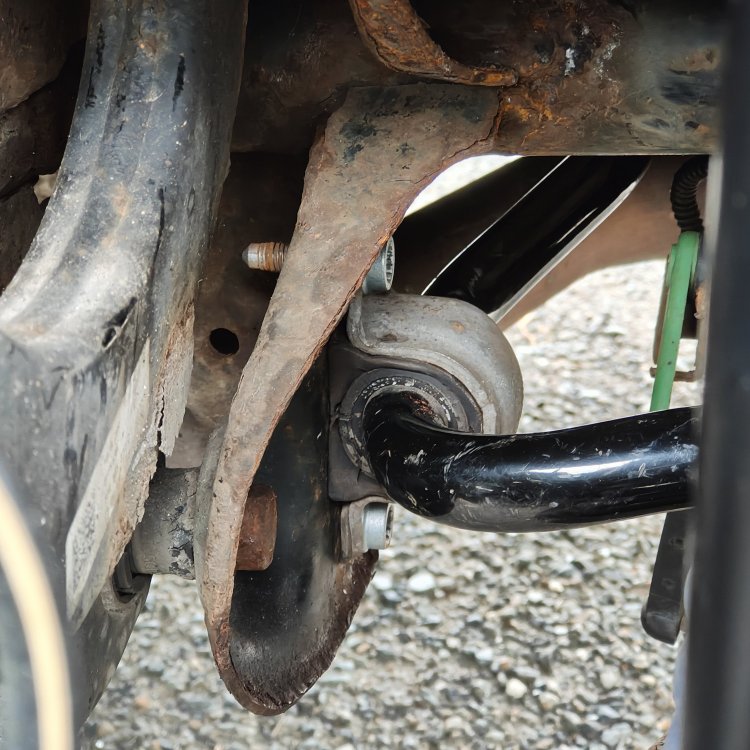

After finding out the rear toe adjustment was seized I figured I would sort it out. £26 for the genuine bolts and £65 for the Powerflex bushes I hope to have it sorted soon. Booked in with the alignment shop for a 2 weeks time.

On another note I've got the rear toe adjust bushes booked in for fitting and tracking and alignment. They are also sorting some tweaks in VCDS for the LED sidelights and genuine VAG LED numberplate lights which is a winner.

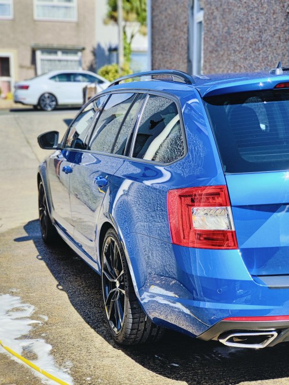

Looks great. Would you have before and after photos of the tyre size change?
Thanks, I probably have a few before the tyre change. Not that it's square on but the one at the top below my list of previous cars is definitely before tyre change. If you are considering it I would do it, MPG hasn't been affected, road noise is less (my rears were heavily stepped anyway) and with the larger tyres being a more standard size they were cheaper per tyre too. I didn't drive it like Damon Hill before the tyre change so I can't say if its made a difference to handling but it wouldn't have made it worse.
And from an aethestic perspective it looks better, the tyres fill the arches a bit better. Once I figure out the best way to host a few more photos I will get some comparisons up. Here's a few from a drive with a mates MK5 GTi recently.
and the replacement boot handle.
I finally got the new bushes installed and tracking done! Took them a few hours to get sorted and a little fiddling to get the alignment correct due to everything settling a little.

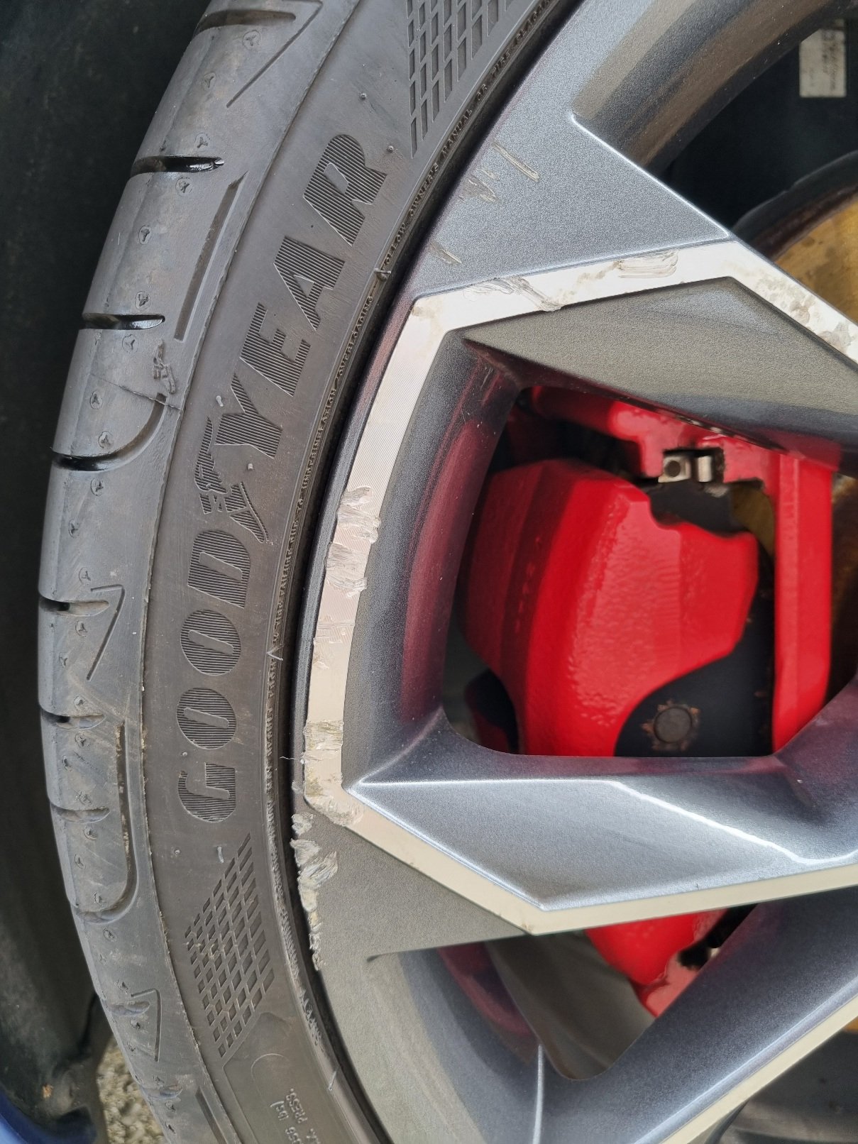

Absolutely gutted, managed to kerb my nearside front rim badly on a pokey kerb 🤢 😭
Luckily I had planned to refurb them anyway, just now earlier than I anticipated. Thinking of going black, I haven't seen many race blue with black Xtremes but would match the black pack. The other option would be dark grey/anthracite. Opinions?

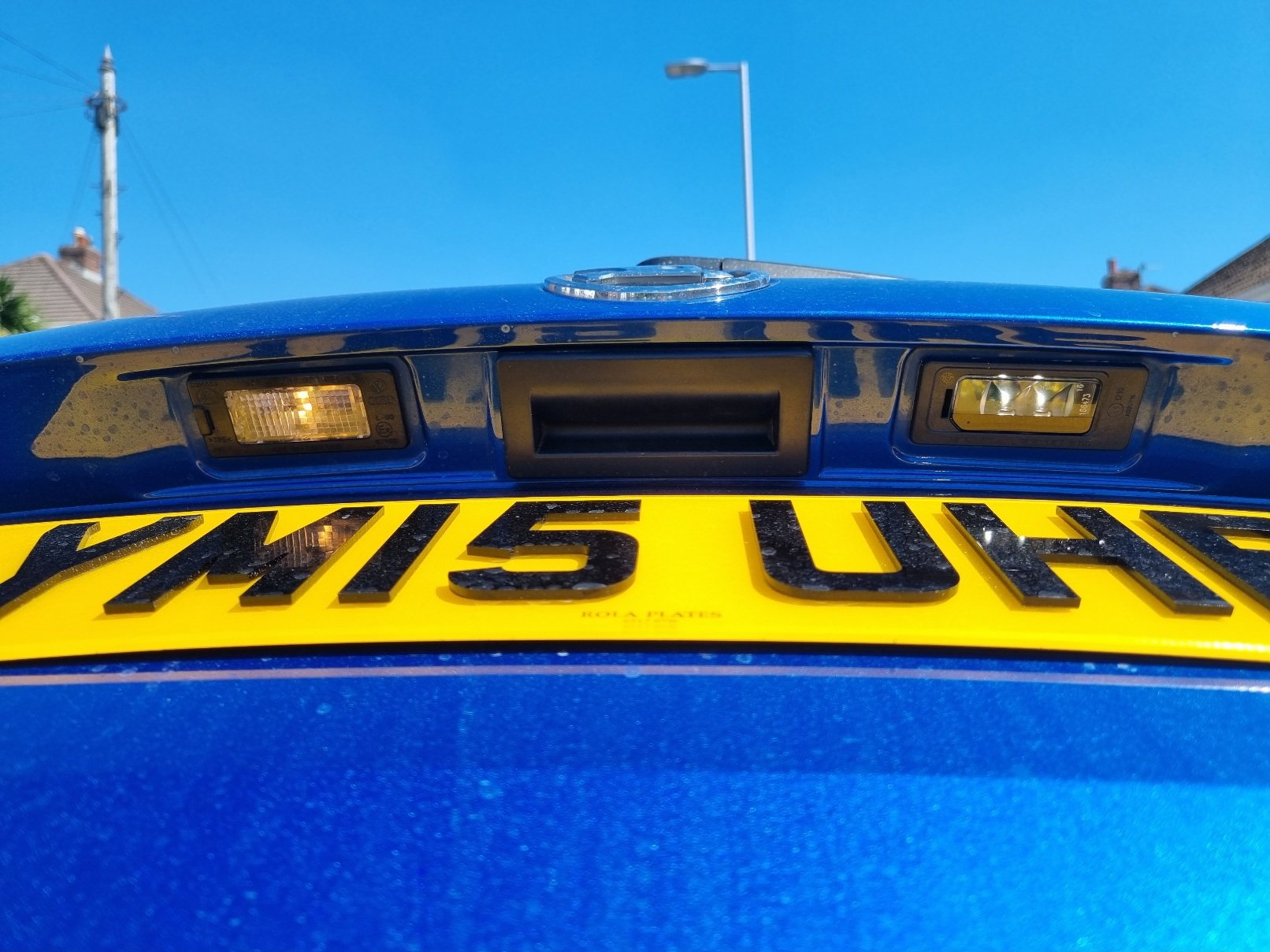

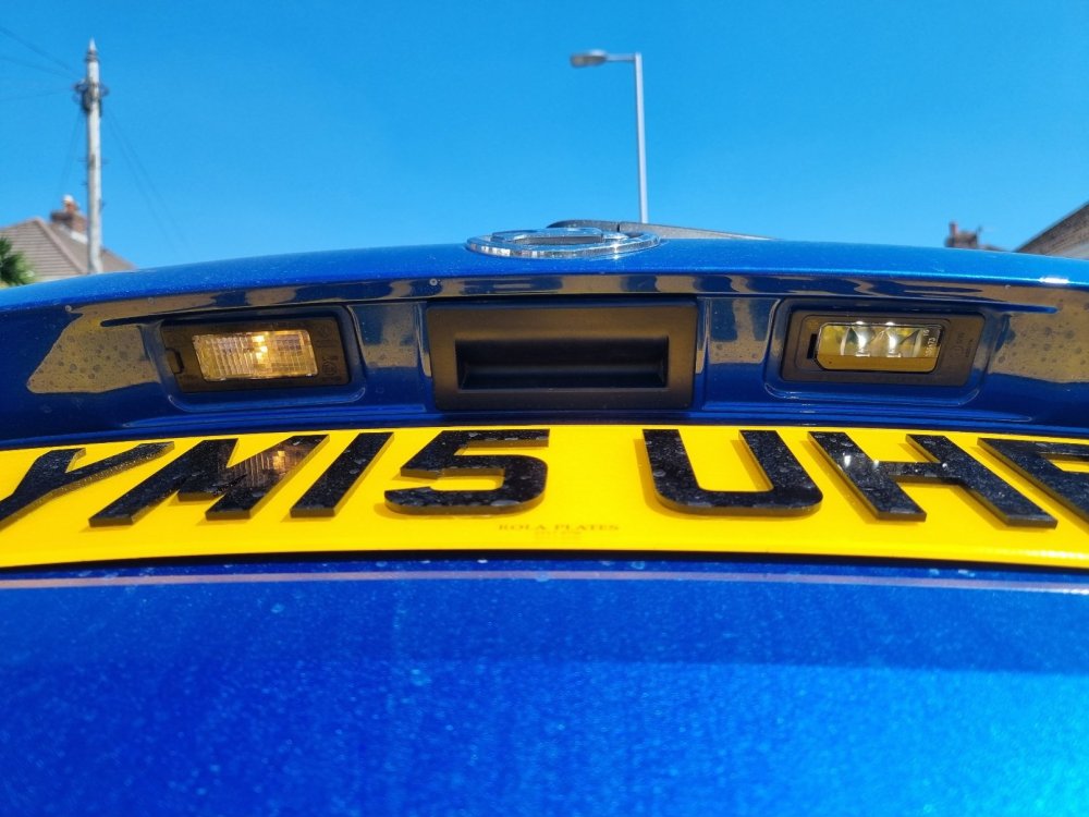

I also fitted the genuine VAG LED numberplate lights, I fitted these before having the bushes done. They definitely look more modern than the original halogen lights.
I feel your pain.
Fortunately I’ve avoided any curbing on my Gemini however the diamond cut parts are beginning to show a bit of the “white worm” corrosion plus I have a stone chip on one.
Was thinking of going black also, debating having them diamond cut too. IIRC someone on the forum had this done however I haven’t seen a photo of them fitted.
One good thing about having black wheels is that you can get the black Skoda centre caps from Kopacek. These don’t tend to corrode like the silver ones and wouldn’t look out of place unlike on the anthracite/silver wheels.
16 hours ago, CookieMonster87 said:
I feel your pain.
I've seen a few pics of black Geminis and didn't like them so much but I think it comes down to how they are sat in the wheel arch. If they are stock height with no spacers then look really lost. The Xtremes look lost top tbh so I would look to add some spacers. Also planning a suspension refresh next year so will slowly get all the bits together.
I'll check out the wheel Caps from Super Skoda though 👍

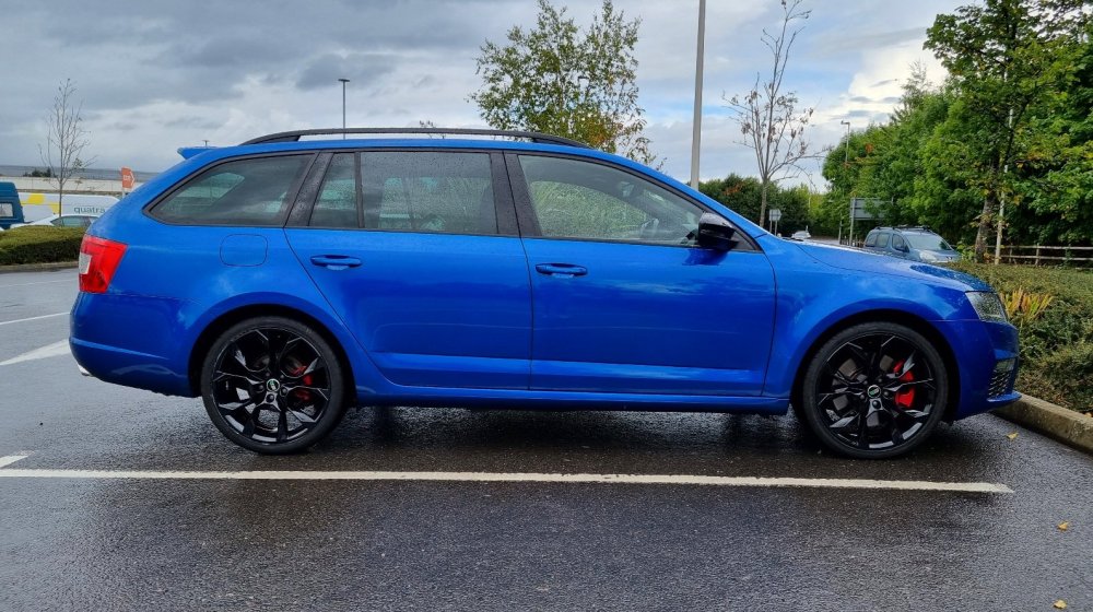

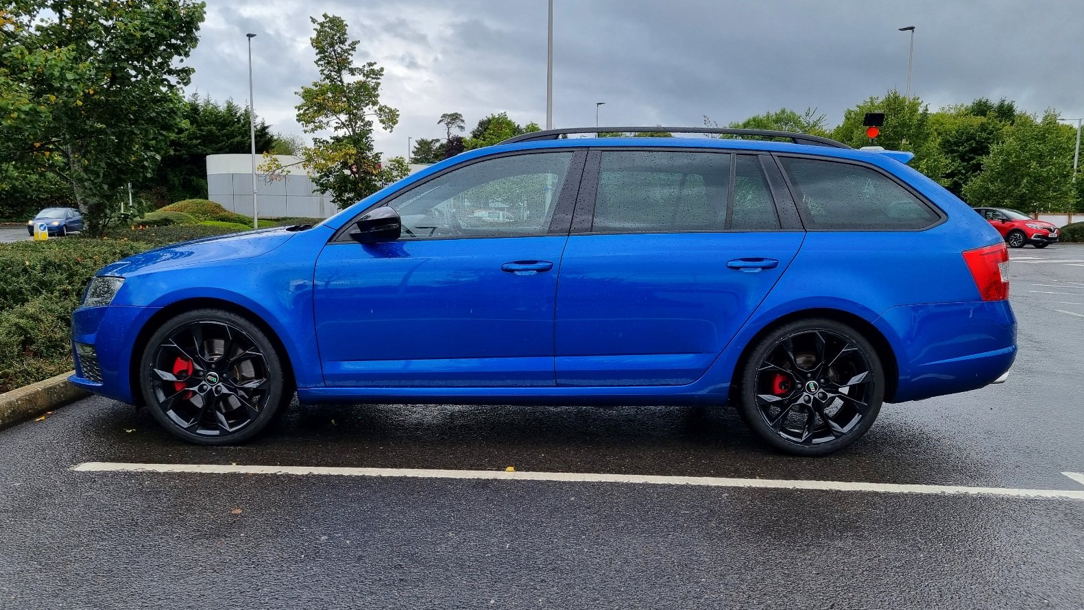

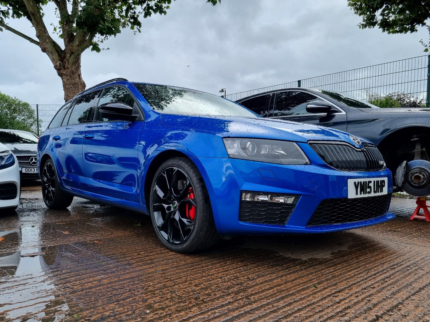

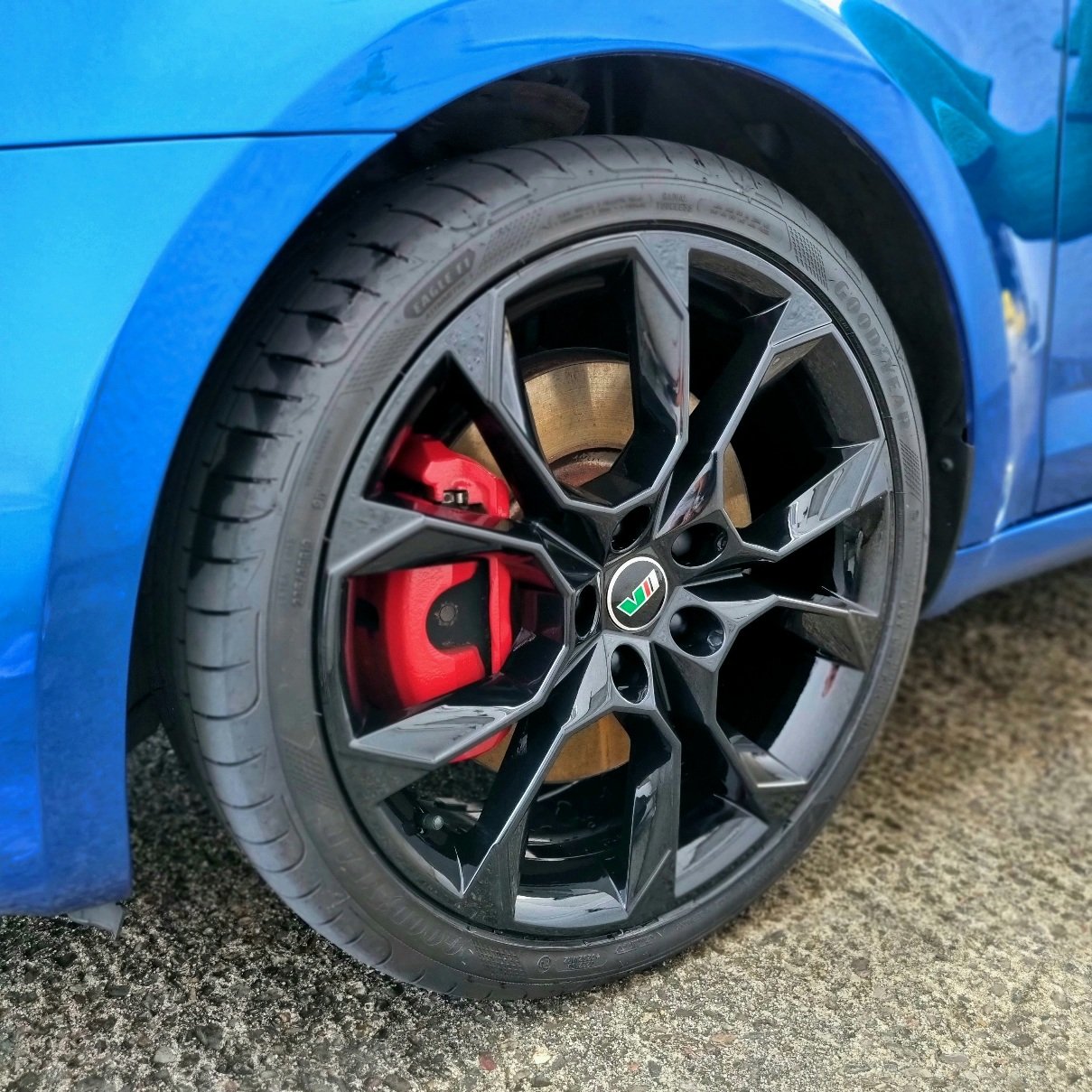

Finally got the wheels refurbed! I went with gloss black in the end and I'm happy with my choice, I really struggled to find a photo of the Extremes in black on a Race Blue car so hopefully the below photos will help someone else in the future. Unfortunately the weather was awful on the hour drive home and now the car is filthy so I need to give it a clean. Initial pics below, definitely needs lows now though!

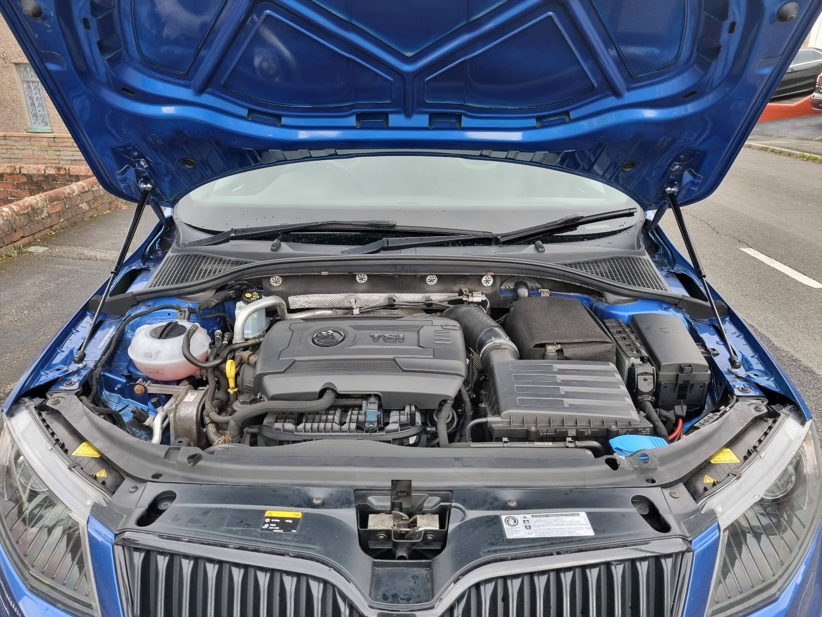

First up was a mega cheap mod and very easy to fit, hydraulic bonnet struts. I can't believe a car of this premium doesn't come with them. I found out about them through a Facebook group and thought for £14 I couldn't go wrong.
Fitting meant removing two factory bolts, one 10mm one that joined the front wings to the body and one Torx bolt each side of the hinge mount on the bonnet. I made sure to apply threadlock to all the new bolts and fitting was really easy. Works well and tidies up the engine bay. I'm also not so worried about potentially knocking the bonnet stay when working now. I've put a screenshot of where I bought it from below.

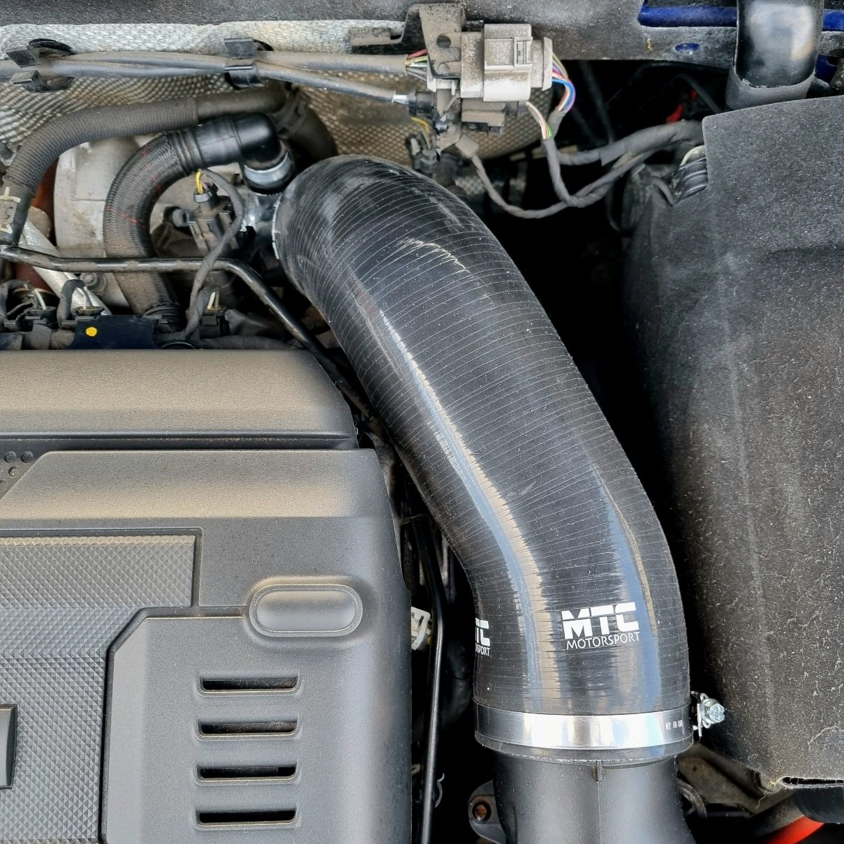

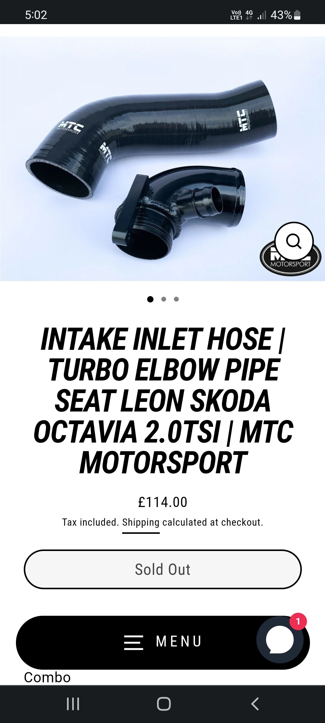

Next thing I've bought I've yet to receive but will help the car in breathing better, if only slightly. It again popped up on a Facebook and for £50 posted I thought why not.
MTC motorsport intake tube and turbo elbow, the item I've bought has a silver metal elbow but should help when the car eventually gets remapped.

Fitted the MTC high flow inlet hose and turbo elbow, very easy to fit. Had to trim 10mm or so from the hose as it seemed too long. I spoke to MTC who were very helpful and said that's common and deliberate by them. Can't say I've really noticed alot of difference but I haven't had a chance to take it out for a spirited drive. I had to order a Mikalor jubilee clamp as struggled to get the original springclip around the silicone hose.

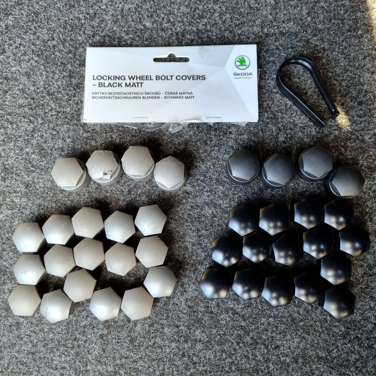

Next up was black wheelbolt covers. I was having a look on eBay at generic Chinese ones and for a little bit extra managed to get genuine Skoda ones.

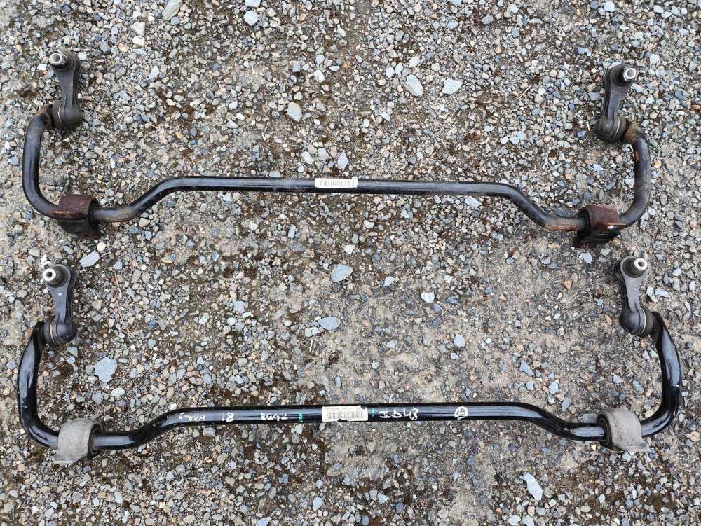

I now have a knock on the front end which I am pretty sure relates to either topmount or ARB links. It happens when the left side is loaded up whilst turning but most noticeable when on full lock. Hopefully it's just ARB links and I can change them myself!
Edited by Dooge
Had the suspension noise checked out on a very wet Friday, of course the noise had disappeared 😐 They checked everything underneath and suspect its front top mounts. I am planning a big suspension refresh at some point when money allows. From research I am thinking:
Bilstein B4's
Eibach Pro Springs
Genuine VAG front topmounts
Meyle HD droplinks
@Ecomatthas recently confirmed B4's with Eibach springs are a great combo so it's what I am aiming for.

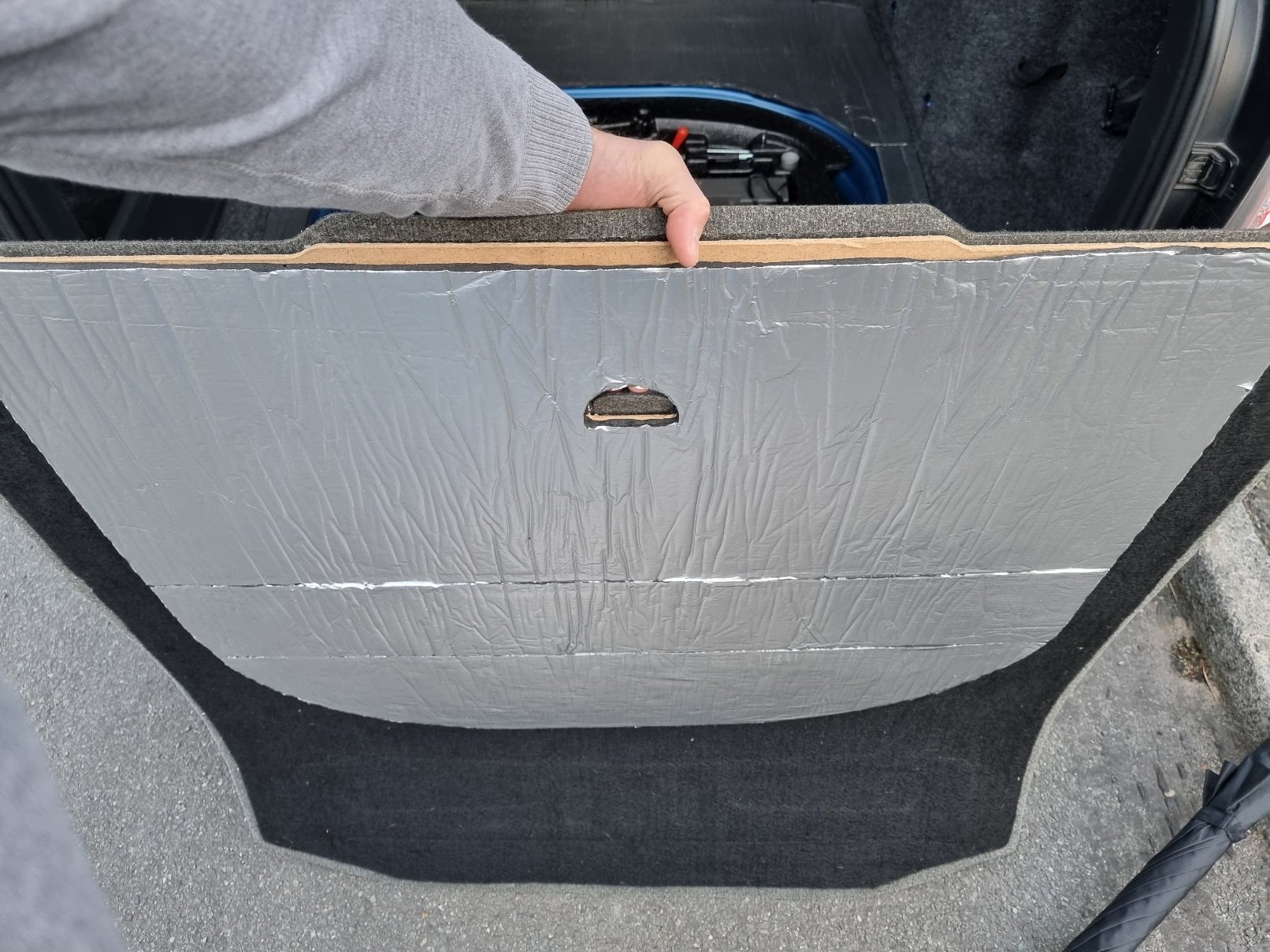

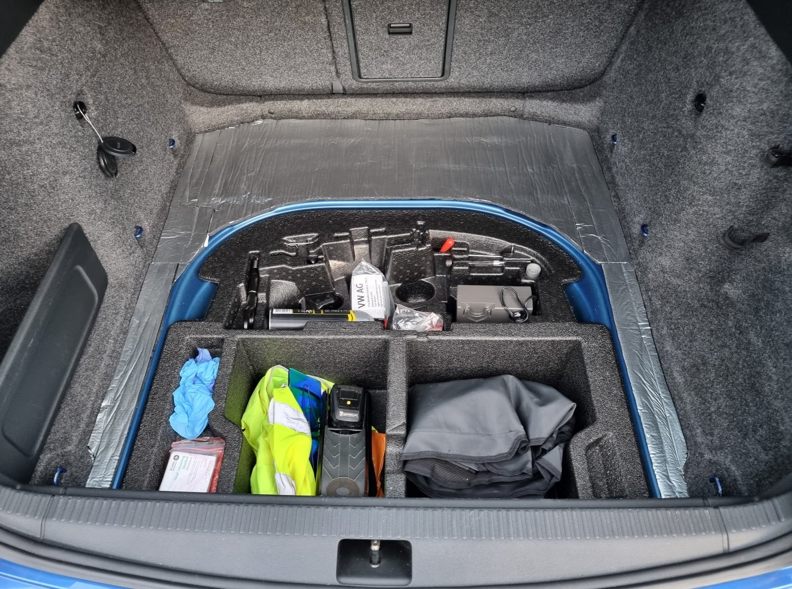

Lastly, I bought some cheap foam sticky back insulation from eBay for a tenner for the boot. Not amazing but I think my poorly tuned ears can detect a slight improvement at motorway speeds. I started by cutting out a shape for the hardboard on the carpet and split at the seam it so I can open it as normal. Then put some around the edges up to the edge of the carpet that cover the wheel arches ensuring I leave a flap for the boot sticker.
