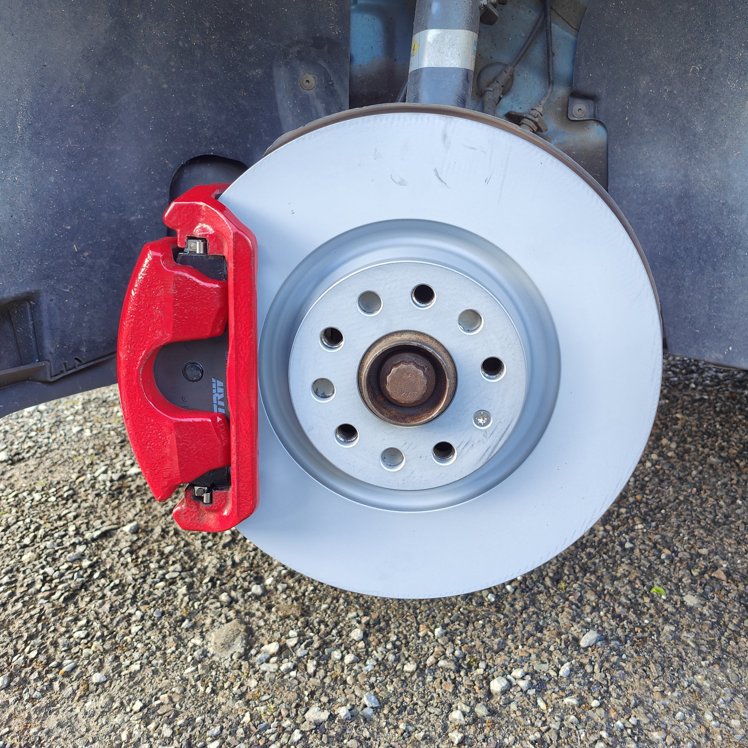

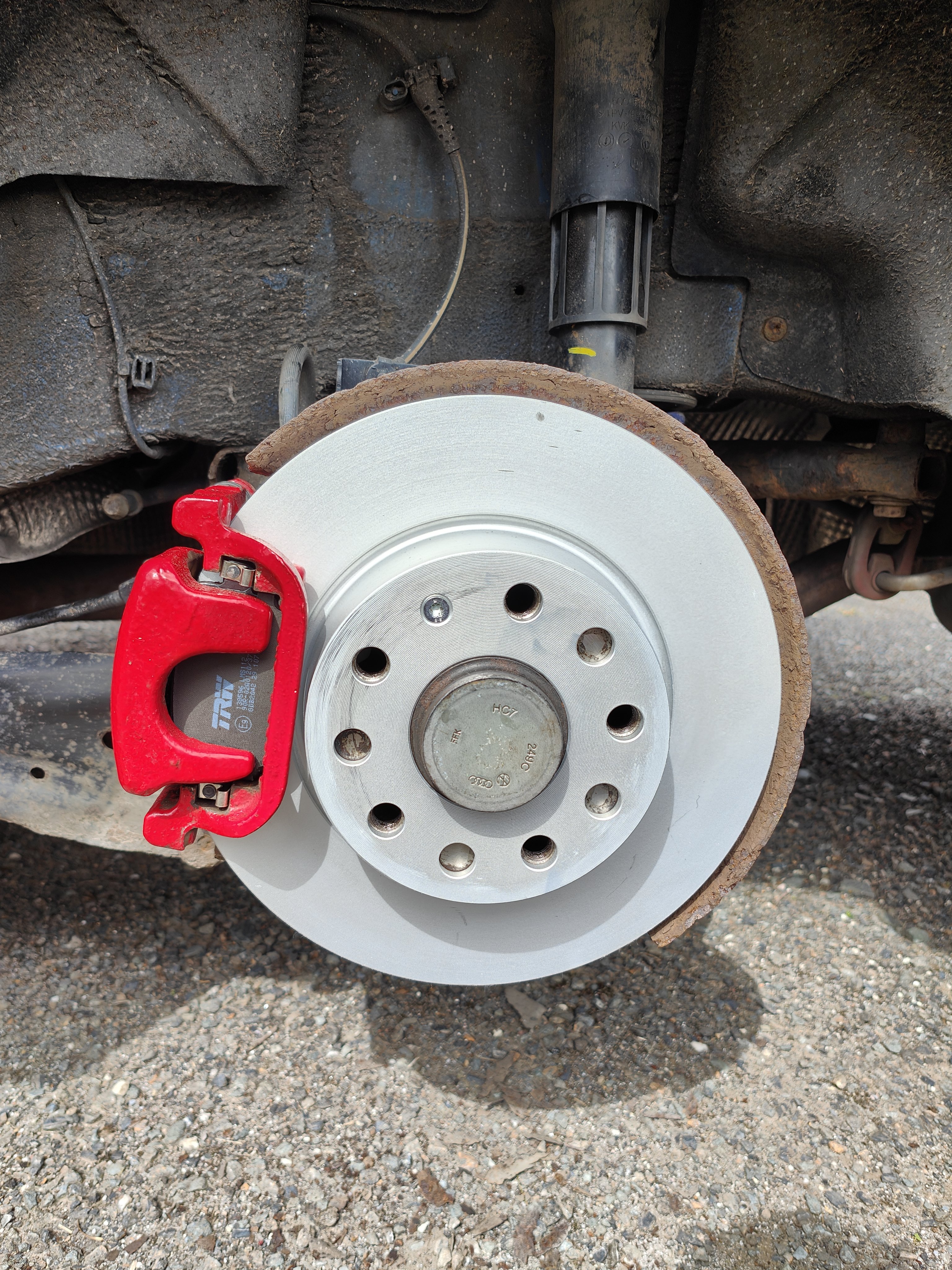

Small update - ordered some new brake pads front and rear and brake discs front and rear from Autodoc, just over £300 for all which I thought was very good! All for MOT which is due on the 28th, the rear discs were an advisory for being rusty last year.
I went with TRW pads (which I think are OEM) and ATE coated discs. These have a matt silver finish which is corrosion resistant and from what I can see is better than painted equivalents. Although I thought about a black finish I'm sure it'll look naff in no time. The pads are all black with a patterned rubber coating on the back, presumably to stop any squealing or vibrating noises.
Unfortunately I bought a Triplesquare set for the rear as the caliper carrier has to be removed but the bits were too long to undo the top bolt, doh! I did pull all the slider bolts out, clean and regrease which showed that a few needed replacement with rubber bushes breaking and pitting from corrosion.

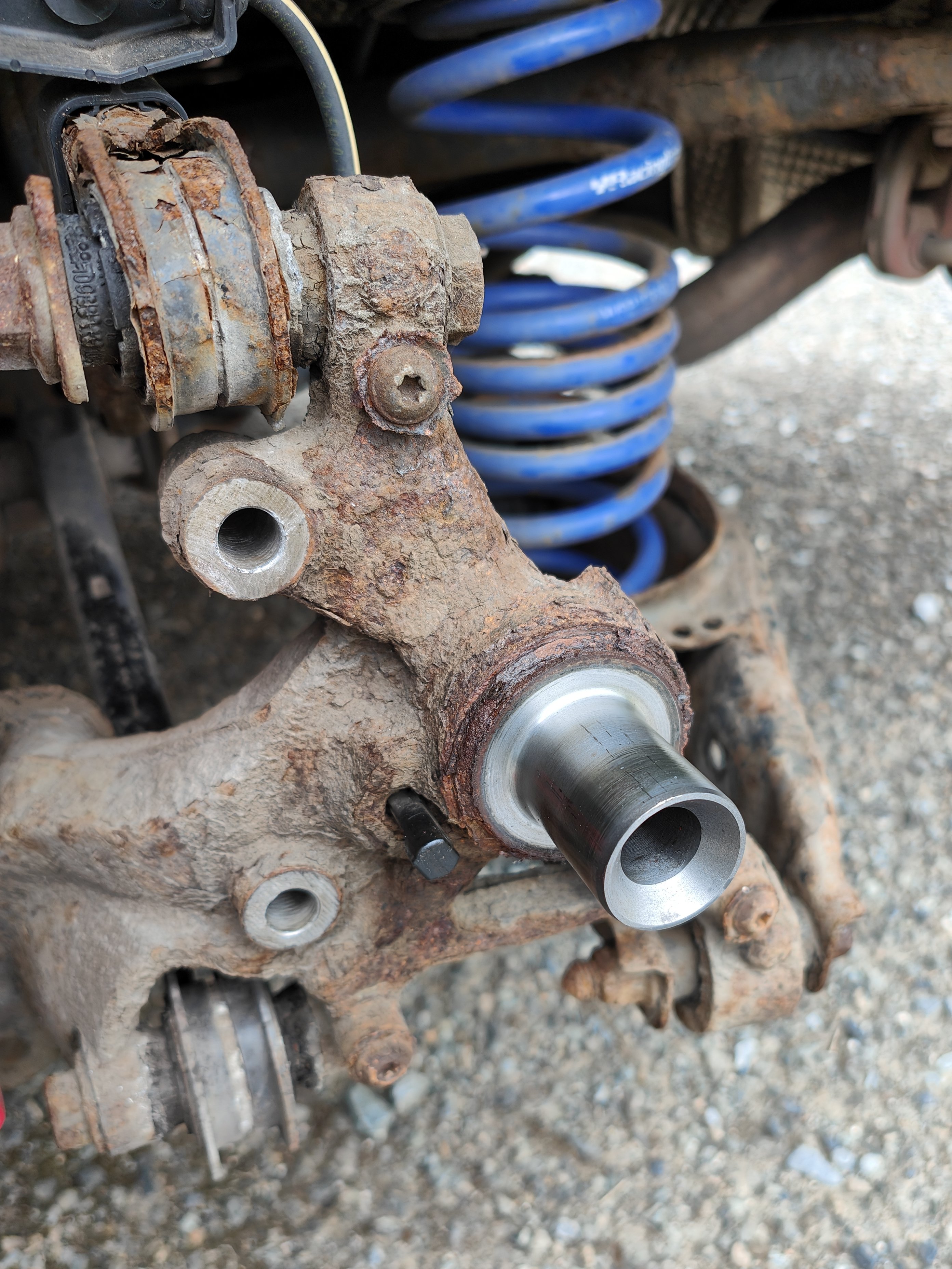

I then fitted the fronts, which was an easy process overall. I undid the brake fluid reservoir and used a caliper tool to push the piston back in.
On the drive home, I broke gently for the first 4-5 times then built up to 60-40mph and 70-30mph braking to bed the pads in. They feel sharper than they did before and overly happy with how they feel.
The car is also going on for an Inspection 2 and brake fluid change when it has its MOT. Hopefully they don't fail it on the rear discs.
Bottom ball joints are still on the list, but I have insurance soon and thinking I'm going to be stung more so than other years.

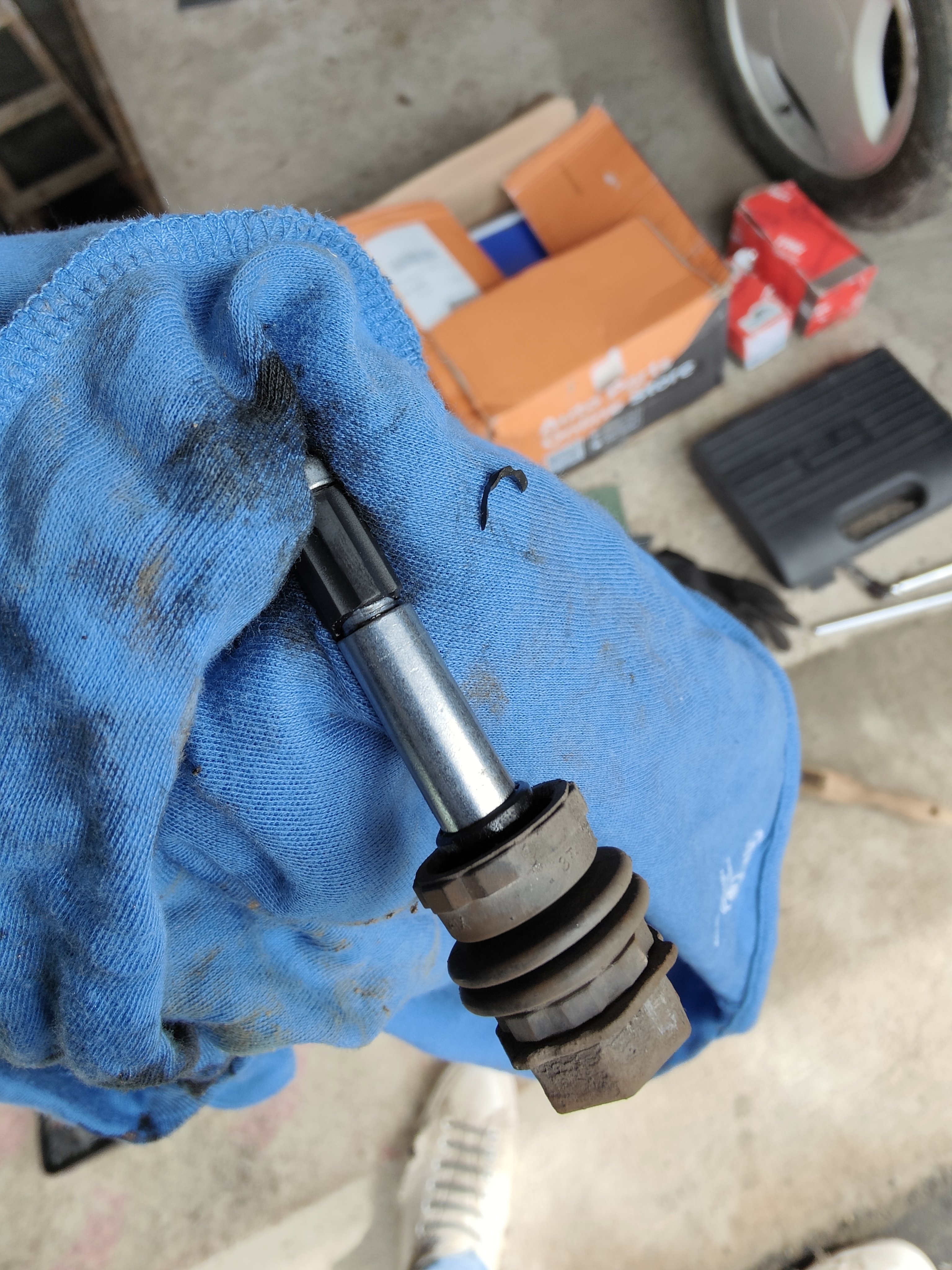

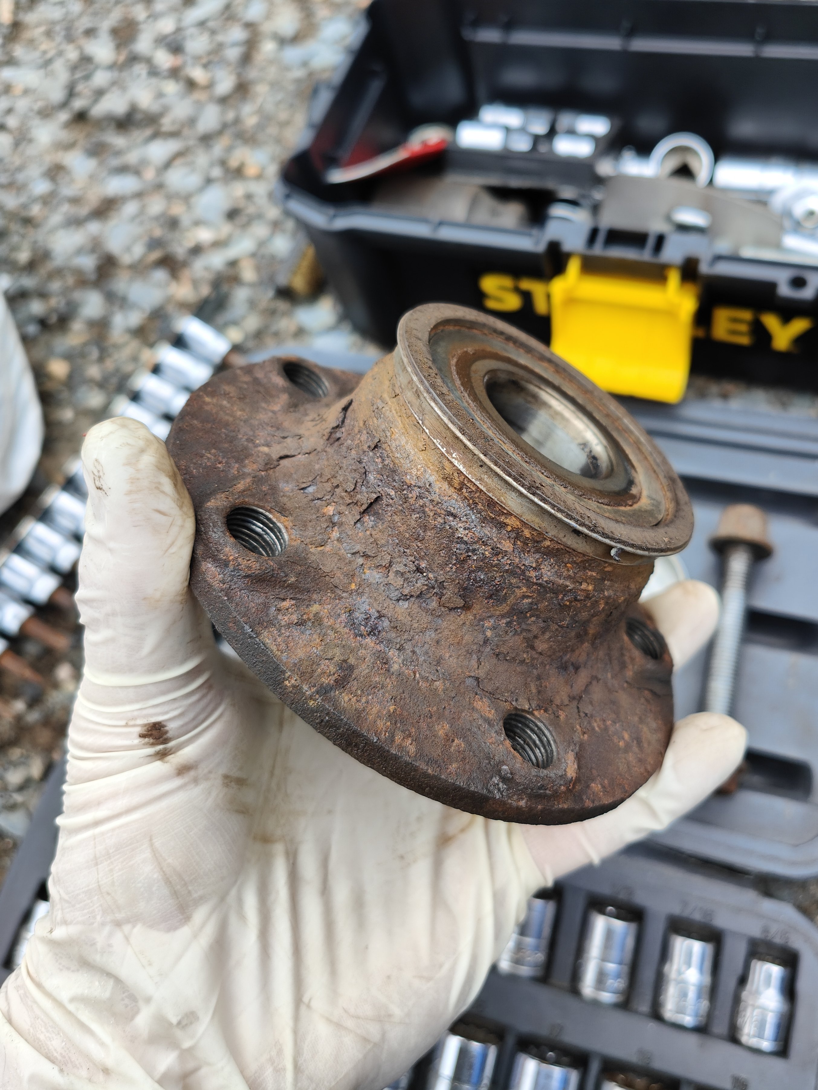

Finally fitted the rears! Undoing the Triplesquare bolts holding the caliper bracket on was not going to happen without removing the shock absorber, which was easy enough to remove and allowed a decent breaker bar or similar to then fit under the arch and be used without spatial issues.
It was very easy to replace them both and all fitted very well.
I did discover that the dust protector on both sides was trying to masquerade as a collander! I also found out that my shock absorbers are totally knackered, barely returning so they may have to be done sooner rather than later.
I should add that the car passed its MOT with no issues, and they changed the brake fluid at the same time. They made no mention of anything being problematic from the service either.

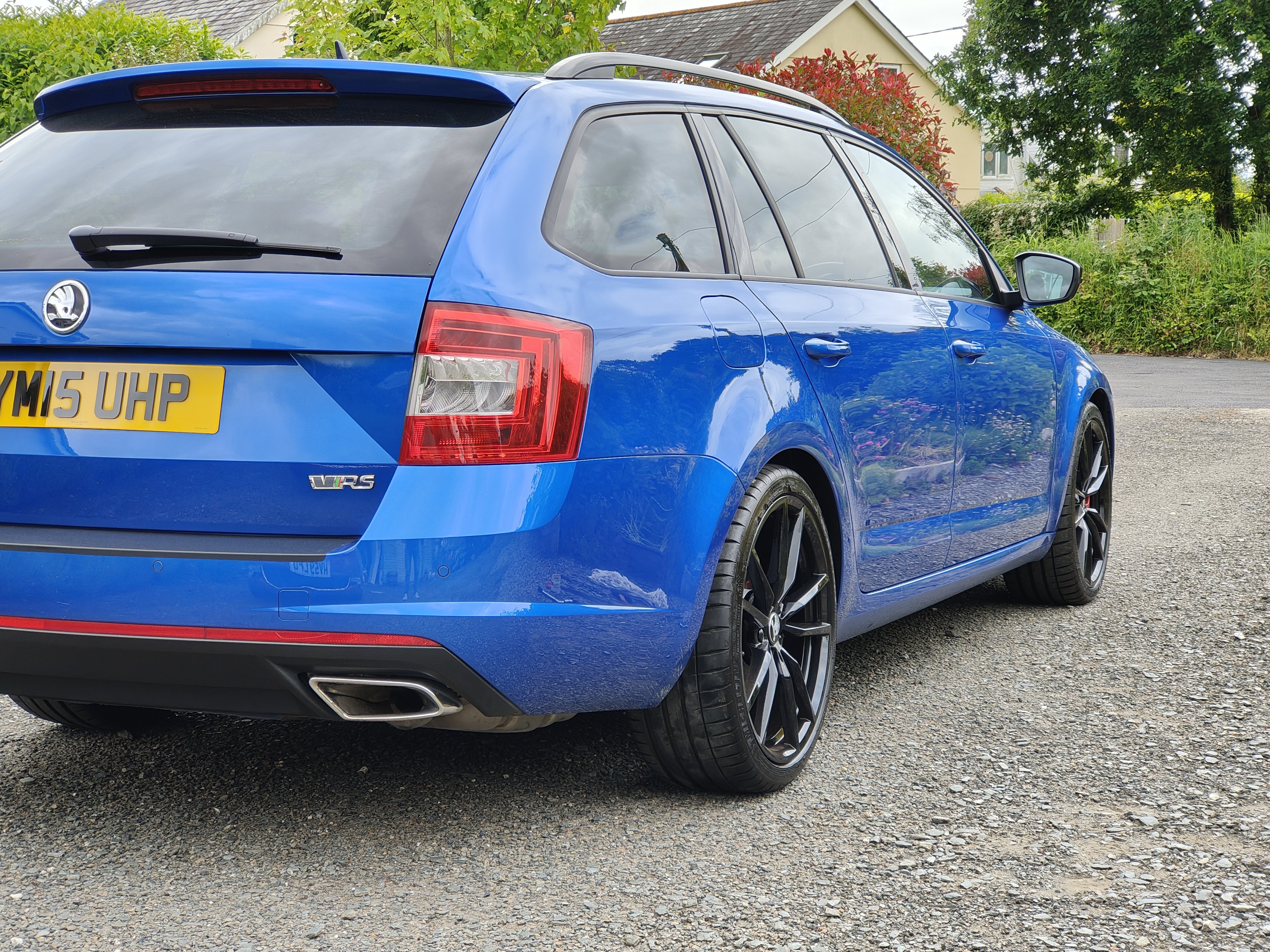

So, a friend offered me his alloys, recently refurbished and with 4 brand new Michelin PS4's for £800... I said yes.
Genuine Golf Pretoria's. I bought some ST-DZX 12mm hubcentric spacers for the rear and I really like the look. Many thanks to @vrs'burks for the recommendation!
The car feels a bit more sprightly on them, I guess because of the new tyres and because they are a bit lighter than the Extremes. I do also know that they are a bit more fragile than stock however most of the roads I drive are reasonably good.

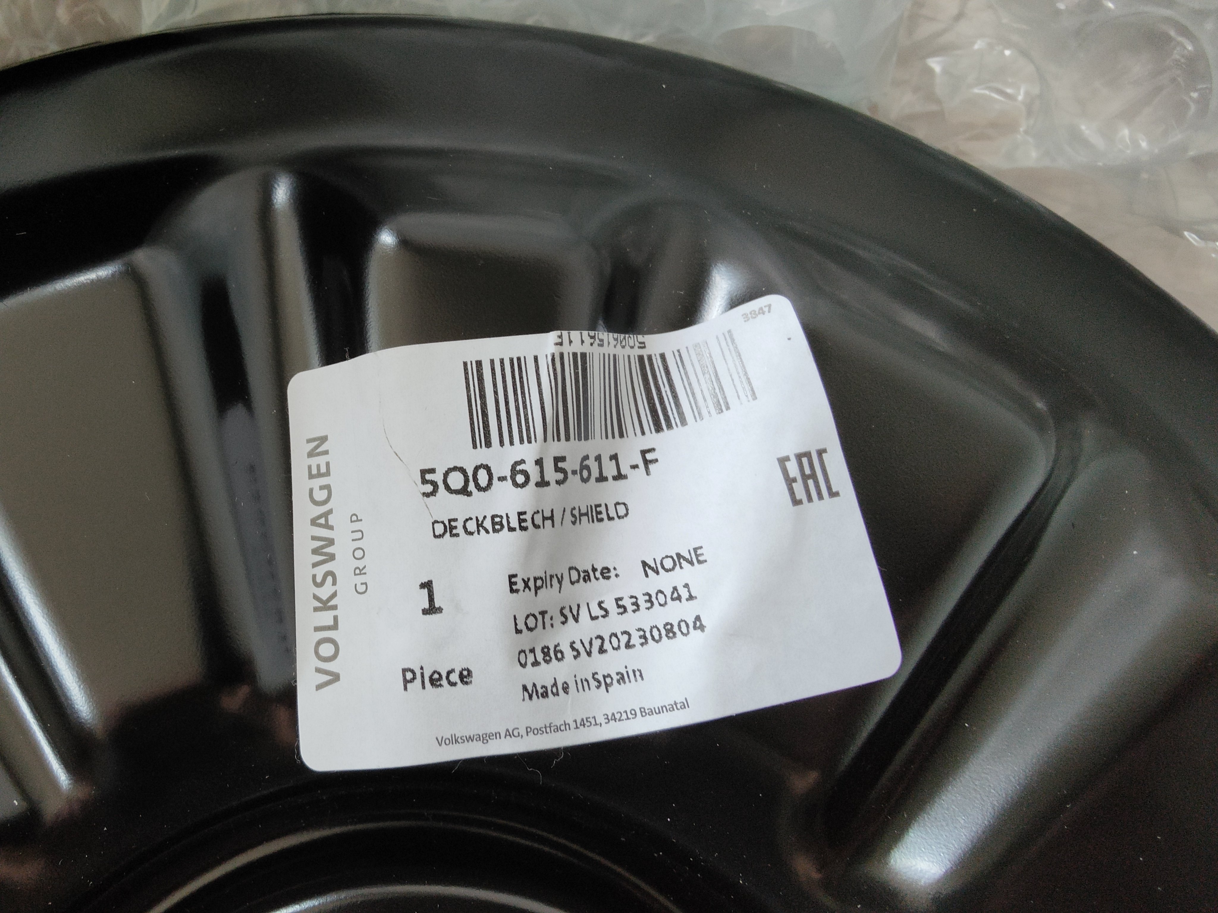

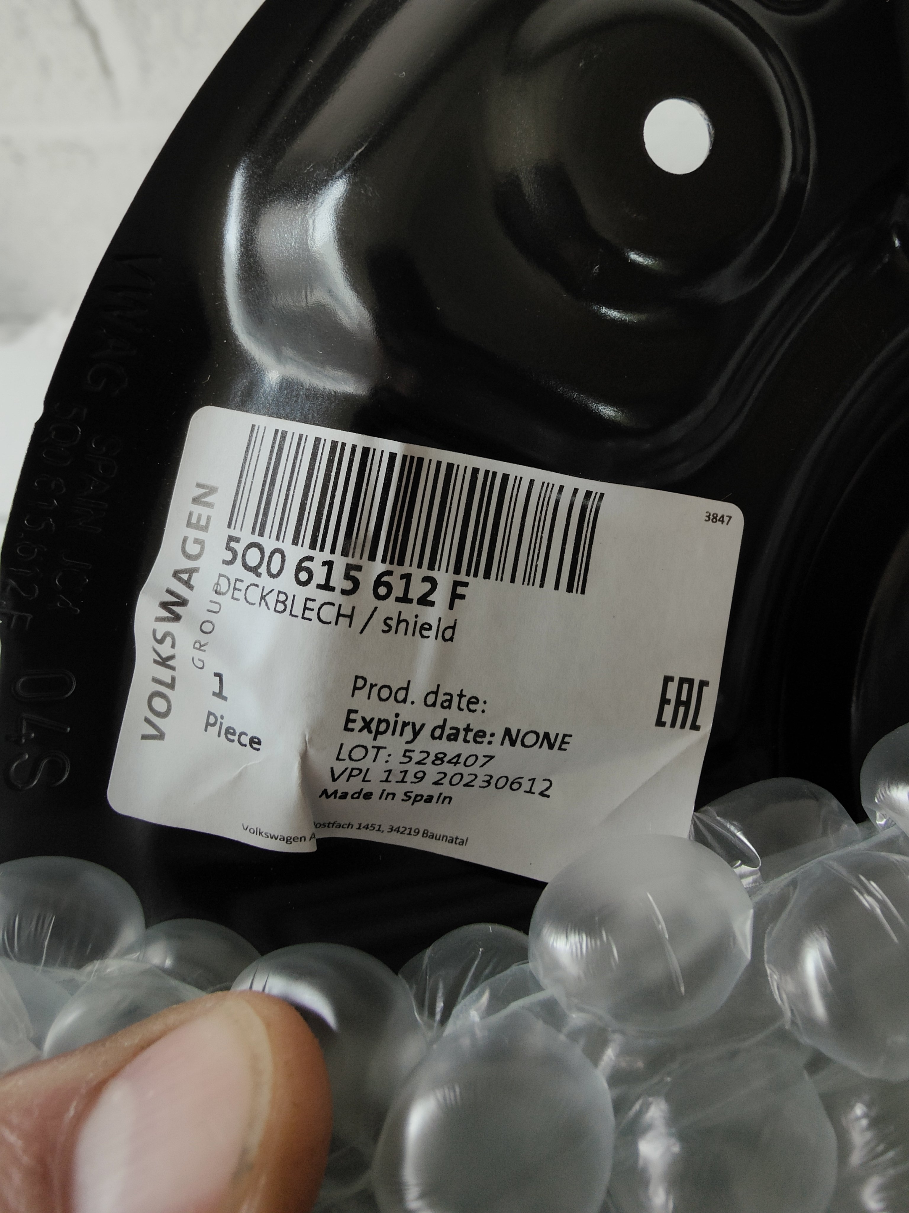

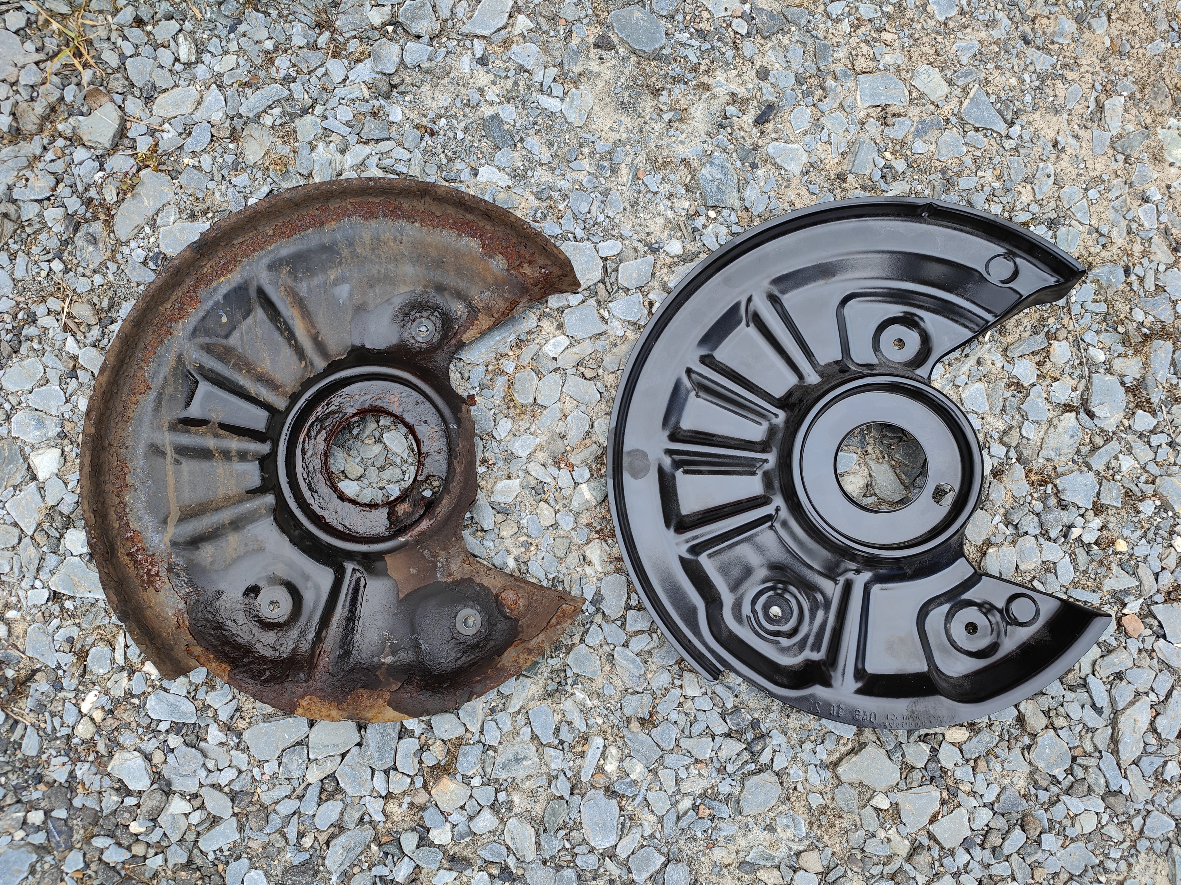

I also ordered new genuine rear brake disc guards, yet to fit them as I am debating whether to get new rear hub bearings.

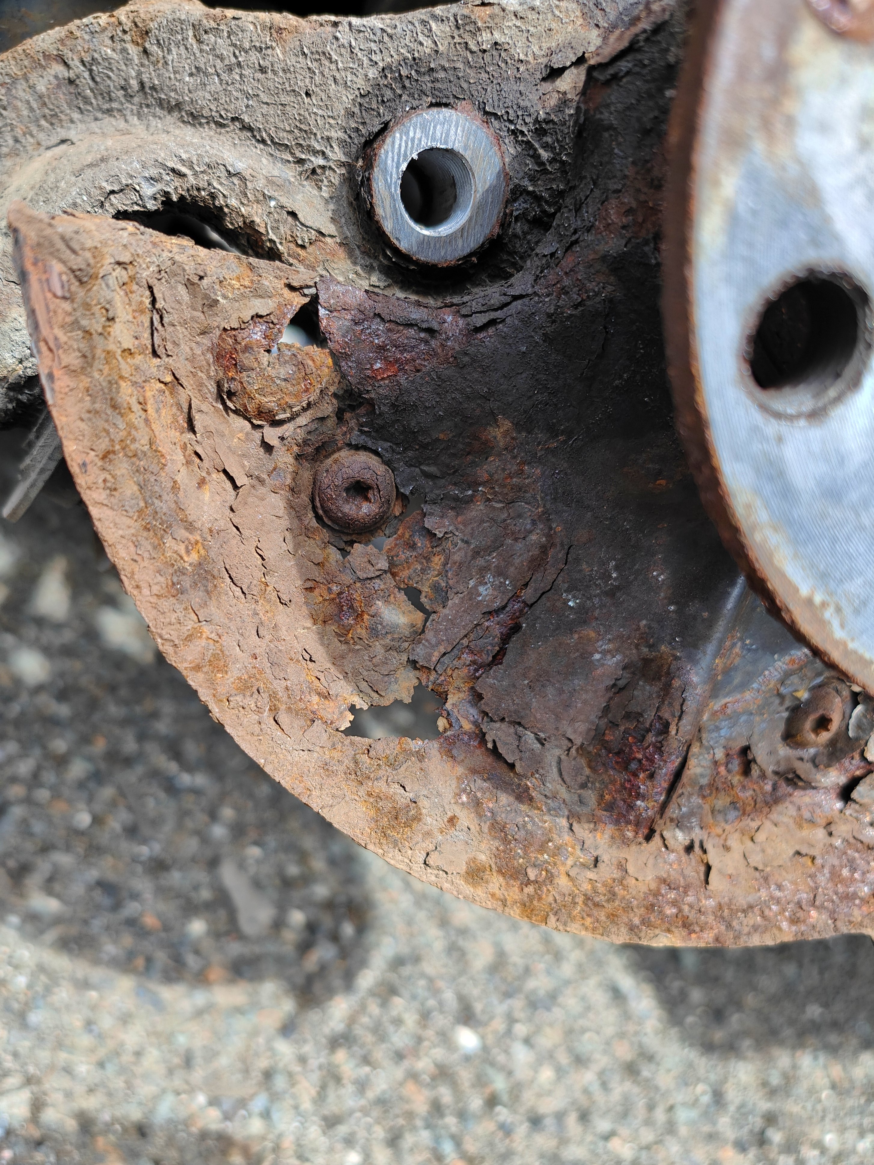

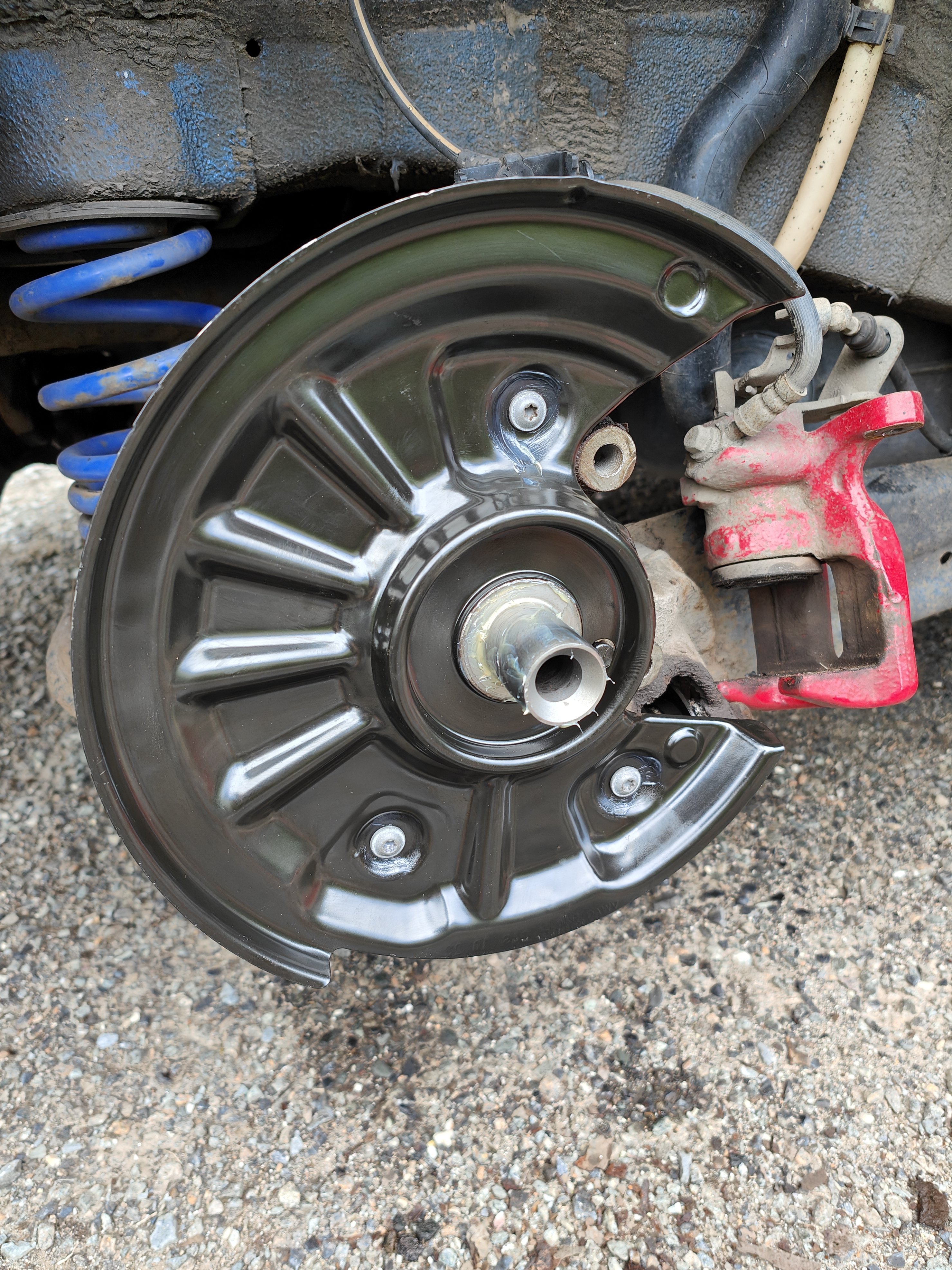

Another small bit satisfying update. I managed to fit the rear disc guards today. I went through the same procedure for removing the caliper, carrier and disc before but could believe how much the old guards had rusted to the hub. Alot of wire brushing and scraping and they fitted well again.

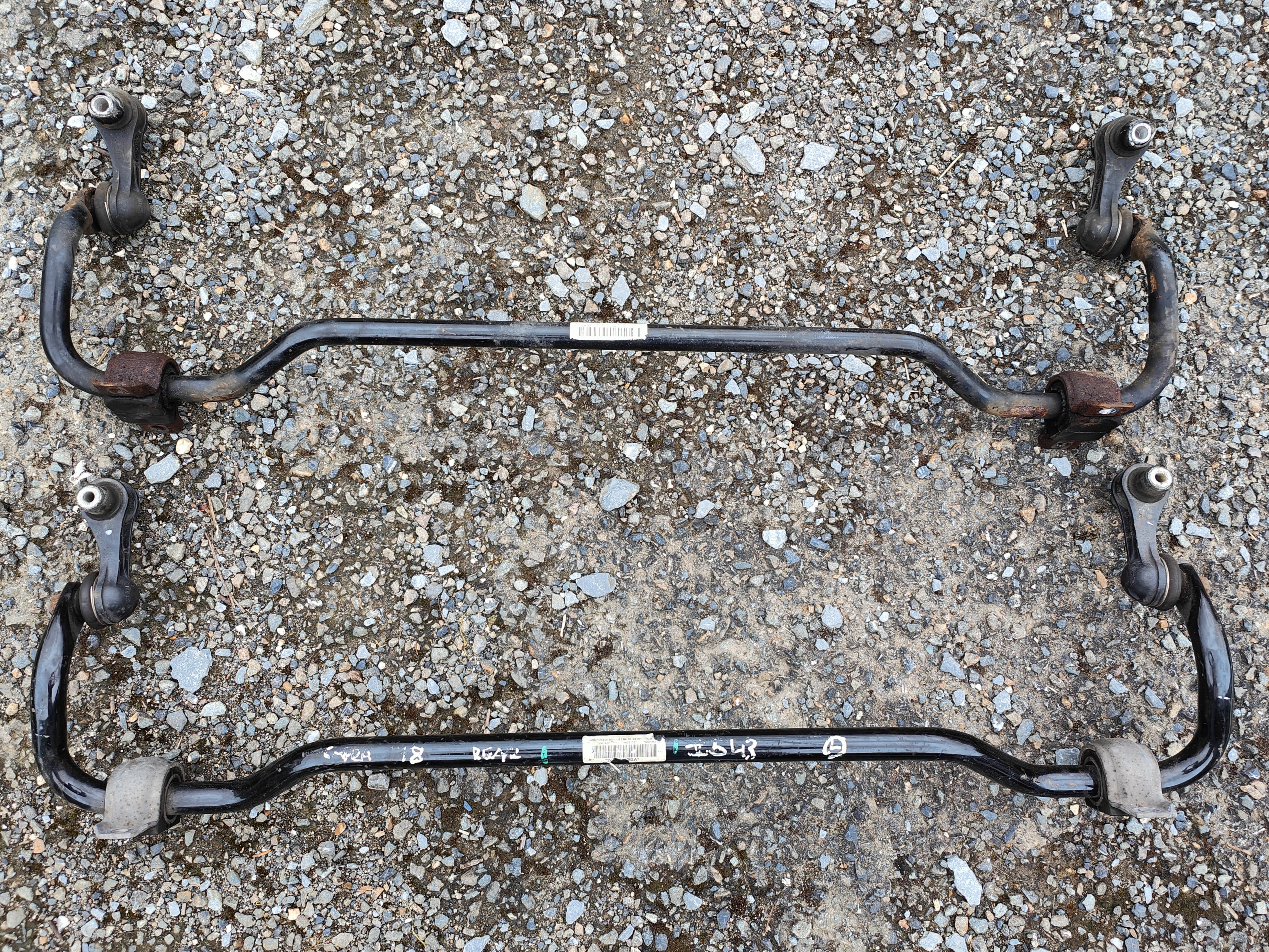

Soon I'll pick up some Bilstein B4 rear shocks and an uprated rear ARB which should firm up the rear end.

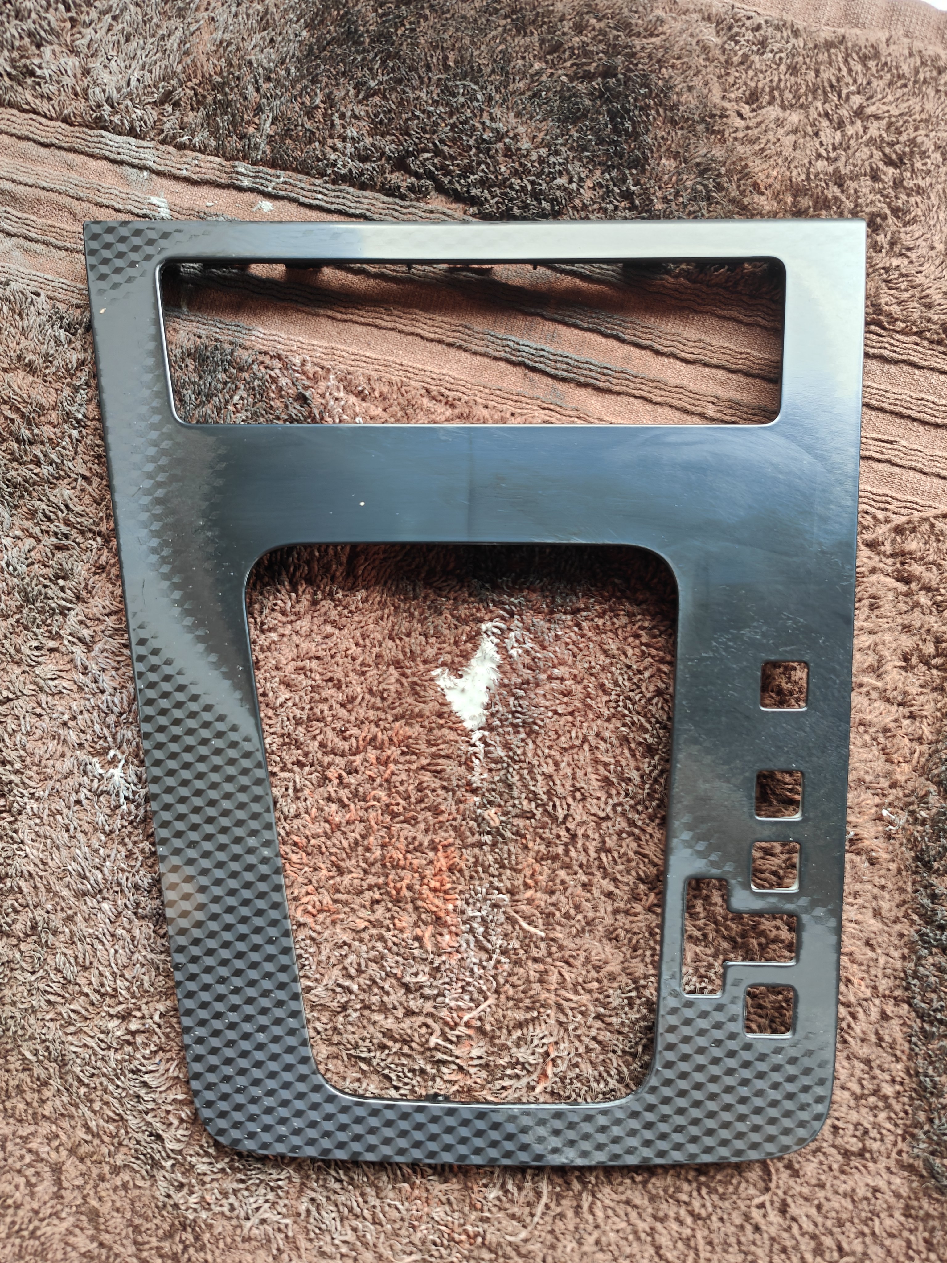

So, the saying every day is a school day is correct! Today I learnt that using the DA polisher on your interior trim results in ruining it 😬 I also ruined both my polisher pads so an expensive mistake 🫤
Once I realised it wasn't going to be saved I ordered a second hand one from eBay for £35 and carried on polishing it until it was all gone. It's like a very dark grey in comparison to the Piano black highlights, but shiny.
I assume you are aware that the uprated rear ARB will reduce understeer and may even induce slight oversteer.
Yes buddy, hoping to sharpen up the rear end. I'm debating whether to go for the Performance Pack ARB (21.7 x 3mm) or the Club sport one (21.7 x 3.6mm) but lots have done the Club sport RARB resulting in subtly improved handling. I'm not going aftermarket or overly thick so I think I'd have to try pretty hard to upset the car, I don't drive it near that limit.

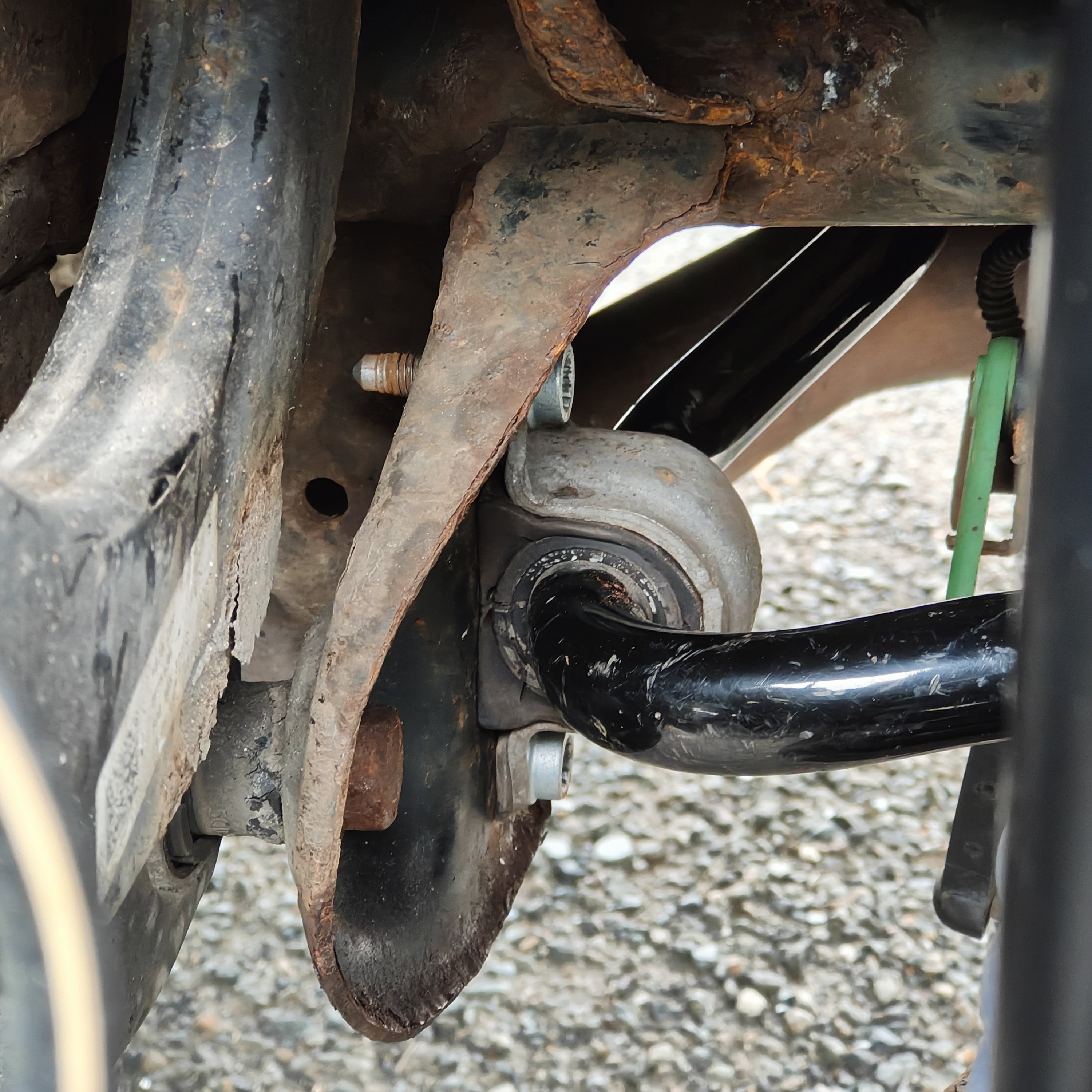

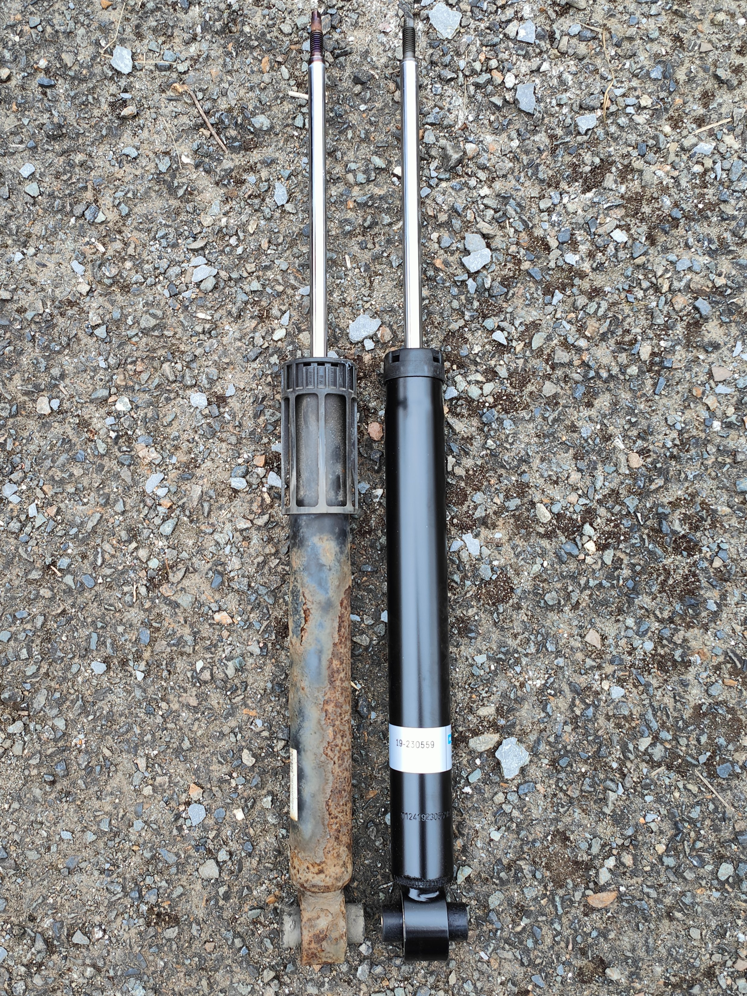

So, I finally got around to tackling the rear suspension.
Fitted:
-Second hand Club sport bar (bought from eBay for £120 with rubbers, collars and droplinks)
-Bilstein B4 rear shocks
I have access to a pit so I started by removing all the M10 torx bolts on the collars, then the droplink bolts and managed to get the old one out without jacking it up. Could I get the new one in? Nope!
Pulled it out of the garage, jacked both sides quite high, dropped the wheels and shock absorbers off, then undid the mounts for the rear exhaust rubbers and the one behind the rear axle so the new ARB could be fitted.
If anyone wants the Clubs sport ARB code its 5Q0 511 305 BA.
Once the new ARB was on (new collar bolts were £17 for 4 from Skoda dealer) changed over dust covers, bumpstops and topmounts onto the new shocks and fitted.
Then made sure everything was tight and secure.
I had a test drive back but a boot full of rattly items didnt help concentrate on the drive so Ill go for another drive soon. Definitely felt sharper and not so wallowy, overall Im pleased! More photos incoming soon.
The new ARB is lighter than the original and its obviously cheaper for the VAG group to fit a solid bar to the VRS rather than a hollow bar. If they did it for any other reason Id find this strange as theres not really a direct competitor in the VAG range to the VRS. The MK7 Golf R/Leon Cupra will handle completely differently due to being AWD and is also smaller. Anything Audi will be priced above and has a different suspension setup.
Reflecting on the drive back, it certainly has made the car more neutral and balanced. Before it was dragging its backside around the corners feeling like it was being pulled from the front, now it doesnt feel so much that.

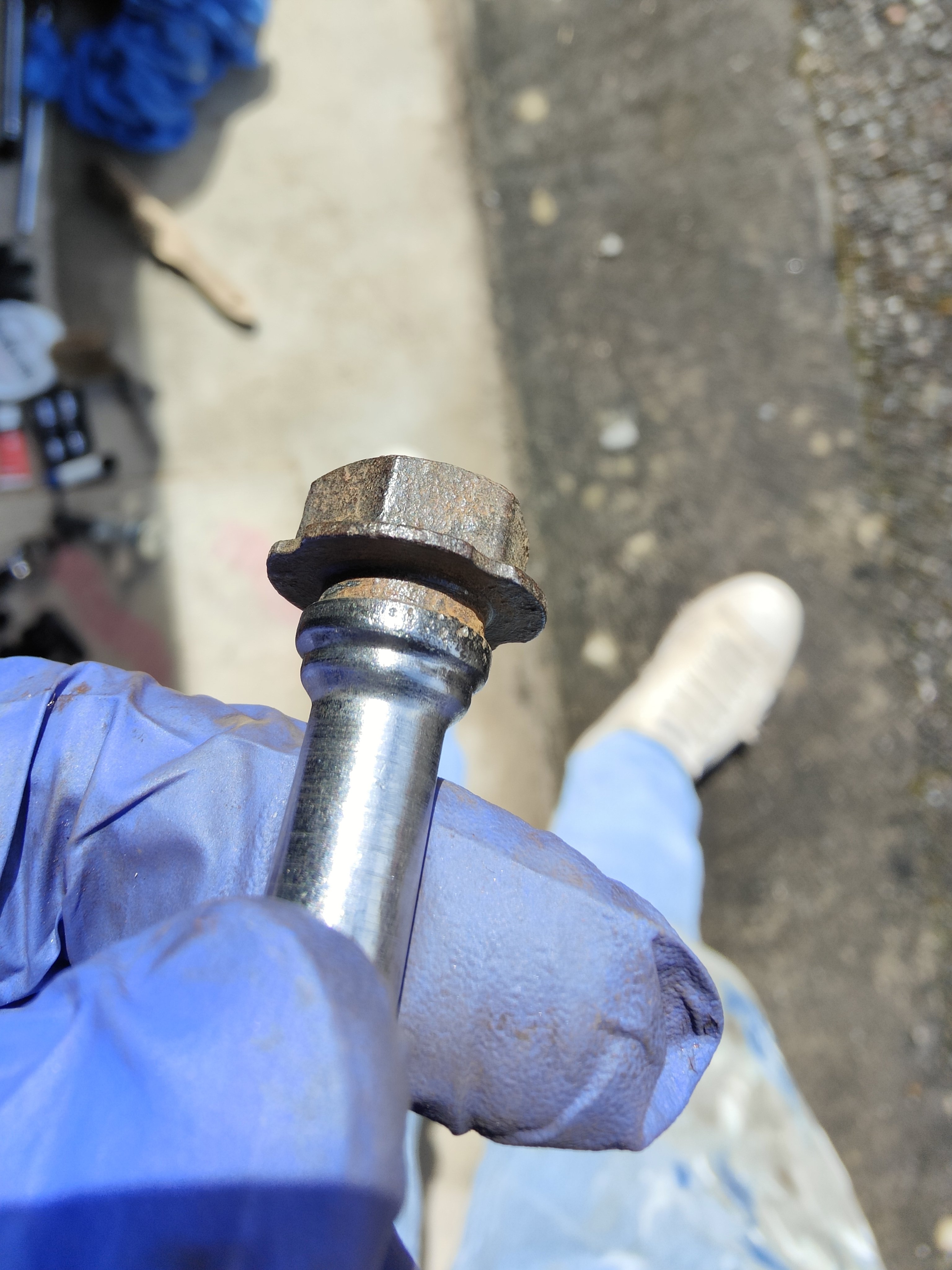

New ARB collar bolts, the old ones were pretty crusty and although came out OK I wouldnt want to use them again.
Most of the underside is pretty crusty and at some point Ill need to start thinking about various arms, bushes and the subframes itself.
Until that day, on with the mods! Next on the list is an APR billet steel dogbone insert and when I have a good day to do it a full machine polish.
