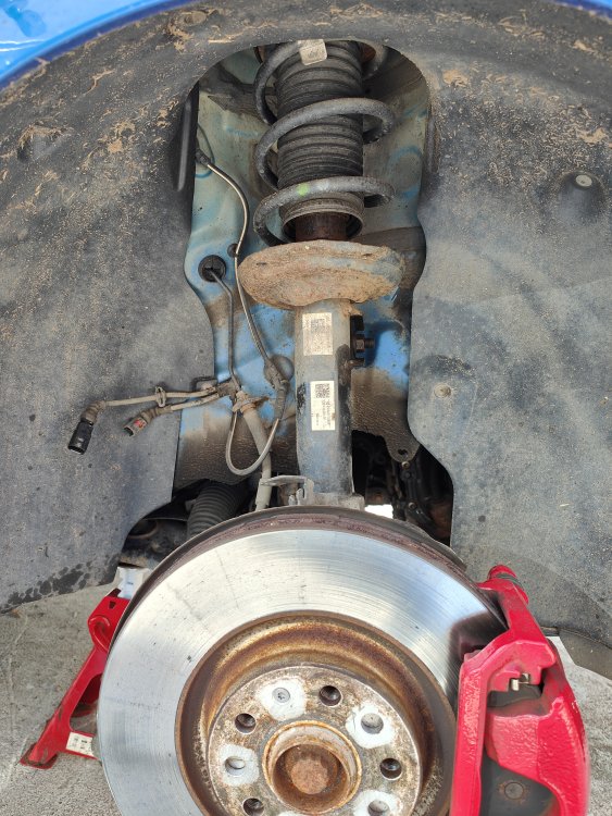

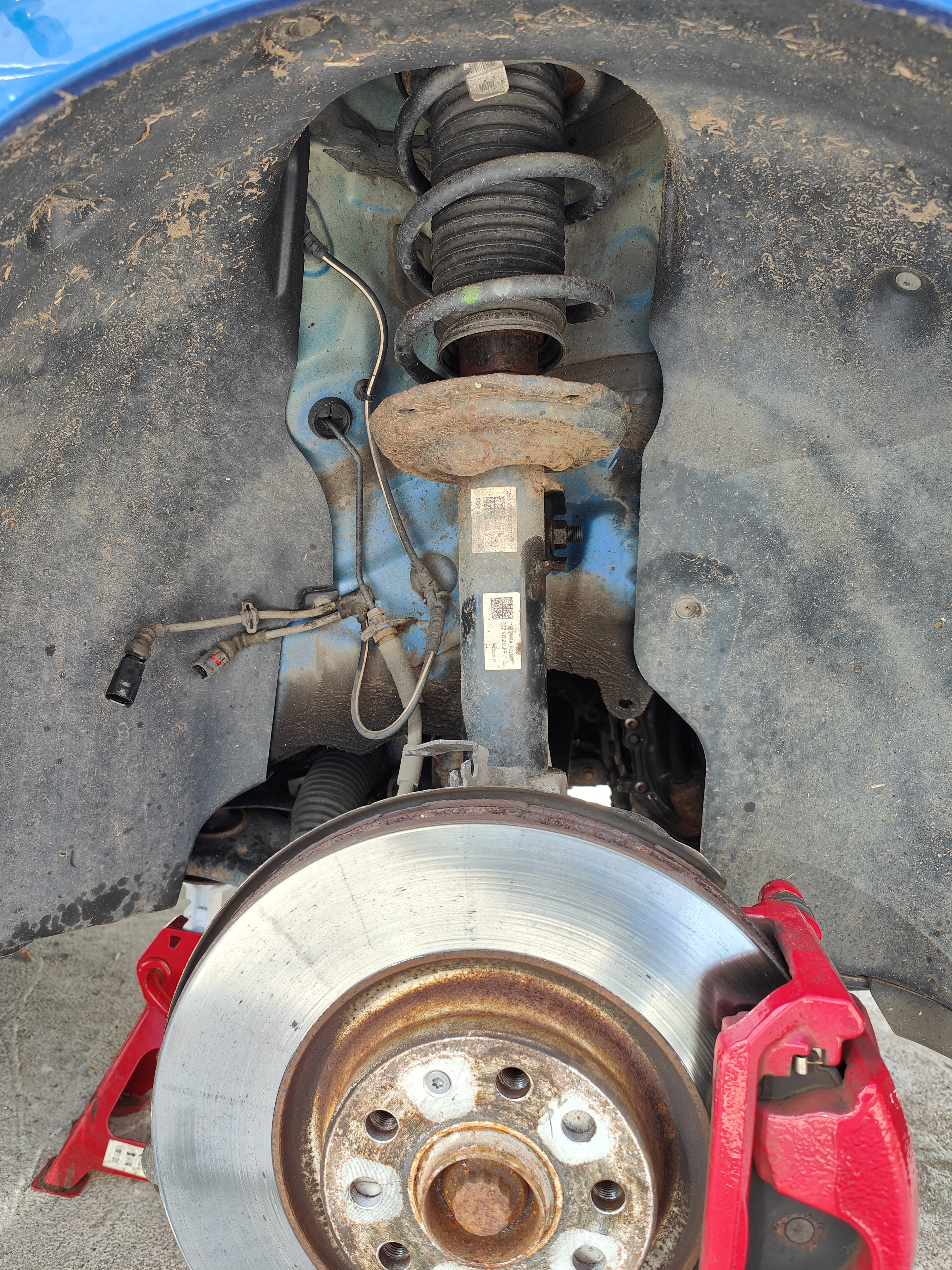

So, a friend (Jedd) and I tackled the suspension! Bloody hell, it turned into a mission...
Started on front nearside. Instantly, he said the best procedure will be to pop the caliper off, tie rod end and the 3 bolts for the lower ball joint at the end of the wishbone. Then pop the driveshaft out of the hub. Everything looked original and untouched, probably for the life of the vehicle which is 88k. Everything was rusty! We couldn't get the wiper arms off either therefore decision was made to lift the cowling gently which didn't make easy access to the 3 topmount bolts on the offside front.
The problems started with the nearside ball joint which would undo to a degree but then just spin. So, decision made to try the offside. Exactly the same. 2 TRW track rod ends were reserved and off we went to the local Euro Car Parts who had some in stock.
The old ones were ground off carefully and new ones wound on. The locking nut was not moved from the track rod so tracking isnt awfully out.
Hub and shock were taken out complete and shock removed from hub. Shock was built with existing bottom spring locator, dust guard and bottom out bumper and topmount attached and torqued up.
Then we realised that we couldn't get the shock all the way into the hub. Topmount and everything else removed and the spring seat used with a bit of wood to hit it downward which worked!
Built shock for second time, put onto car and torqued up. All bolts and mounting points were cleaned up and copper greased.
Offside was tougher, one of the bolts for the ball joint was knackered and just span. It was ground off and the thread on the bolt was quite clearly knackered 😪 This part doesn't seem to be available easily, despite being a ball joint. So, washers were added with a new bolt and all cleaned up, copper slipped and torqued up. When we put the topmount bolts in, the hardest to get to was just starting to be screwed in when the shock and hub assembly moved and pulled on the bolt pulling the initial threads on the bolt 🙄 This bolt was knackered and luckily we had a non OEM replacement. I'll try and get this replaced though.
Next up was the rear, thinking it was going to be easier than the fronts. How wrong we were... Both ARB droplink bolts snapped. The droplinks have seen better days so I'll replace these when I come to tackle more of the back. Due to not having any 8mm bolts long enough, decision made to drill through lower arm and droplink to accommodate a 10mm nut and bolt on both sides. These are a little too long so need to get something shorter, potentially stainless steel l for longevity.
Overall, basically all bolts were seized and rusty. Nothing was easy and everything fought us, but we got it done!

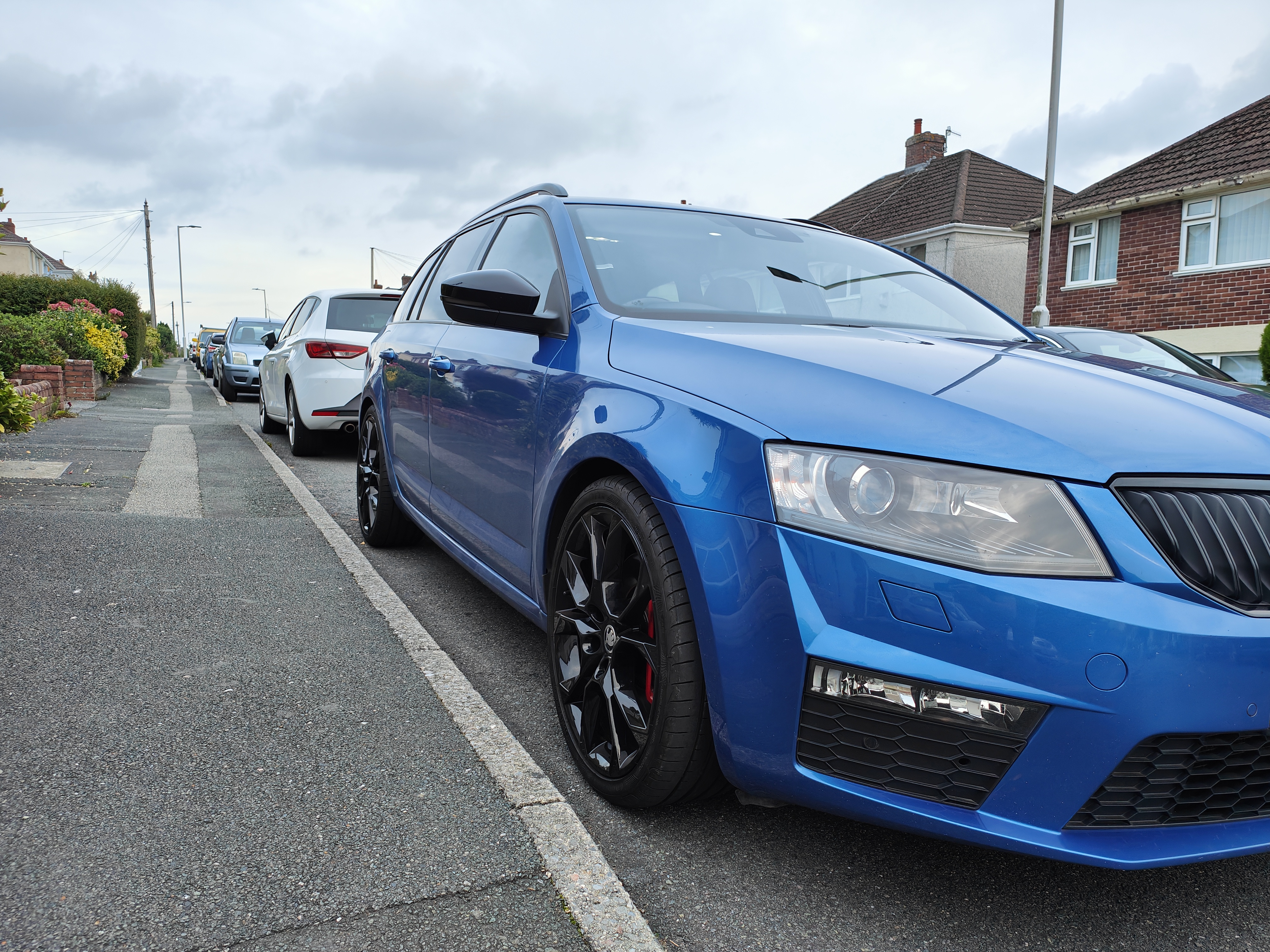

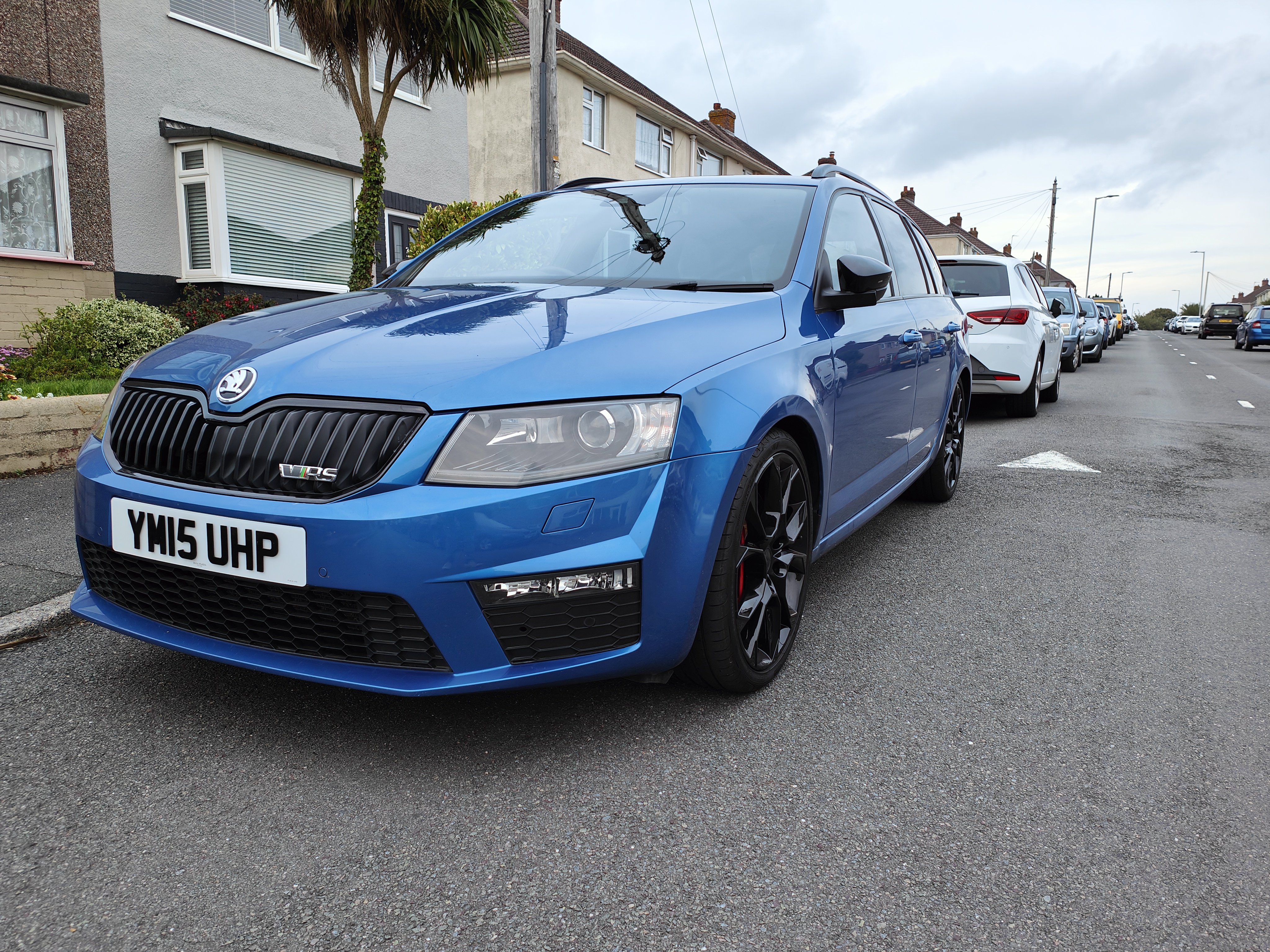

  • Before   After   Difference is subtle, unfortunately I haven't been able to get any great photos before and after. I'm happy with the ride comfort and it was definitely
  • So I attempted to fit the spacers last night after work... First barrier was the neighbour blocked the joint driveway with dumpy bags of sand blocks as he's having work done in his back garden! So, I
  • So, a friend offered me his alloys, recently refurbished and with 4 brand new Michelin PS4's for £800... I said yes.    Genuine Golf Pretoria's. I bought some ST-DZX 12mm hubcentric spacers

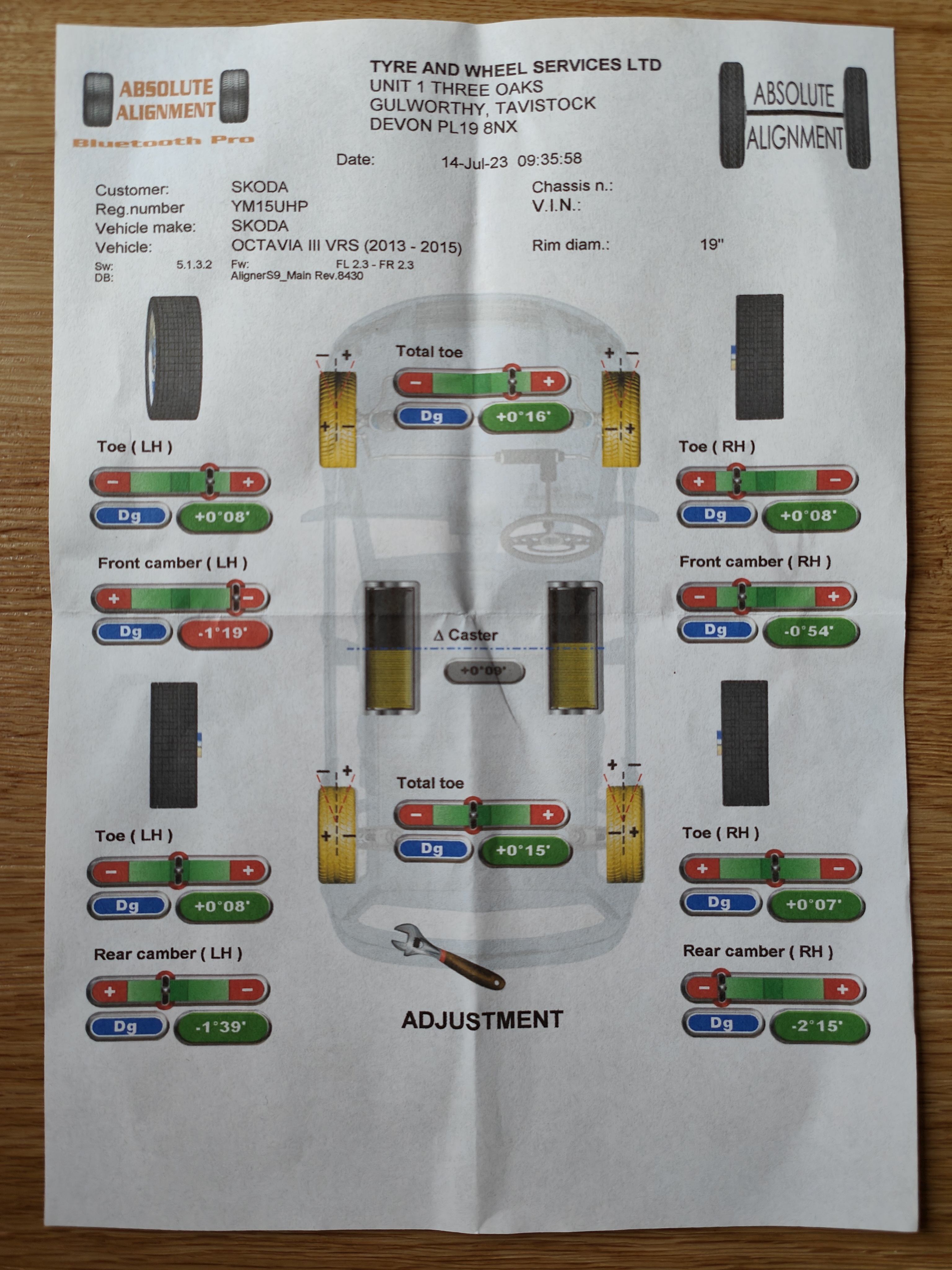

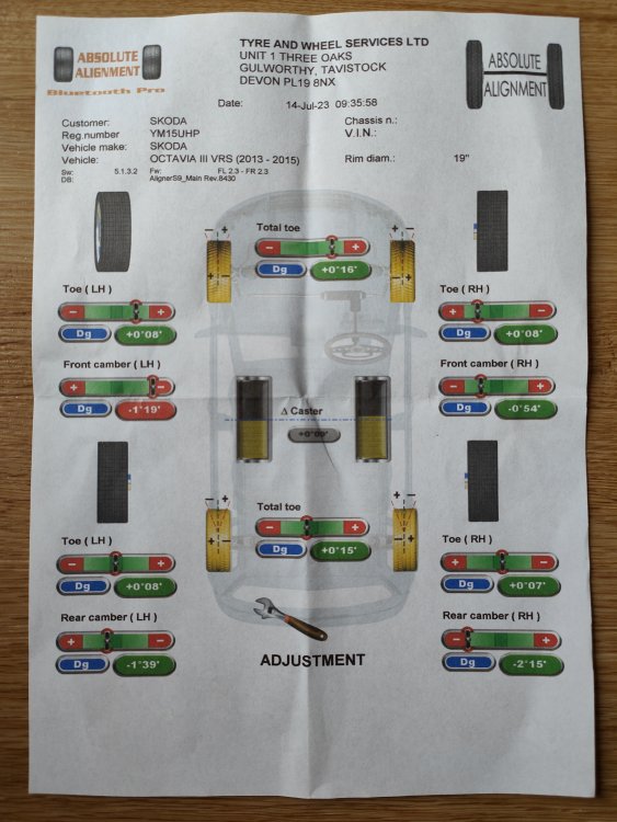

Small update, I got the tracking and alignment completed and the car now drives well. They have said the offside camber adjustment on the rear subframe is seized so can't adjust it. They said they'll have to drop the subframe to cut the bolt out and replace 😑

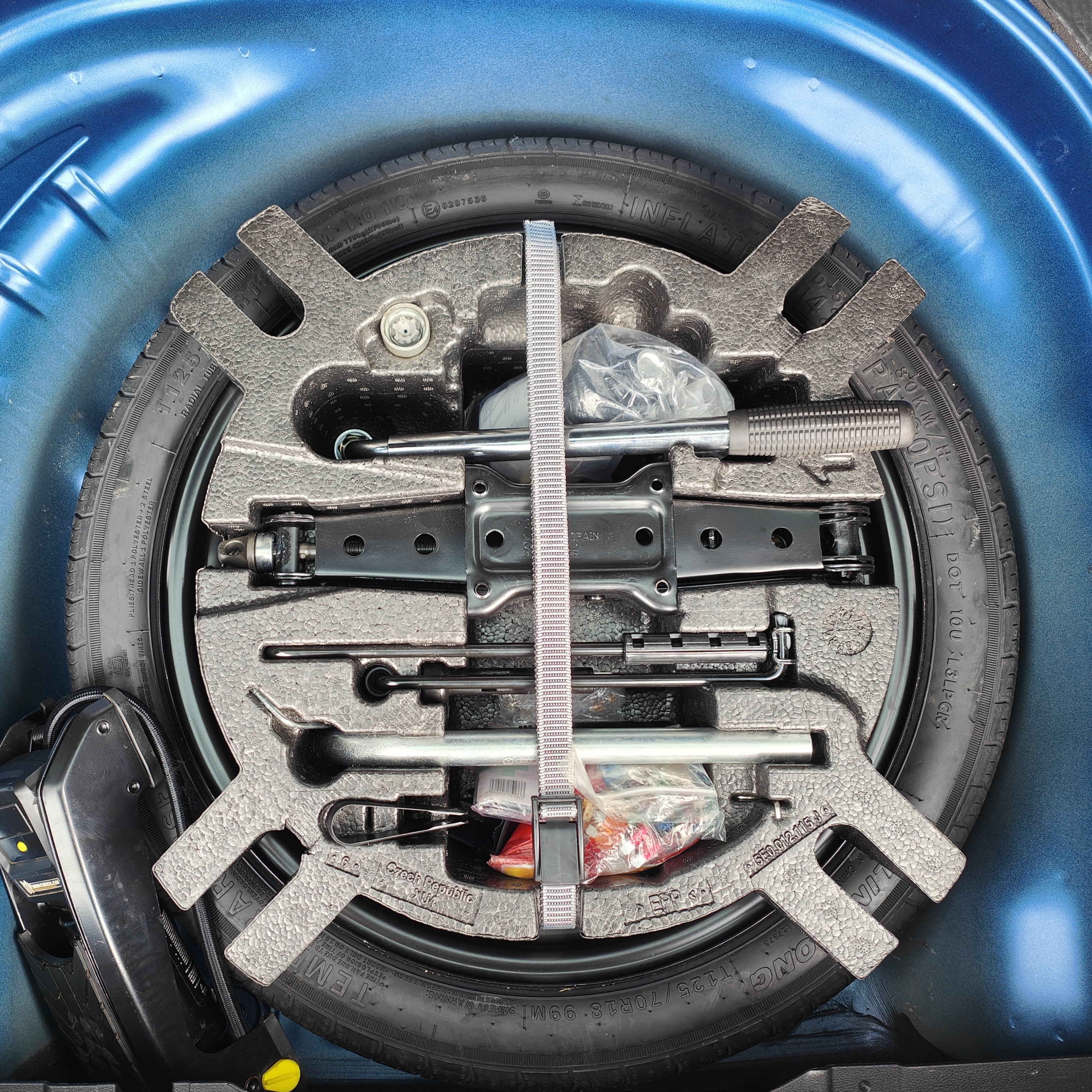

On another note, I managed to pick up a spare wheel. Genuine VAG 18" with polystyrene insert and full tool kit, completely unused. It cost me £60 which I thought was a bargain. I picked it up as I'm off to Caffeine and Machine in early August for an Air-cooled weekend and then a drive around Wales so wanted to be prepared!

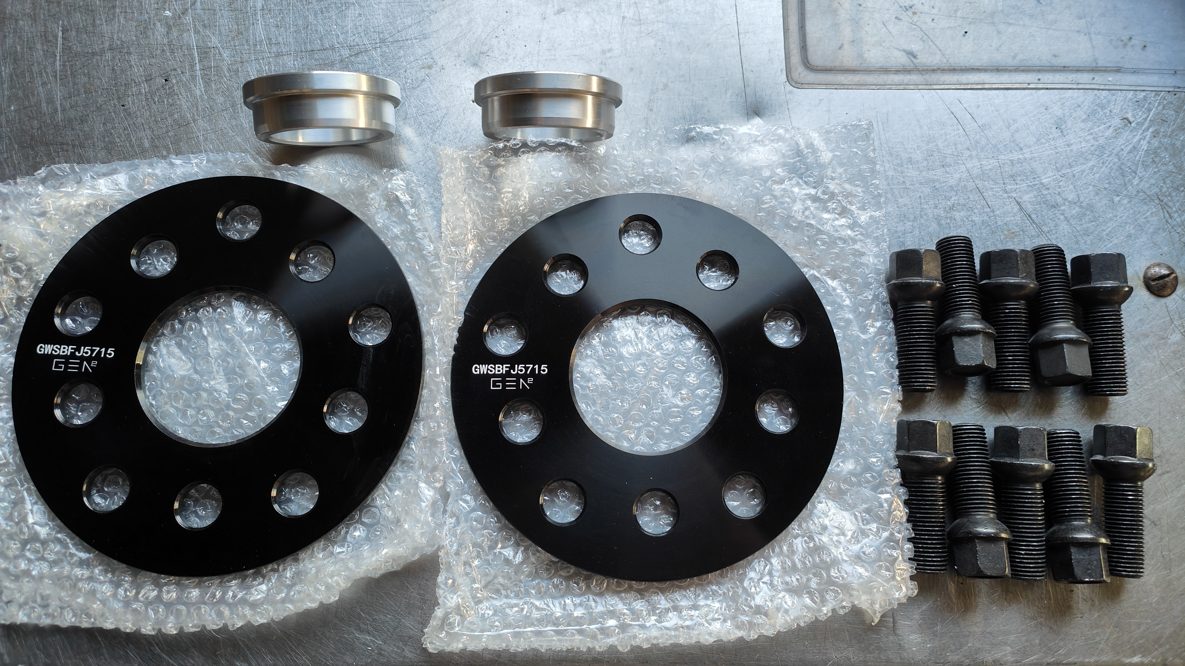

I ordered some Forge 13mm and 20mm spacers for the front and back at the weekend. I did measure the spigot depth and its 11.5mm. When I looked at photos and the construction of the Forge Hubcentric spacer there's definitely more than 2mm of material between where the spigot sits in and where the spacer takes over.
In the end Forge came back and said they were out of stock of one or the other and asked if I wanted to cancel my order. I went for a kit from Precision_Autoparts on eBay who supply 15mm and 20mm spacers with 40mm and 45mm bolts for £78.99.
I haven't measured the rear hub spigot depth but someone on a Facebook group said recently they tried to fit 16mm to the rear and the only way they could get them to fit was take off the metal dirt shield.

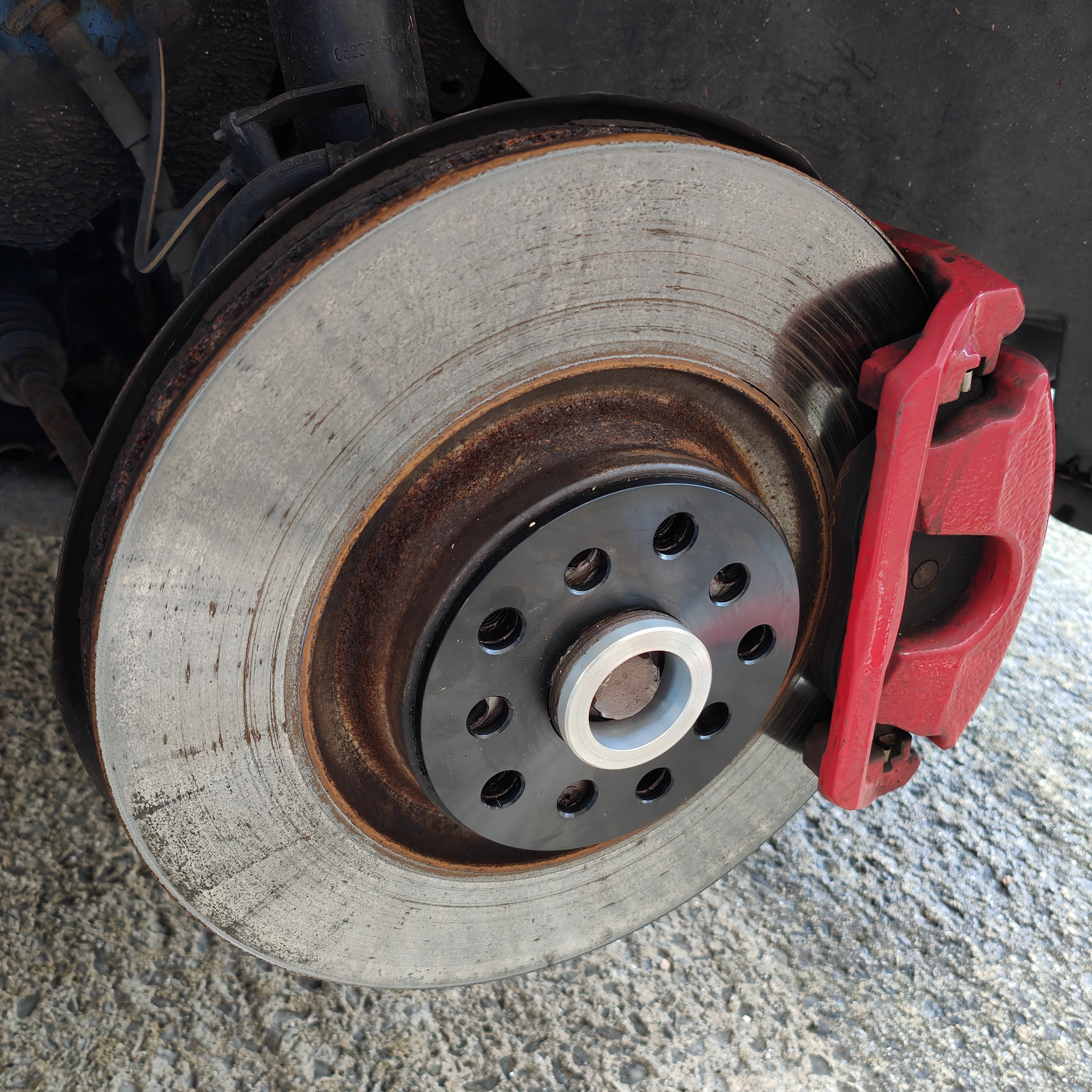

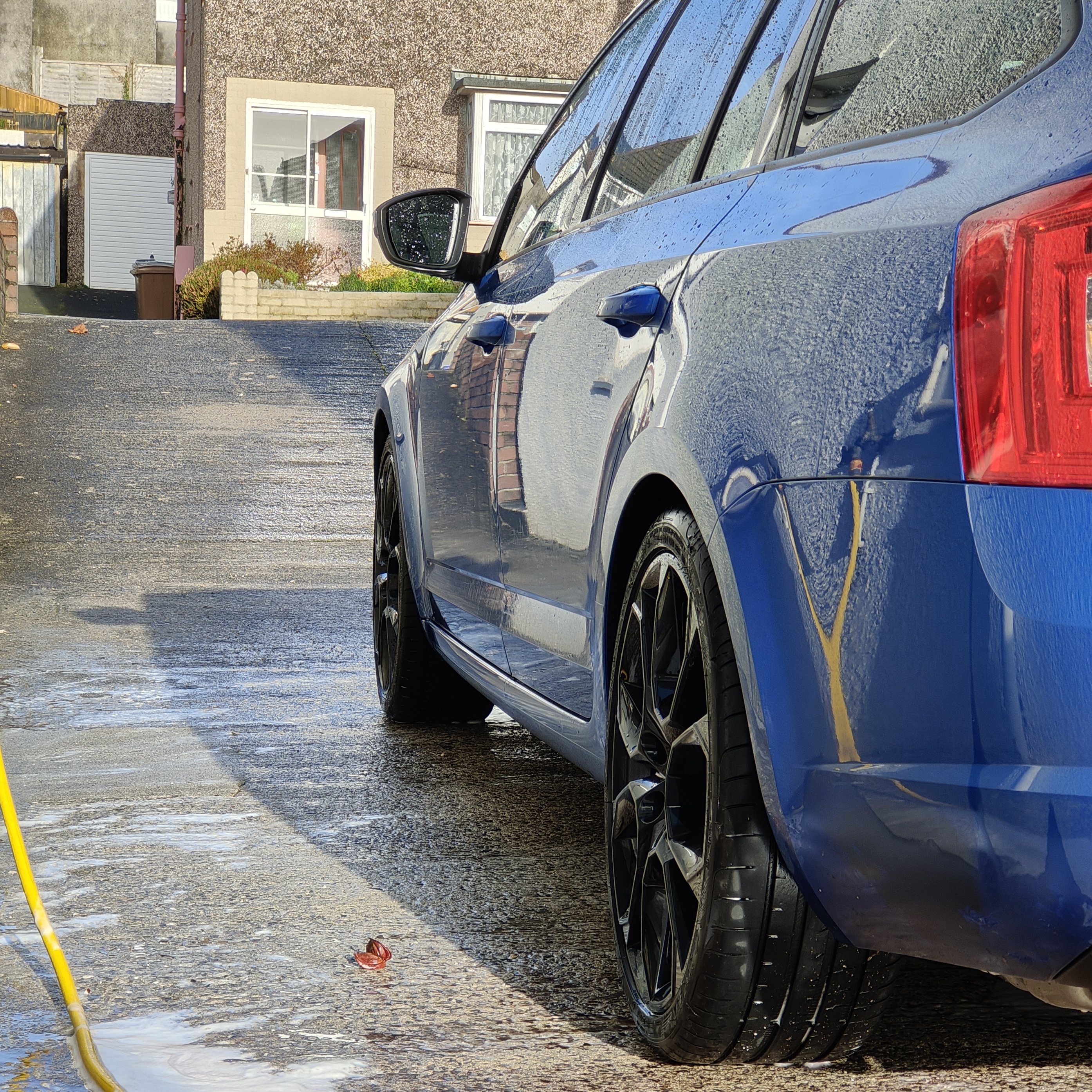

So I attempted to fit the spacers last night after work... First barrier was the neighbour blocked the joint driveway with dumpy bags of sand blocks as he's having work done in his back garden! So, I parked across the drive and jacked the car up which was far from ideal.
The point of getting the spacers on for this weekend was I am visiting Caffeine and Machine with a friend today and then driving around Wales tomorrow. I wanted to see if the wider track would make it handle any better.
I got front and rear on one side on, then turned the car around and attempted to fit the rear on the other side. Except, the locking wheel bolt was edging towards being rounded. The locking wheel key would slip meaning I couldn't get it off. Thinking back, I asked the guys at the alignment place to torque up all bolts...
I rang a mechanic mate and drove over there, one side with spacers and one side without! By this point it was 8.30 and starting to get dark. Once I told him the problem he figured a way of putting enough pressure on the wrench so the key wouldnt slip. The legend only got it off! A quick check to make sure the other front could undo and away I went.
I had already decided I liked the 20mm on the rear but was unsure of the 15mm on front. The front needs something but 15mm is too much for me. I suspect I may get 5mm spacers and potentially get some hub extenders which I saw on Awesome GTI. There's also the point of increasing the scrub radius, which I'm sure VAG have done alot of research to get to. I knew that increasing rear track would help a little more and it certainly hasn't done the facelift VRS any issues.
A few quick photos.
With spacers
Without spacers
Once I got home I fitted the rear 20mm, took the 1 front 15mm off and torqued everything up. Took it to a local self clean and gave it a quick rinse.
I also splashed out on genuine Skoda wheelcaps from a local dealer which I fitted... £62.45!!!
But the car is looking and feeling good. Time to test it out over a weekend of driving!

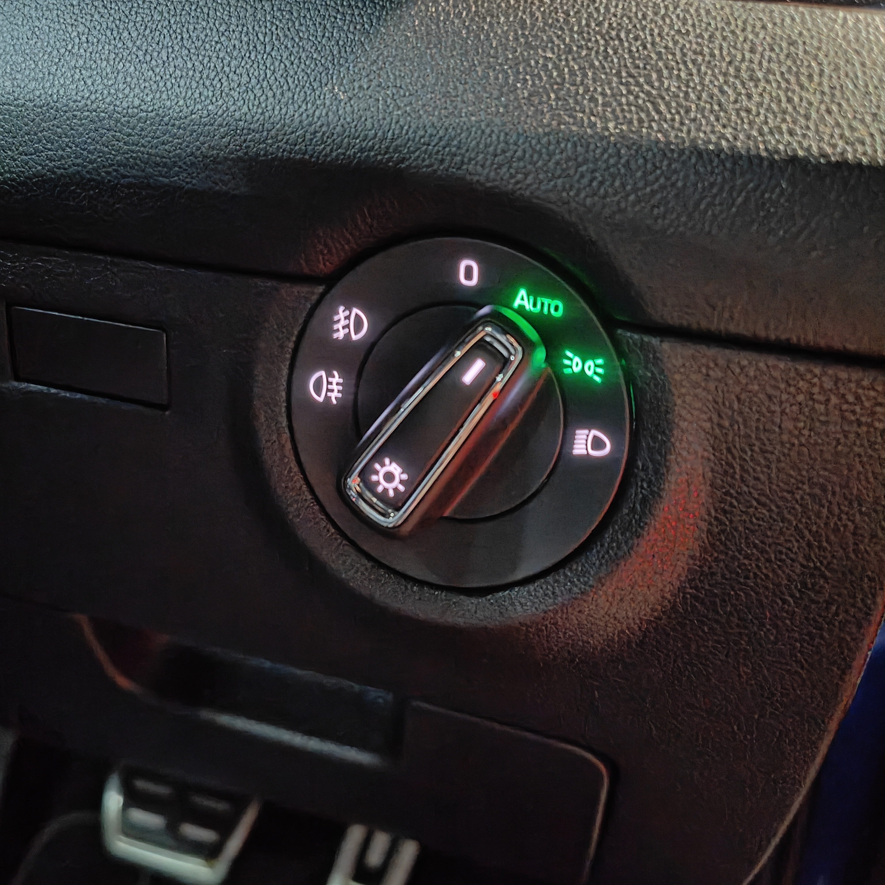

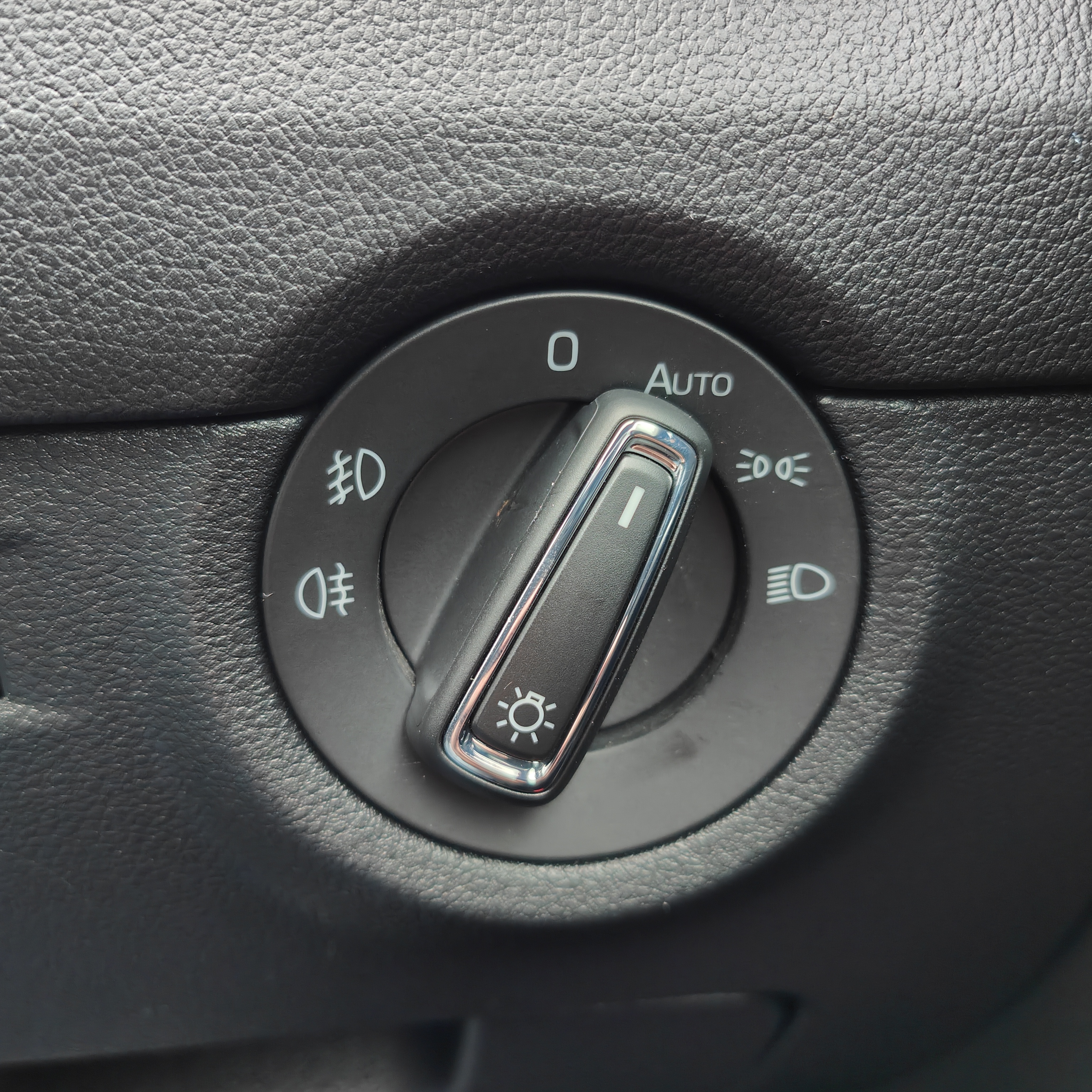

A small interior mod, a Superb MK3 light switch with added chromey bling. It is white and green instead of all green. It was all of £23 from eBay, I just confirmed I matched up functions and number of pins.
I started looking at other items, such as Golf mirror adjuster, window switches and facelift climate control. I also looked at a frameless Golf interior mirror.
I decided against all of it due to the level of work and that the mirror won't fit due to the connection. Also, I seem to have a combination of white and green already, my steering wheel buttons are white but everything else is green. I also really need to get other bits sorted so I'm looking at ball joints for the front end.

The switch looks smart, how easy is it to pop the old one out of the dash?
Very, turn it to off position, push it in, turn it right and it'll sit at the auto position. This releases the catches and it slides out. IMG20240202103644.thumb.jpg.68e975cef26551006ed94714d9fbf90c.jpg
For the mirror mod I believe anything facelift can take the Golf frameless mirror. Before this the bracket is different, but it would have been a nice mod to do.
Oh, bugger, I was hoping you'd say it was a pain and I wouldn't bother attempting it 🤣🤣
Thanks for the quick response.👍
I'm off to surf eBay...
Just check how many wires you have on your wiring loom, not the old switch. My switch has 10 pins but the loom has 9 wires. The switch I bought is part number 3V0941431 and seems to work perfectly.
