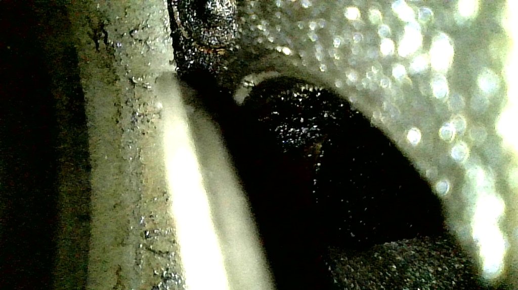

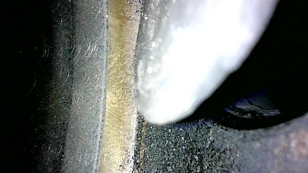

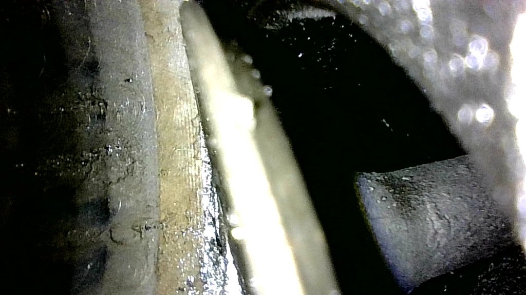

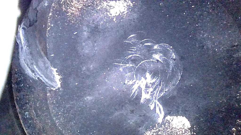

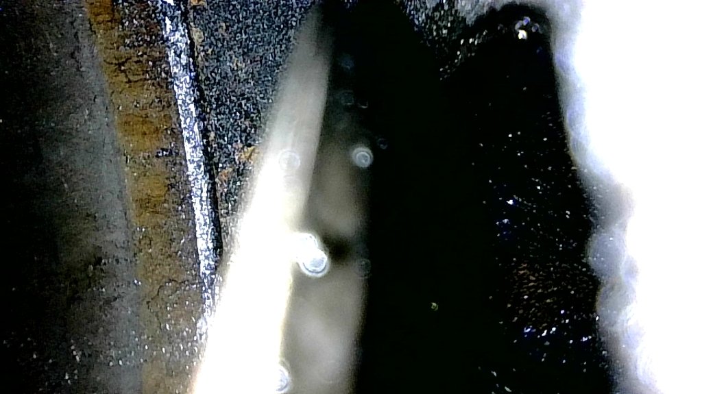

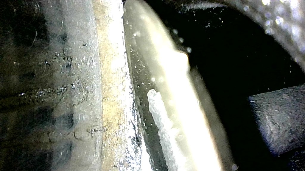

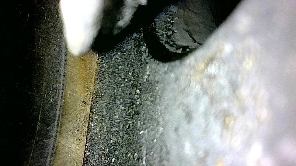

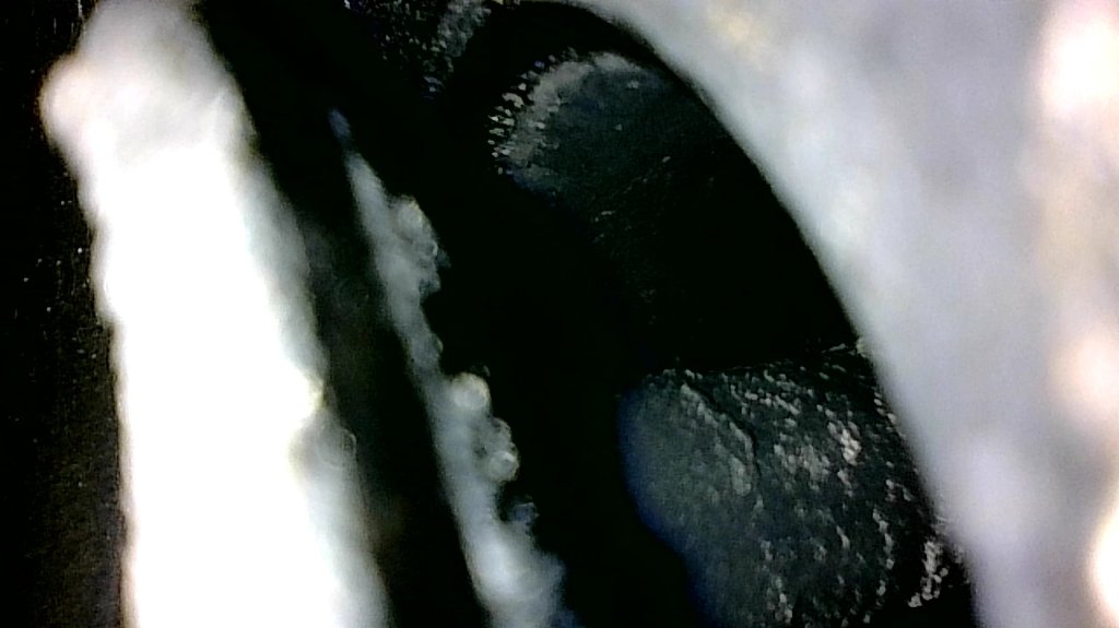

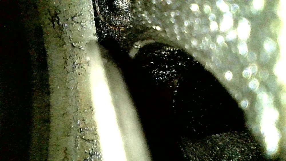

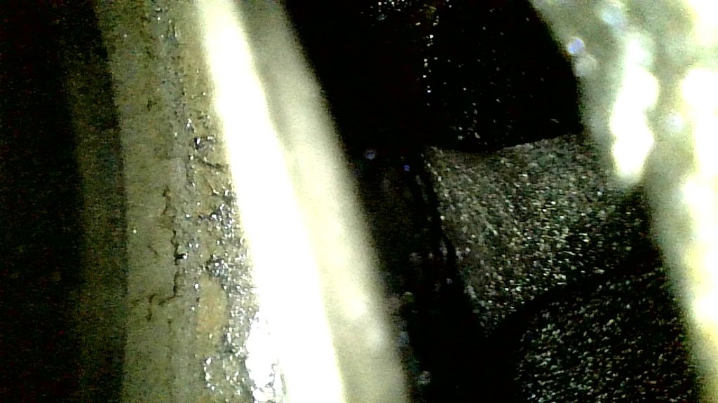

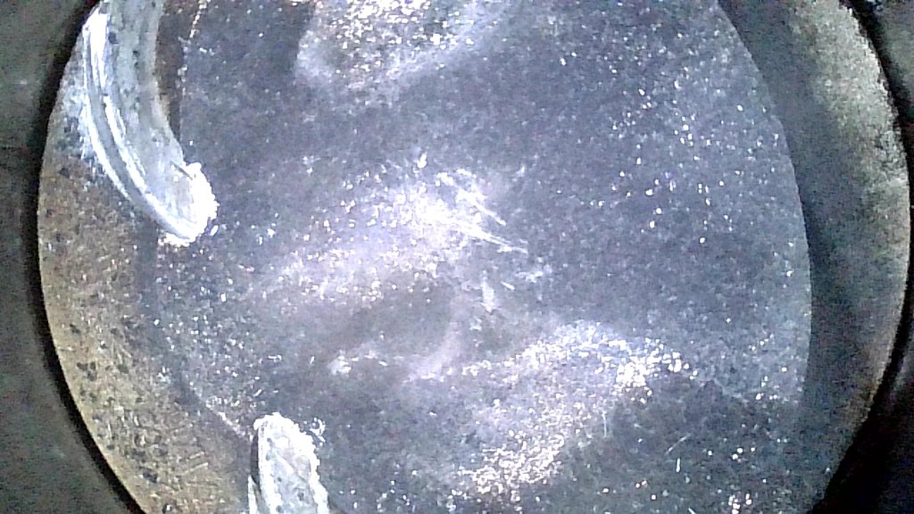

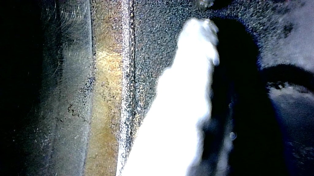

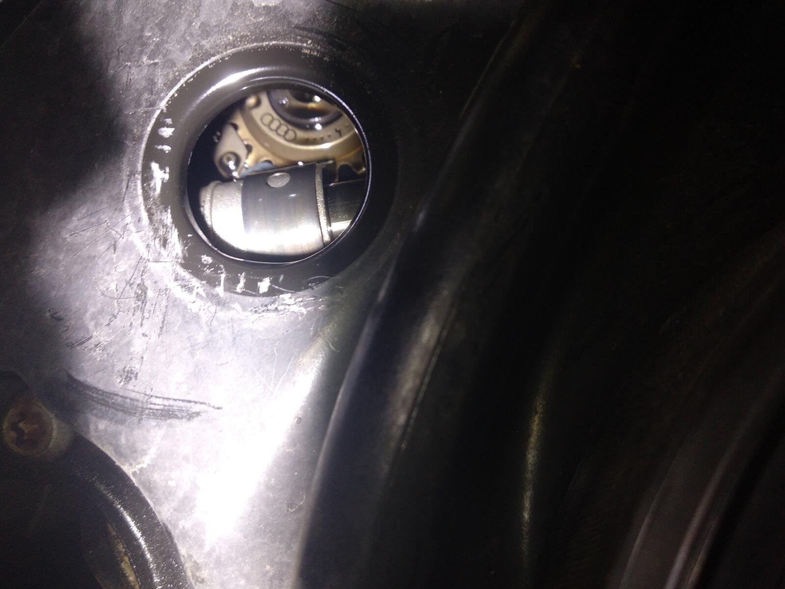

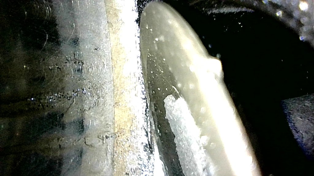

I've used my inspection camera and looked into each cylinder but I couldn't see any problem. The piston surfaces look clean,
I can see the two recessions and no marks on the surface. I couldn't  see any valve though, those sit back from the camera
and I guess the filed of view is not wide enough to see them (not visible even when the camera enters the chamber).
I've also bought a compression test kit, cranked the engine and I have no compression at all (0 psi) in all the cylinders.
Since it's the first time I use this kit I check it is working with my bicycle  pump and it was.

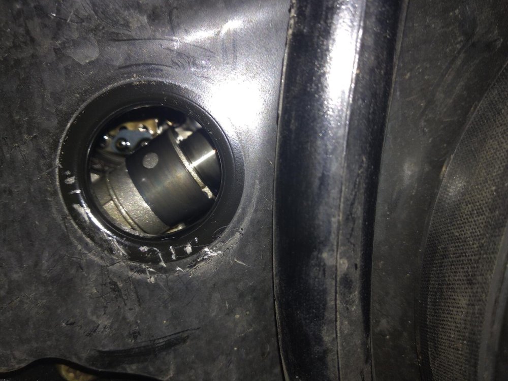

Again I hear no metallic noises when I crank it. I've placed a carbon fiber rod in each cylinder and hold it with my hand
to check that all pistons travel up and down, no problem there.

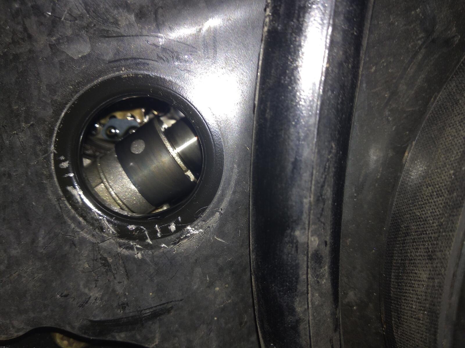

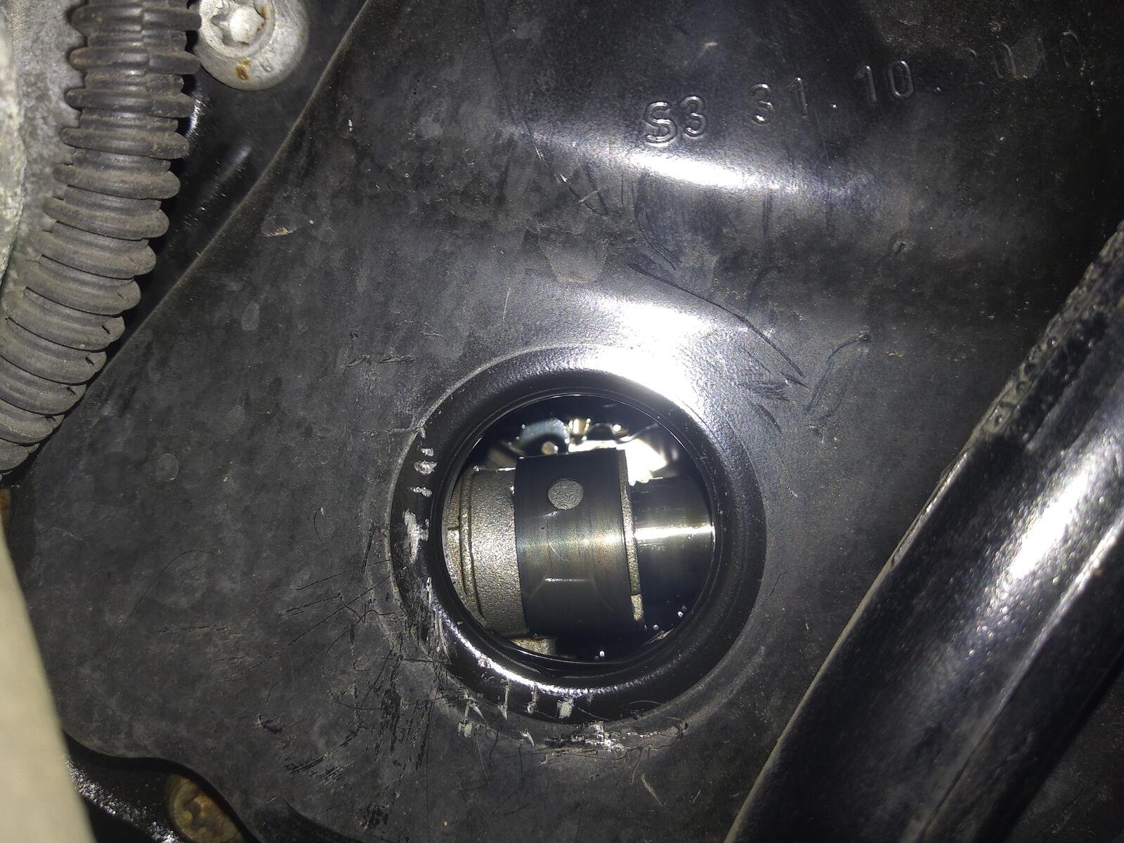

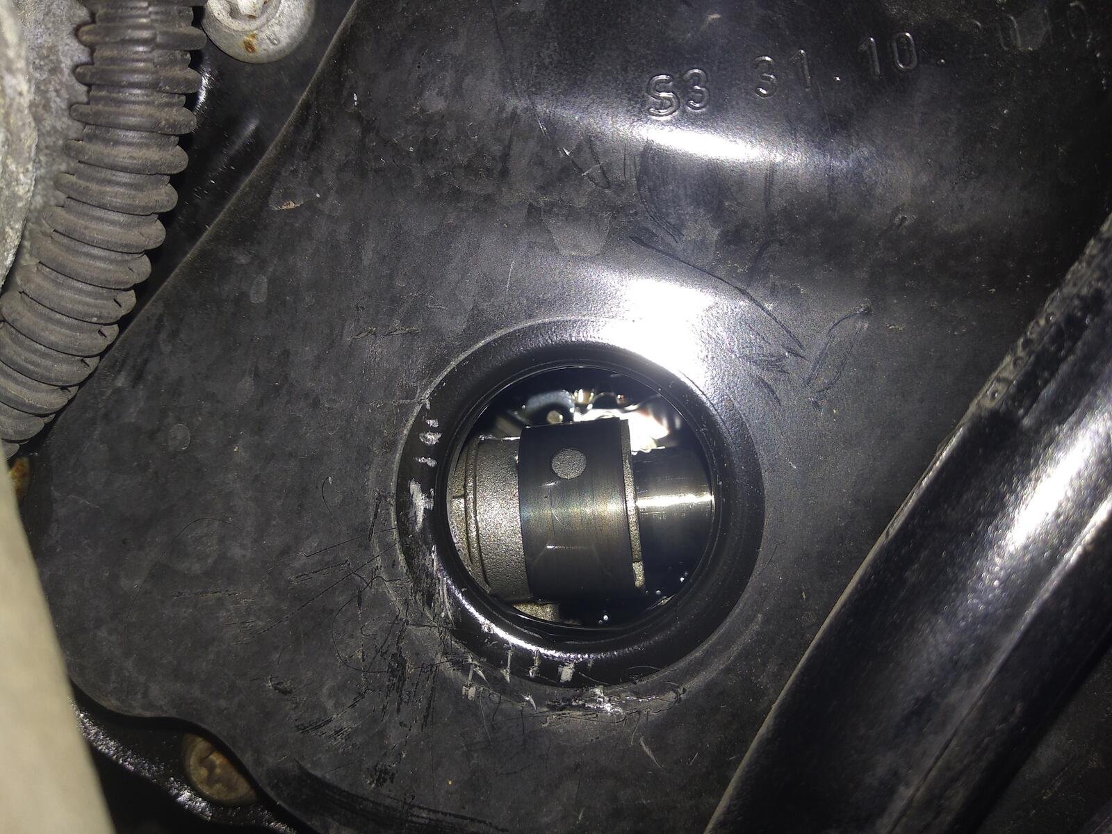

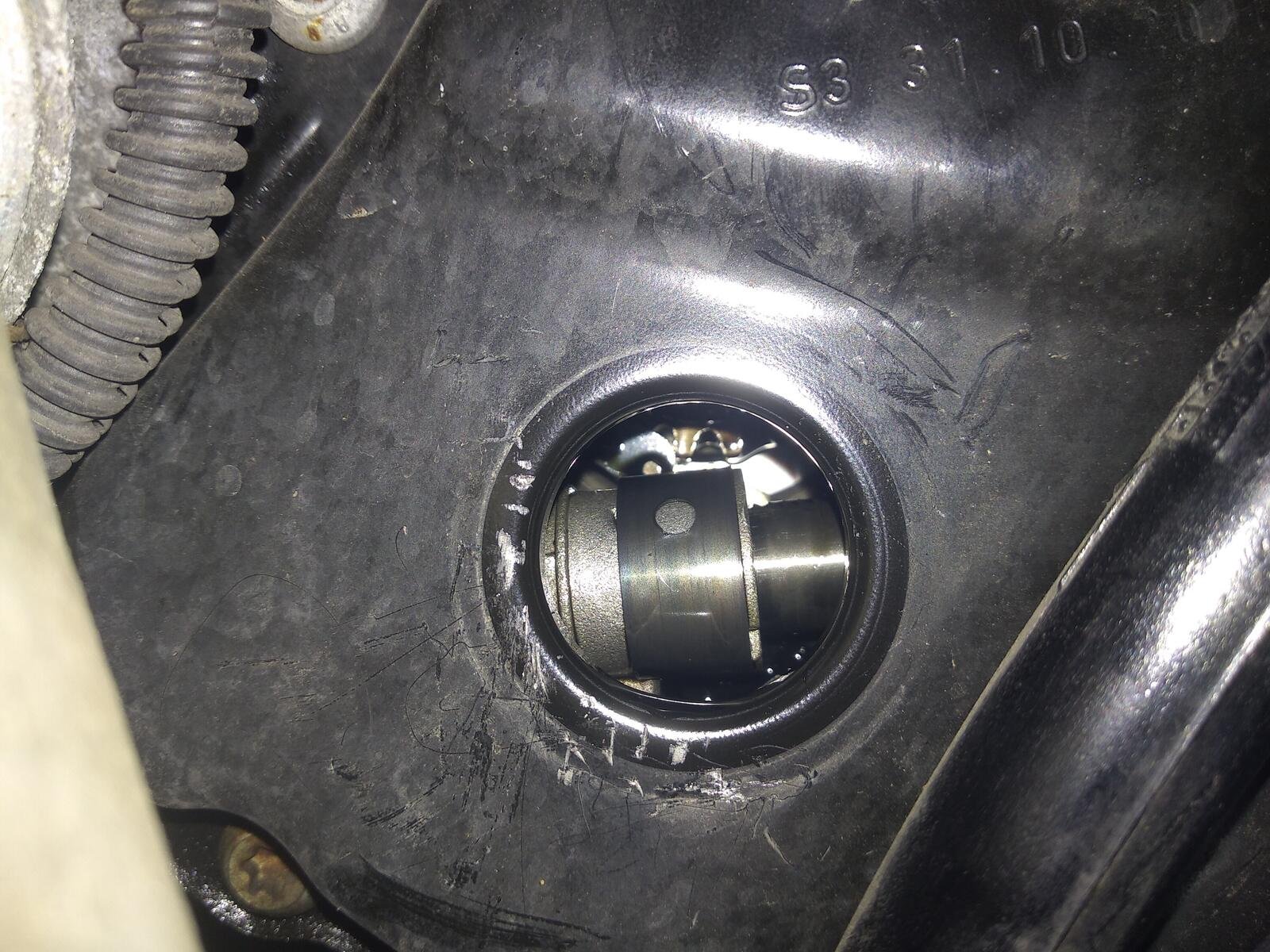

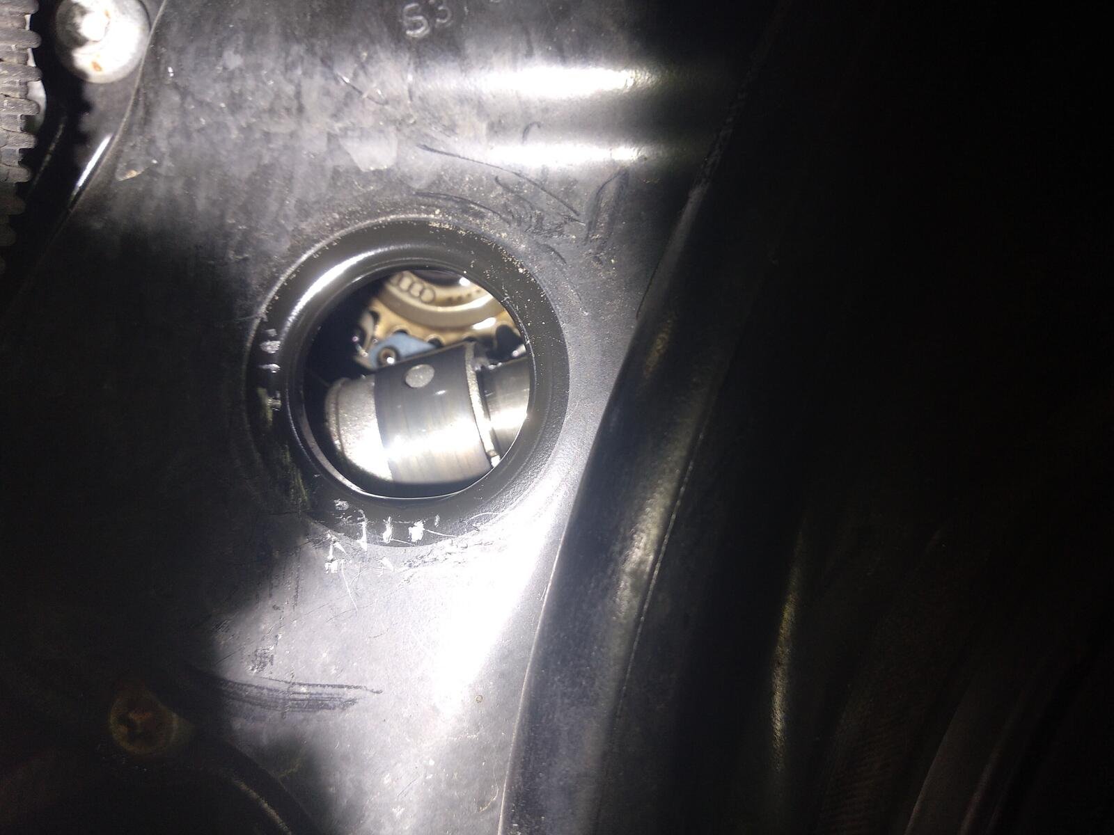

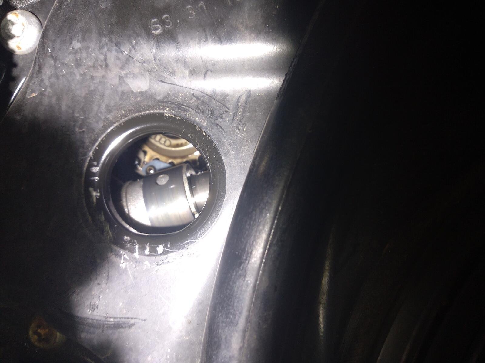

I can see through the oil port that the inlet camshaft is rotating and one valve rocker is visible and moving while cranked
so I don't have a broken timing chain.

I've also accessed the tensioner port and took some pictures. It was a lot of work to get there: I hat to take the wheel off,
then some 20 torx screws to get the wheel arch off and a I had to disconnect a thick air hose which was sitting exactly in front of it.
Are these a definite symptom of timing chain slip? Before changing the plugs the engine still started but rough. Did the chain slip
further when I've cranked the engine with no plugs in?
Is it normal to have no compression in all the cylinders or could could it be another cause as well?

Edit: By the way. that is an old style tensioner. Very susceptible to failing but doesn't look like it has failed totally in the normal way. However, it looks a long way extended but I can't count the teeth due to the angle of the shots. Access is better with engine mount off.

In some of the images you can barely count the teeth on the tensioner piston - I see 3 teeth.
I'd probably start by removing the upper plastic timing cover.   This would allow you to measure distances from the links. You could also try to feel for chain slack, although not sure how successful that would be as it is right at the top at the sprocket.
I can dig you out some instructions if you want. DAP / Humble mechanic has a couple of good videos as they do a lot on the 2.0 tsi. The 1.8 is of the same ea888 family. The Erwin repair manual which will probably cost about 10 euro for access not a bad idea before embarking on the project.
Another thought, if you take the pcv / fine oil separator off the top of the engine you can see in the cam cover particularly the intake valves lobes and actuators.   This is a fairly quick job 30 mins. Be careful with the plastic tube connectors (fragile) and do not drop anything into the aperture where it is removed. But I am virtually certain you have a slipped timing chain. The questions is, is there valve damage?

You were right, all my inlet valves in all cylinders are bent. The exhaust valves are fine though. I've bough this week a quality borescope which has dual cameras one pointing sideways.
With this lateral camera I can see very well all valves and inlet ones are all opened and bent.
Since the bending happened while I was cranking the engine with no combustion in the cylinders I am hoping the damage is not too severe.
If a buy a timing chain kit and a full set of valves would this be enough for a garage to repair my engine?
Photo 3 appears to show the piston crown broken off at the edge exposing the top piston ring, no decent garage would ever reassemble an engine with that.
I would say that it needs 4 new pistons as well.
Ouch! Looks nasty! Hope you can get it fixed at reasonable cost. Something like that might cost more than the value of an 11 year old car.
Bummer.! That third photo is a worry. It does look like a chip but is right on the edge of the piston pre-made relief isn't it?
I fear the whole job is becoming uneconomic unless you're very attached to the car and would like to spend a substantial sume to keep ot for another say 5 years plus?
That head repair with 8 valves and possible valve guides reseating etc. How much would an engineering shop charge.
I know is the us garages usually go for a vw exchange head for piece of mind and speed. And the retail on the whole job incl timing chain is around 4k USD. Imagine it would be similar in euros.
And you've still got this potential piston replacement. And even if not, increasing oil usage.
I guess if you did all the disassembly and reassembly it could just about justify itself. But it's a big job even without pistons rings, and the upgraded parts required new conrods from memory as well.

That piston skirt damage is where you're going to come unstuck though?
