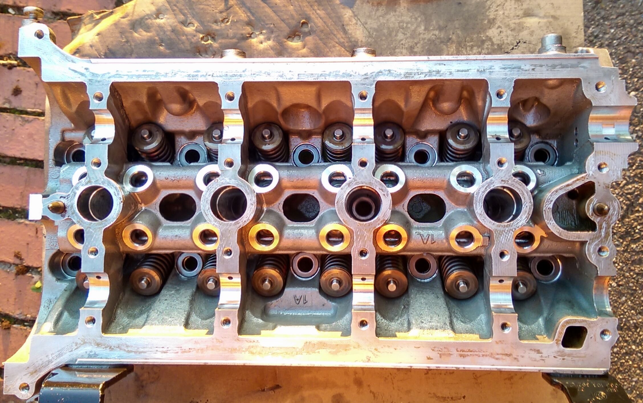

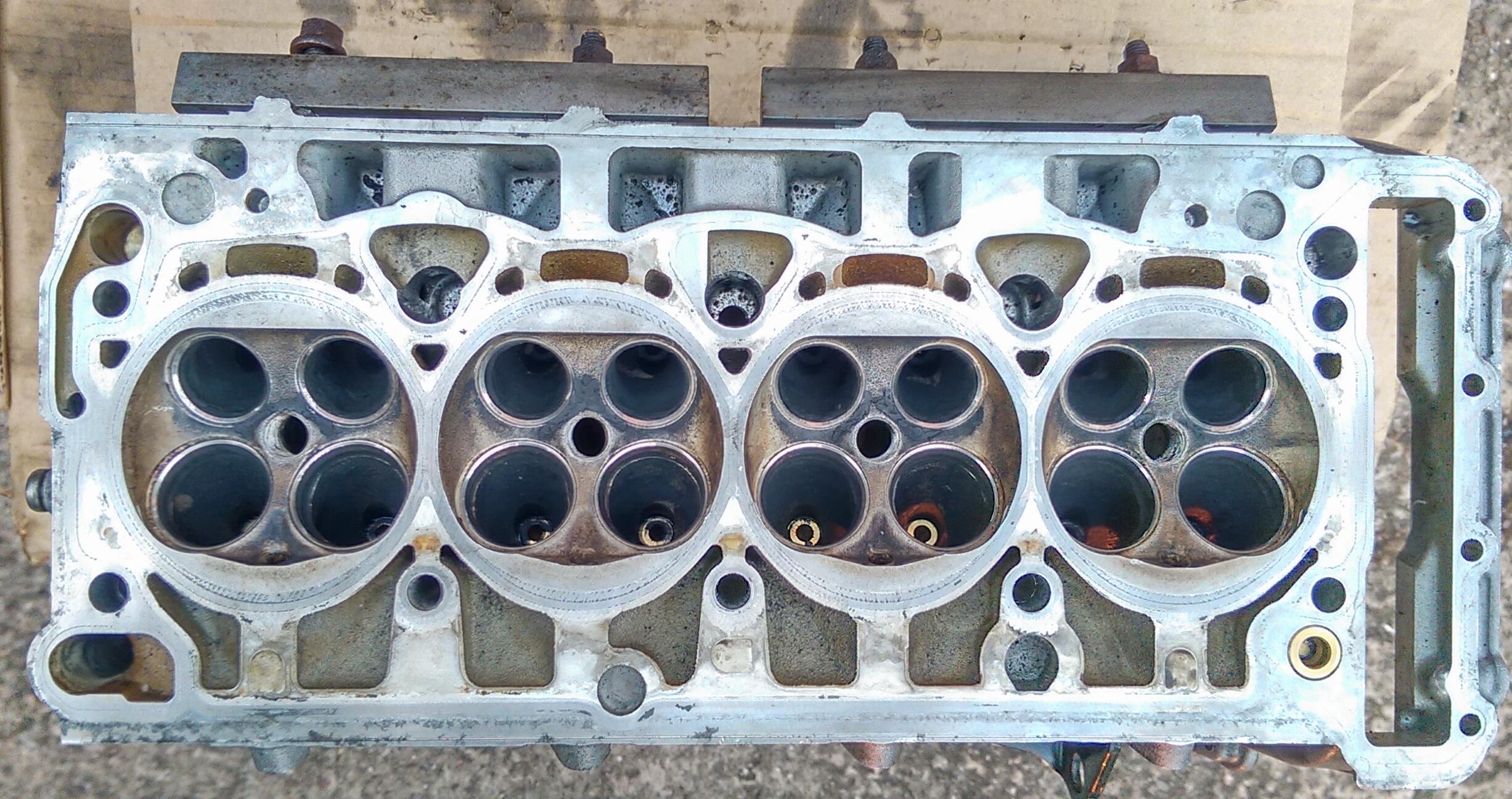

I took the valves out and I've spent a few hours cleaning the head (very time consuming). All valves came out with just a hand push.
I've used a combination of intake valve solvent, kerosene, kitchen paper towel and the green slightly abrasive kitchen towel for the two mating surfaces.
I've been very careful not to scratch these surfaces. Then I've used a Dremel with a wire mesh disk to clean the inside of the valves port.
There is no damage to the valve seats and the head seems to me in good condition so I'll reuse it. Three out of the eight intake valves have crushed the

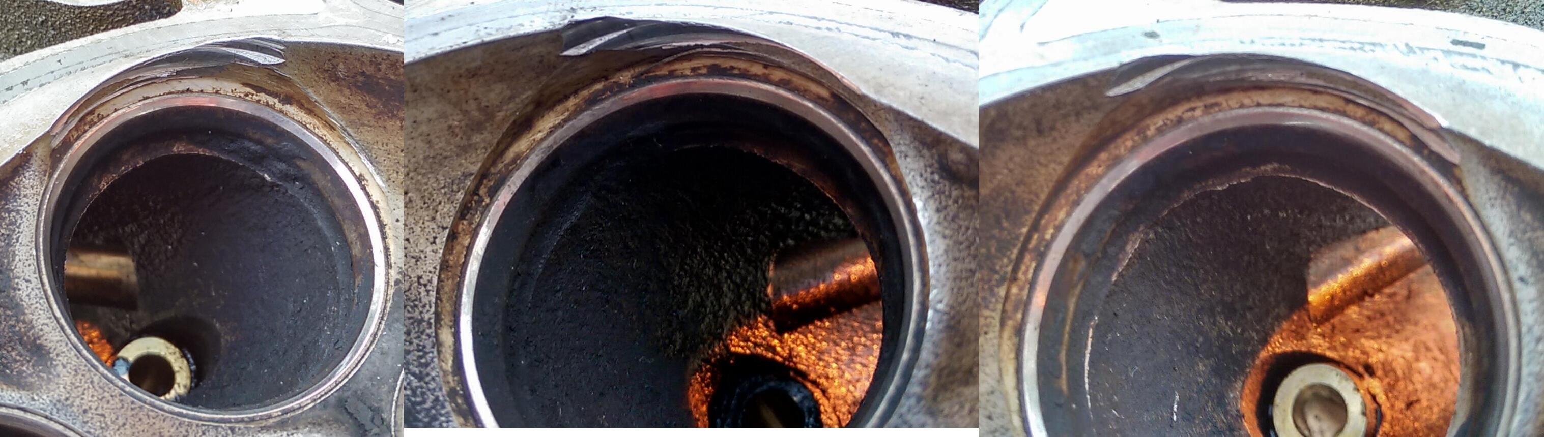

lip of the head (the crush can be seen in the picture). For those I've used a chisel shaped knife with a flexible steel blade and I've removed a tiny amount of
the aluminium where it was crushed and I'm pleased with the result.

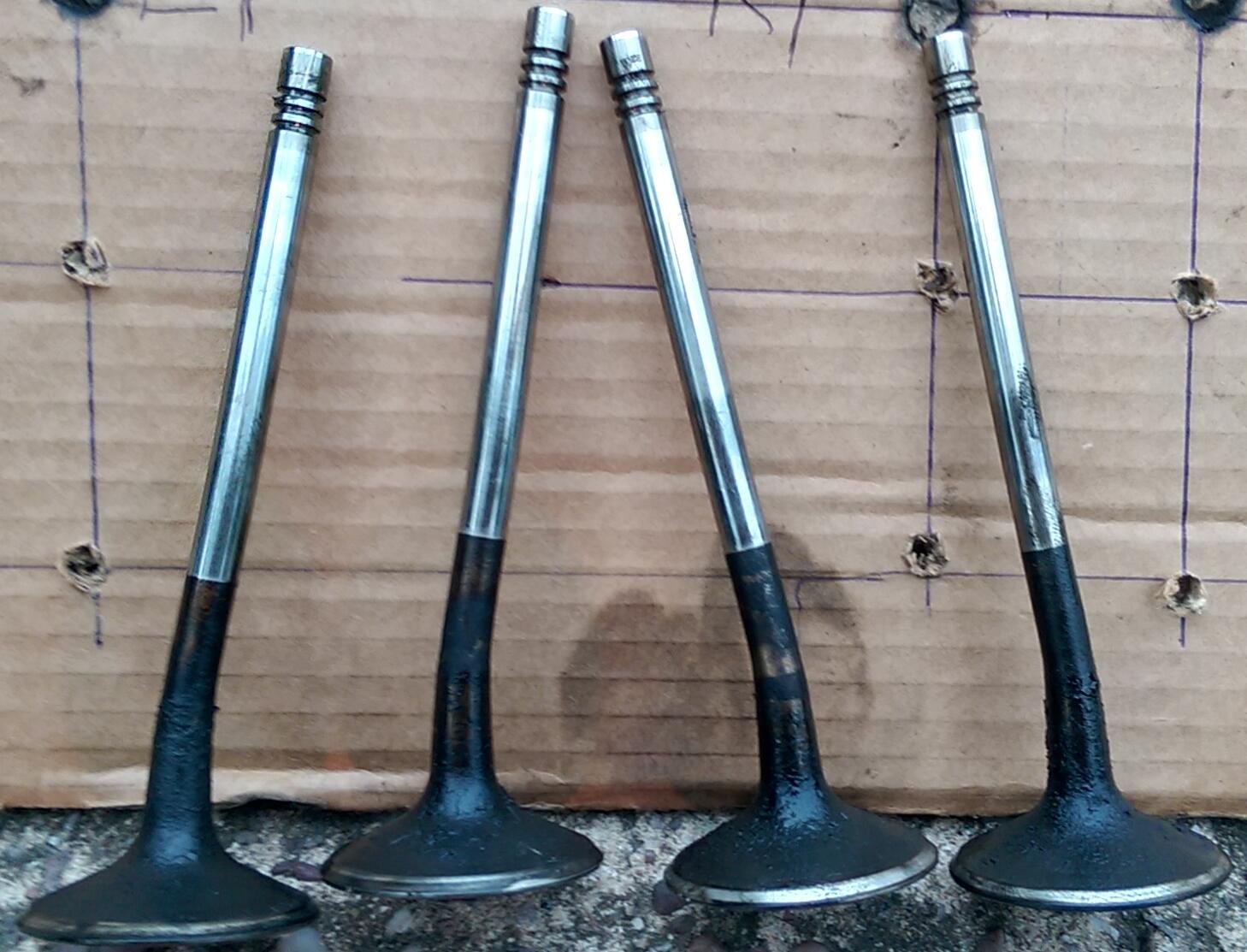

I wasn't able to clean the exhaust valves (I've tried a lot of solvents); the deposit on the valve surface is almost like stone and I don't want to use flame or
any mechanical grinding. So I've decided to change all the valves.
When I put it back together with a new head gasket should I also use a spray to cover both sides of it or is the gasket by itself good enough?

I take it you'll lap the valves in (old and new)? If the old exhaust valves were that cruddy you probably wouldn't get the suction cup to stick to them anyway.

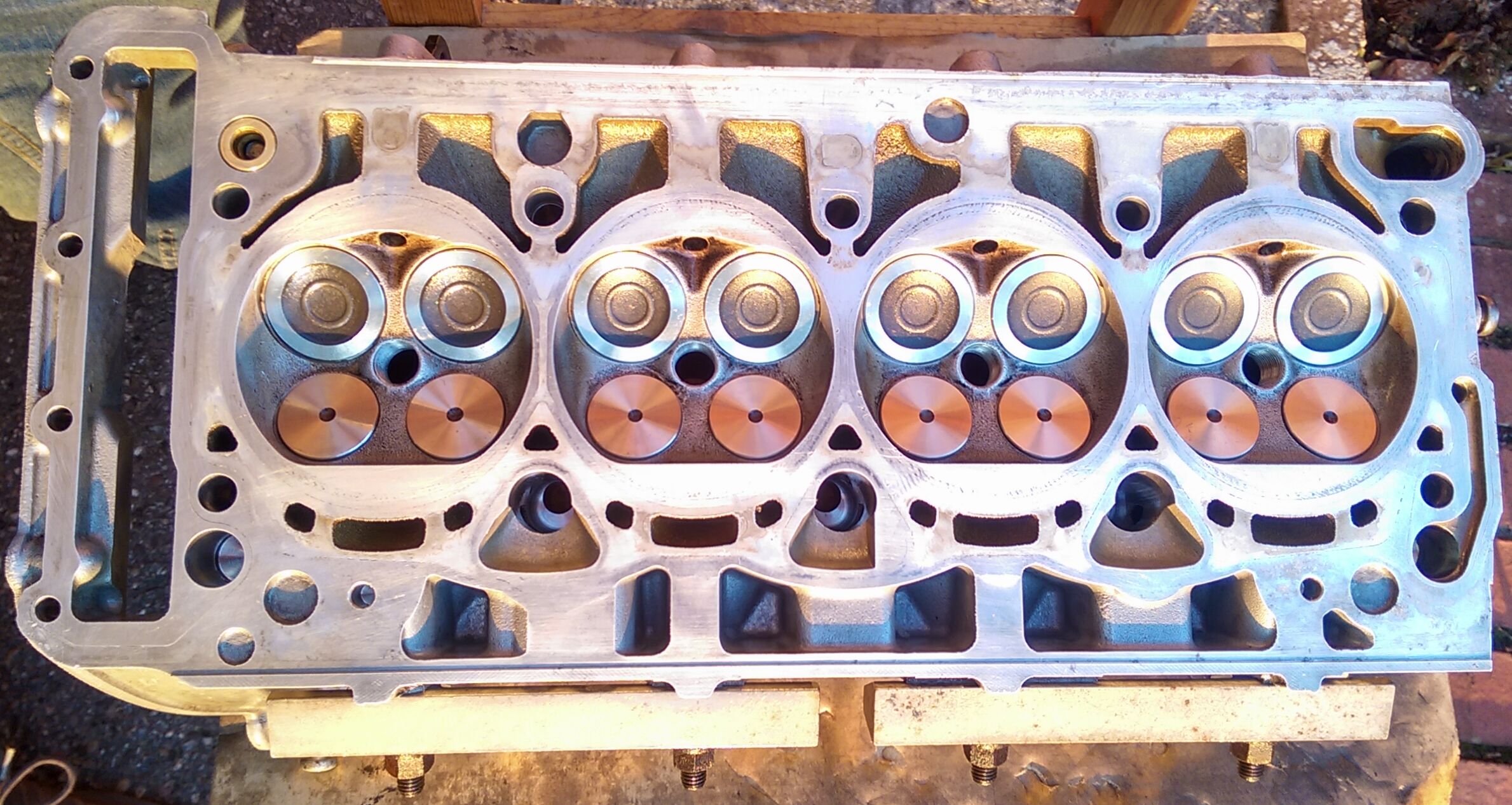

I haven't counted but I've spent at least 20h cleaning the cylinder head and installing the new valves. I had
to go into every nook and cranny to remove the old sealant, clean the head cover, the exhaust manifold,
polishing the inlet and exhaust ports, polishing the injector ports, lapping the new valves into place and so on.
The exhaust threaded pins (from both ends) where quite rusty so I've used a tap and die kit to re-thread them
and I can now turn them by hand.
When lapping the seat for a new valve I've first used the coarse paste, removed one suction cup from one end
of the lapping tool and stick it in an electric drill. Then I've cleaned the paste, reapplied fine paste and finished
the lapping by hand. You could hear the change in pitch when the seat and valve were perfectly polished.
I was about to put the head back on when I've noticed in my gasket set 16 green caps which turned out to be
valve stem seals. I wasn't even aware those could be changed and no one here mentioned them. I am now
convinced those are to blame for my increase oil consumption given the state of the old spark plugs and valves
which were covered in a thick layer of carbon. The green rubber was much harder on the used ones compared to
the new from the set.  I just wish I've noticed them one day earlier because I had to take the valves off and
put them back on again and instead of half an hour it took me another 4h.  For the valve removal I've used
this tool which was incredibly good for its price. I've used it twice on 16 valves and it hasn't bent at all.
For the stem seals you need yet another tool. This one was also cheap but not as good. I had to file down the
extractor (which looks like a forceps) clamps to make them close better and the gripping ribs are not deep
enough. It takes several pulls until you can remove one valve seal. The insert tool from this same kit was
perfect. It pushed down only on the metal part of the seal evenly on all sides and they are all changed now.
Tomorrow the cylinder head and exhaust turbo go back on the car.

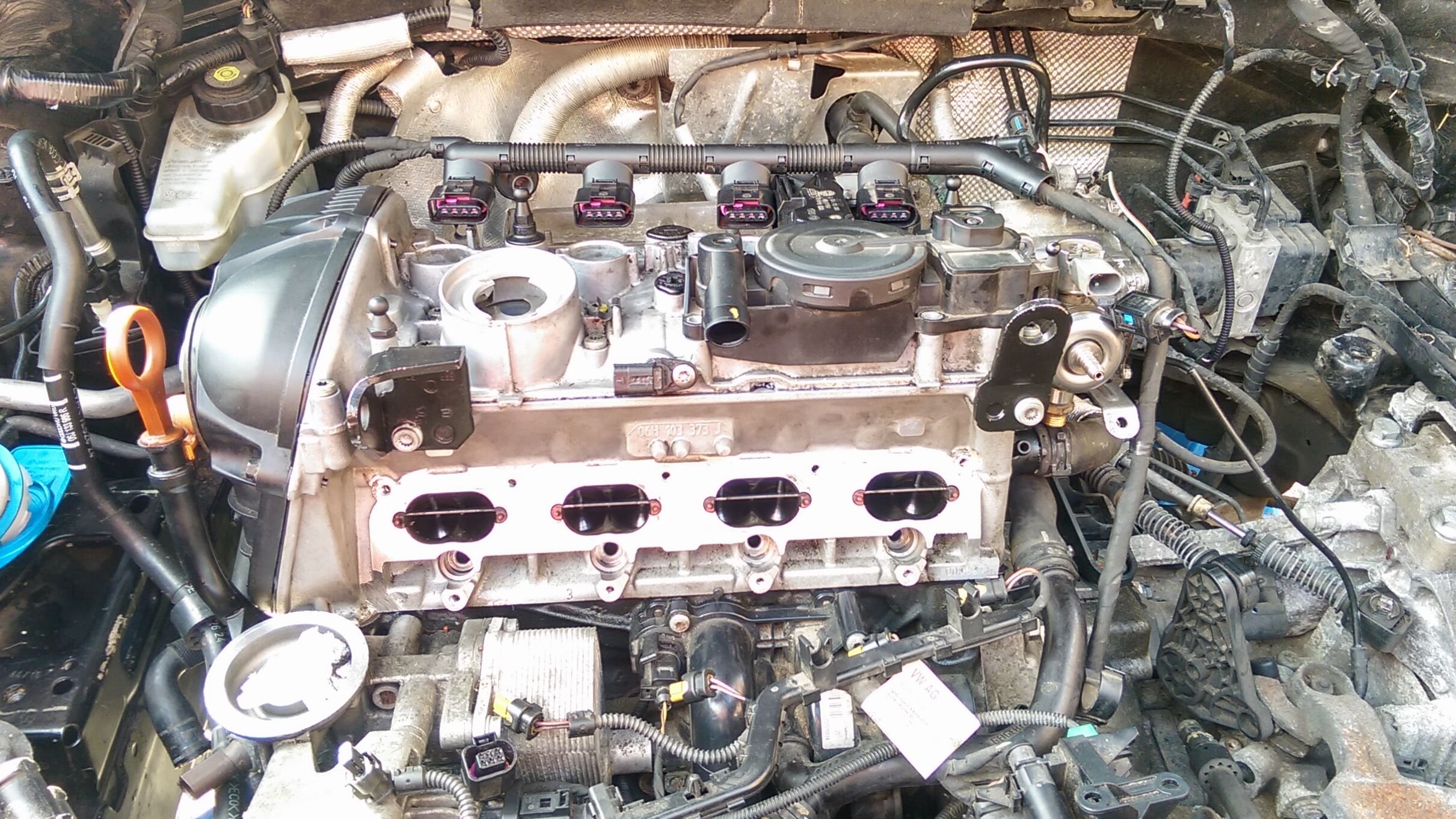

Cylinder head and cover are back on the car, engine timing done, chain covers back on.
I've put new teflon and rubber seals on the injectors and I'm ready to put the intake manifold back on.
I wish I've taken more detailed photos because there are still a few hoses which I'm not sure where they go 😉
One dreadful task still left to do is putting back that left engine bracket. I'm slowly getting there.
