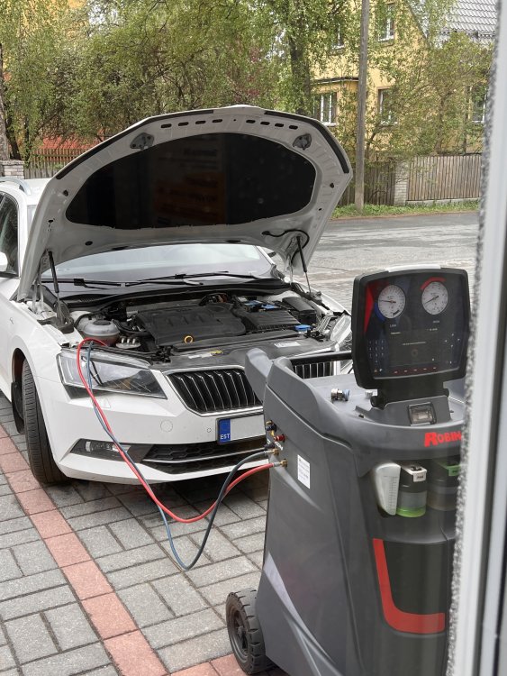

In the meantime, the weather was getting so summery that, sitting inside, you wanted to blow a little cooler air. To my surprise, it was lukewarm. The machine uses a newer type of substance, R-1234YF.
The whole process took 45 minutes on the device, 0.460 kg of refrigerant was loaded and the bill was €95. The majority of places charge at least €120. The agency charges €185 for the same work.

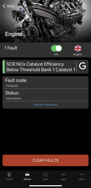

Time-to-time, when scanning with OBDEleven I get NOx error: P20EE00 - SCR NOx Catalyst Efficiency Below Threshold Bank 1 Catalyst 1 Intermittent
No dash warning and car driver normally.
My question is - where to begin to solve this error ?

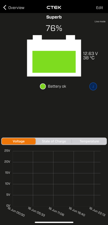

Bought CTEK Battery Sense to have an overview of the battery. Install and pair with the phone was really easy!

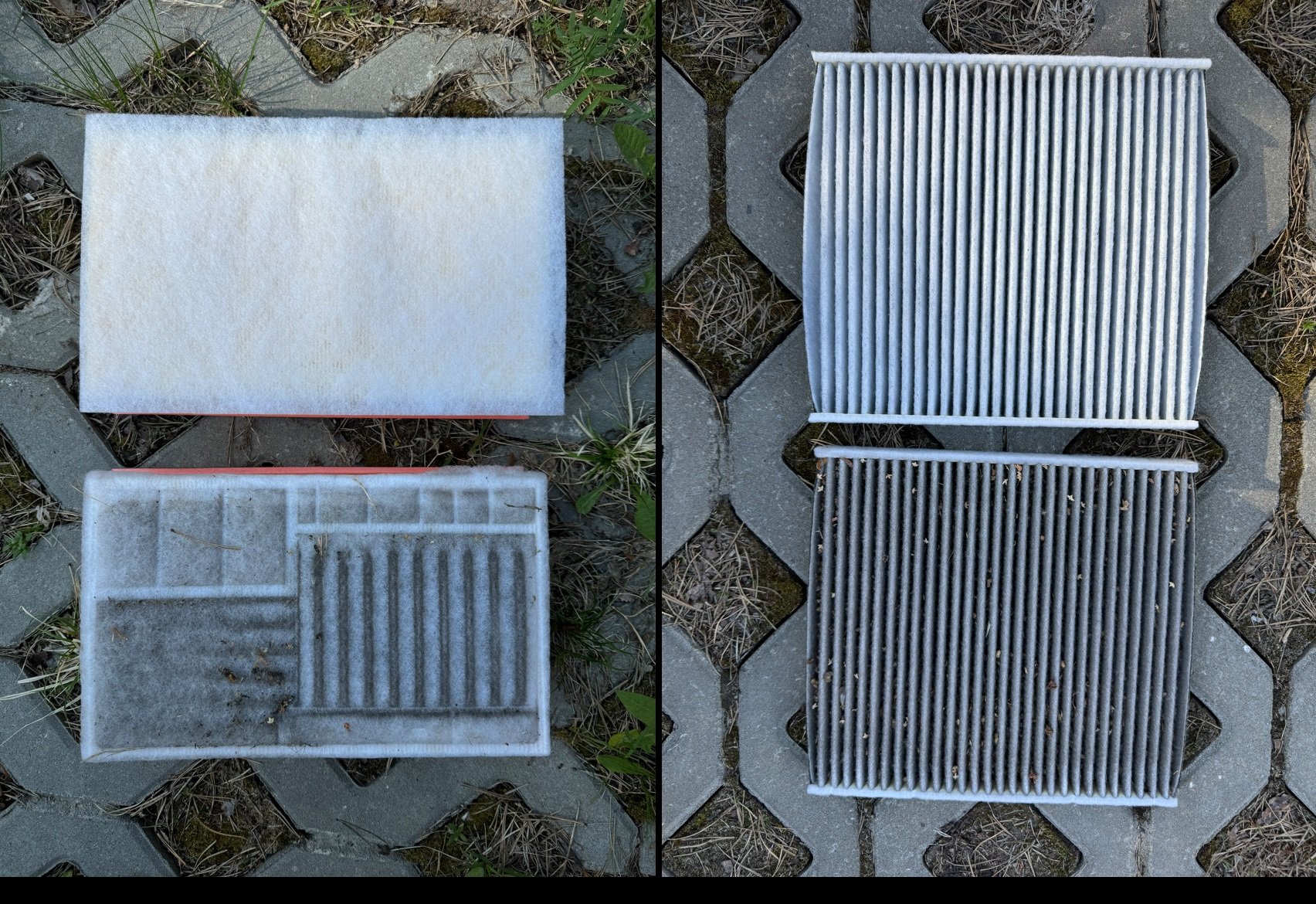

The air and cabin filter was replaced today:
A nice 20 minutes of tinkering.
Mileage: 126814 km
• Air filter: OEM code: 5Q0129620C - MANN-FILTER C 30 004 / cold climate filter - €12.61
• Cabin filter: OEM code: 5Q0819669 - MANN-FILTER FP 26 009 - €15.69
