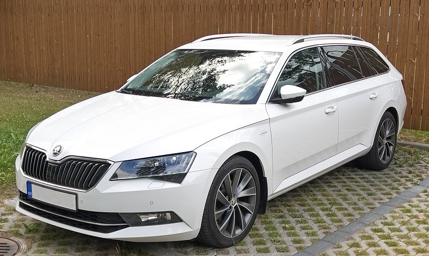

Skoda Superb Combi 2.0 TDI 4x4 140kw L&K Business Edition - 2018
Hello! :)
Thought to make a thread about my new car. From 2014 to 2022 july I drove with SAAB 9-5 Estate Aero. Time goes on and needs change and so I decided to go forward. My searches began early spring and recognition hit me in june - It's when you sit in the car and you understand "this is it" 😆
At the moment I feel like you have a button phone and now you have to use smart phone - so much to discover.
Color is candy white, interior black leather, webasto, canton, 9.2" Columbus touch screen, parking camera.
Mileage: 105814 km

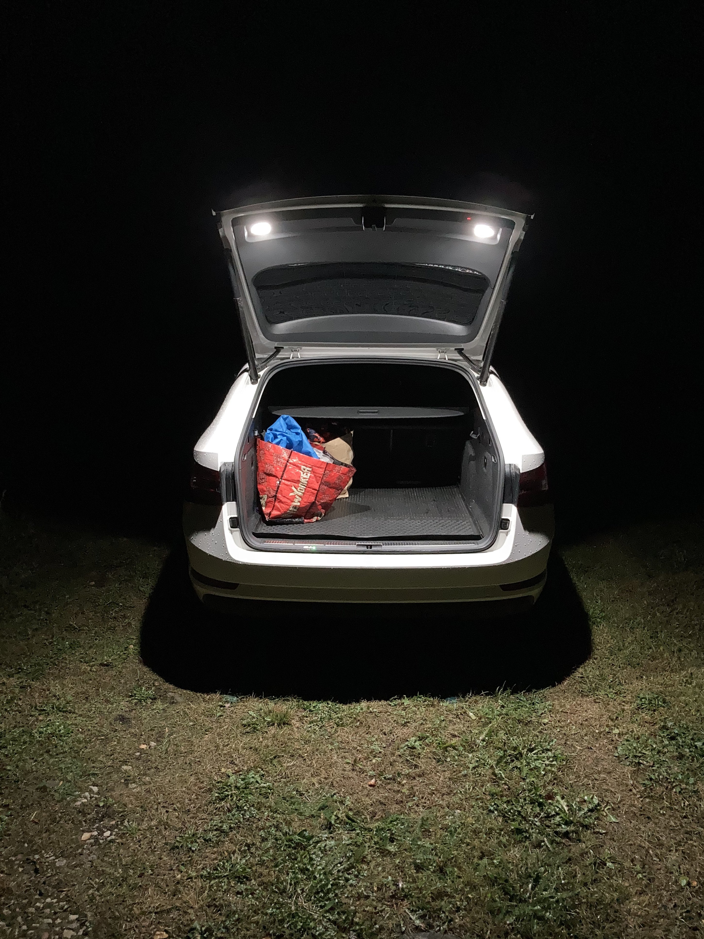

Recently changed yellow bulbs to white LED and the result is amazing. Nicely bright!
if it's not a secret what bulbs

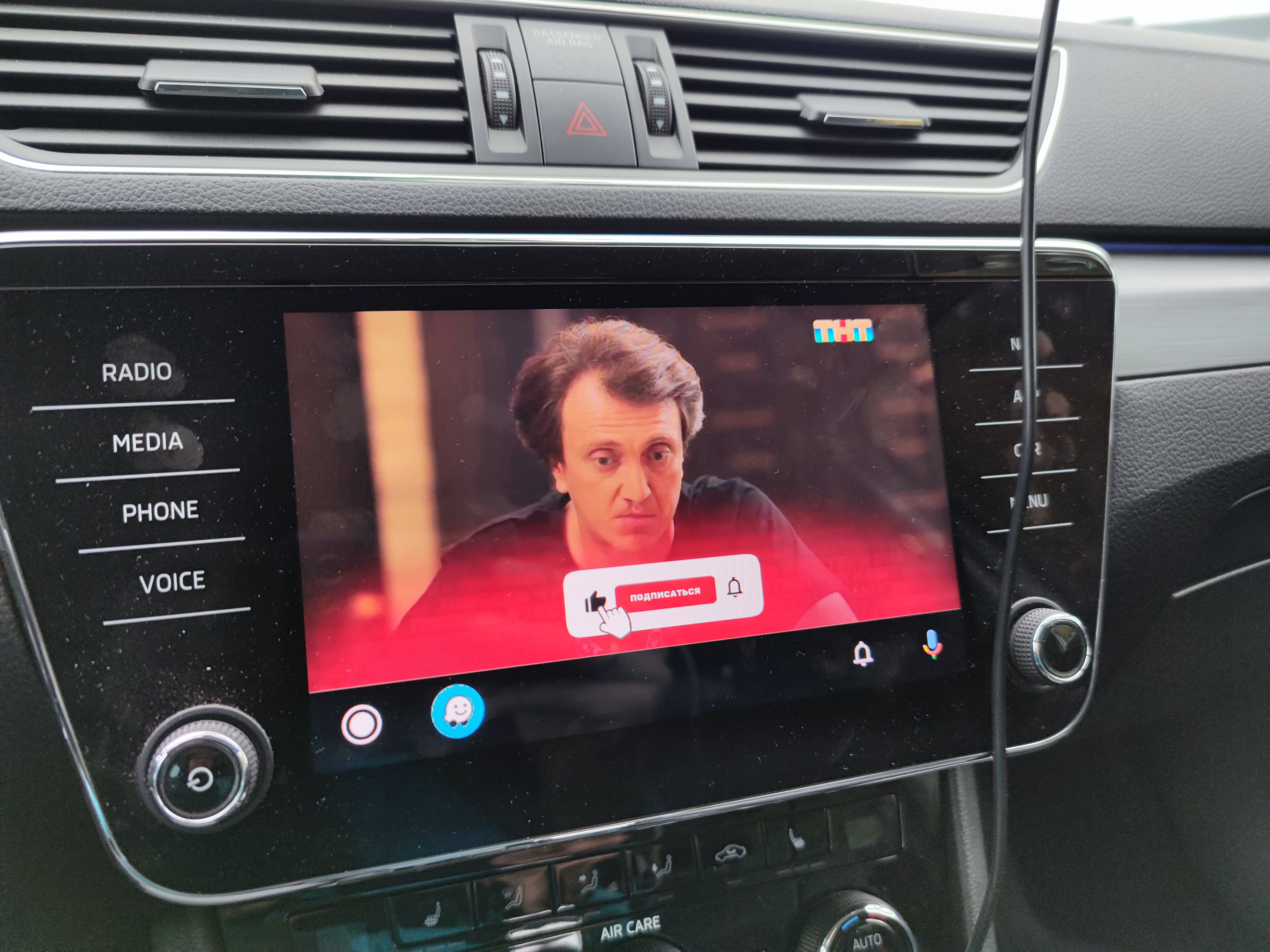

Купил беспроводной адаптер CarPlay: Ottocast U2 Air от Amazon. Стоимость 100€.
https://www.ottocast.com/products/u2-air
Подключение его к машине было довольно интуитивным. Было несколько раз, когда он не подключался, но после обновления программного обеспечения - никаких проблем. Очень нравится, как быстро он подключается!
Основной недостаток - Разряжает батарею телефона, но это зависит от того, сколько лет телефону и в каком состоянии батарея.
Печально, что этот адаптер не поддерживает зеркальное отображение экрана, чтобы я мог воспроизводить YouTube и т. Д.
connected youtube via carstream

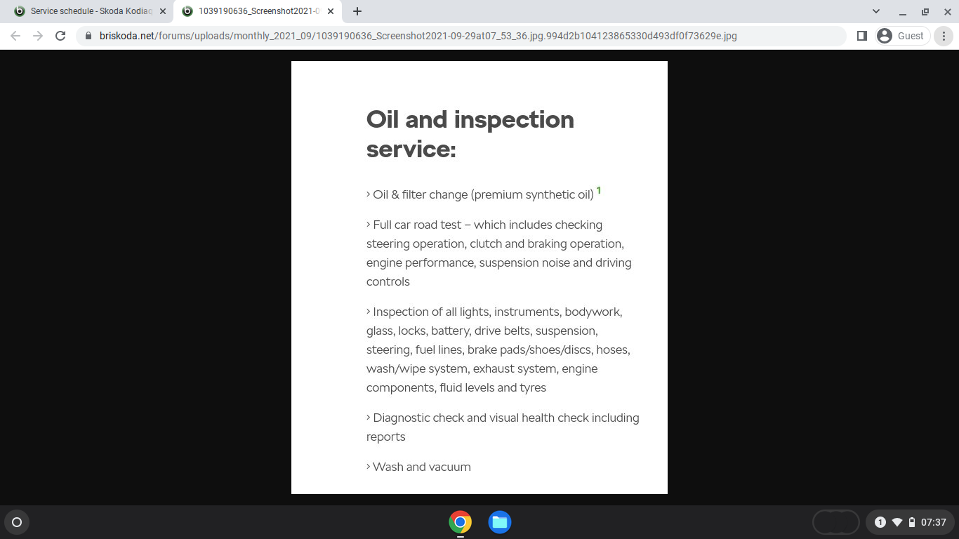

Škoda tells me that I have to go to regular maintenance in a few days. Therefore I thought, where I can check exactly, what the next service should do ?
Mileage is at the moment: 112236 km - Where can I get full info about next service without asking it from dealer ?
Ask who ever told you the regular service is due what they think is required.
Or was that the service indicator on the car that shows service due?
Plenty posts in the Superb section if you look.
What has been done so far, last services.
When was it done?
Oil & Filter, Fixed or Variable Servicing.
Haldex service @ 3 years / 30,000 miles.*Not just the oil changed.*
DSG oil change @ 80,000 miles or sooner if a DQ381.
Brake Fluid change at 3 years then each 2.
Pollen filter @ 2 years or sooner if needed.
Air filter when dirty.
Brakes serviced as needed.  etc etc
Cambelt / Water pump according to country, advice / recommendations.
Just as an idea,
1624336521_37335614_Screenshot2021-09-14at07_38_18(3).webp.3c042b3d60ff4f7eed63333aeb416947.webp

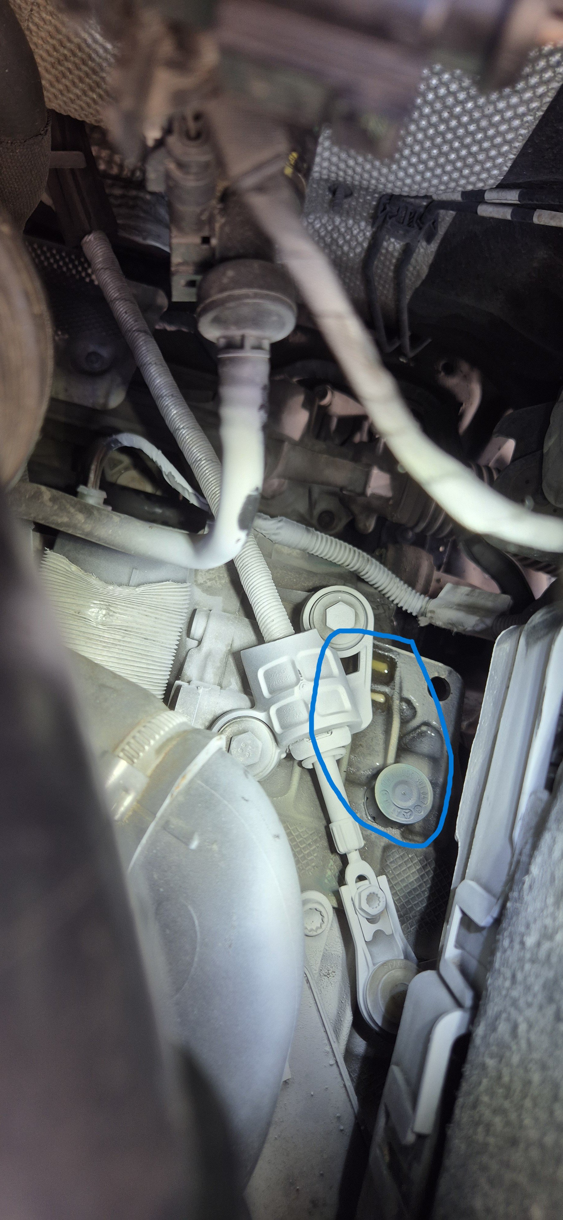

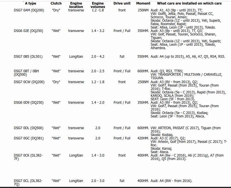

I found myself to understand, what DSG my Superb have. It is 7-speed 4x4, but is it DQ250, DQ381 or something third ?

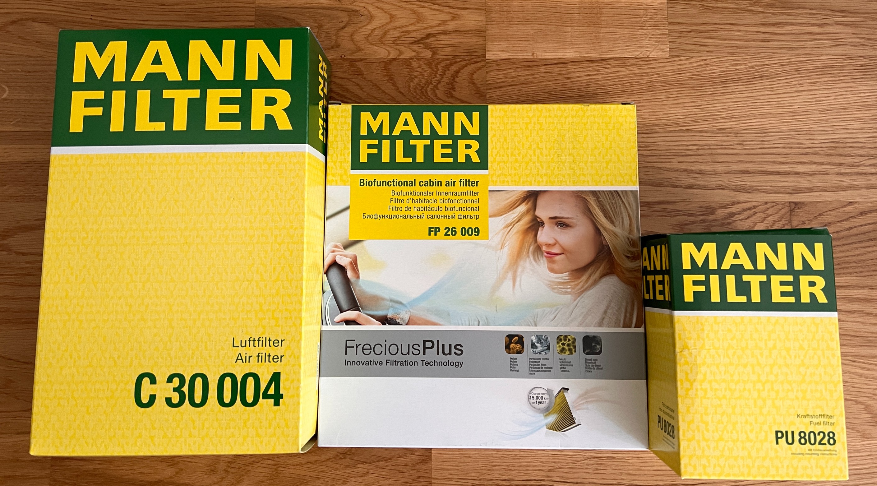

After some searching I came to a conclusion about filters: I can buy filters a lot cheaper and going to change myself: Pollen and air filter, but going to buy all the filters below.
  OEM code MANN MANN site  Local price (€)
Air filter 5Q0129620C C 30 004 Link  14.96
Oil filter 03N115562B HU 7020 z Link  6.65
Pollen filter 5Q0819669 FP 26 009 Link  15.25
Hydraulic Transmission Filter 0GC325183A H 6031 z Link  6.65
Maintenance contains also engine oil replacement and Im going with Mobil Super 3000 Formula V 5W30 - 5L cost 39€ (dealer price for the same oil was 106 €)
There is also Haldex clutch oil 850ML - OEM code should be G  060175A2 - Workshop price is ~58 € (with discount) - At the same time, same amound oil from Febi or SWAG costs 17 €... am i missing something?

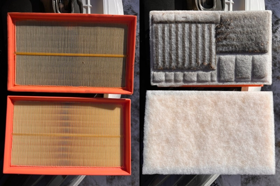

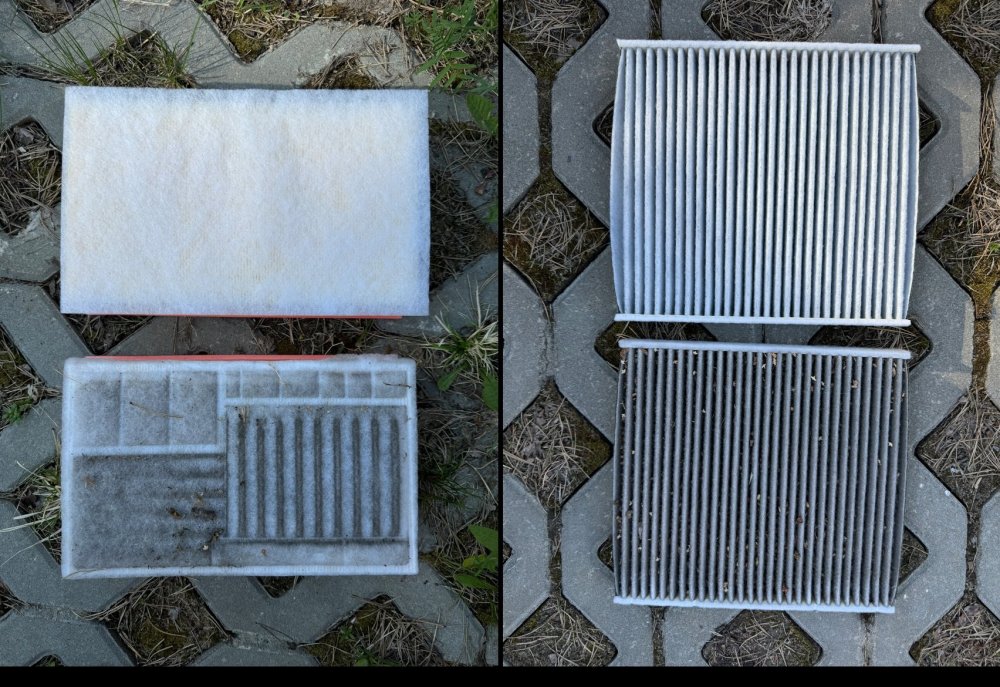

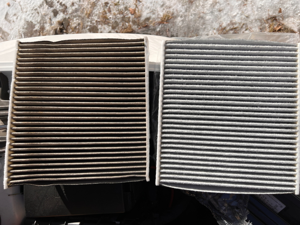

I did filter replacement by myself (filters costs 51.51€). It was pretty straight forward and took about 25 minutes, but saved me pretty much € :D

SEPTEMBER 2022
16.09 - The yellow lights in the tailgate have been replaced with white ones.
