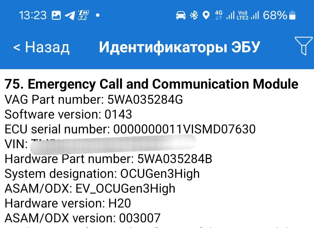

You need to know what is SW version with OBD
I have OBD adapter. Can you advise how to check, if it's not the one on picture?17256348816252179316816284656028.thumb.jpg.516a223433f5a247dd0c4c1d7a8a9633.jpg
This photo is infotainment SW information. Module 5F
Obdeleven, Carscanner, Carista, Vcds, etc.
75. Emergency Call and Communication Module
VAG Part number: 5WA035284G
Software version: 0143

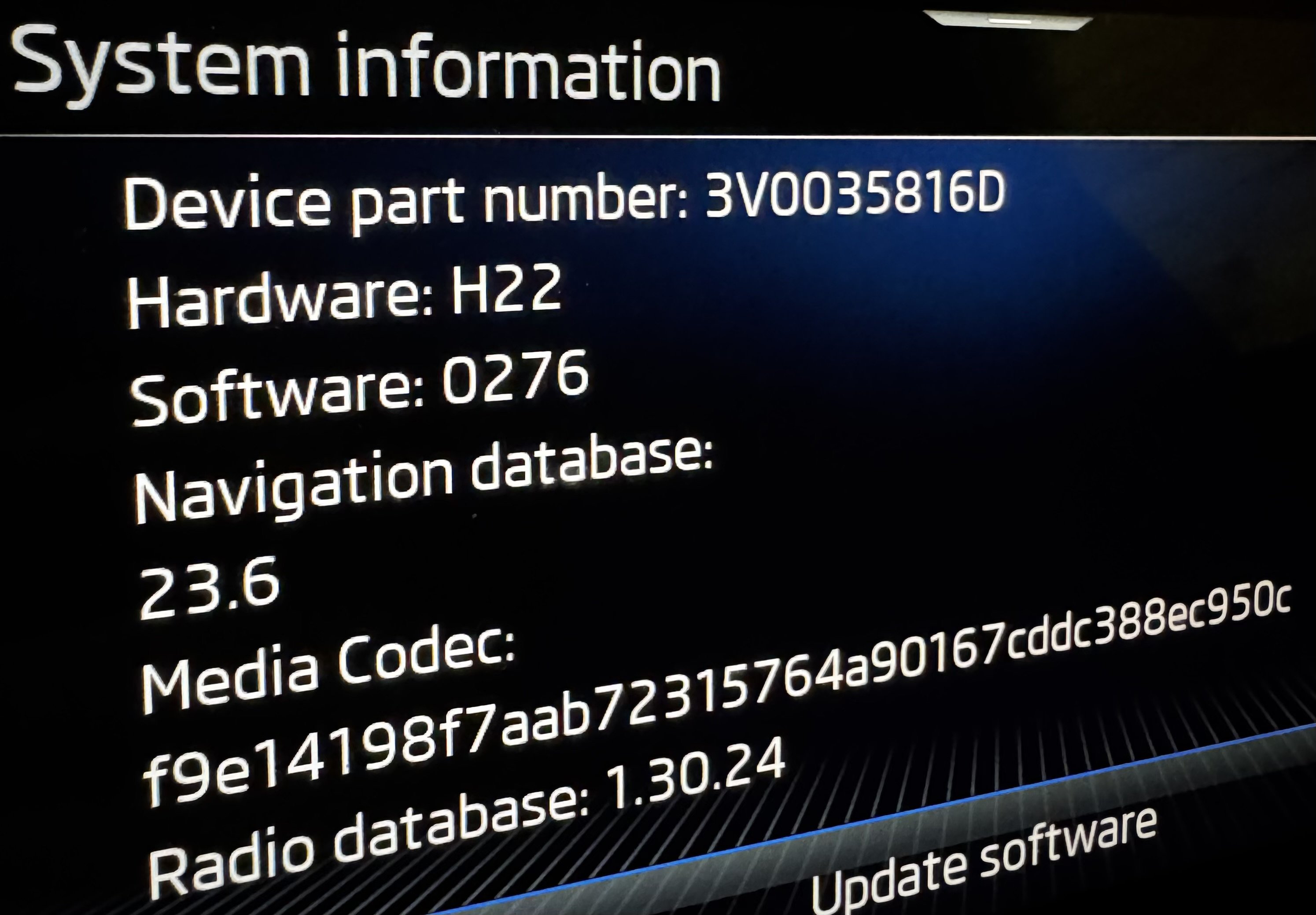

Hello,
A friend of mine has a MIB3 with SW 0270 (H22). Just to be sure: I need to update first to MOI3_EU_SKMQB_P30800P_0308 and then to MOI3_EU_SKMQB_P33000P, right? Can I expect any problems after the updates? I found two different version 0330: MOI3_EU_SKMQB_P33000P and MOI3_EU_SKMQB_P33000P_0330 - is there a difference between them or which one is the right one? Thank you.
Yes, the update procedure is correct.
There is only one 330 update.
They must be the same.
After update, the system must work moore fine.

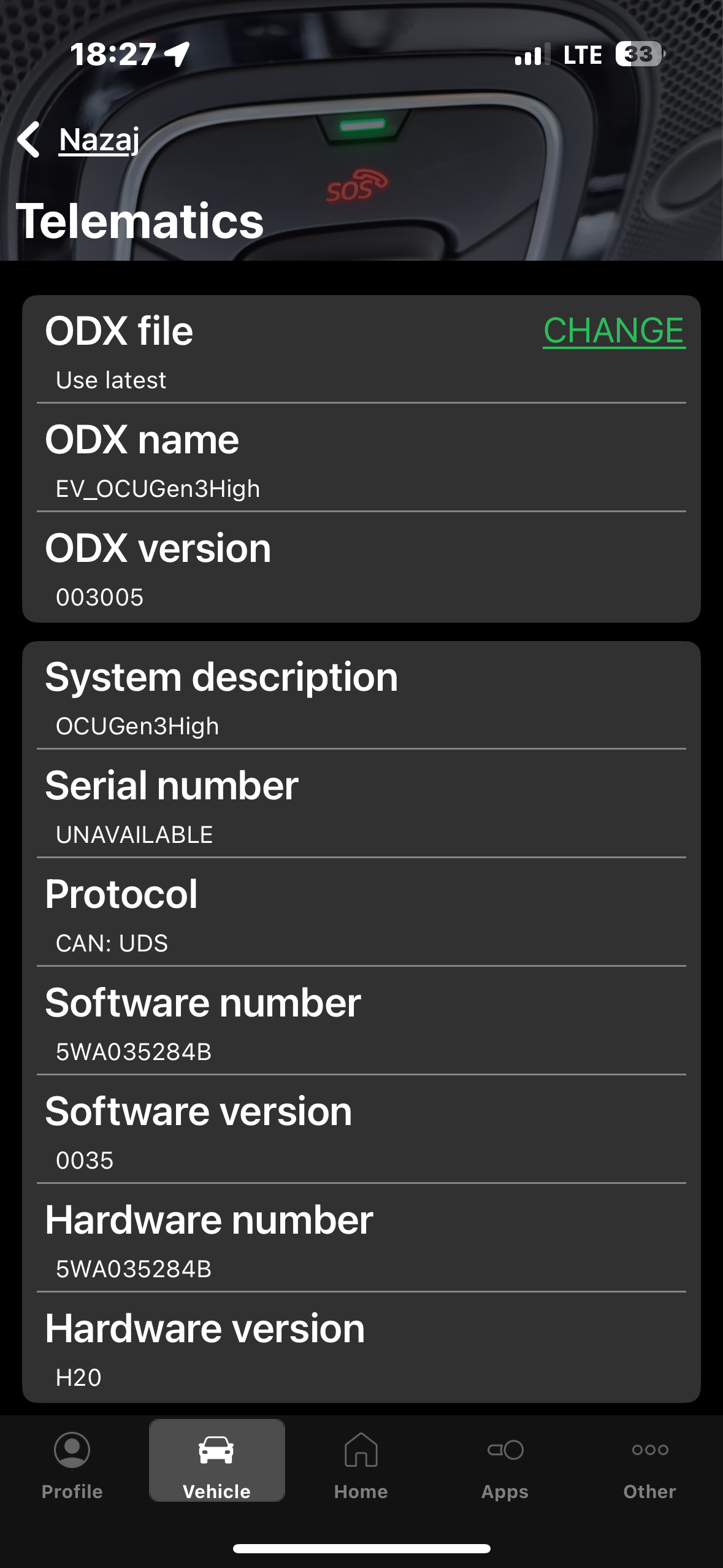

Hello
Can somebody pleas help with OCU update?
I talk do dealer and they says that they must update OCU module. Problem is that i cannot become a primare user…and this update might solve the problem.
Can somebody write procedure for update Please?
Car is 2021 Superb.
Here is my firmware.
please.
Edited by Seba800
Sw 035, it's very old, now is available version 149. You can brick your OCU if you try by yourself.
